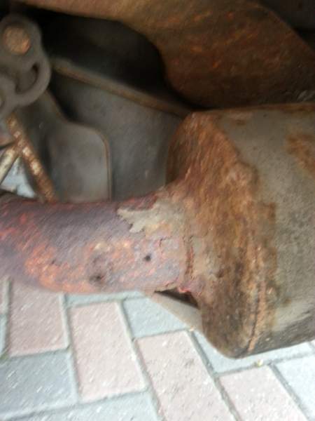

If some of you remember i'm looking at changing my exhaust, The pipes from my mid section to the backbox are badly corroded and have got little holes behind the wheels and they're slowly getting bigger.
I'm still unsure what to do. I've managed to find a place in Darlington that will replace those two pipes with stainless and attach them to my original Kakimoto boxes for £80 a side. however the boxes are quite old and looking through the pipe it doesn't seem to have a lot of packing left inside them.

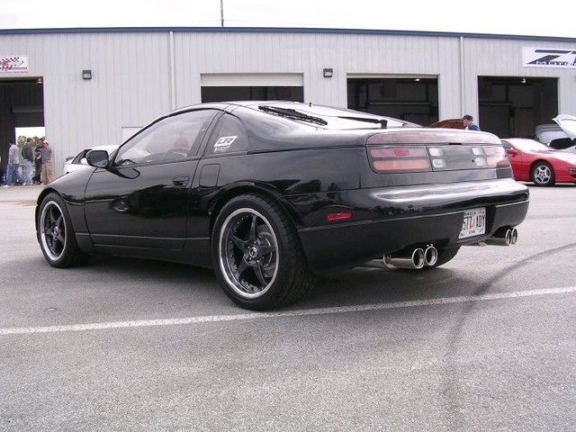

If you are debating the tip style, its always twin-tips for me. And slightly larger than stock size really updates the Zed rear end.

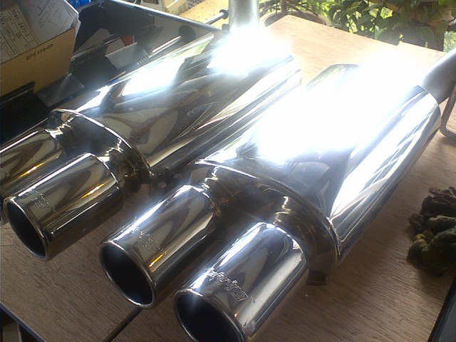

for ref: I use a Greg Dupree X Pipe with resonators and Sebring backboxes:
(from http://www.300zx.co.uk/forums/showthread.php?95514-The-Olliezx-Story-Chapter-8-New-Exhaust-Part-2-Greg-Dupree!&highlight=sebring)
Sorry I have't actually take any pictures of them fitted on my own Zed in all this time!
Edited by olliezx

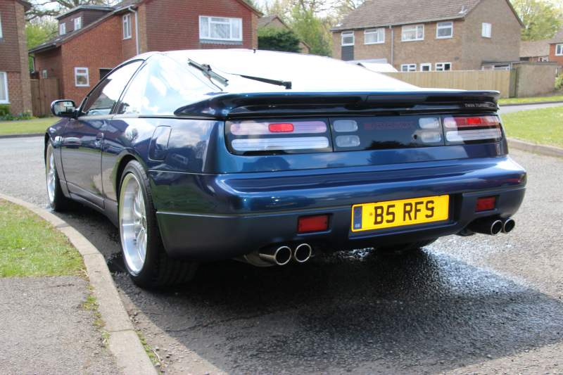

I am happy with the Blue Flame/Mongoose - for the same reason as you mate. Twins each side - just like stock but a bit bigger - and not too noisy either. There's a subtle low rumble when pootling along at around 2000rpm; but nothing so intrusive on the motorway. And it's not terribly expensive either - especially if you can still find the "Blue Flame" version....
Richard:cool2:

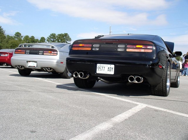

[ATTACH=CONFIG]72142[/ATTACH]
[ATTACH=CONFIG]72143[/ATTACH]
[ATTACH=CONFIG]72144[/ATTACH]
I've never been a massive fan of the twin tips, but looking at them photo's you may have changed my mind. I think it's because they're bigger than the standard ones, but they do look really nice. Would probably suit my rear bumper better too than one big pipe. xforce do a twin tip too for the same price as the others. and reading the thread it looks like they weren't cheep, so i'm guessing if I do get the Australian ones then it won't be massively more expensive than others. which is a little reassuring.

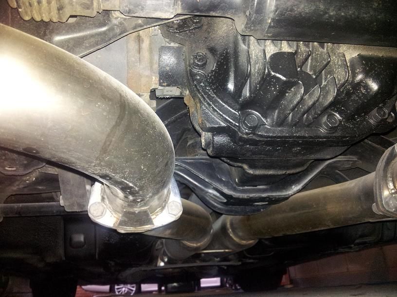

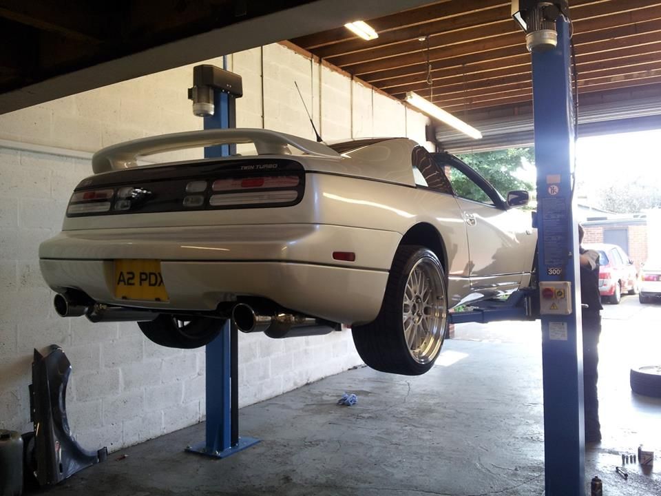

I took the wheel off earlier to check some rubbing under my arch and got a photo of the exhaust, the bloke in Darlo said he could save the back boxes by just welding the new pipe on, but from the looks of them they'll probably disintegrate...
Dude, those backboxes are trash, in fact, your whole exhaust is. I wouldn't save that if all I had to make a replacement with was baked bean tins! lol
