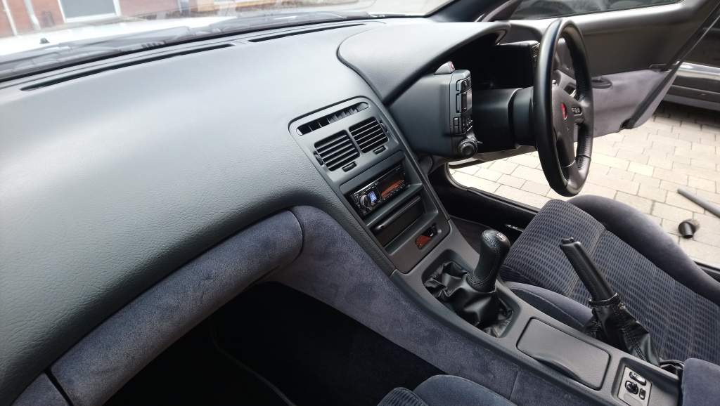

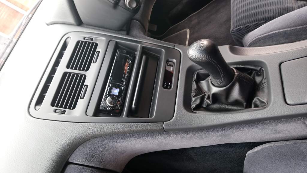

Gave the interior the first proper clean of the year. Comes up pretty nice.

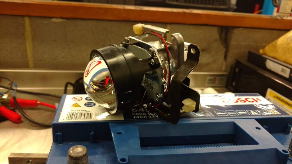

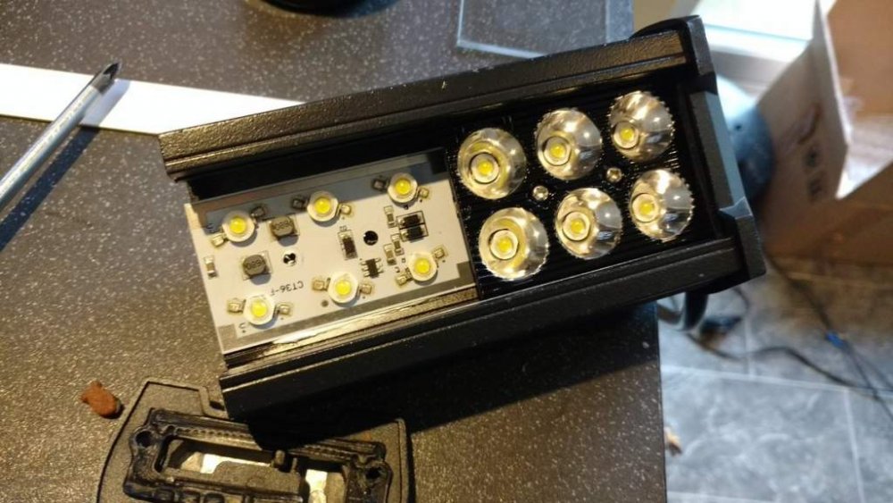

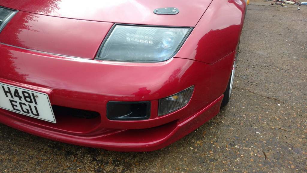

Actually did this a few weeks ago but wanted to give it a good road test. Works amazing compared to stock! replaced the OEM projector for a high/low beam projector with 4300k HID while keeping it mounted to the factory mount so can still be aimed and all wires so low beam will stay on with the high. Also replaced the high beam with a fixed *32w* (more like 14w) led flood. might not be everyone's taste but im loving it :laugh:

What projector did you use Jay?
was one of these projector kits below. however i know some bmw and vw use a similar setup, but couldn't find a set in my price range lol
https://www.ebay.co.uk/itm/2x-2-5-Mini-HID-Bi-xenon-Projector-lens-Kit-Headlight-Bulb-Shroud-H1-high-low/281394647817?epid=1639245810&hash=item41846d9309:g:CZUAAOxyNThTegv~

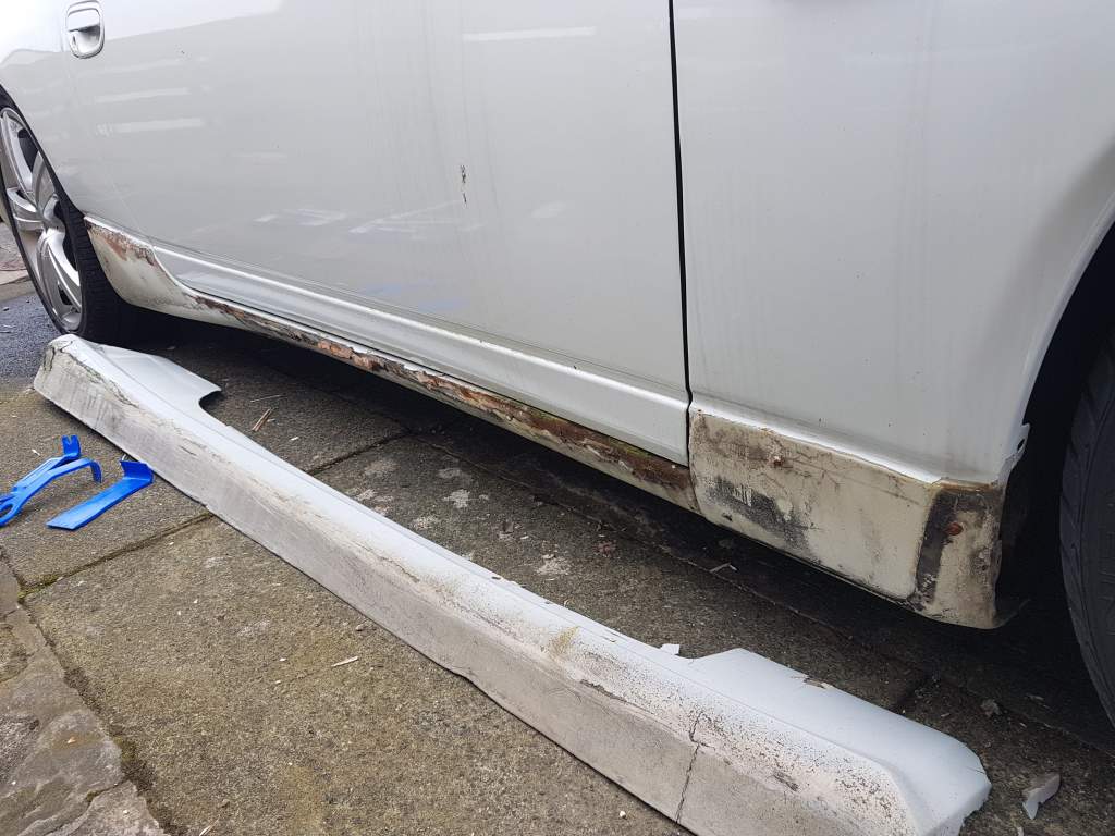

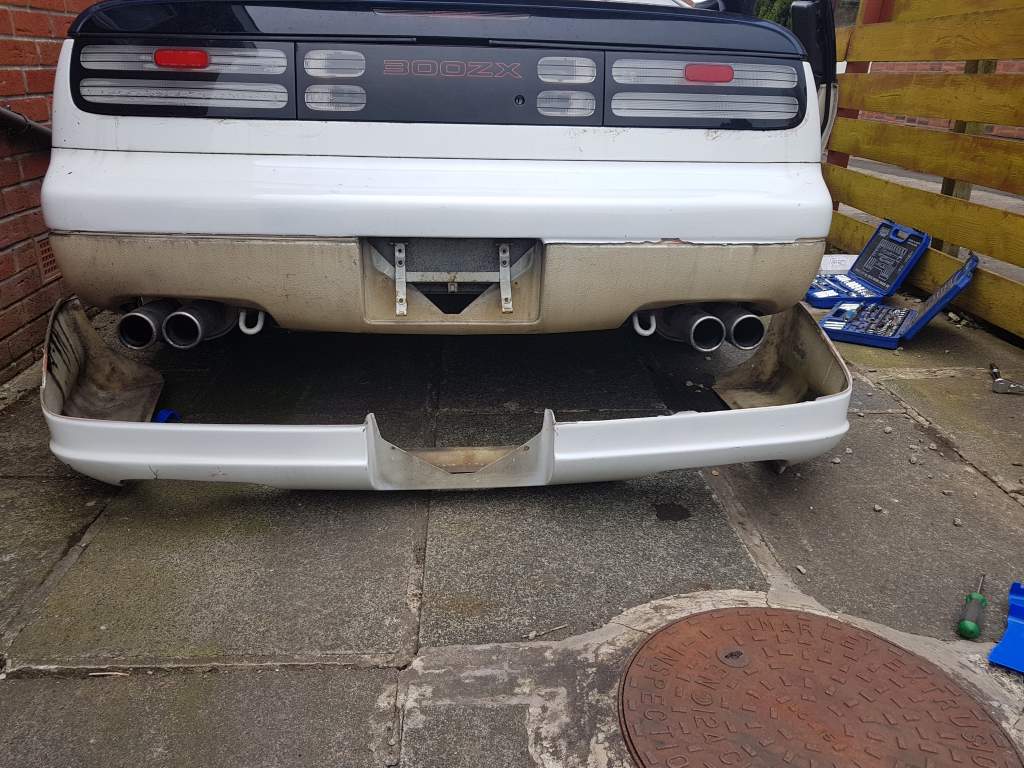

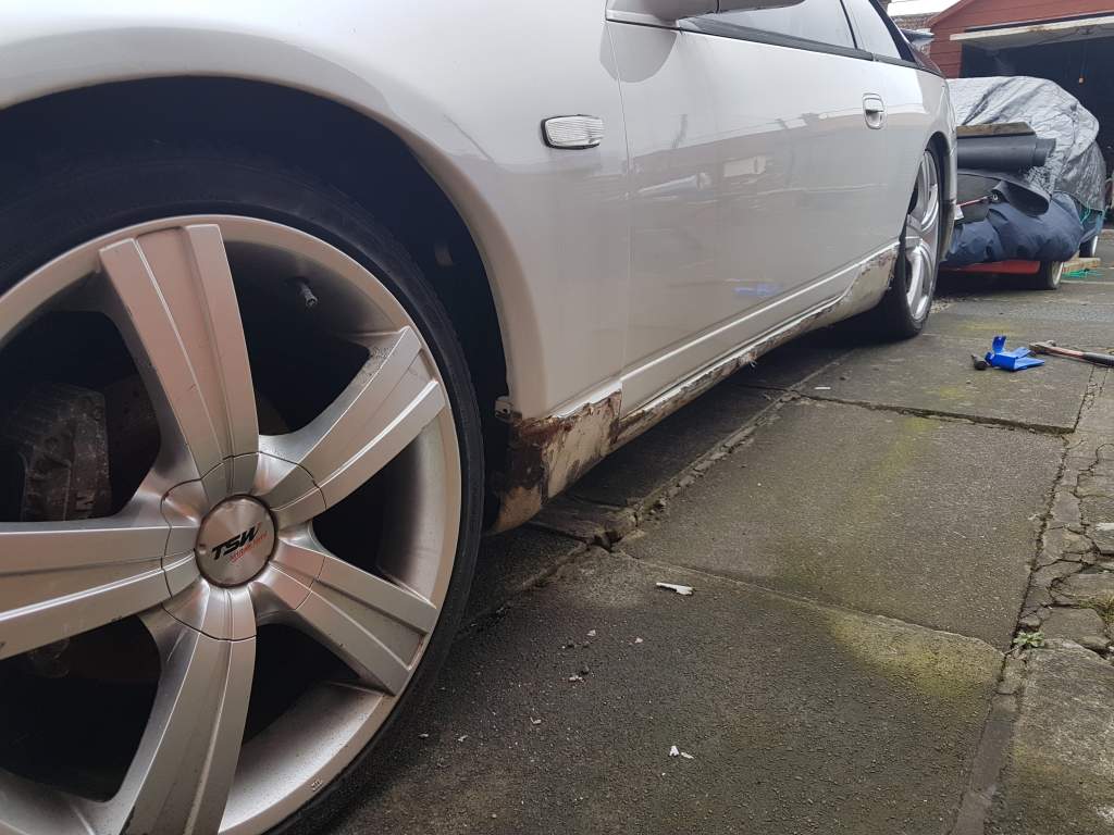

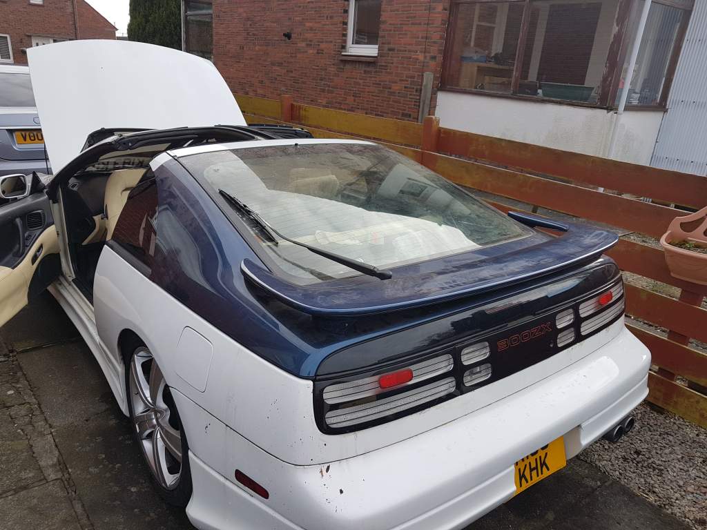

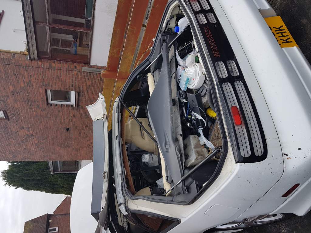

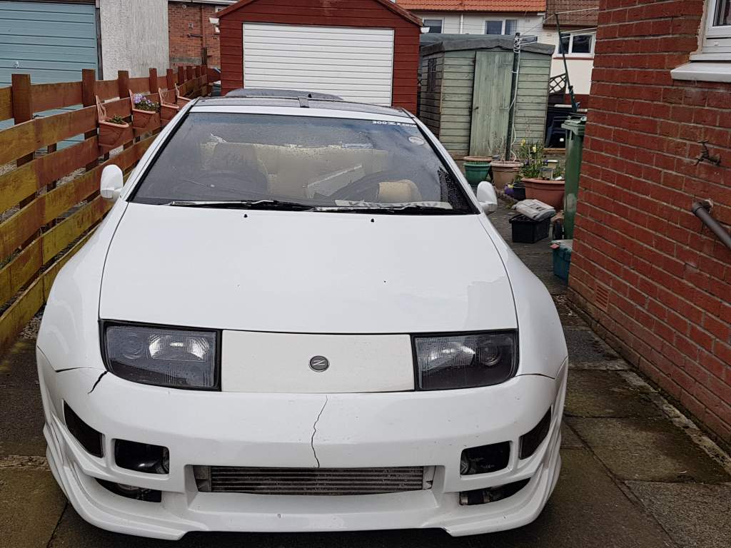

been busy as feck over last few days from Sunday, plus rained off with freezing cold rain and wind. so the car got the tub off and away, BYE BYE Bomex rear bumper side skirts off and away just need a front bumper, new nose panel, chrome door panel. The Shite C@@t that I bought the car off cut wires to wing mirrors, tailgate, but any how just a couple of pics to show that I have been working on her, probably start a regeneration thread and add all my pics on as I go along.. at least the sills are in good order what I was kinda worried about when was taking them off.

had to slap loads of rust proof over effected exposed metal gonna be sitting for few months now lol..

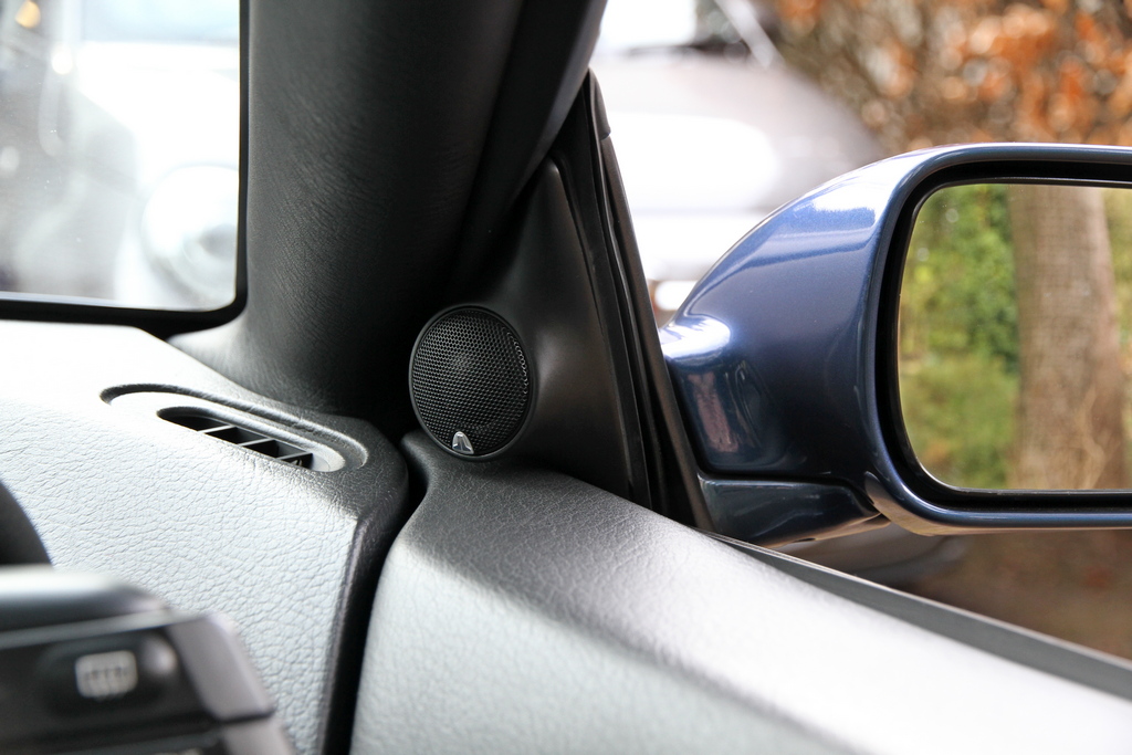

I finally made progress on a job I started about 4 years ago! My version 2 speaker install. Version 1 was ok but when I purchased my Genesis amplifiers, the speakers were screaming for better quality upgrade. I’ve always had my tweeters in the air vents and whilst version 3 will likely see them move to the sail panels, version 2 stuck with the vent location which had proven to work well.
4 years ago when I started the upgrade I only did the drivers side component set and then as time went by I had other priorities and didn’t complete the passenger side. During this time my drivers speaker has been significantly better quality and power compared the the passenger side so I have been balancing this out with a 70% shift to the left to keep the sound stage central!
The upgrade itself is simple for the larger speaker as I’ve already mounted that to its chamfered MDF ring ready to straight swap, but as the tweeters were larger than version 1, the air vent brackets needed to be remanufactured. I got round to doing this today and I’m looking forward to the simple task of installing them and then taking the car to Audiophile in Bishops Stortford for a audio tune with my freshly serviced amps and this new front end setup. These tweeters are a tight squeeze in the vents once the angle is set properly but they fit well and there’s still plenty of airflow through the vent.
I know many people don’t bother with the audio side of these cars but I really like a decent sound stage when driving the Z and listening to some good music. My setup is fairly powerful when compared to most modern OEM fit systems but it is far from the level that you see in these cars with speakers everywhere, massive subs and a hearing test report that correlated with their graphic equaliser! It goes loud enough to not want to go any louder as a normal person but the main focus has been with the sound quality. None of my gear is super high end stuff as it’s money wasted in a 1990’s Nissan due to it’s design, but it consists of decent quality mid range equipment that is matched well to the capabilities of the “room”.
The bracket is now in primer ready for a quick spruce of black before wiring in and installation. :rockon:
