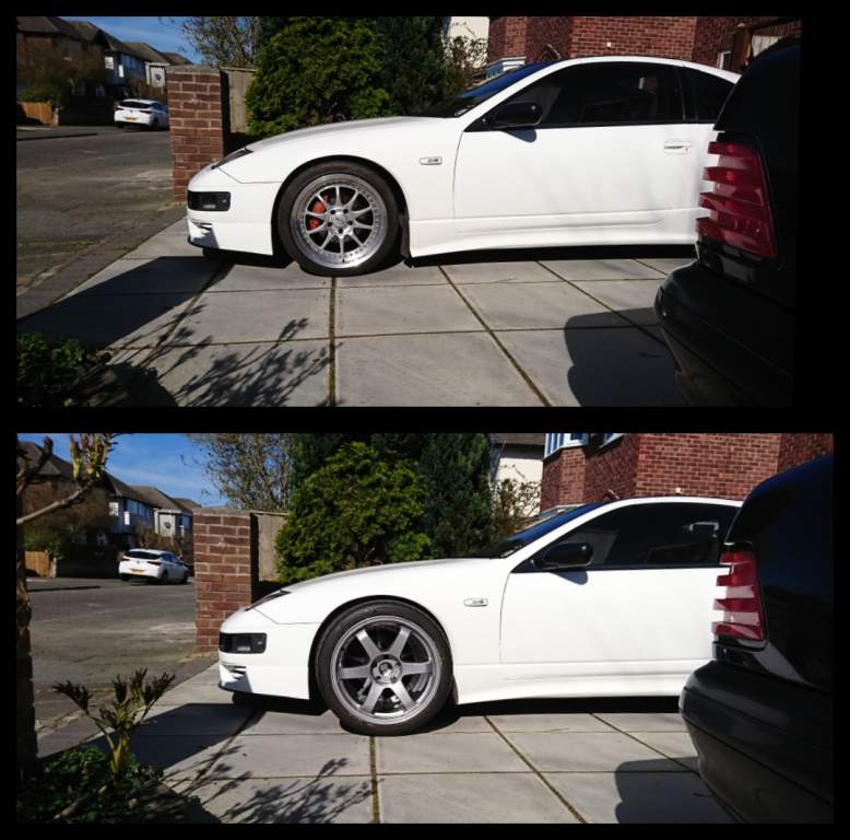

I prefer the bottom ones tom but like Si says the ones you have are nice id polish the rims up and get the ctrs painted shadow chrome.
I'll get the rotas fitted, if I like them I'll keep them on if not they can go on the slicktop
