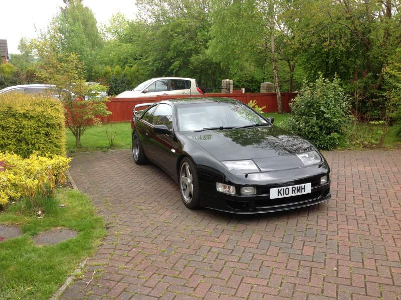

Wash and waxed think I might take it for a run,before it rains.

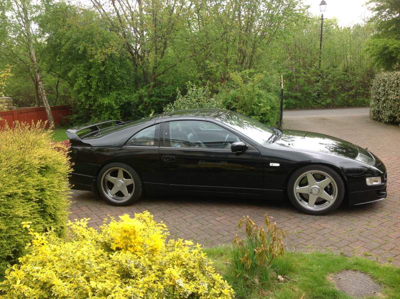

My mission continued today with my corrosion prevention control program! It went a little something like this:
- Remove remaining interior necessary to access sills and rear 1/4 skins
- A Boroscope inside of both sills front to back revealed that this 20 year old import (that I got fresh off the boat in '07) is still in remarkably mint condition!
- Lots of sound deadening applied to the rear 1/4 inner skin all round and various other areas
- Cavity wax lavishly applied throughout both sill sections, rear 1/4 wheel arch box sections and every nook and cranny using a series of fancy wands and nozzles.
No area of this Z32 is being left untreated and hopefully will happily see another 20+ years of rust free motoring.

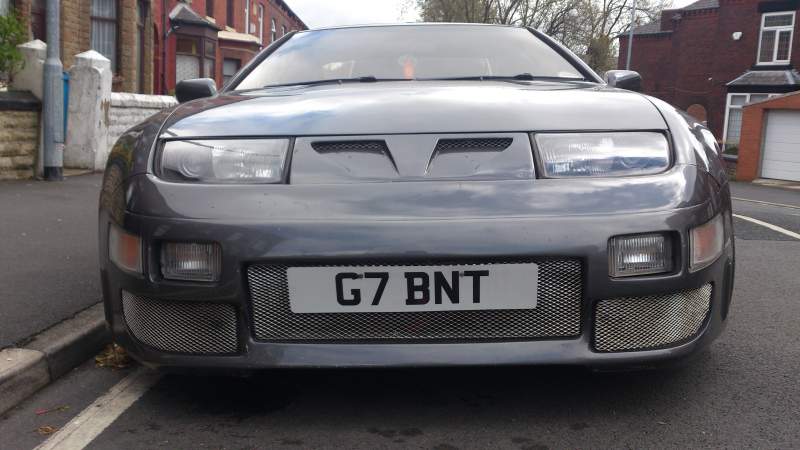

Nice front end.......
.......but then I have to concur mate....:whistling:
Get your car in the COTM competition next month Gray, you have a very good chance my friend!!
Richard:cool3:
CheerZ Dave. I'm using dinitrol ML3125 solvent based cavity wax inside all the nooks and crannies! And dinitrol 4941 solvent based underbody wax underneath. Just about ready to drop it back down, I didn't get as much done as a planned this time round but will work my way across the car.

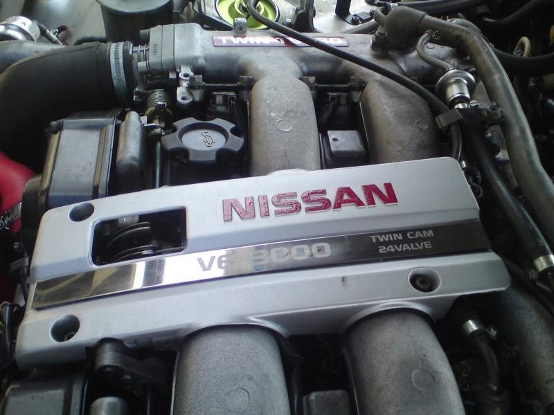

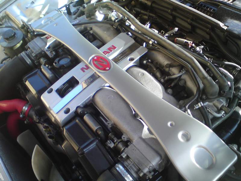

Whilst attending to a slight bit of rust on the drivers side sill I removed my throttle cover and decided to paint the raised NISSAN part in Mazda classic red.
I took my Tokyo Auto strut brace off also and ran it under my wire wheel, primed it, then silver wheel sprayed and then lacquered. Also took its center Z badge off and sprayed/lacquered also in Mazda red. It looks very much like I'm now starting to bling up the bay :cool2:.

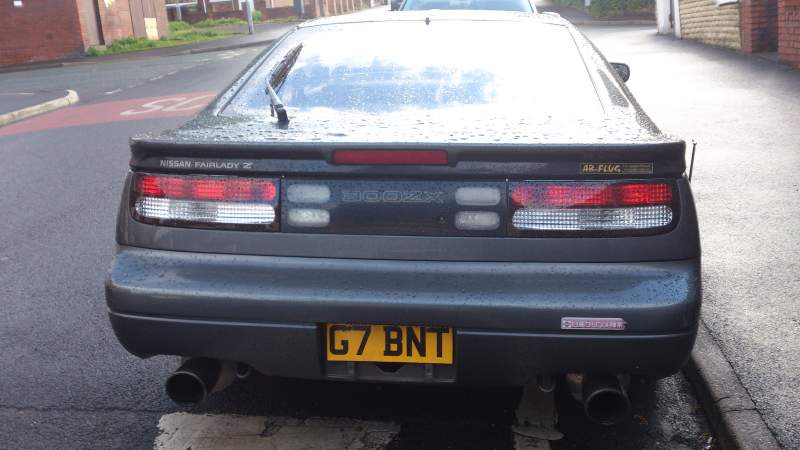

new license plate on. :biggrin: had to cut the back plates to fit, contemplating doing the same to the front.
don't like the square shape rear plates.

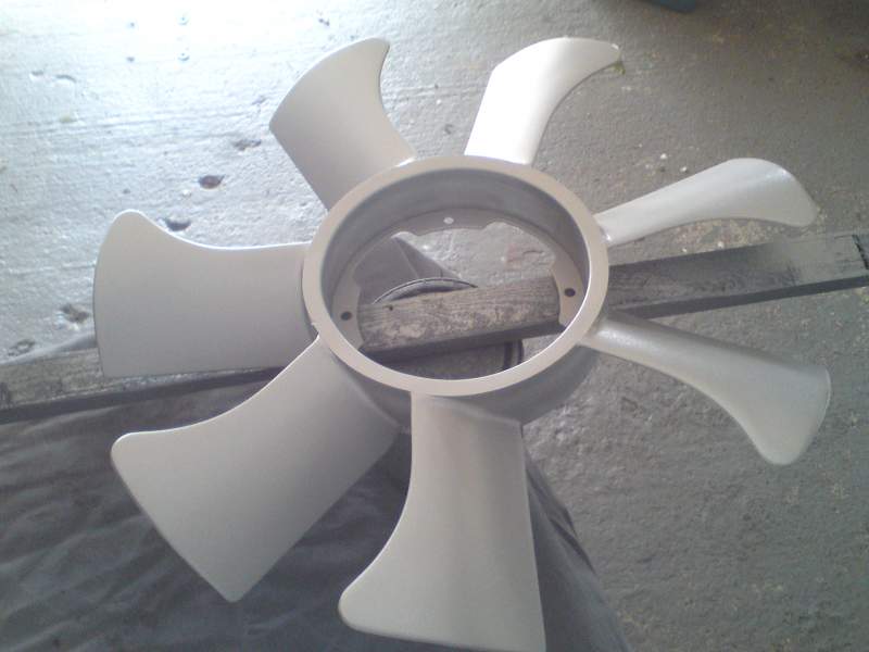

Took the viscous fan off, gave it a damn good wash with a brillo back to milky white, primed and then sexy silvered up, just need a few coats of lacquer tomorrow and then re fit :thumbup1:.
Why though 7 fins - a group of 3 and a group of 4, clearly not equally spaced :confused1:.
