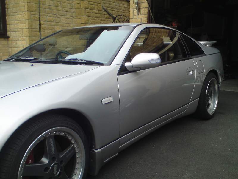

Fit my mirrors and got closure in this area as the door cards are all back together and I have lit what I wanted to light up, these mirrors now have indicators, auto fold, adjust and are heated :thumbup1:.
All my indicators are yellow and match very well as opposed to some of the led bulbs being more of an amber colour, look very nice especially at night when all is a blinking, the new mirror indication can be seen perfectly during daytime as well.

That looks the biz mate. :thumbup1:
They do look great Andy, could pass for factory mirrors.

The goal all along was to achieve the factory mirror look, I took great care with the 'slot' cutting out with different dremel attachments and then used needle files where necessary.

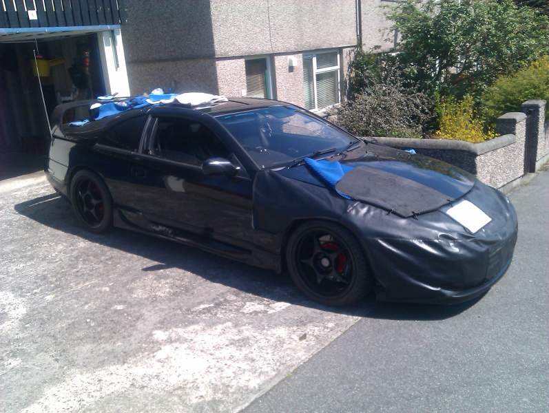

Ive got pics of the sprayed panels ive done that i want to show but there on my phone and i dont know how to get them off lol!!!
Its looking nice though. i could of spent 3k on a spray job and it wouldnt look any better :)

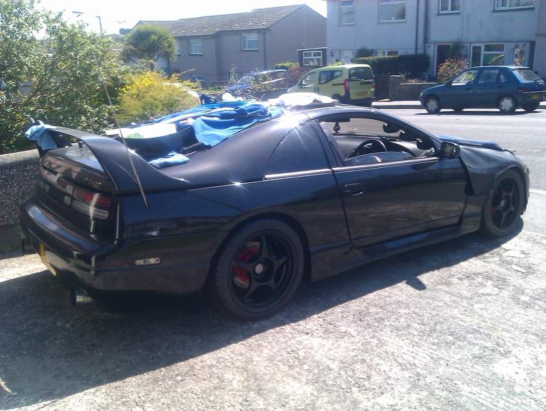

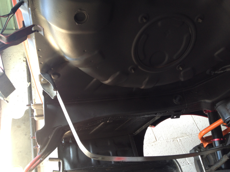

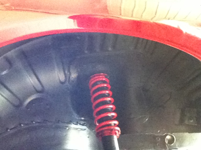

done loads today. took the rear hatch off. took the glass out and found horrible rust starting to develop where the window sits. so sanded the whole edge down to bare metal and treated. once dry i then painted on some hammerite smooth just incase. then when that had dryed i sprayed the hatch and spoiler :)
Ive modded my door handles so now the keyring lights up and a hiden led behind the door grab so it all lights up when you unlock your car. ive also put down lights in my wing mirrors to light up the floor at night when the car is unlocked :cool3:

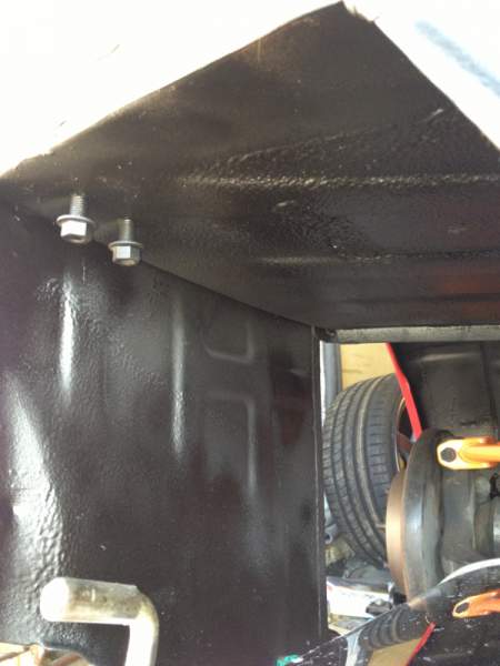

Also lol!!! ive 100% finished off the passenger rear arch. finally got paint on it and it looks 100% mint. all the lines are perfect and no horrible dips or ripples so all the refections are spot on which i was worried about.
Just got ones more to do which will be easy and the rear bumper then the rebuild begins :dance:

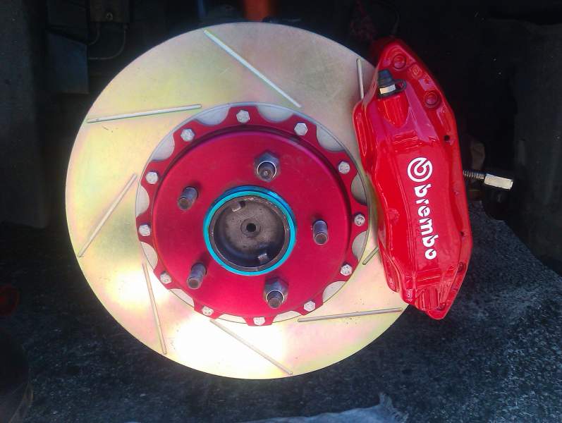

mine came out the garage today for the first time in over a year! hooked up the battery turned it over a few times with the fuel pump fuse out to get the oil moving and she fired up first time once fuse was back in place!:clap: gotta get the centre's off the brake disc's powdercoated same colour as Brembo calipers now! :yes:
