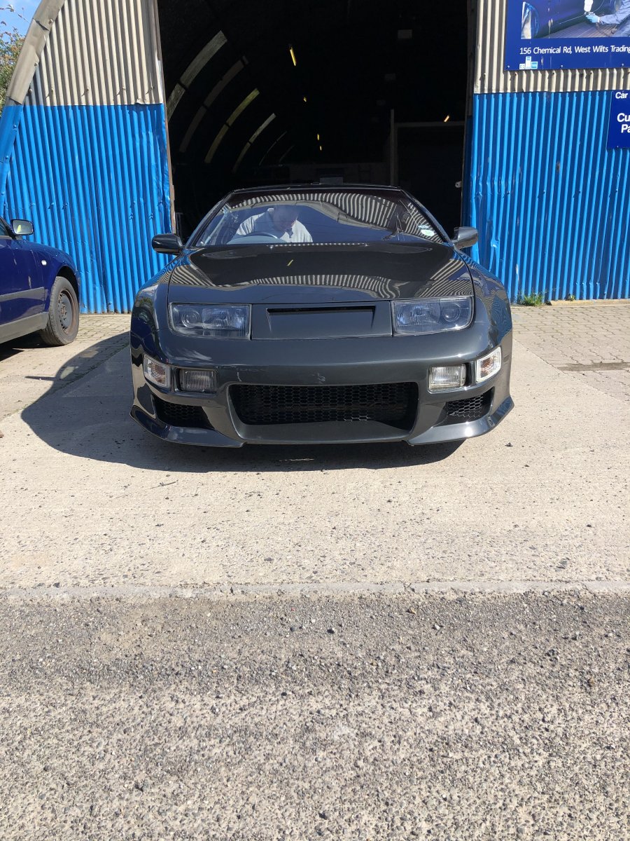

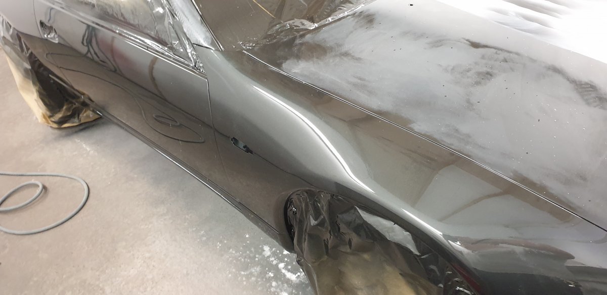

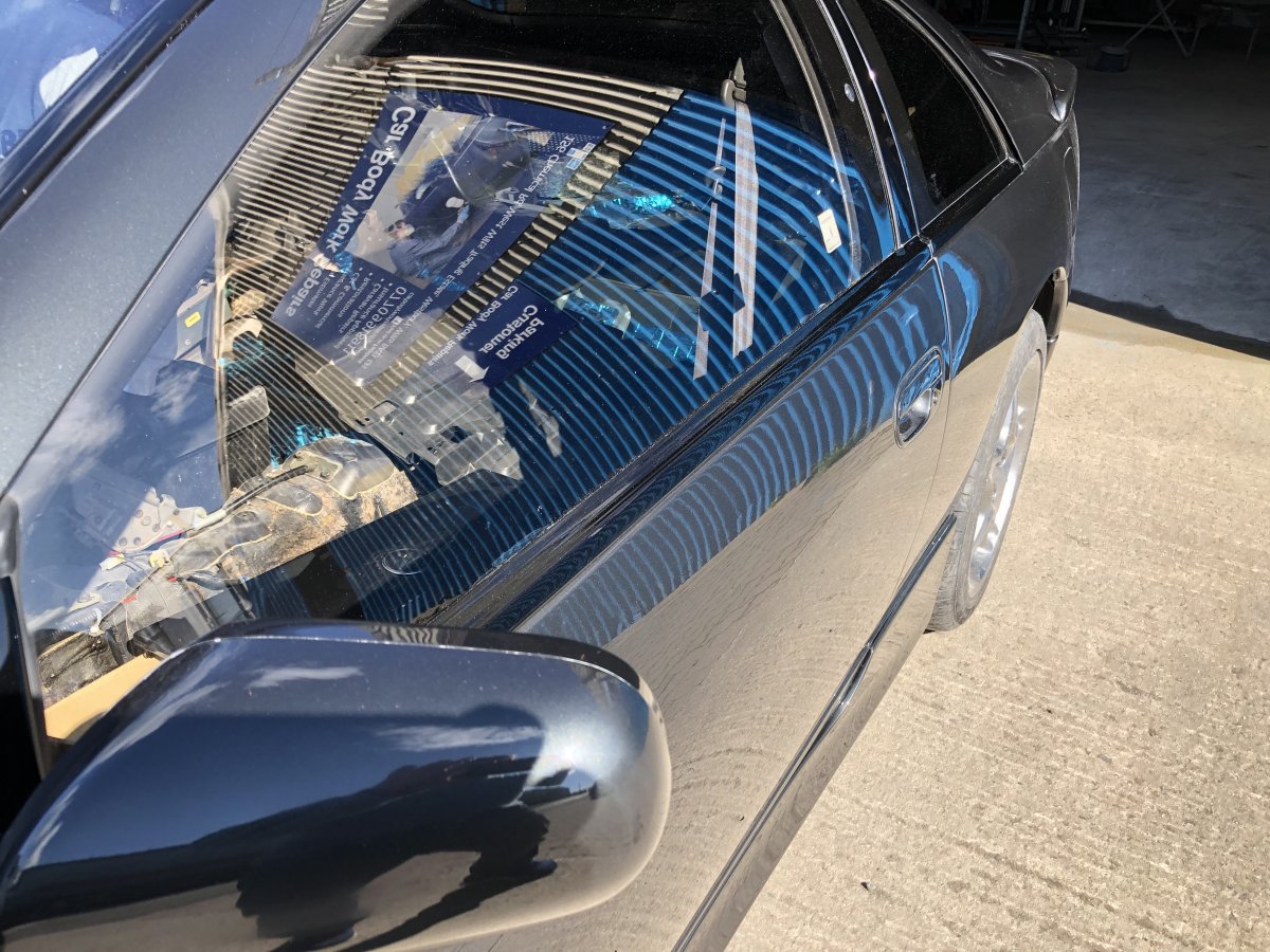

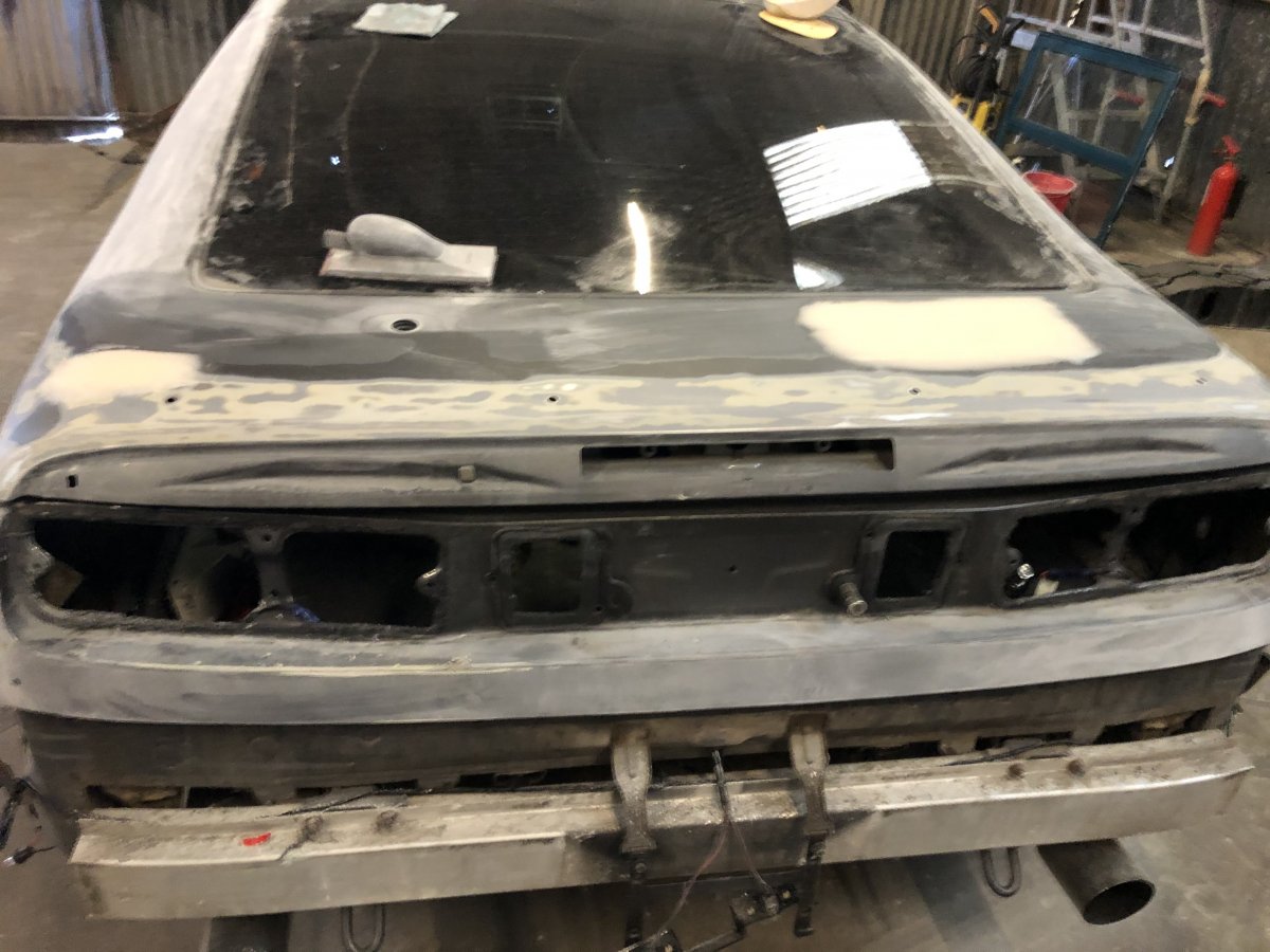

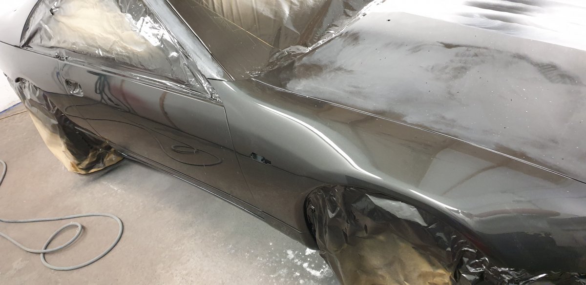

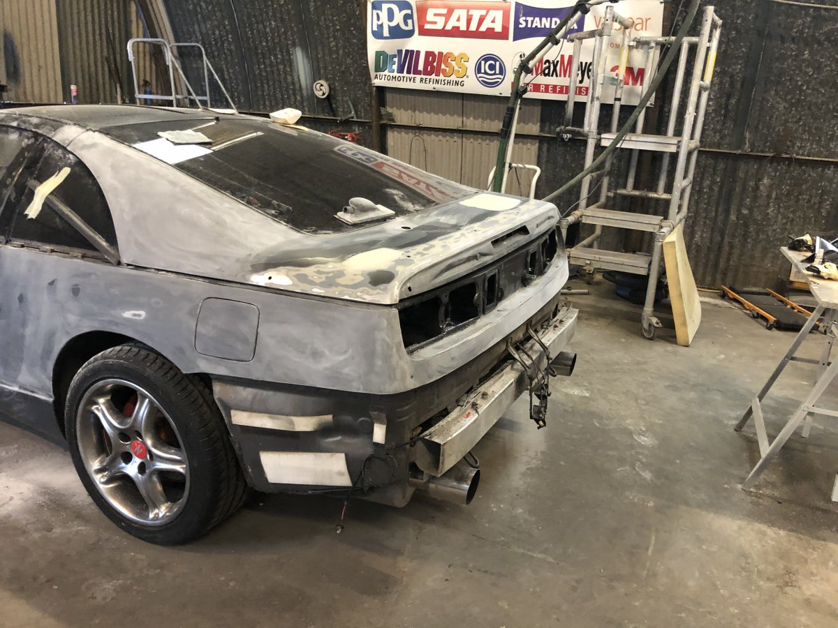

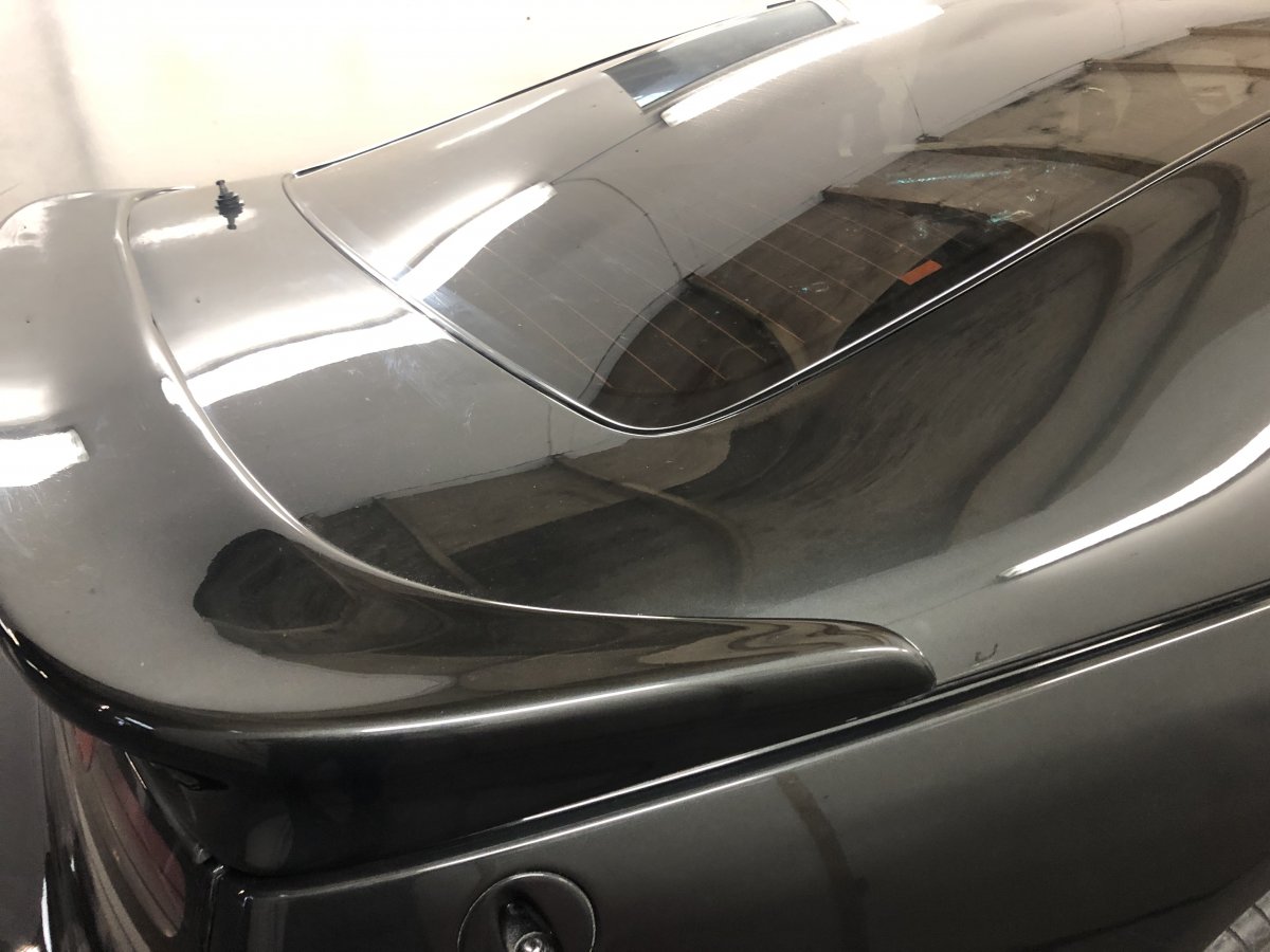

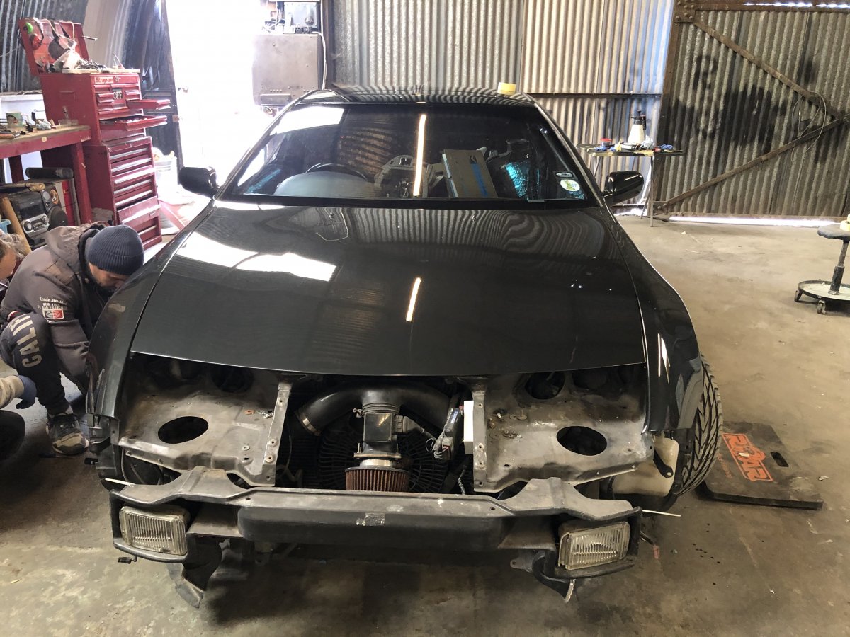

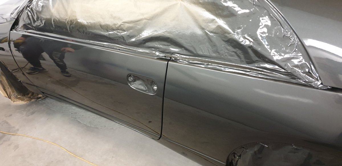

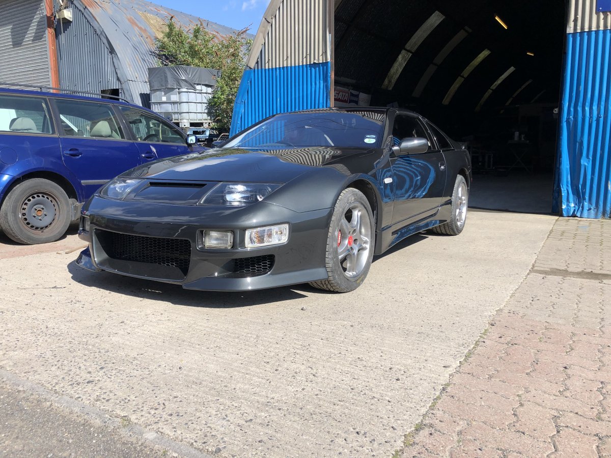

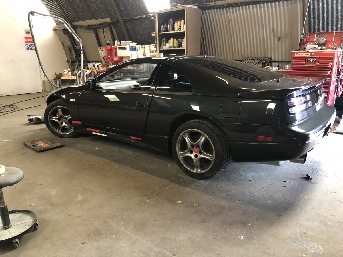

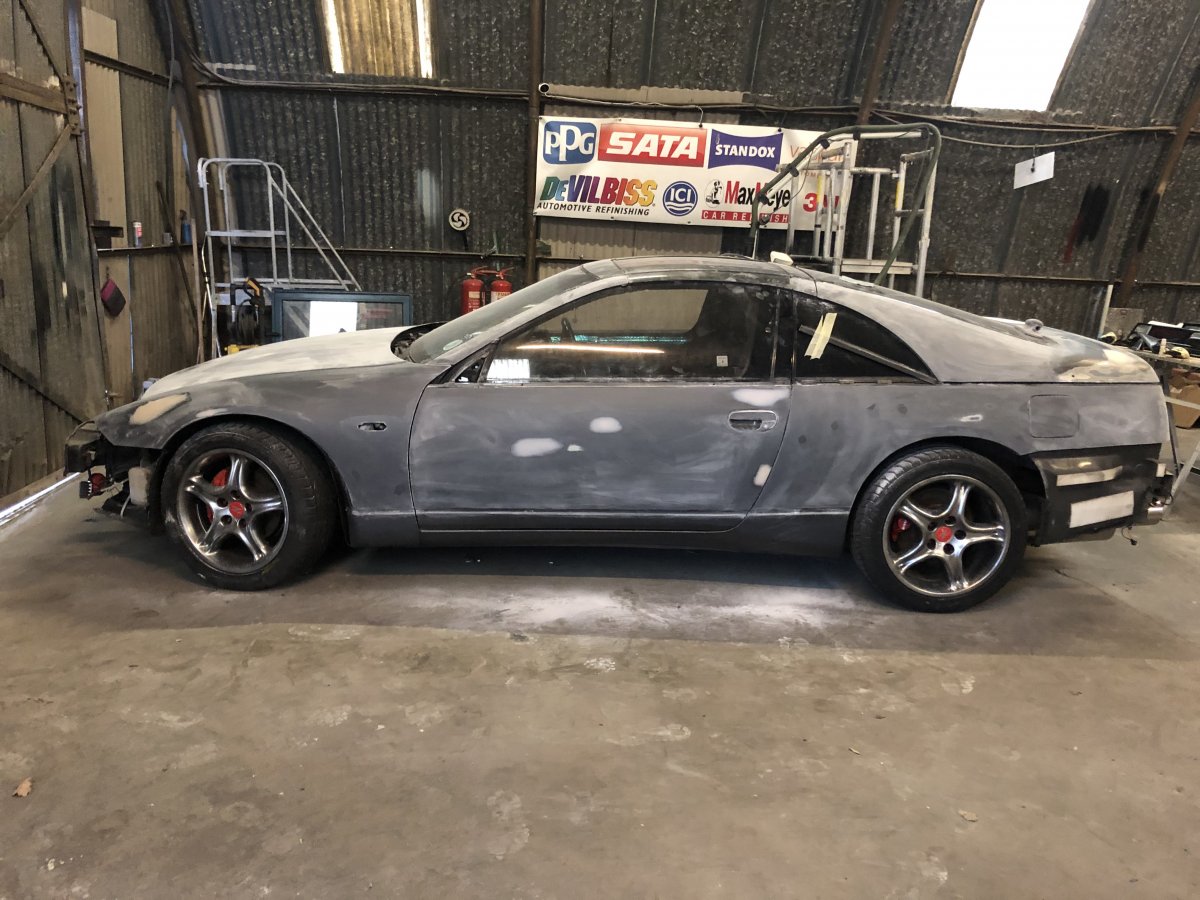

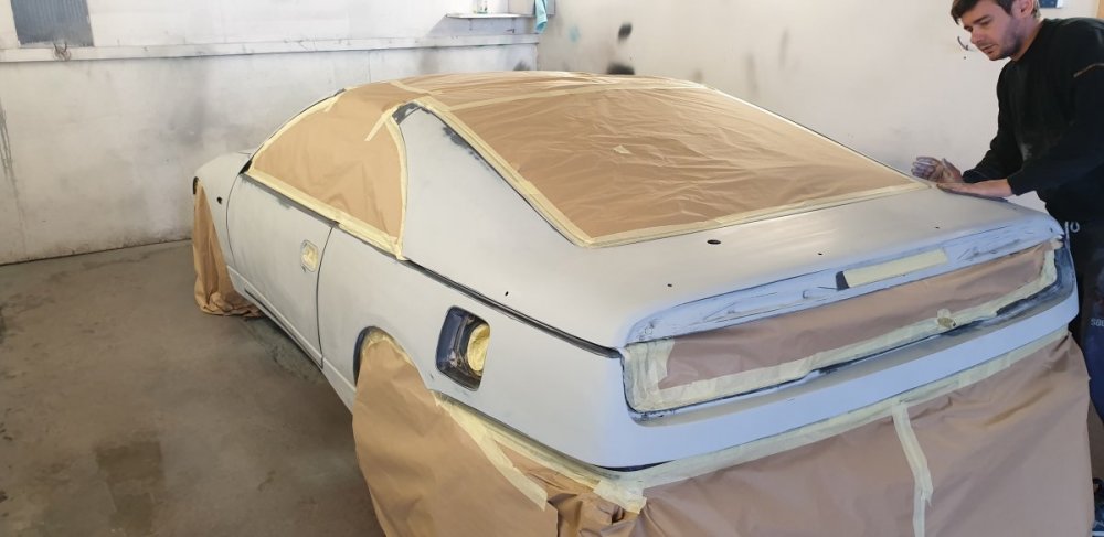

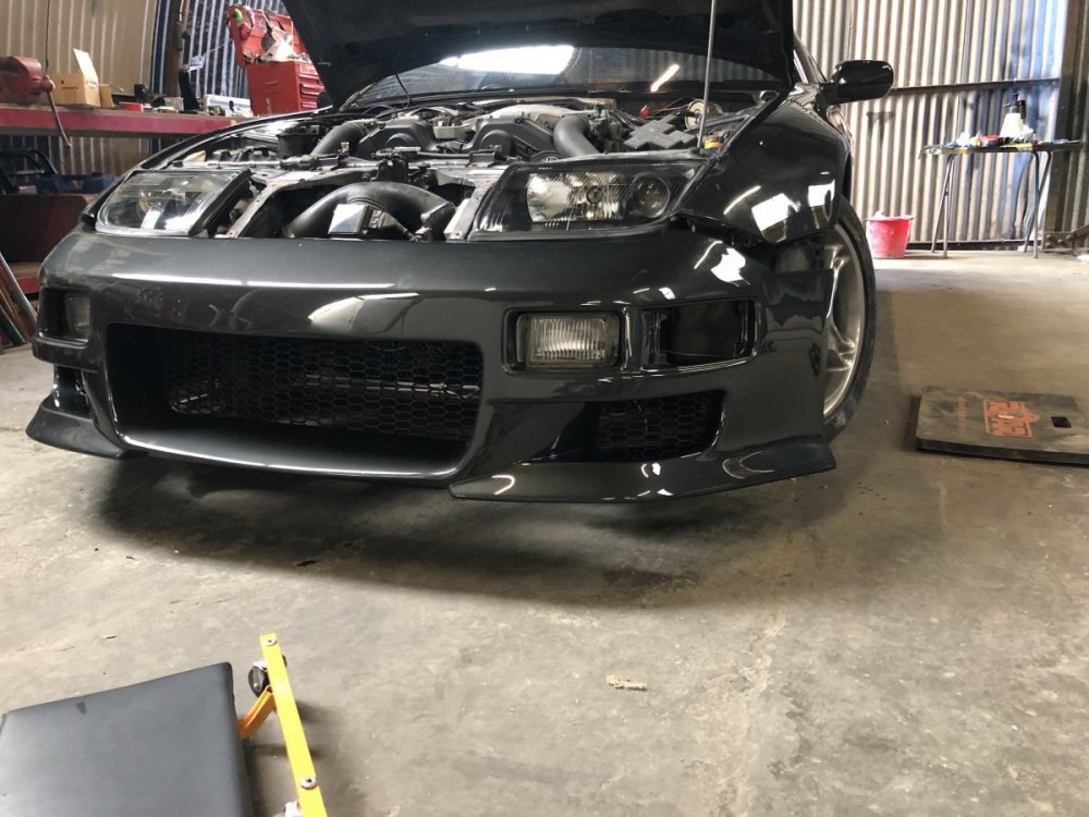

  1. After owning this car for 4 years, things have certainly moved on in the last few months. Firstly, just before lock down, I went up and collected my interior from Si (this is now sat in my front room all covered up waiting to be fitted. Still have some wiring bits to finish off first. I then decided I could not put such a lovely interior into a car that needed so much TLC, so pulled the trigger and had it resprayed. The colour choice was long and exhausting, going from all the solid greys that are so in at the moment, to a Porsche chalk and even avalanche grey. I have watched here and seen other's pain trying to decide on a colour that compliments the cars natural lines and also excites you when you see it. I eventually decide to stay with the original colour pallet "ish" but lift it little and give it more modern "j'en n'a sa que", a more OEM plus shall we say. Well I guess you guys will be able to say if I have got it right :). It is so much more in person (like a lot of colours I guess). Every time I go back to look at it, I think yep nailed it haha

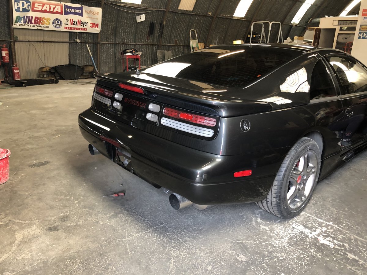

  2. Can’t wait mate tbh. It has been such a long time with it sat on the drive and getting wet and grimy. I think I have washed it more times than the number of miles I have driven in the last two years with her. But I am building a garage so when she is back from paint she will be under cover. will need MOT and exhaust sorting (as I don’t want the large bore exit anymore, a more refined quad exit is required) then a trip to Jimmer for a health check before she is allowed on the open road. Happy but expensive times. ?

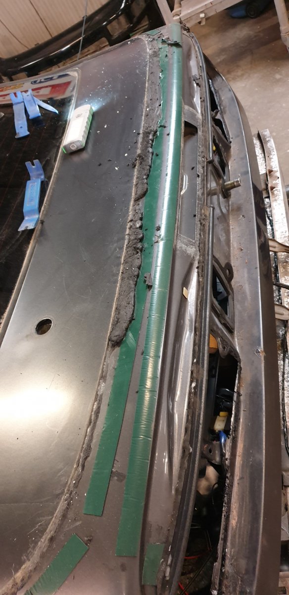

  6. As I am going to have the car resprayed soon I am Interested to know what seals/rubbers etc that are needed when refitting / replacing windscreen and rear tailgate glass and where the best place to get them all from? thank you in advance

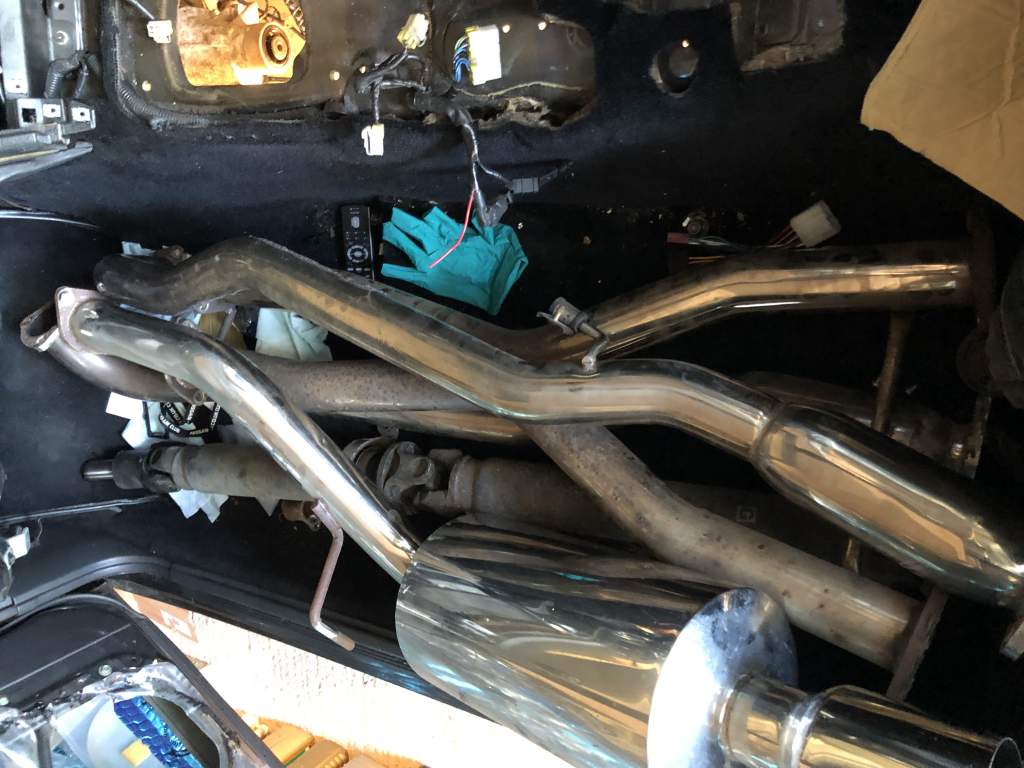

  8. Exhaust is back on all started and a quick drive sounded as if it was going to stall and a bit like a track car. Removed the loop back vac line from the balance bar and ran fine so I am guessing that this vac line that I removed from the AIV system relay that also goes back to a point on the block needs to be either re connected too as it was or blanked off. Thoughts?

  12. Next episode fitted the prop shaft jumped the auto start relay and went for a quick start.... yep it was a bit loud without exhaust but it did start quick to turn off as there is no clutch fluid or gear box oil just wanted to check the start. Next question is I removed the AIV system when I changed the exhaust and removed most of the bits but left the relay and looped the vac lines. The question is can I remove the relay remove the connector and loop the vac line from the balance bar to the pipe under the wiring on the drivers side plenum? Thanks again

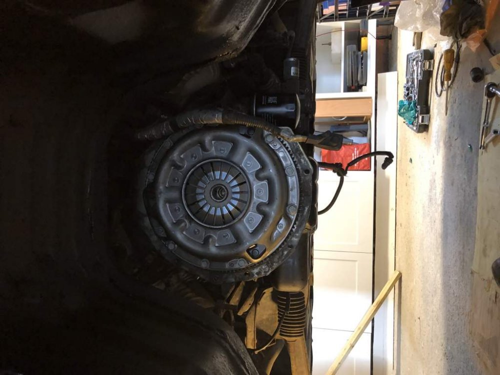

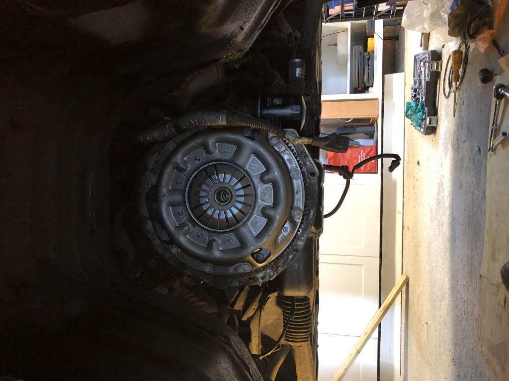

  14. Hi gents An update, the flywheel fitted and torqued with the new £13 bolt from Nissan, clutch and pressure plate on and torqued. With the help of piece of wood a jack and a bit of a wiggle gearbox was mounted all bolts accessed around the bell housing and secured “torqued”. Last night replaced the gearbox rear seal and wires in the reverse switch along with removing the redundant two left in the engine bay. Also fitted the speed sensor and just wanted to confirm with the experts here if I have fitted the correct one. I have an n/a and fitting a manual box from a TT the car obviously has the n/a rear diff, so am I correct that the gear box should have an n/a speed sensor due to the rear diff ? Progress is steady hopefully finish wiring tonight maybe a start, might be a bit noisy with no exhaust haha.

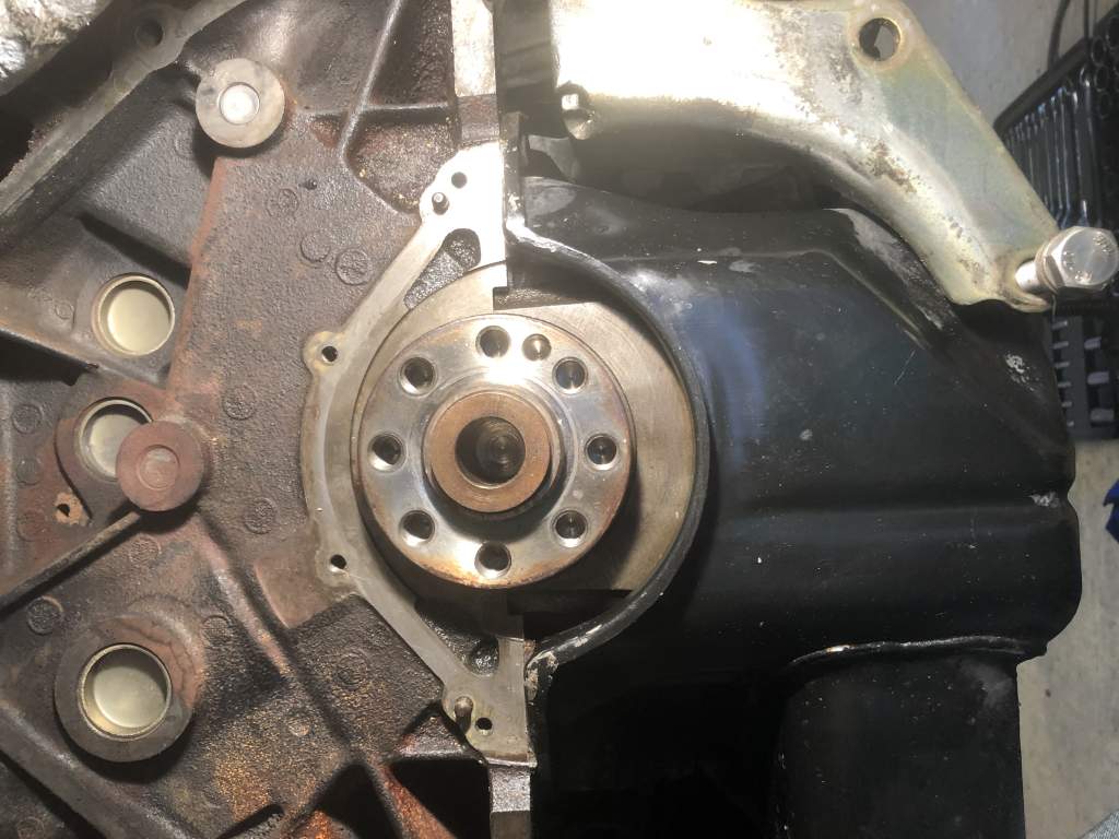

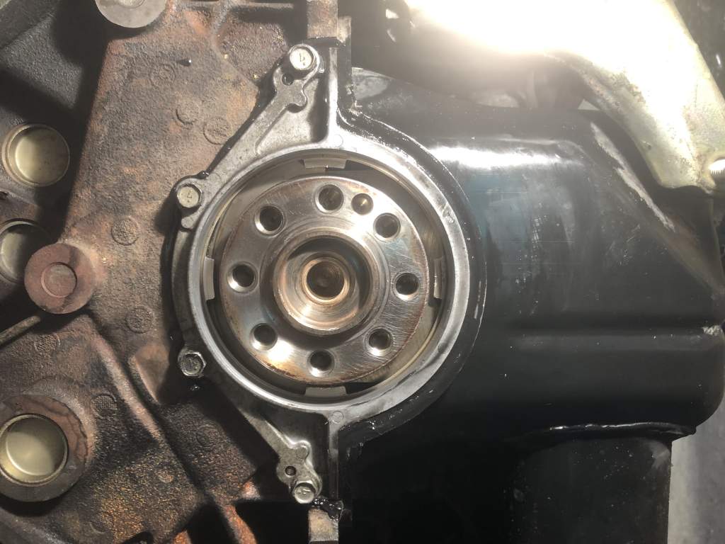

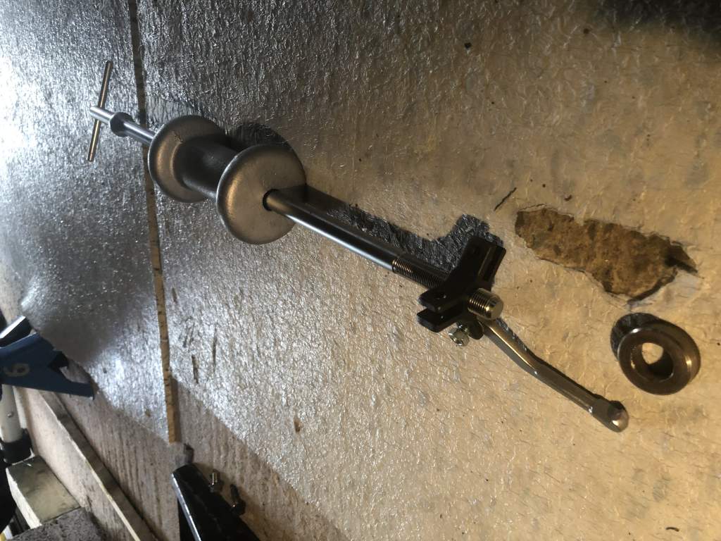

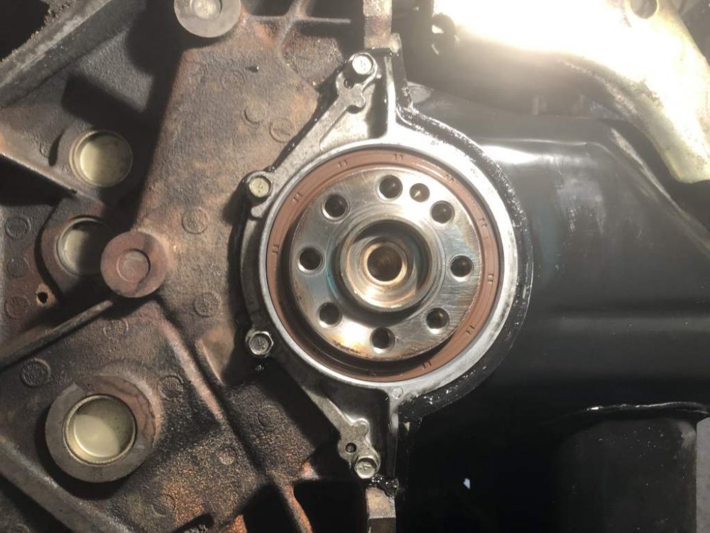

  17. Well remove the main seal retainer cleaned it all up used high temp rtv sealant refitted and replaced the main seal. All went well. Also removed the auto pilot bush with a nice slide hammer and hook, came out pretty easy with several hard bangs. Then fitted the new manual pilot bush with a few careful taps with hammer and wood.

  20. Cheers Jeff haven't removed it yet, but looking at the residue around it thought that it might be leaking a bit from round the retainer
  21. So the question for the day is after removing the main seal retainer do I either buy the paper gasket (Nissan backorder 6-8 weeks) from Z centre or just use gasket sealer? Also if i use the sealer do i need to go all the way around the retainer with it or just where the paper gasket sits? I know some of you have done this so your advise and experience would be welcome thank you.

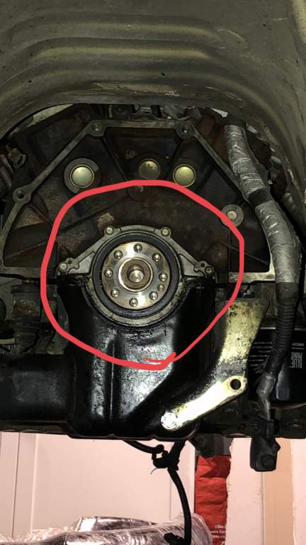

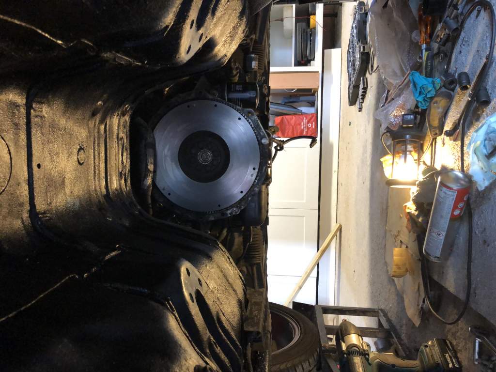

  22. Yep all done there was a plate on the passenger side of the block that when removed gave me access to the four bolts holding on the torque limiter. Then the eight bolts and the flywheel was off. Going to replace the main seal behind the flywheel. Any suggestions how that comes out? Looks like a plate above it but not sure if that comes off before hooking out the seal?
