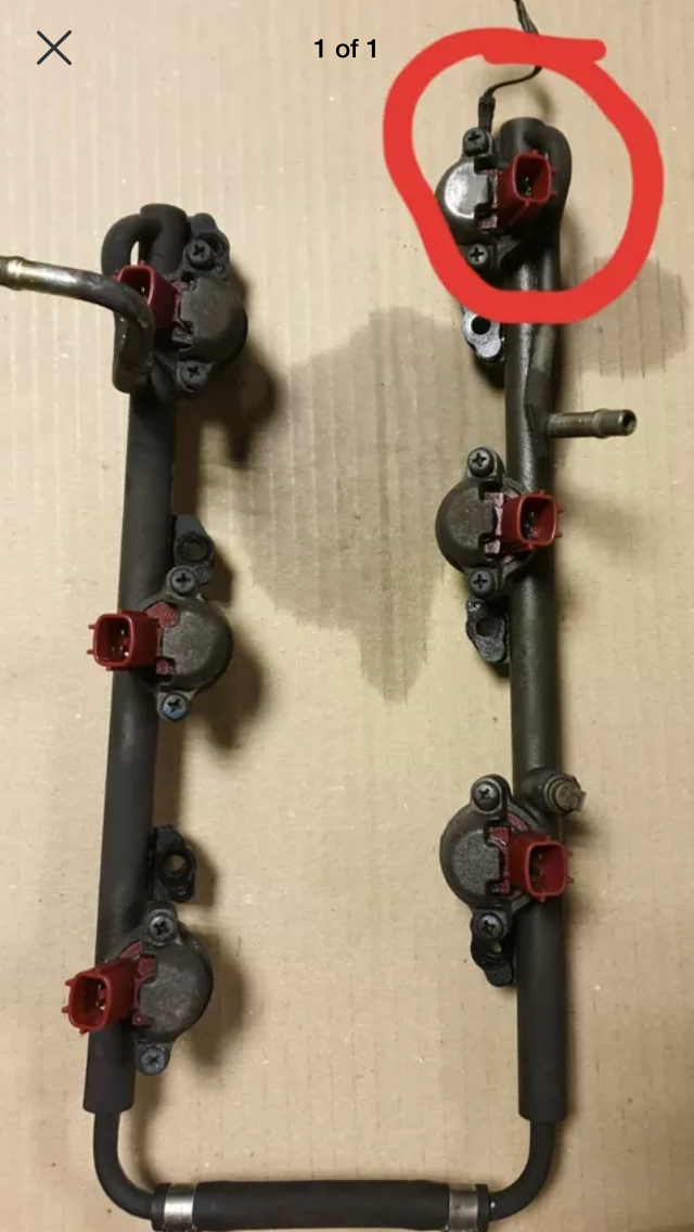

  13. So it is better to swap the injectors into an early fuel rail and use an adaptor kit? I am getting confused with it now.
  14. Thanks.I will not need the adapter as the injectors come in a fuel rail already. I am just wondering if new style fuel rail will drop in to lower manifold that was mated to early fuel rail. Would the rubber gaskets at the lower manifold differ?
  15. I will be dropping in new style injectors in place of old style. I am getting them with a whole oem fuel rail. Do i need the lower intake manifold aswell? I cant seem to find any information that i do. Is there anything else i need to get apart from new plugs?

  18. Hi, i am looking for a good used standard injector early style for NA. Let me know if you have any. Thanks.

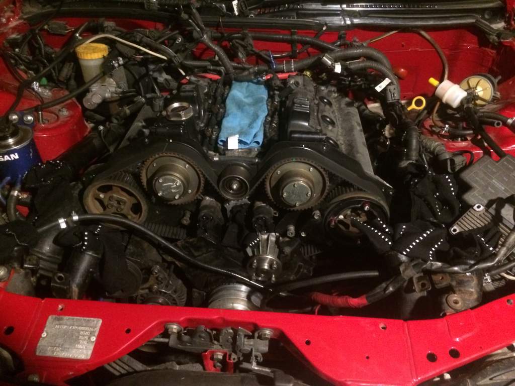

  19. Thanks for help everyone. What a f... job it is to get the heads off with engine in. Fingers and arms all scratched up to armpits... driver side is off. Looks like bad workmanship caused the problem. Head bolts have been reused. Might not have been torqued properly. 2 came off with little to none struggle. So i take it the head just lifted a bit with some boost. Found leak marks from two water ports on cylinder three and one water port on cylinder 5. Passenger side head still to come off. Nothing seems to be damaged so new gaskets and new bolts and will be good to go again. Any trade secrets on how to pull a dipstick tube?

  23. Thanks for the tip., unfortunately i do not have the space or the equipment to remove the engine. Managed to get the belt off and did not destroy anything. Very stressful experiance. I have done the belt before with locking kits.
  24. Really short progress. Was sitting all this time in the garage. Managed to get a couple spare hours this weekend. Radiator out, plenum off. Cambelt coming off hopwfully today. Then heads will come off. Question. How do i drain coolant from the block? Risk snapping a bolt on the block or is there a hole i can stick a hose with a vacuum pump on it?
