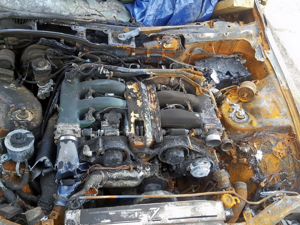

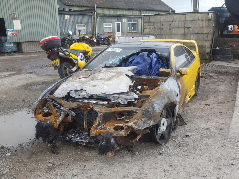

And another dead Z
I would say fuel lines at filter and then dripped on hot turbo.
Fuel line leaking from the fuel filter.
I agree - quite alarming as mine was doing this for about a week before i realised what it was and sorted it [emoji50]
