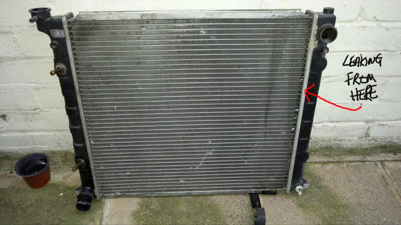

  18. I know how you feel, mate. My 1992 TT bought 1 mth ago has done that twice already!! 1st time was the rad, today it was at the rear/top engine bay. it waited until halfords/eurocarparts etc were all closed before splitting. had to temp fix with rubber patch and hoseclip as I was lucky i had enough hose to cut down to the split. We appear to have the same decision to make....change out the whole bloody lot as we'll never really feel comfortable knowing another can go at any time, anywhere... But at £16. each??:censored:

  21. OK. New rad ready to go in, here's the plan. Fit new rad, connect hoses, etc.... Now Ive checked the forums re: airlocks, with lots of advice re: auxillary bits, BUT.. the last post i read suggested that as the car front is up on ramps, rear on ground, I can just refill with 70/30 glycol mix, run and check every 20 mins or so, with heater on 40deg, and top up as required, right ?:rockon: Also, while I'm at it, is there a way to flush out the system BEFORE i put the new rad on?:no: don't want old shite in the new one, I'm thinking.....
