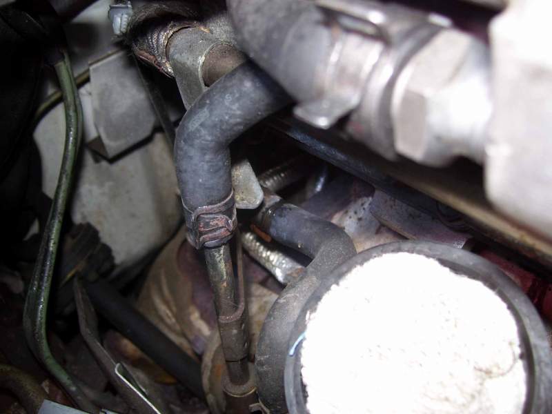

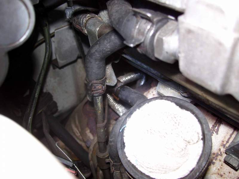

After an hour or so, I think I have tracked down the culprit!
Not 100% sure, but I think these must be the 2 pipes supplying cooling to the turbo as Mark eluded to earlier.
If so, I am hoping that I may be able to cut it back slightly and re fit for now. I will take it off though and check it all over just to be sure.
I will add photo's in a mo.

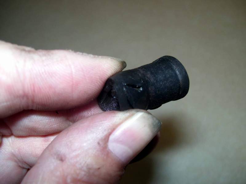

It's OFF!!
mind you, I did have to cut it close to the clip so as to allow me to get my curved long nosed pliers in.
Also had to remove a couple of more bits so as to gain access.
Although it is in 2 pieces now, you can still see the splits.
It's OFF!!

Pop to machine mart and get yourself the pack of 3 12" needle nose pliers. There's so useful for this kind of thing. Check what it connects to and if possible replace the whole section...if it split once...see what I'm saying?
