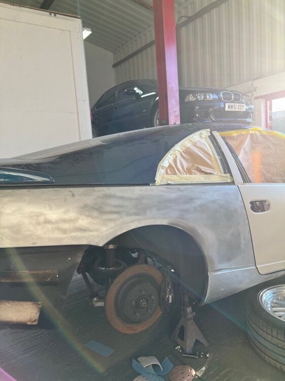

  17. After the front and rear windscreens were removed, off comes the boot and front pillars/roof paint. Note the targa drain was capped off and removed when they blew all the dust off. Some rust was found hiding under one of the seals [emoji50]. I’m glad I’ll finally be able to store her indoors hopefully from this summer, to prevent that ever happening again. Sent from my iPhone using Tapatalk

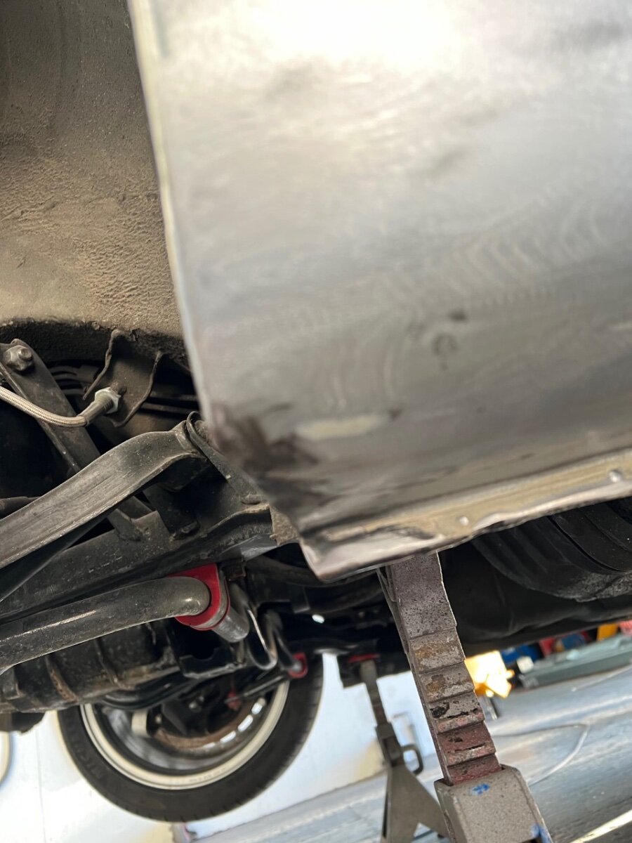

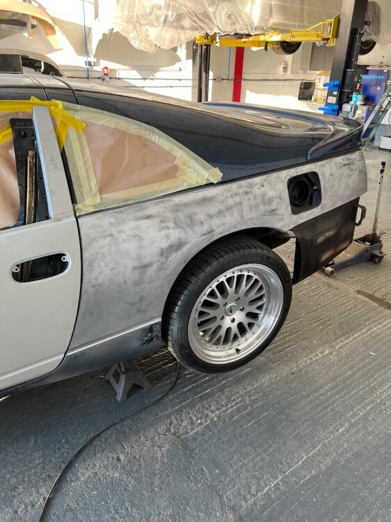

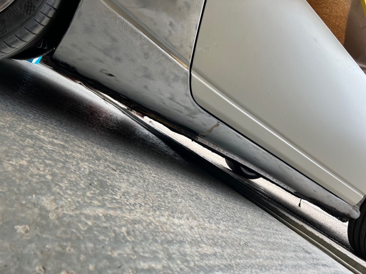

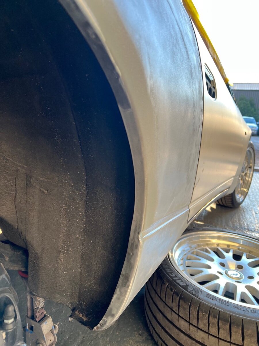

  25. Rear quarter windows have been removed. Front and rear windscreens being removed this weekend - was due to be completed last weekend but the glass remover ran out of time! As you can see, rear quarter panels now stripped right down. Small bit of surface rust on the sills, the drivers side rear bumper support panel and two small sections in the engine bay which will all be sorted. All areas that I was aware of rust presence, so no surprises thankfully. Overall they said the shell is very clean, which I expected to be honest, due to the previous owners. As mentioned before, I'd happily clear coat it now and leave it looking like a DeLorean ?.
