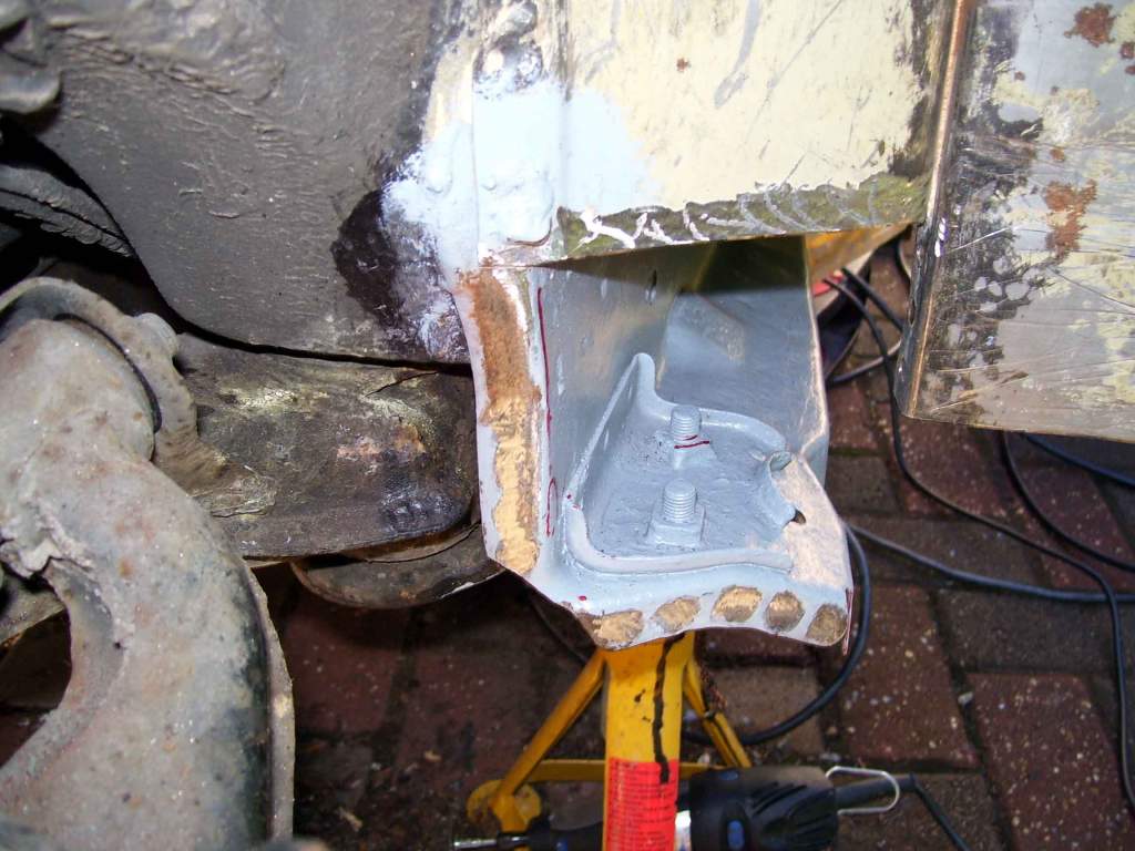

  1. Well after a couple of more hours loosely fitting everything up, I finally managed to start welding. First 3 seemed to go okay, if not slightly off center.

  4. I agree znut, :thumbup1: I guess I was just doing as much up front as possible in the hope of a replacement, but I think I will have to go with this one. I will heed your advice and clean away the paint locally on each weld point before I start welding. I know I will make a mess of the paint locally, but I am prepared for a tad of dressing and touching up post welding. Just did not fancy finish spraying the whole thing in situ either, not with my history of overspray. :blushing:

  9. Decided to finish off the repair as I have almost given up on a replacement. Just hope that my welds are strong enough.

  14. Don't get too excited, but I will be welding tomorrow. Only my set-up piece mind, just want to be deadly sure of my setting before I make a start in earnest. Be patient guys, it'll be worth the wait I promise. I will have to stop procrastinating sooner or later.

  17. I understand your frustration mate, I am so close it is untrue. I think it is the uncertainty of whether I will secure a replacement or not that's holding me back. That said though, I have been prepping all of the spot welds by way of grinding back to bare metal in readiness to fire up the mig. Hopefully soon. May do some practise welds tomorrow. Your are welcome to join me in a Stella by the way.

  19. Well that's me done for today guys, cheers.
