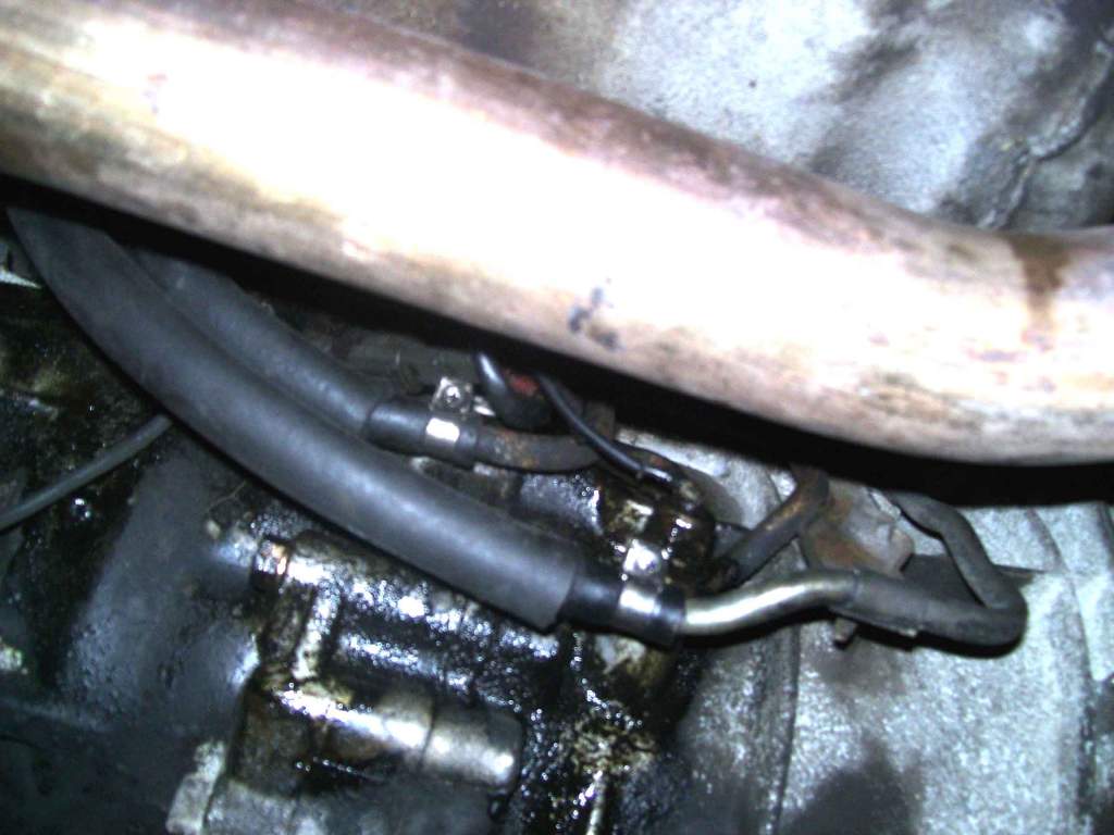

  1. Just discovered this whilst getter the car ready for Coventry! Leaking filler plug for gearbox? or something more sinister? Advice please.
