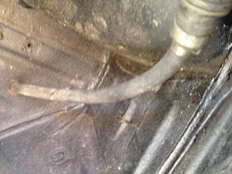

  4. Hi Chaps. Wondering what this pipe is please. Passenger front wheel well, comes from behind the front bumper area and goes what seems to be into the frame rail. Its a dead end pipe with just a slit opening on the end of it. Is it from the carbon canister vent? Just doing a bit of tidying up. Fully removed all AIV and PRVR components. Thanks...
