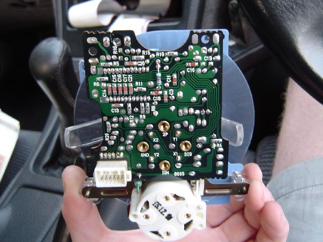

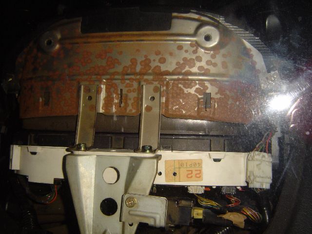

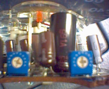

  15. Ok, the last bits... 5 attached pics showing: 1 The dial-side of the speedo PCB. The small area in the middle where it says "R10" next to a squiggle is where the old resistor was. Note the artistic new curve incorporated into the speedo dial on the right... :( 2 The rear of the speedo PCB. Near the top, in the middle, you can see the new light-blue resistor which I found was much easier to mount on the rear, but then I'm no soldering expert (which explains the modification to the dial :x: ). 3 The location of the holes in the clock mounting. The scale pot is the one on the left as you look at it. 4 Ditto with the clock assembly in situ. 5 How it looked like from the dial side, with the screwdriver in tweaking position (NB scale pot is now the one on the right as you look at it). All tickety-boo :dance:

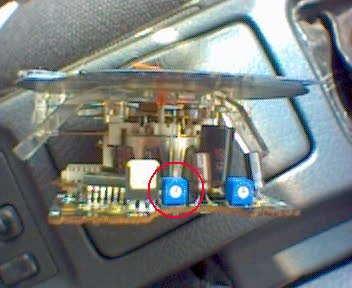

  16. LOL probably boring the pants of anyone else reading it all! :tongue: Ok, with reference to my earlier photo it's the one on the left that does the scale and the one on the right that (allegedly) does the offset. Attached are the 1000 words, with the scale pot circled.
  17. Ok. Rested a screwdriver in the scale pot and had a quick dash up and down the local A-road. My mate in the passenger seat read out GPS speed while I drove to the speedo and gave the screwdriver a twist as necessary. After 5 mins I had it so at 70mph the GPS speed would fluctuate between 69.0 and 69.5mph, so I'm happy with that. :dance: I didn't touch the other pot as I didn't need to, so I don't know for sure that it does the offset...

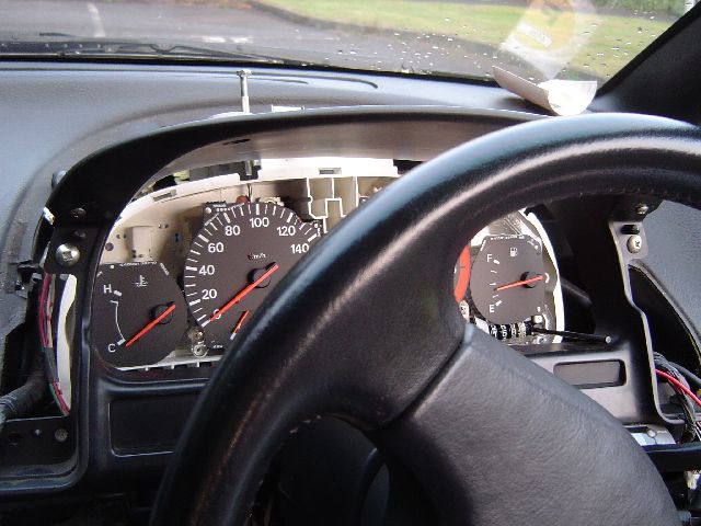

  18. If I were you I'd take the whole thing to bits- otherwise, to drill through the clock housing you'd need to take the windscreen out (bit excessive don't you think?! :rofl: ) Secondly if you leave the speedo module in situ there's the risk of damaging components when the bit pops through. Steve-o posted some good instructions on how to dismantle the binnacle. :bow: (and if you want to change the resistor you'll need to do this anyway) http://www.300zx.co.uk/forums/showpost.php?p=297744&postcount=3 I'd add a point: Step 5.5- it helps if you remove the panel under the steering wheel before step 6, as I hate unclipping things when you can't see what the state the clip's in! I'll go into the resistor change when I've taken some more pics...
