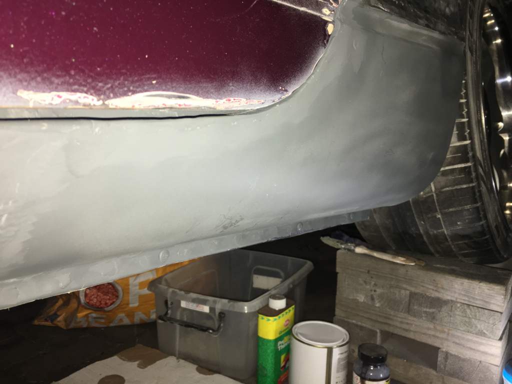

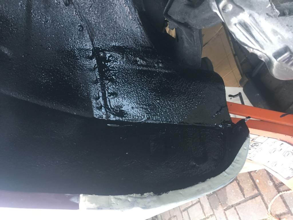

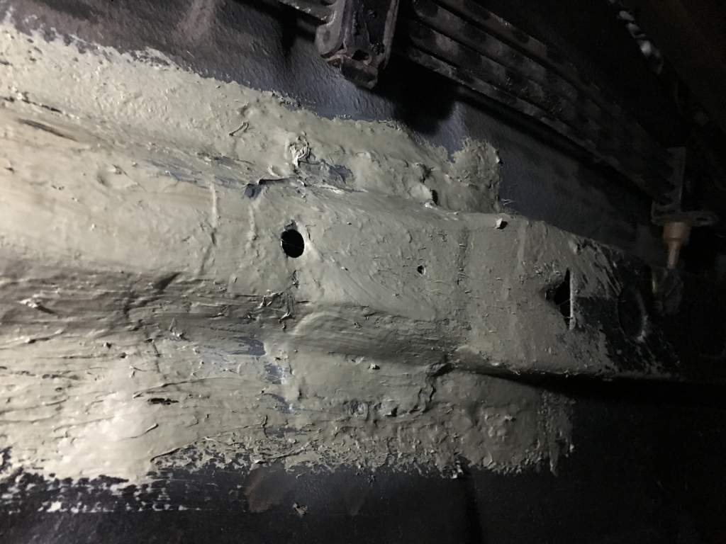

  20. Well after spending the day with the headache from hell..... I only managed to get the underside of the car full sealed with Tetroseal.... I'm going to try some more painkillers and then jack up the car ready to finish the final bit of welding tomorrow instead... Aiming for MOT this week and finish the bodywork over the next few weeks in a nice warm workshop.... As long as she is MOT'd I can get to and from the workshop to get the bodywork done..... rather than cold, wet and windy driveway!! Oh and I have joined a welding course to get qualified..... lol

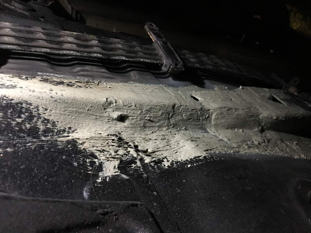

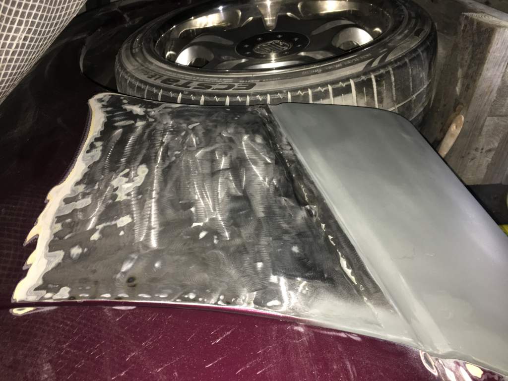

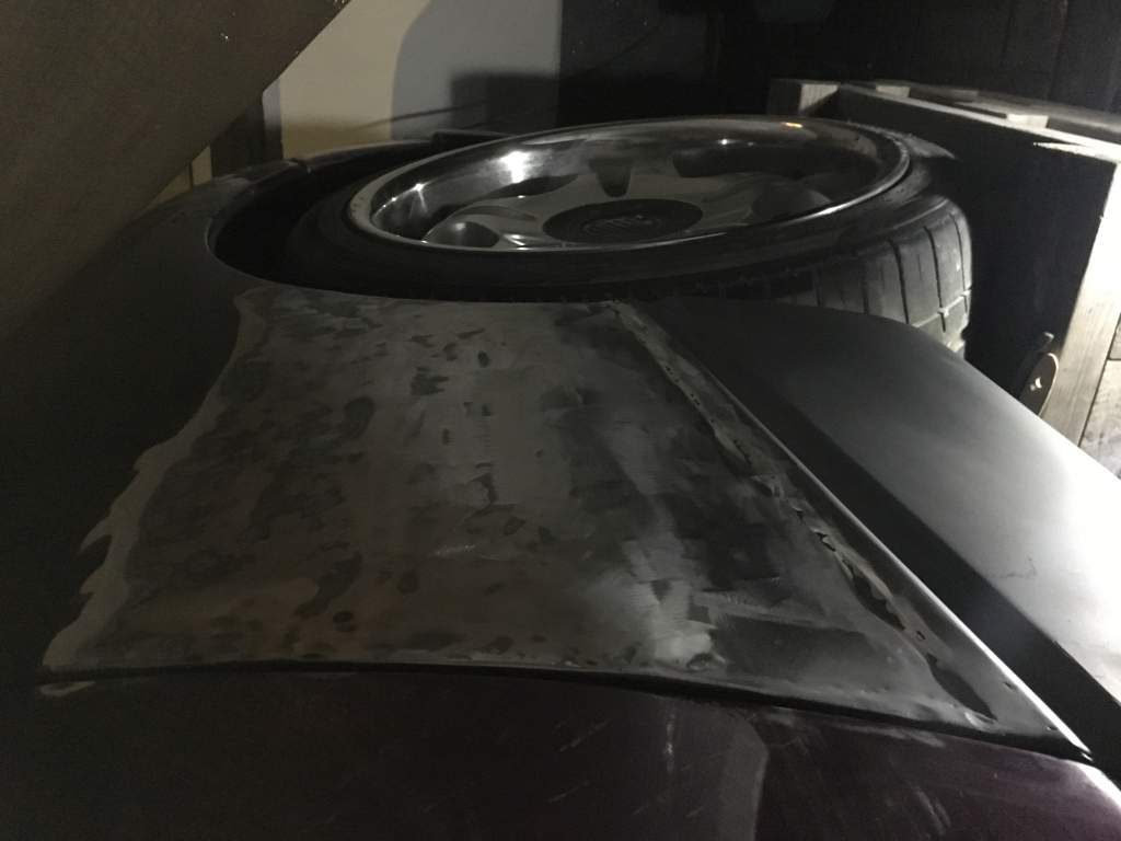

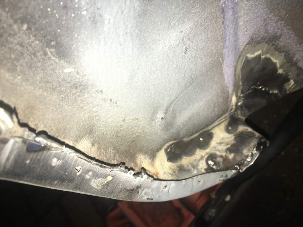

  21. A few pics of the end of today’s work..... Damn iPhone...... lol But you can see how thick the filler was on the rear quarter panel....... looks like it goes right up! The repair panel looks all dented, but it is the light and grey cold galvanising spray making it look bad.... lol

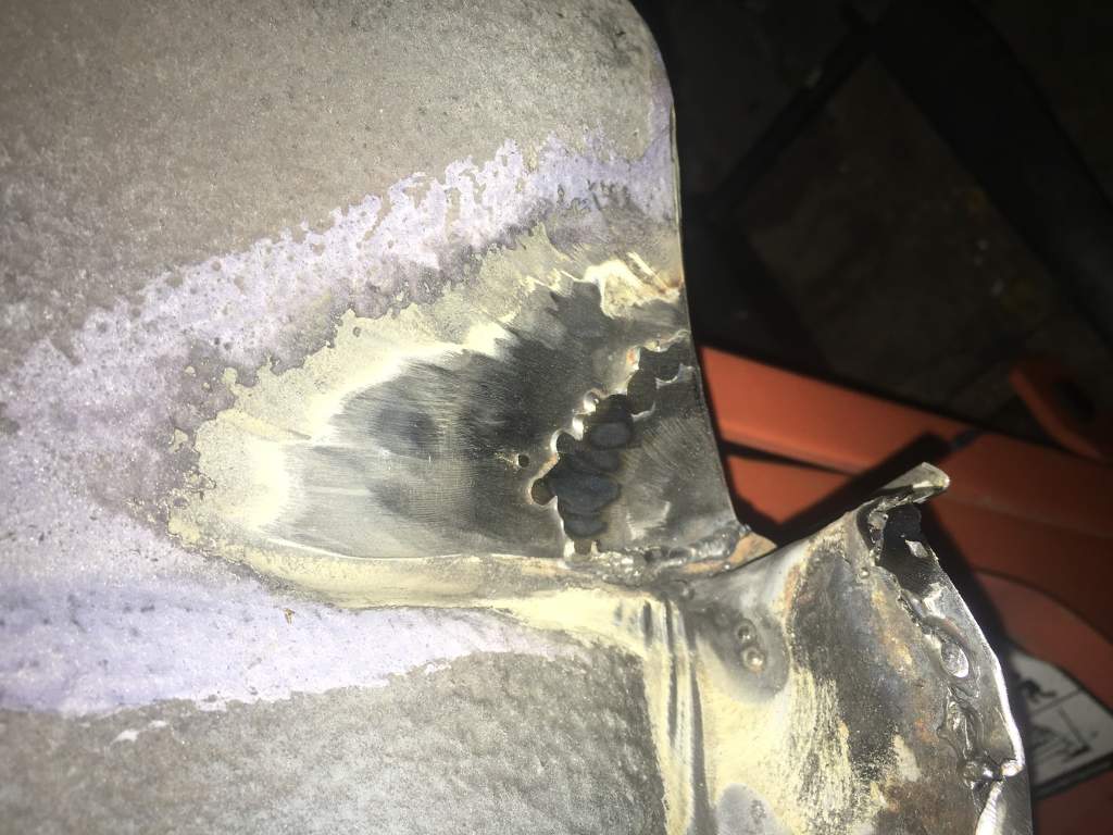

  22. Well today was quite productive..... 1) Removed kick plate, passenger seat and carpet (laid fire blanket above the area being welded), rear quarter interior panel, harness mounts. 2) Welded repair section across the chassis rail joint section (just behind passenger seat). Ground back welds. 3) Welded the final closing patch in the N/S sill.... Ground all welds back. So just inner rear arch to finish tomorrow. 4) Refitted all interior panels. 5) painted repaired sections with Cold galvanising spray. Tomorrow:- 1) Jack up rear end higher and remove wheel to access the inner arch to finish welding. 2) Seam seal the inner arch. 3) Spray the passenger side floor pan with underseal. 4) Strip all filler that remains from sill sections and rear quarter, back to bare metal ready to try lead loading....
