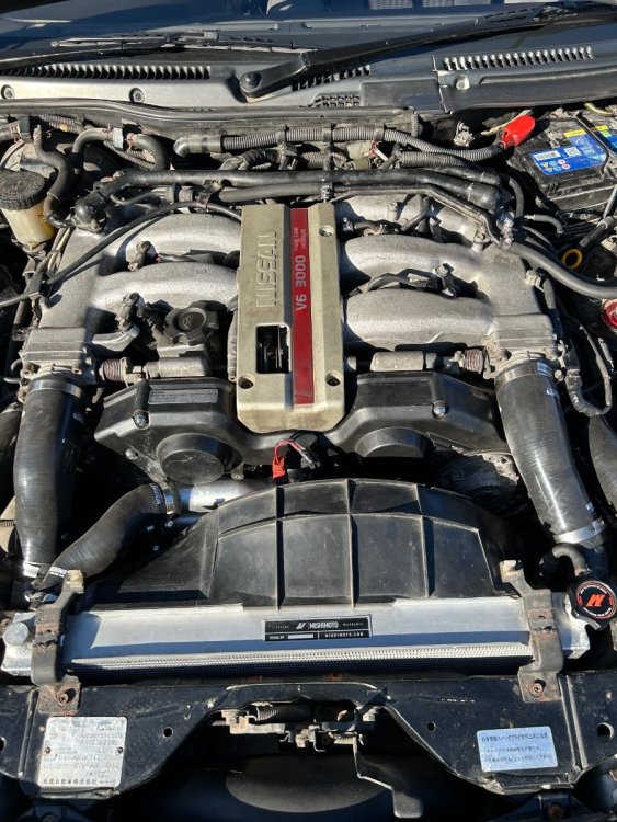

Engine is stock, although it has a Mishimoto radiator and an open cam cover so has obviously had some work done at some point. Also has some aftermarket HID’s I believe.

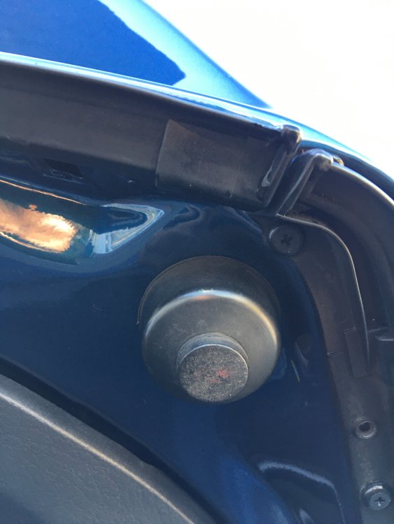

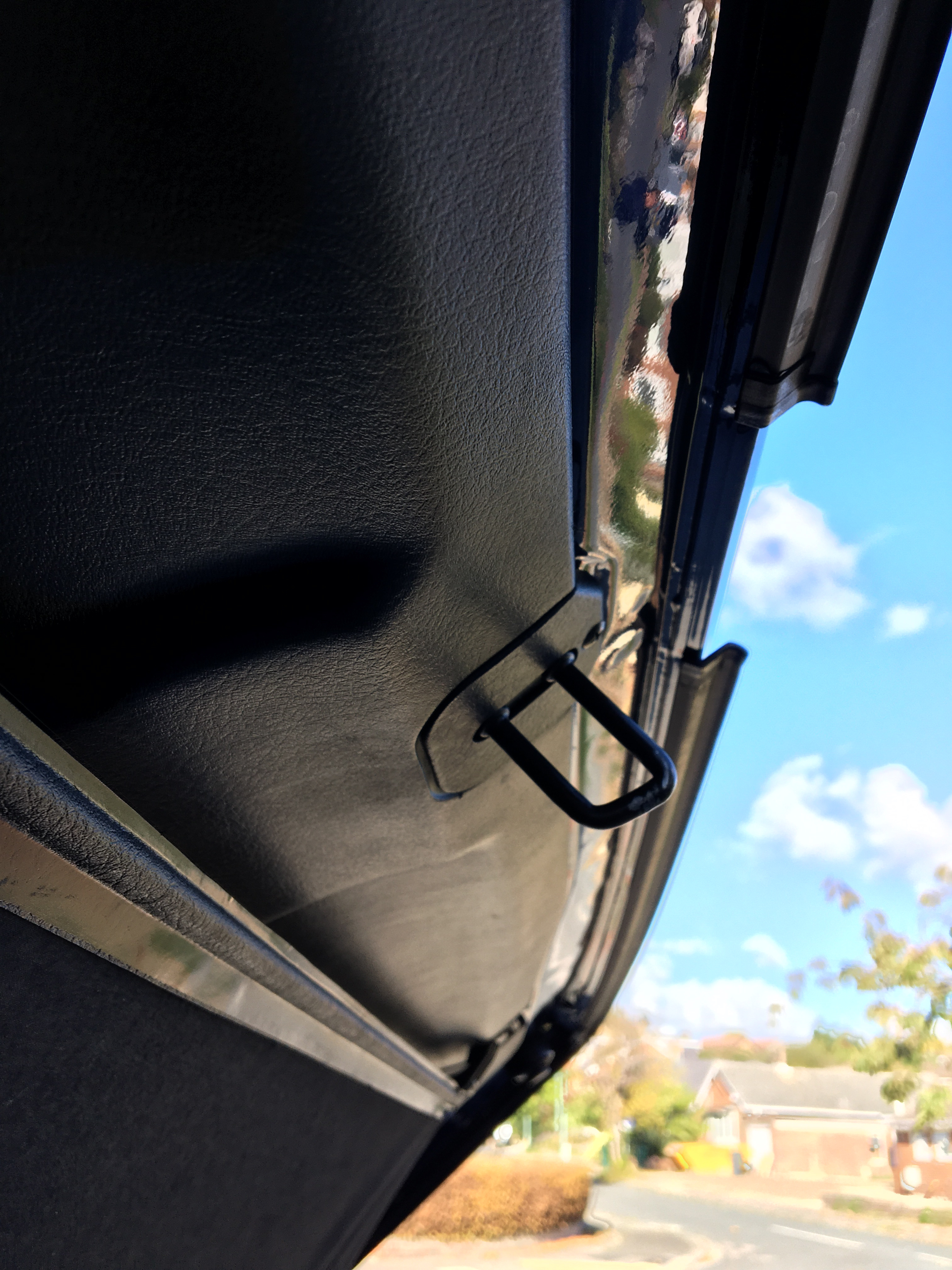

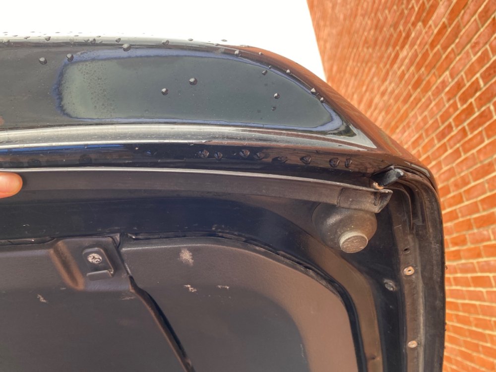

So here’s a question. Im missing some trim and have been putting it back on bit by bit, around the inside of the boot lid are a couple of strips I’ve got but I still feel like I’m missing something and not sure how to attach them.
Can anyone help me out here?
I’ll put up pictures of what I’ve got but there are still some holes where something else was clearly attached before
#1. 1993 Twin Turbo Manual LWB in black (2022 - 2024)
#2. 1991 Twin Turbo Manual LWB in white (UK) 2025 -
That might explain it, have you got any photos? Might need to bodge mine
I took some photos of mine the other day - not sure if it’ll help you much or not...[emoji2375]
In hindsight I shoulda taken some further away pics so you can get a better idea - will do soon and upload.
Thanks Raja, think they will help

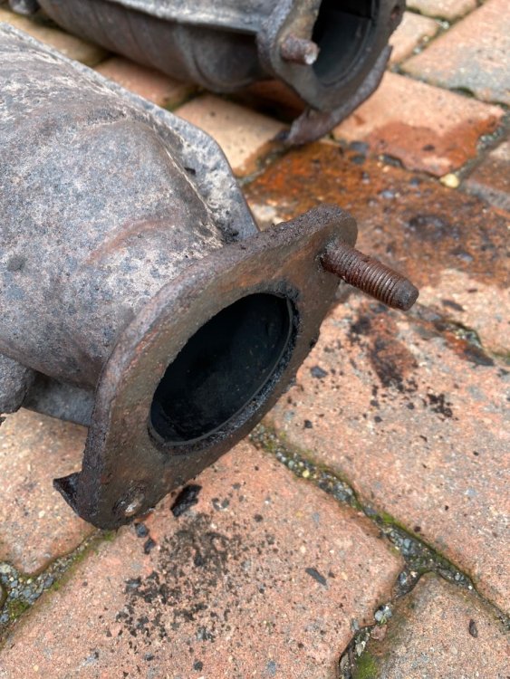

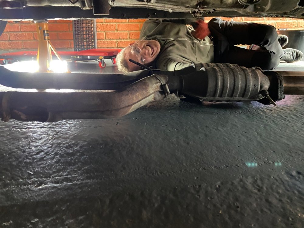

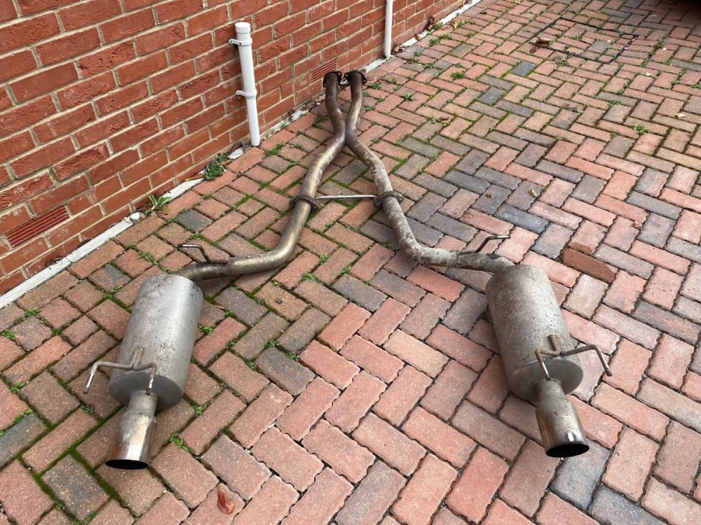

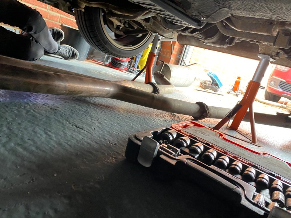

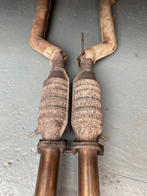

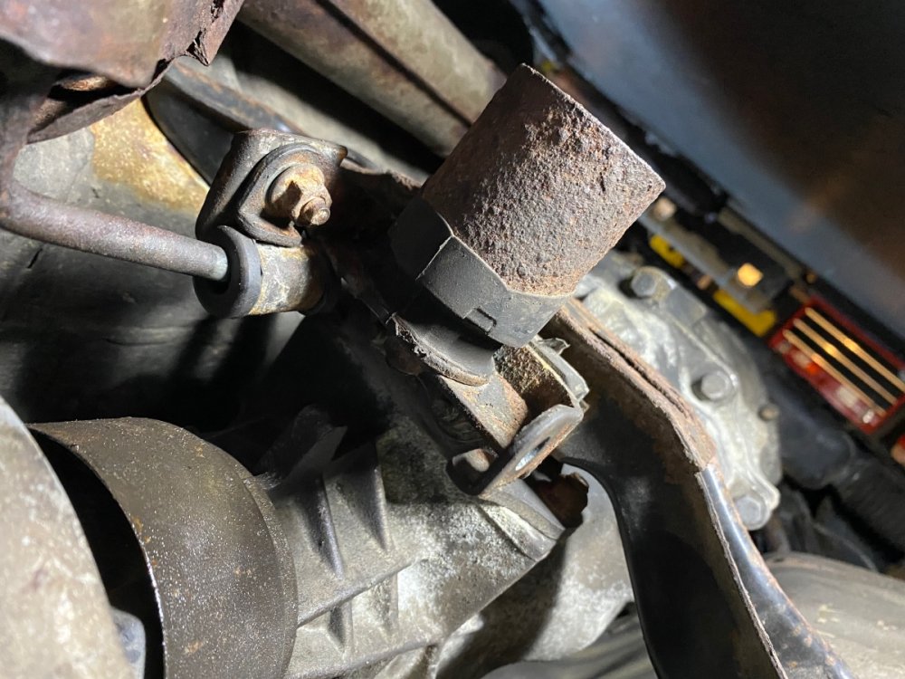

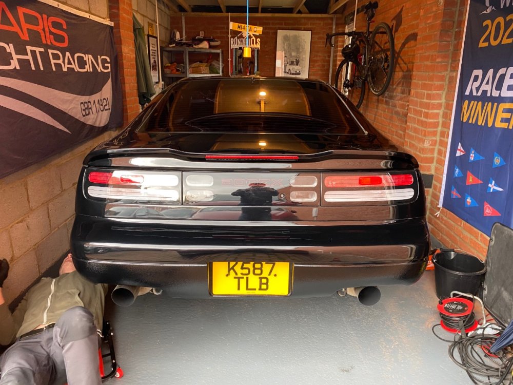

This weekends task was to fit the Mongoose Catback exhaust I bought second hand from Banzai Breakers!

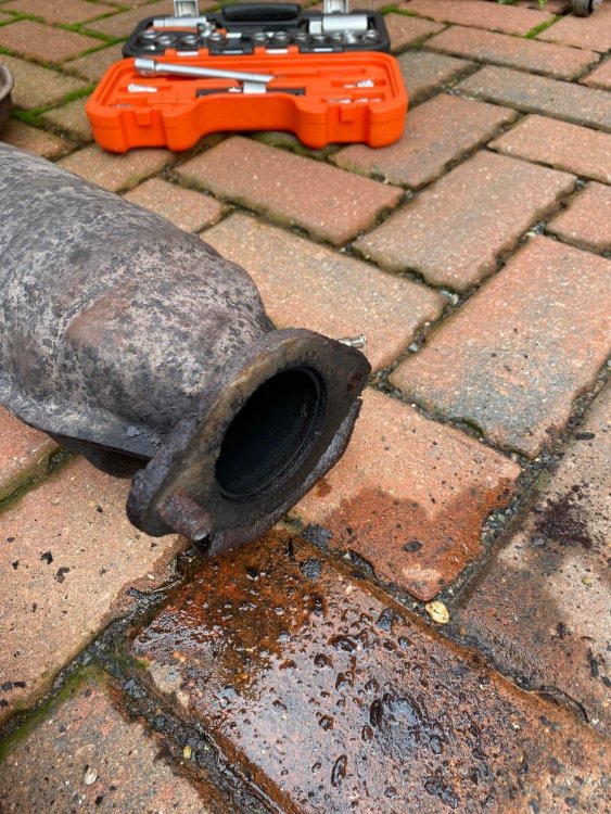

With it up on axle stands, I found that the Cats have obviously had some work on them before as it looked like a new bracket had been welded on and some previous bolts had sheared and some headless bolt threads welded in. It was a bit of a bodged mess.
We ended up having to drill out 3 of the 4 holes in the end and have used nuts and bolts to attach the new exhaust. The easiest thing was to remove the whole exhaust including the Cat section so we could really get at it rather than trying to faff about with it still attached. Was very easy to take off and the nuts were quite loose where the Cat section attached to the down pipes.
There were also no gaskets where the down pipes meet the cat section so we made some up from a sheet of gasket material and then we found the gaskets from the Cat to the Catback had almost completely disappeared! I think a previous owner had just reused the ones that were there when they put the Japspeed on and they were total garbage. Will explain I got a fume smell under throttle when the windows were down!
I’ve also found a hanger on the cat is totally missing, and two hangers that should be on the car further back are also gone so a trip to the exhaust shop is coming up next week to get it all squared away!
Anyway, the exhaust is now on as best I can, there may be a cable tie or two on it temporarily! Once it was on, I took it for a gentle run out, and after it was warm I pulled over and it appears a weld has failed on one of the sections as it was blowing a bit.
These are the challenges with second hand parts but still, should be an easy fix when the hangers get done!
It does, however, sound and look great! I’m really pleased with how it has come out. The drone has gone and it’s quieter when cruising and has a bit of a rasp too it under acceleration!

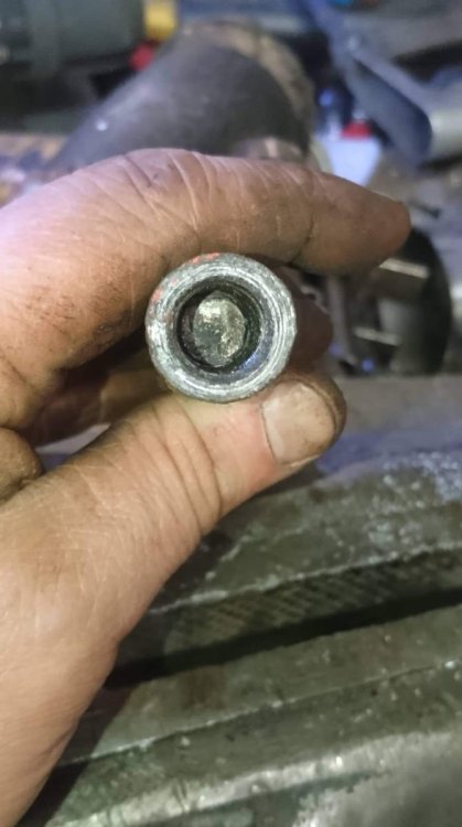

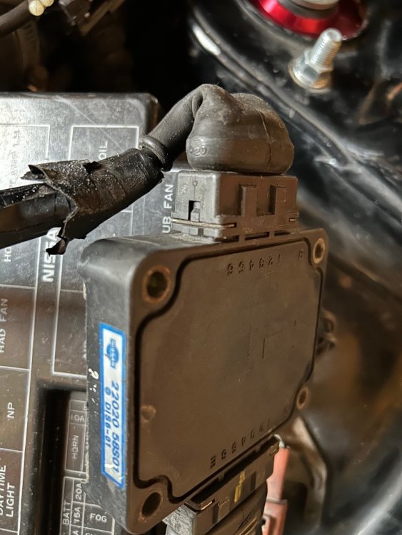

To try and solve the problem with cylinder 5 I’ve done the following:
1. Swap the ignition pack with cylinder 1. Didn’t fix it.
2. Cleaned the connectors on the PTU. Didn’t fix it.
3. Swapped the spark plug with cylinder 1. Didn’t fix it.
The cylinder will fire on a cold start for the first 30-60 seconds before it stops so I feel like the injector is ok as it’s obviously working then.
I’ve read about all the Series 1 PTU’s failing so I’m going to upgrade it to a series 2 and see if that helps! It’s been relocated at some point in its life and the wiring looks ropey so that will probably need doing as well.

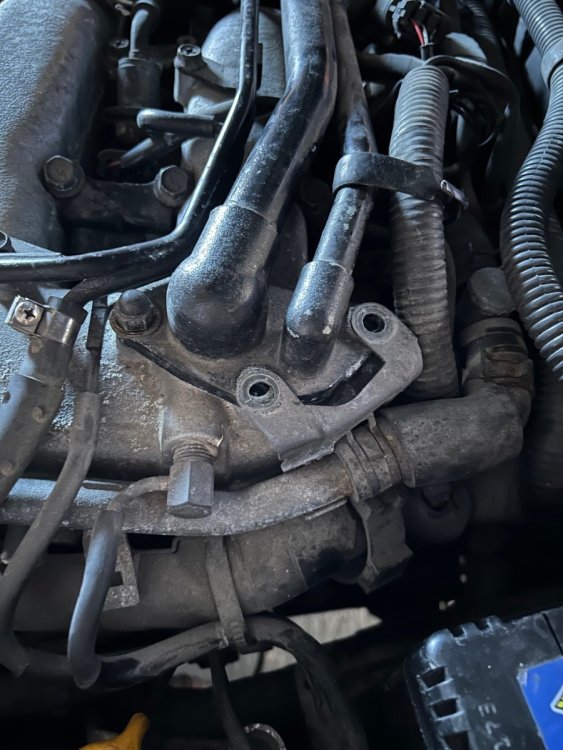

New problem!

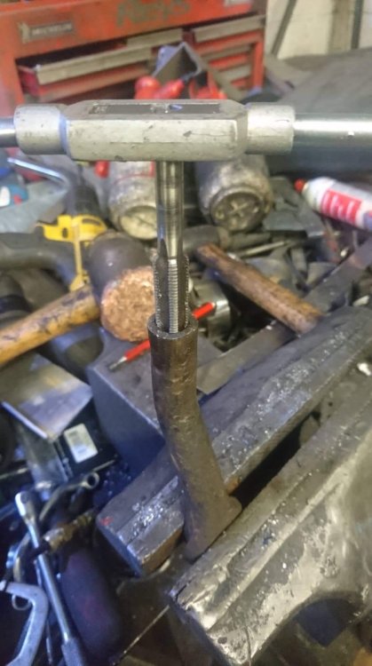

While putting the balance tube back on after swapping coil packs etc, the two screws that hold the passenger side on have both dethreaded the inside of the plenum. ?‍♂️
Hey Rob,
Looks like you may have found your miss-fire problem mate! Upgrade to a S2 PTU and (proper) wiring harness....
...And as for the balance bar, gently re-tap the threads in the plenum with a tapping tool and get some new bolts.
Inconvenient, but not insurmountable ?
Good luck mate!
Richard

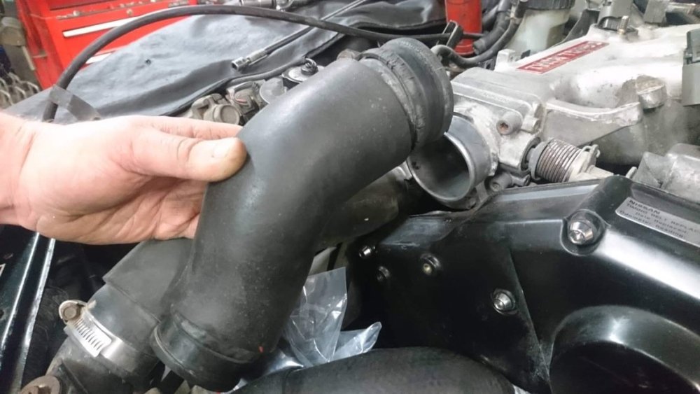

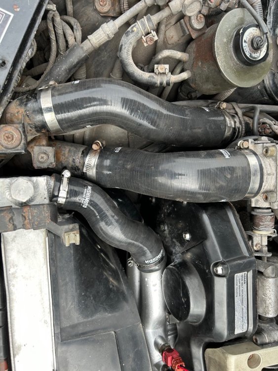

Compressions test results all good. All cylinders up around 140-150 so happy days there!
The intake hoses however were all pressing and brittle, fortunately I had a set of Mishimoto ones in the garage that I was going to fit when it was back anyway!
The pipes are 30 years old this year so probably not going to be the last that’ll need replacing.

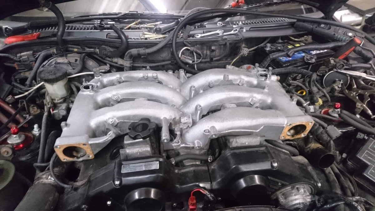

New injectors are in and it’s being put back together. The second hand plenum cleaned up way better than I imagined it would. It looks shinier in the photo to be fair than in real life but happy with that.

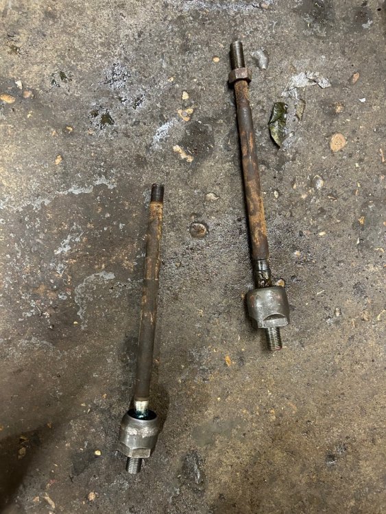

While replacing the Hicas ball joints and setting the car up he went to adjust one of the tie rod ends (I’m probably wrong with this component but picture shows what I mean!) and he found that the thread had previously snapped off and where as there is normally an inch or so of adjustment, he had about 2 threads!!! Bit of a close call there.
I’m very happy with how it ran on the drive home and hopefully now, although it’s cost a fortune, it should be set for many more years of running. The only downside is he said he might  or want to work on the VG30’s anymore as it was such a pain!

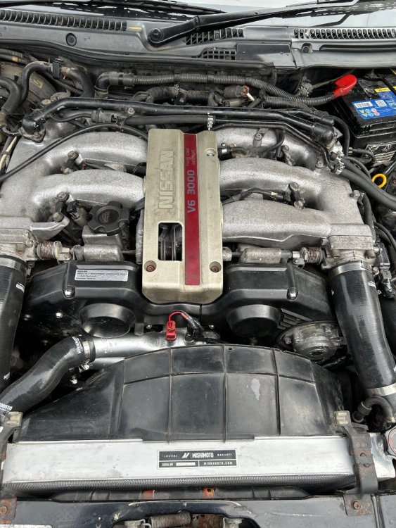

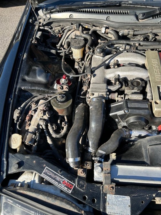

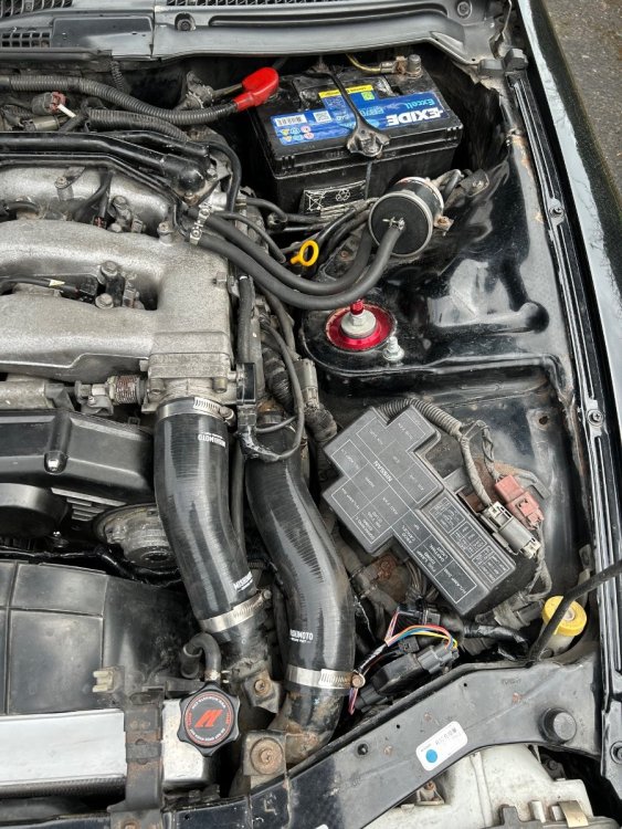

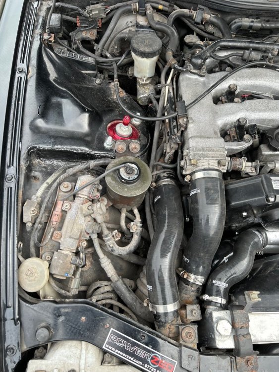

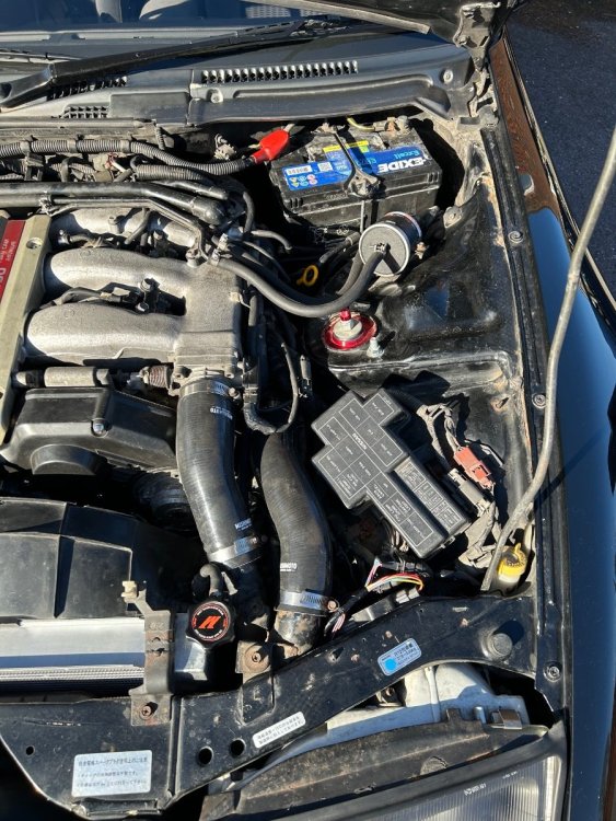

Had a cheeky engine bay clean up today. Nothing amazing but a good scrub and clean up has taken a lot of grime off
Edited by RobHowl
