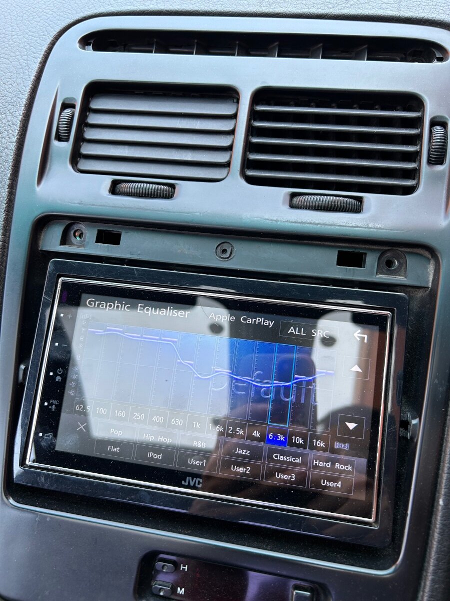

Got on the interior last week and fitted my ZSpec double din stereo fascia to replace the butchered one that was already in it.
Turned out to be a bit of a ballache of a job in the end, only because it was difficult setting my JVC stereo up at the correct height etc.
Anyway, so the kit I bought was really good, really well packaged with crystal clear instruction cards written for dummies (fortunately for me). It came with its own mounts for the stereo too and is mainly setup for Kenwood or Pioneer as they seem to be the top main brands in the states.
I ended up test fitting a number of times and having to modify the mounting brackets to get it to fit but the difference it makes in the car is really noticeable. Sounds weird as the single din fascia isn’t all that different (after butchery) but having a proper setup it streaks ahead.
The stereo also sits at more of a 90 degree angle than the old one as well, so I get a lot less glare on the screen now.

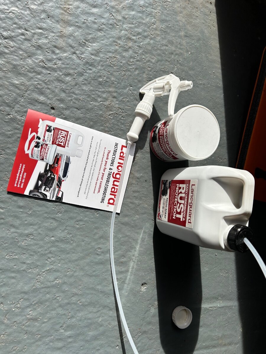

Passed its MOT! A couple of advisories around the brake lines being covered in gunk but not any issues and general corrosion underneath.
I have given it a coat of Lanoguard underneath, cost about £75 for a do it at home kit. Pretty easy to do really, the kit was good and came with loads. I only used about a quarter of it so can do another quote after winter as well. Also had a special grease to go on the more vulnerable areas.

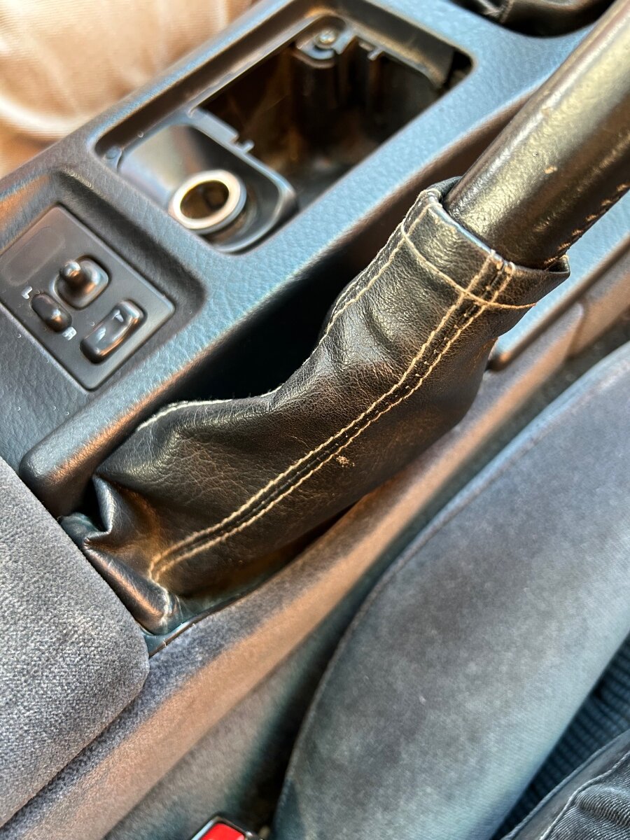

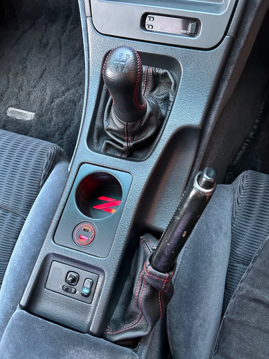

Installed a new gear gaiter, handbrake gaiter and 3D printed cup holder! I’m so excited to try out the cup holder!
Nice and straight forward for the gaiters, just taking off then middle trim pieces, just a few screws and fitting the new leather eBay special ones. They got nice red stitching like my gear knob now and replace the really tired old ones.
The cup holder I bought from a forum member, Peage, who makes them and sells them on Etsy and it replaces the ash tray.
its excellent quality and came with detailed instructions but it’s just a case of cutting away some of the old bits and it slots right in to place. The USB is plugged in to the ciggy lighter and has an on/off switch and cover and was very easy to do, even the connectors were supplied!

Always nice to see one installed!! Glad you got on well with the install and are pleased. I think that looks right at home in your Z 😄

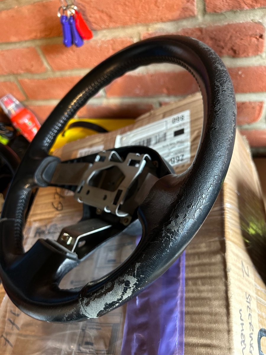

Also, fitted new steering wheel (proper wheel but recovered and looking lovely!) and also fitted the new window seals.
Both a really easy job but make a big difference.
