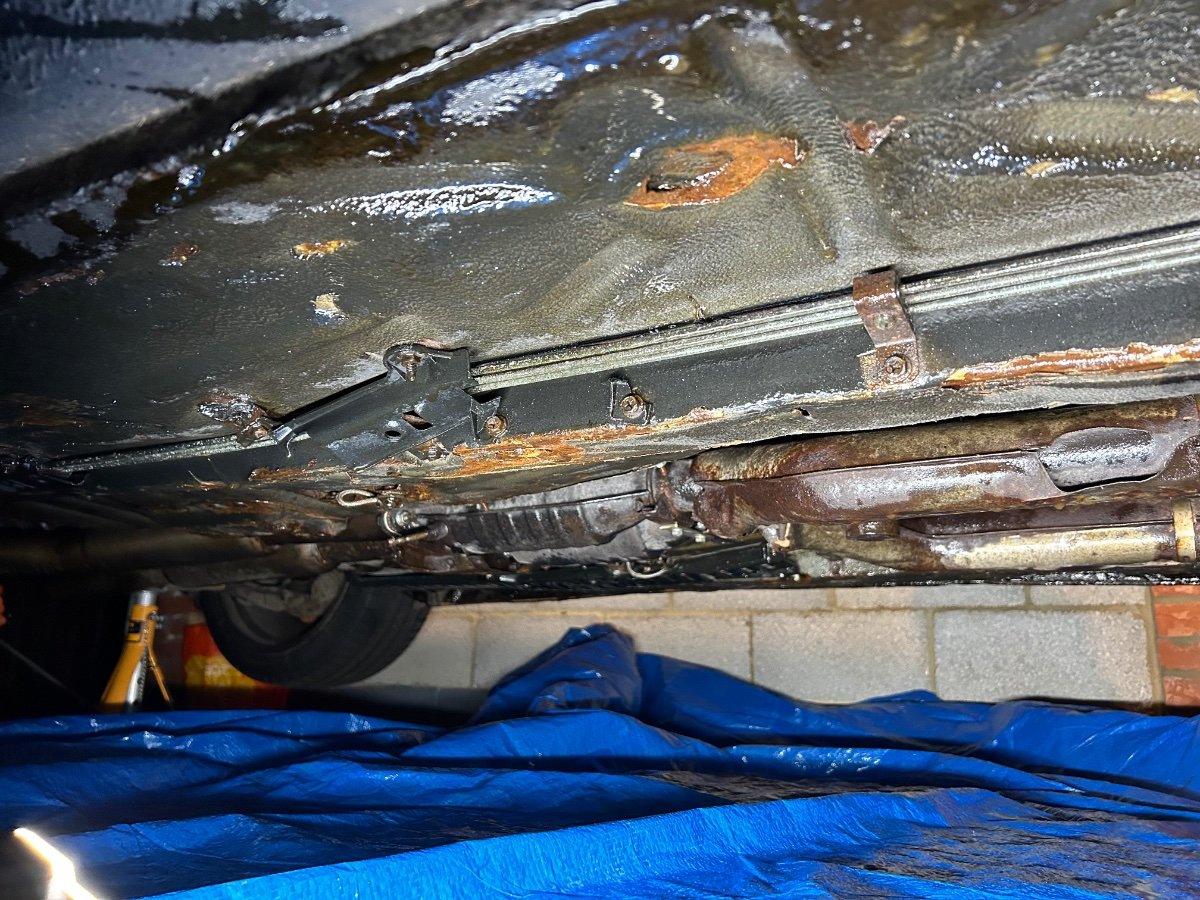

He also said that although the underside has been let down in the last few years by being sat outside, there are signs still there that has been a very well looked after car in the past. She needs some TLC in rust prevention which I will look at doing when funds allow.

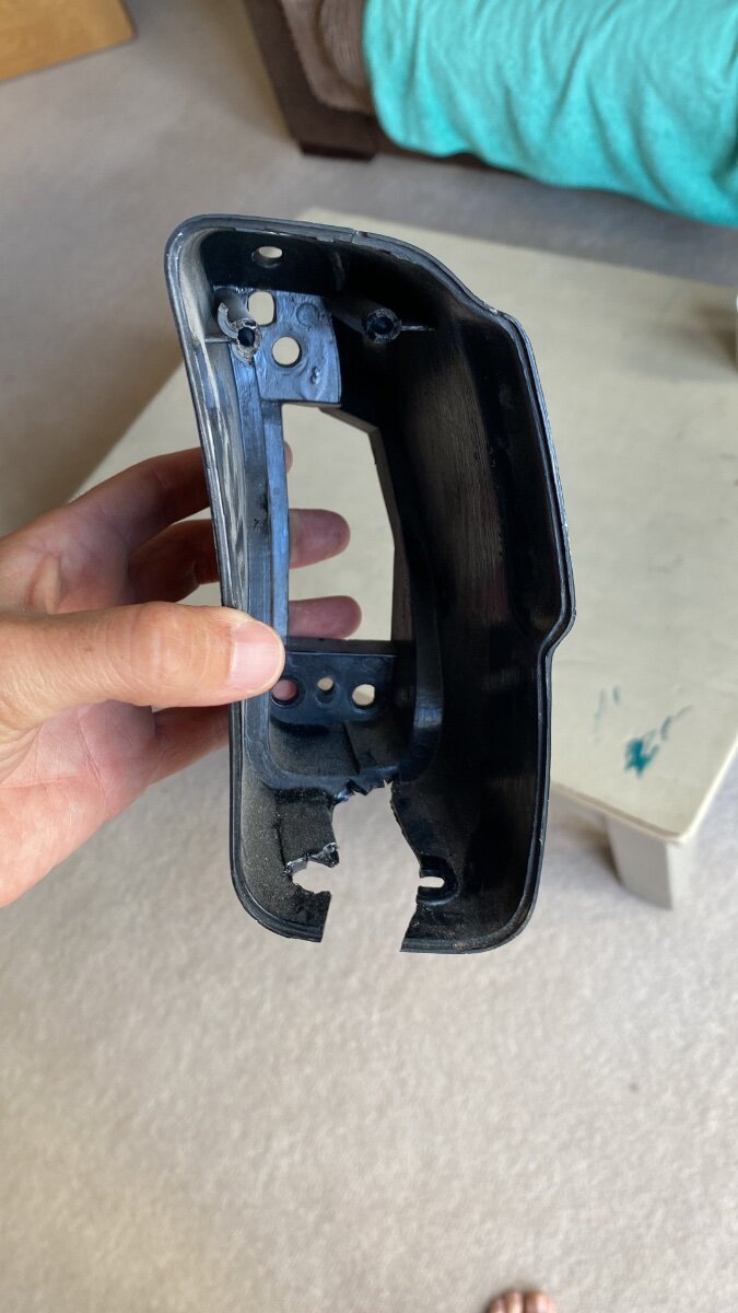

Today I was able to replace the light switch pod mount as it was broken and the pod itself was loose and flapping around. No it’s nice and solid for turning on the lights
I was also able to fit the 99 rear lights and centre panel I bought from Z Centre.
Really easy job, 14 nuts to undo, cleaned all the manky old mastic off with some white spirit (looks like some old gasket was still on there and it had been mastic’d around! Bit of a bodge) but that’s all gone and the kit even comes with a roll of mastic ready to simply unroll on to the back of the lens and then 14 more nuts to do up. It’s very much plug and play.
I took care not to do them up too tight as don’t want them to crack but they fit flush and take years off the car.

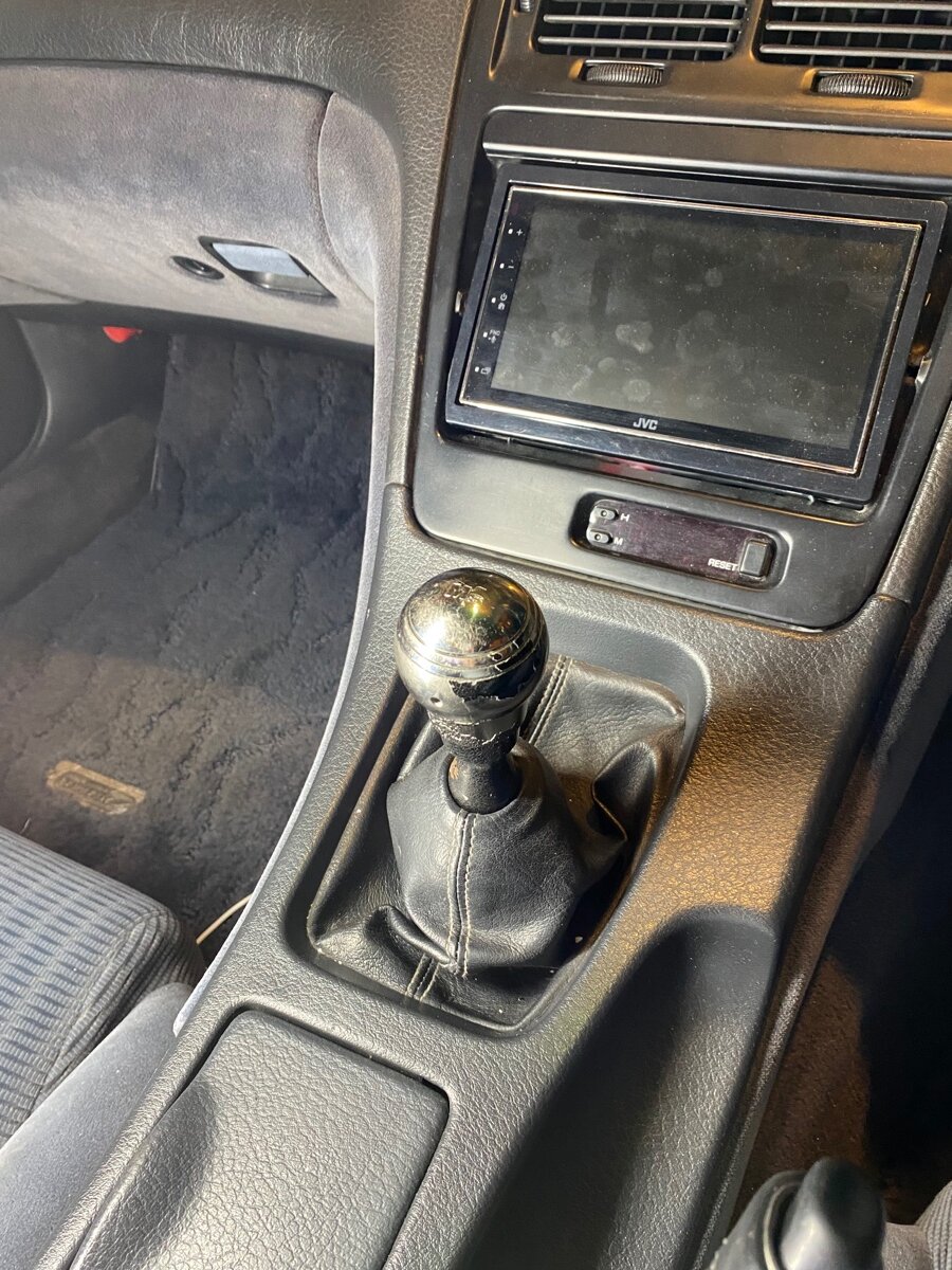

Got rid of the flakey metal gearknob (never fun on a hot sunny day!) and replaced it with a ‘Nismo’ gear knob.

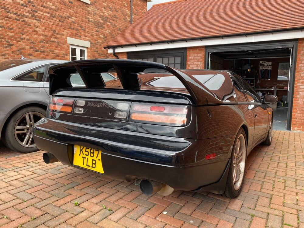

New spoiler arrived, getting some quotes together to get it fitted. Will suit the car better than the big wing I think.
The lines on the car really suit a low key spoiler I think.

That knob makes a huge improvement. It's not a Nismo knob though. It's a 99 spec one. Was standard on the late cars. Nismo ones are metal.

Knob is fifty trillion times better.

Yeah I put Nismo in brackets, that’s what Z1 sell it as though.

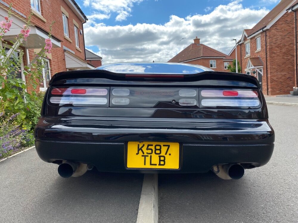

Got her back from the bodyshop today. I had the old Bomex rear wing removed, some welding done on the boot lid (rear wiper hole closed up) and had a new Twinz Design Wing 3 installed.
The wing I took off was not really my style, also blocked the view out the back pretty comprehensively, and I believe the new one compliments the lines of the Zed much more.
Turns out the boot had 9 layers of paint on it!!
I used TP Smart Repairs in Aylesbury as they have a good reputation and Tommy did a fantastic job. It looks excellent, is like an OEM+ look and will be much easier to clean

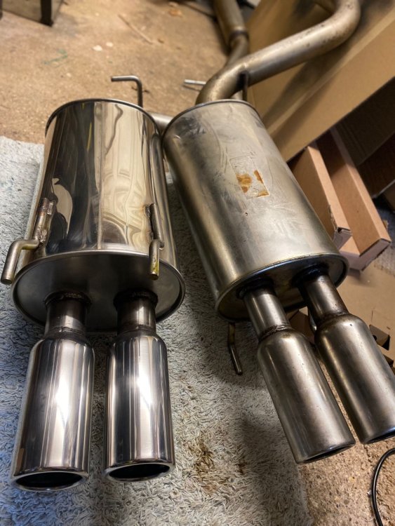

I’ve also got my hands on a Mongoose catback exhaust to replace the Japspeed one. I much prefer the quad pipe look and I’ve heard they sound really nice too!
It was ok when I got it, had some yellow overspray and was dull but looked in good Nick.
Not installed it yet as I need to get a gasket and some new hangers but it has had a good clean up with some light abrasive scourer and some metal polish and has come out amazingly well! Almost too nice to use ?
