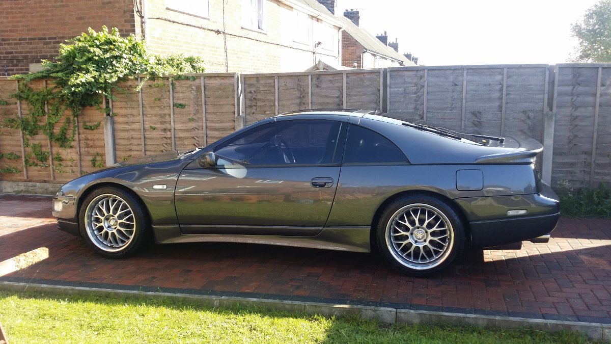

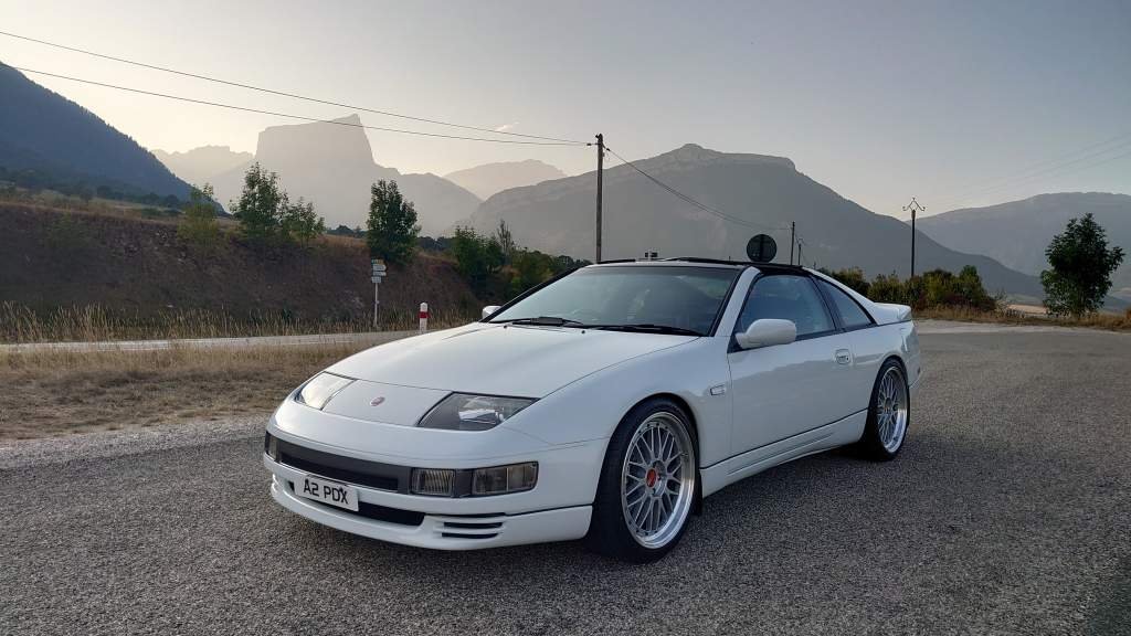

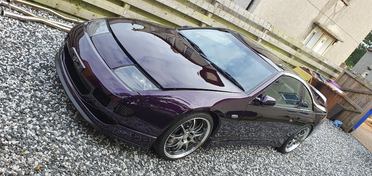

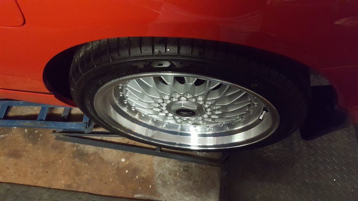

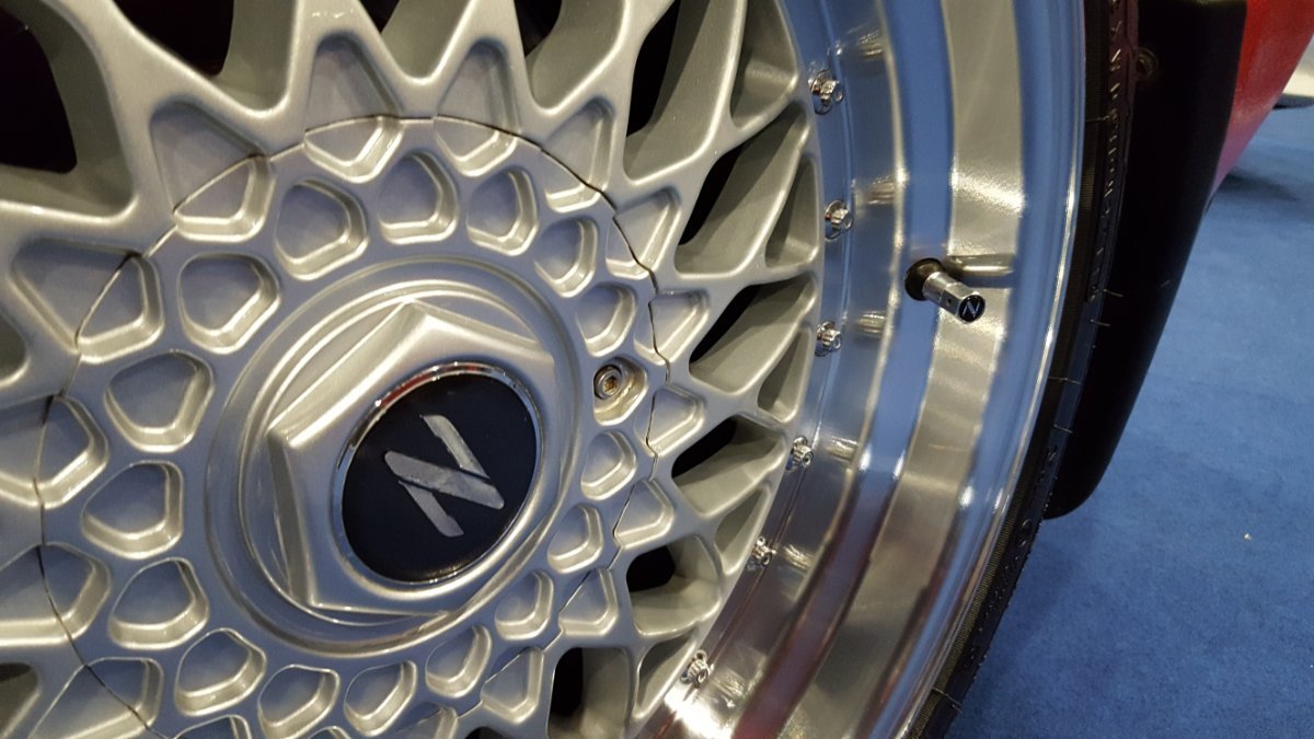

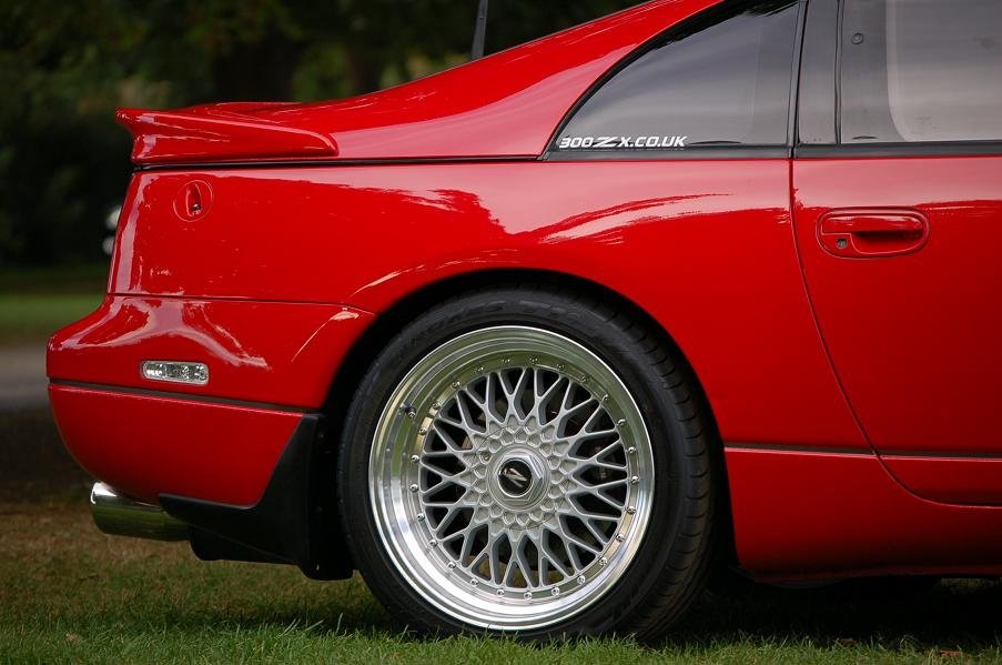

  • 19" BBS LM on my old Z. Rare fitment in 19" format.

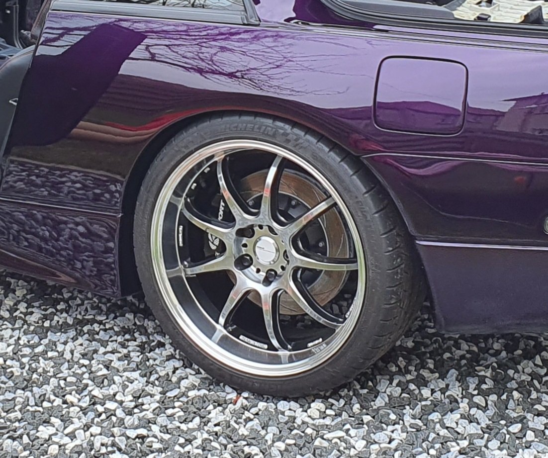

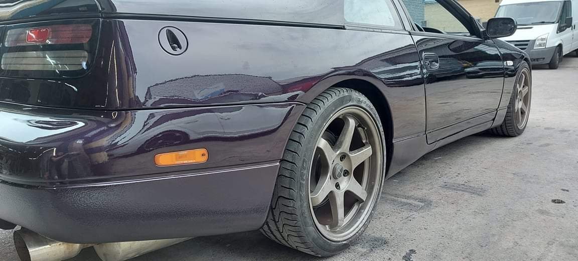

Ultralite wheels TE37 knock off.

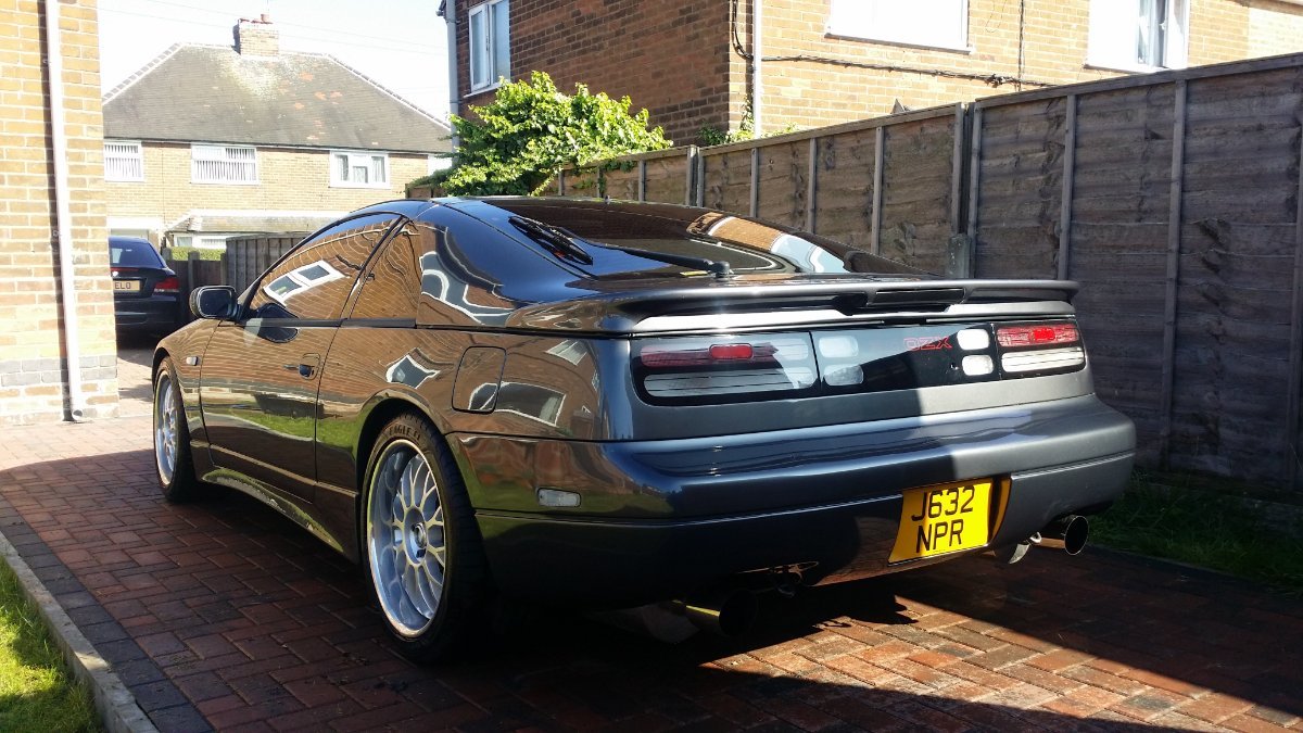

18s, 8.5 front and 9 rear. Can't remember the offset as previous owner fitted them and tbh the offset isn't great and I've spacers fitted.

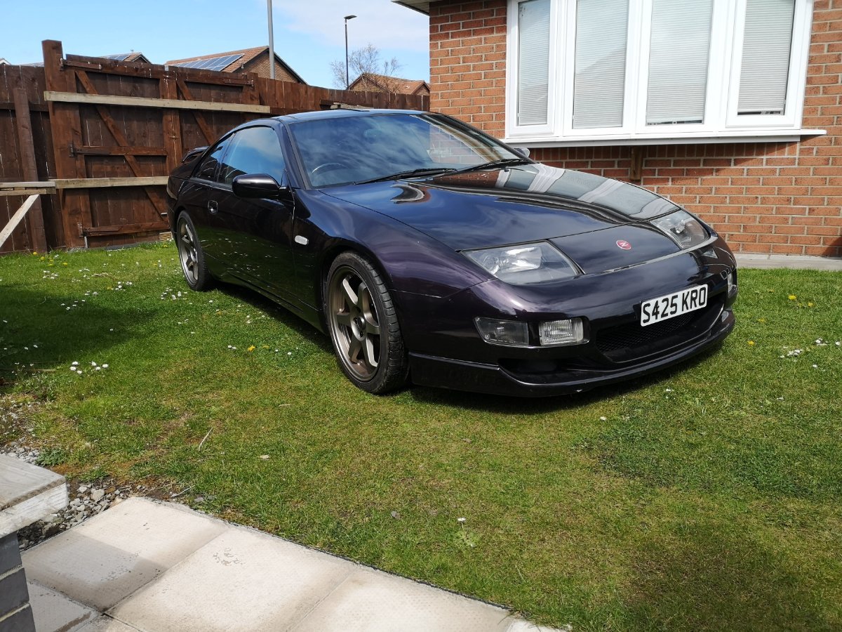

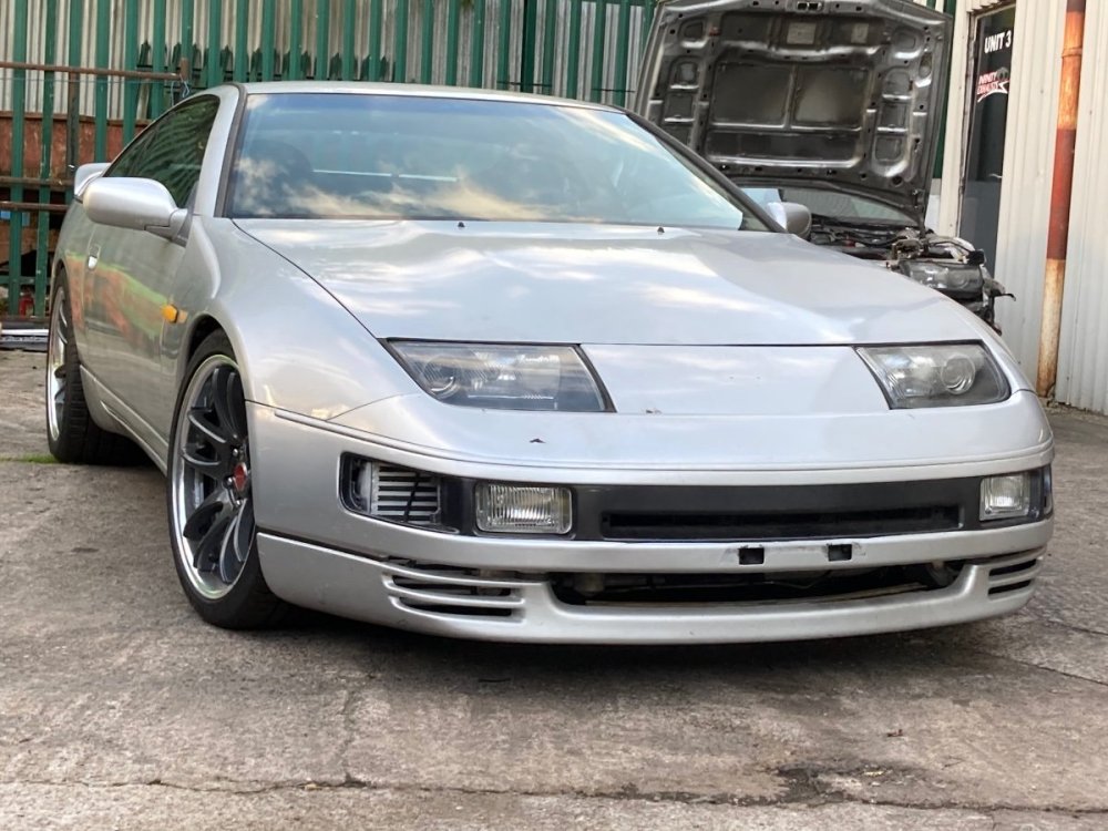

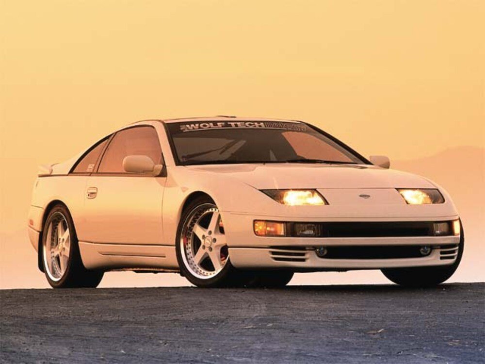

That's freaky, I was literally looking on Google images at wheels on a 300zx. Mine came with some questionable ultralite wheels so looking to change them with something else. Imo you need a but of dish and some fat spokes. Here is some inspiration for you. Not mine, downloaded from the Internet lol!
Oh and dark car bright wheels and light car dark wheels for maximum impact. Although i think gun metal wheels and bronze work on most coloured cars.1b2ba03c34439482df39158de58f21cb.jpgeb29e576c613bb2a96b0c83a1b2d84c2.jpg

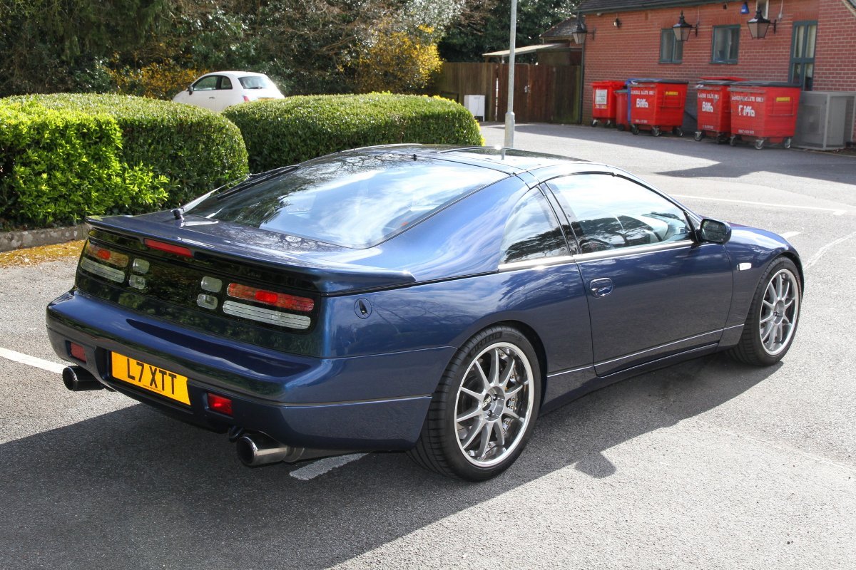

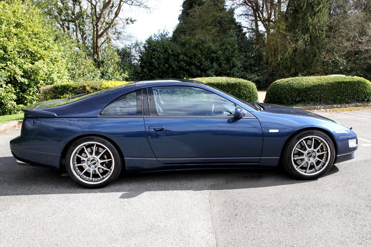

Mine has Advan Siena II wheels, 18x8.5 with 20mm spacers on the front and 18x9.5 at the rear (desperate for a refurb!!!)
Tyres are 245/40 at the front and 275/35 at the rear.
I think it's lowered about 20mm or so, on the standard old KYB AGX shock & Eibach spring combo which I'll be swapping when I finally get the Meister R's on!

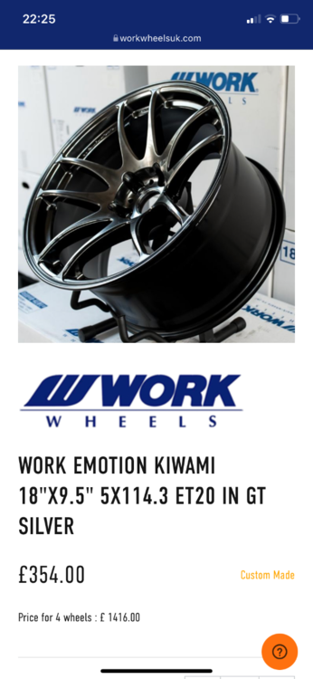

I’m looking at some Works wheels but not sure if they’d fit. They are an 18x9.5 with an offset of ET20
if got some bog Evo 8 callipers on the front which would need some clearance.
can anyone advise? I’m not brilliant with wheel setups

I've a bit more time to answer now, the driftworks link provides full sets which I believe are in stock, I had to wait 9 months for mine but it was Covid time, I bought all my four individually and specs are above.
Full sets do tend to be staggered, so that's usually a 8.5J and a 9.5J rear.
The fronts are likely to have a straighter face, 'R' fitment iirc, so they may not be just as pretty as a concave rear wheel, 'A' fitment again, if I remember correctly.
You'd be better following one of us with similar spec wheels, at least then you'll know they'll fit.
A 9.5J ET20 will not fit on the front, too much poke, it will fit better on the rear, just, on a standard arch, you may have to stretch a tyre a little, so instead of a 275 width, go a little less but why ? Get the correct offset straight out of the box and more rubber down is my opinion.
8.5J ET20 is more like it for a front wheel but you've got brake clearance to consider, so that leads back to the 'A' and 'R' fitments I have mentioned, lots to consider.

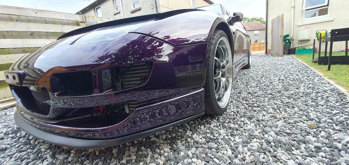

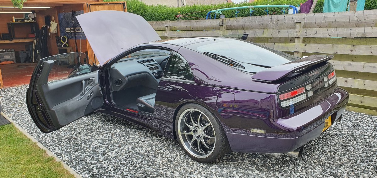

I'm on e20 9.5x18 front and 9.5 e30 rear. The plan was to put e30 on the front and e20 on the rear, but because of the concave spokes the e30 wouldn't clear the stock caliper. I am hoping when I put my ksport brakes on I can swap them round as they will sit further out (if thay makes sense?)
Car is currently sitting on 245 40 18 tyres all round and I have experienced no scrapage.
Pics were on stock suspension. I have recently fitted BC Coilovers. Will get some more shots when the weather improves 3ee139b1d9a15a9f4508cc21c93e8d0a.jpg
