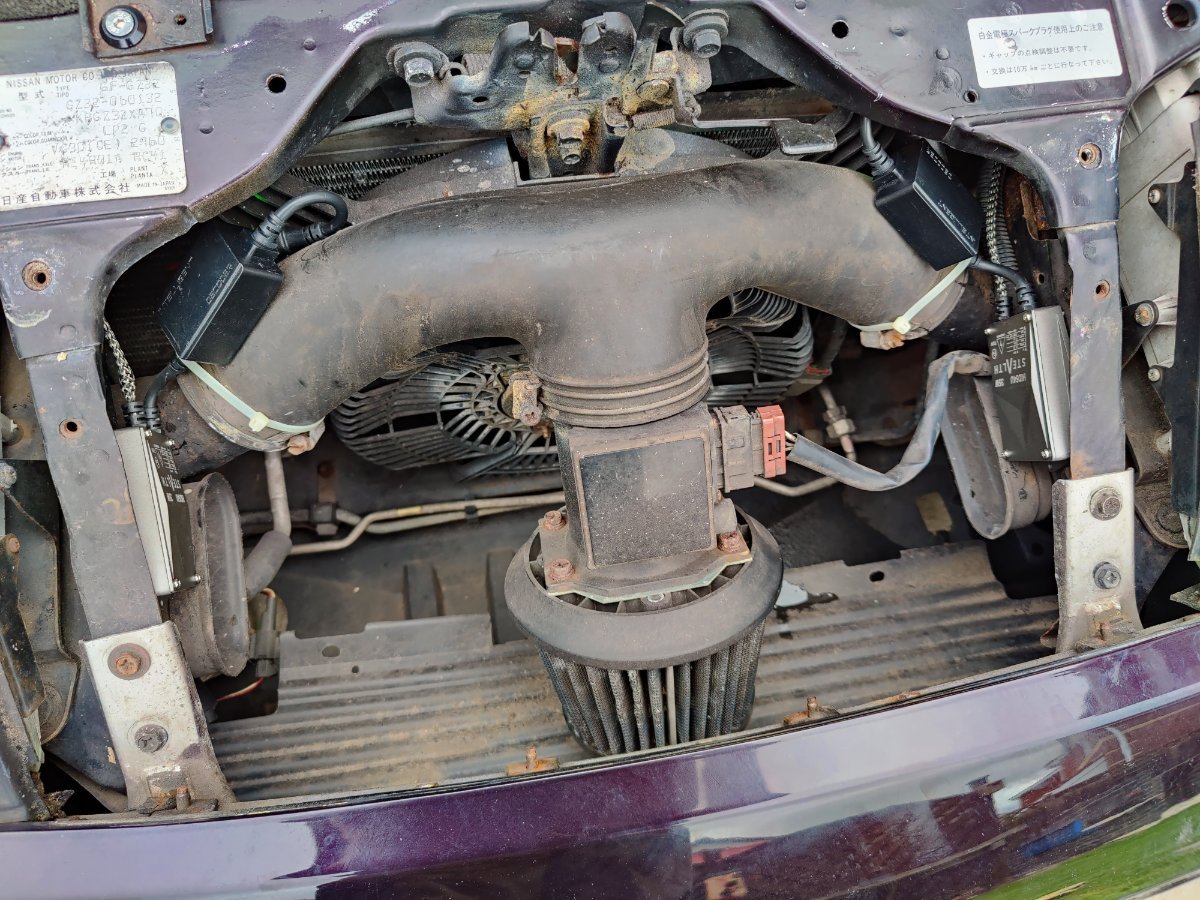

3. Source OEM airbox to replace the awful cone filter. - Done

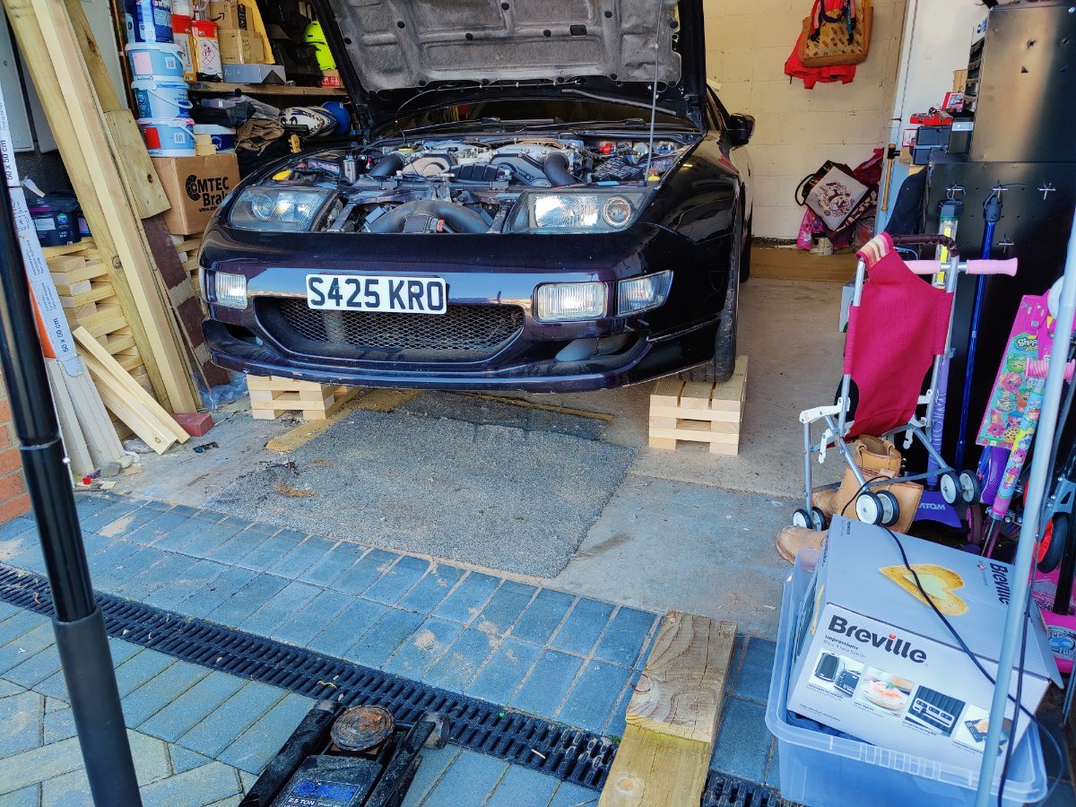

4. Raise suspension up to a sensible height. (need to buy a MeisterR spanner) - Done

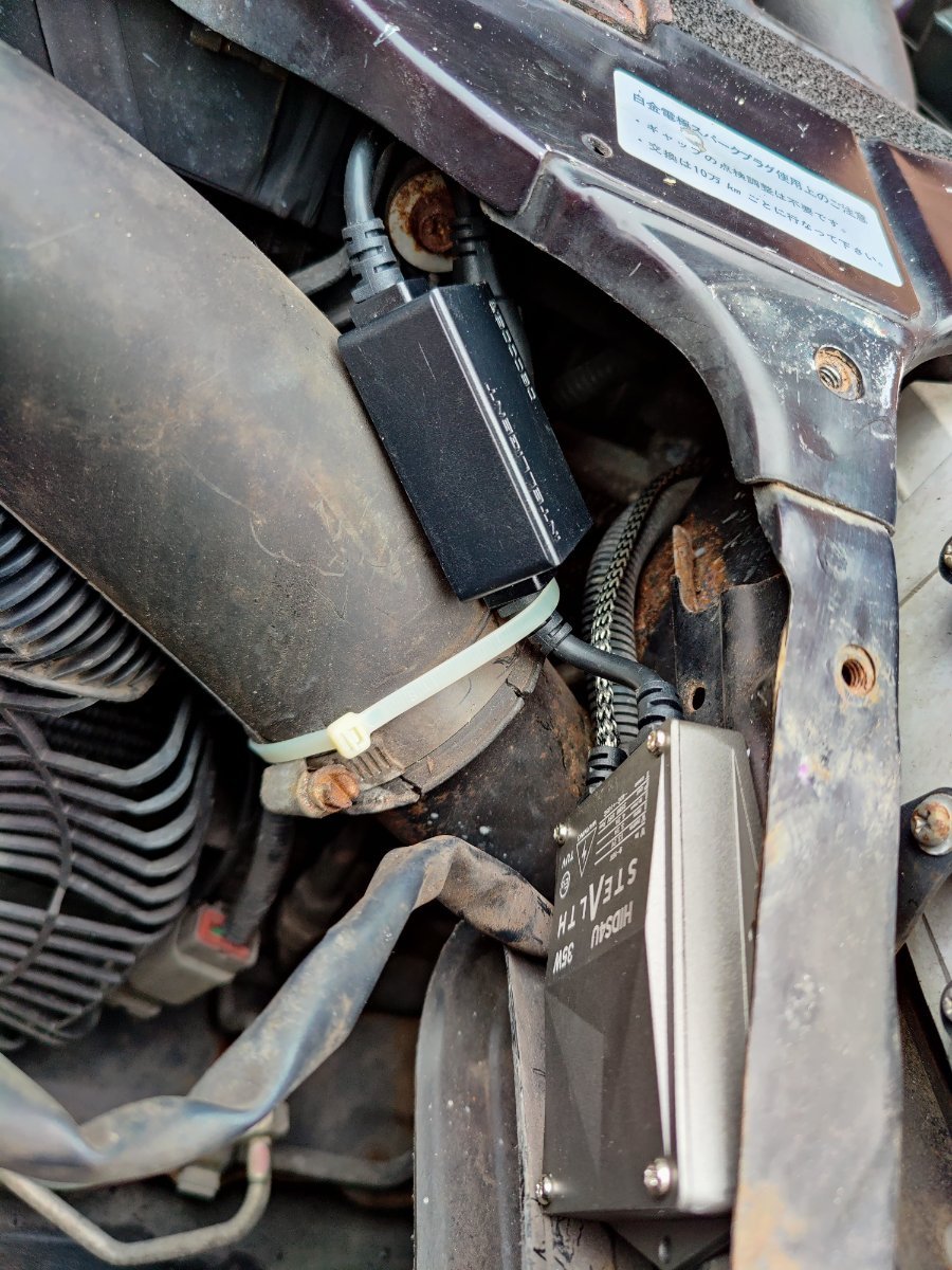

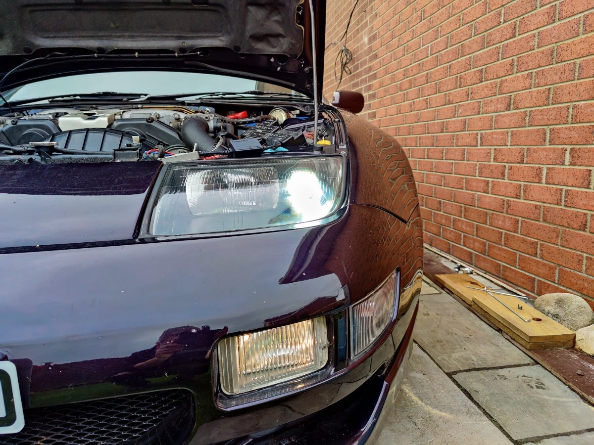

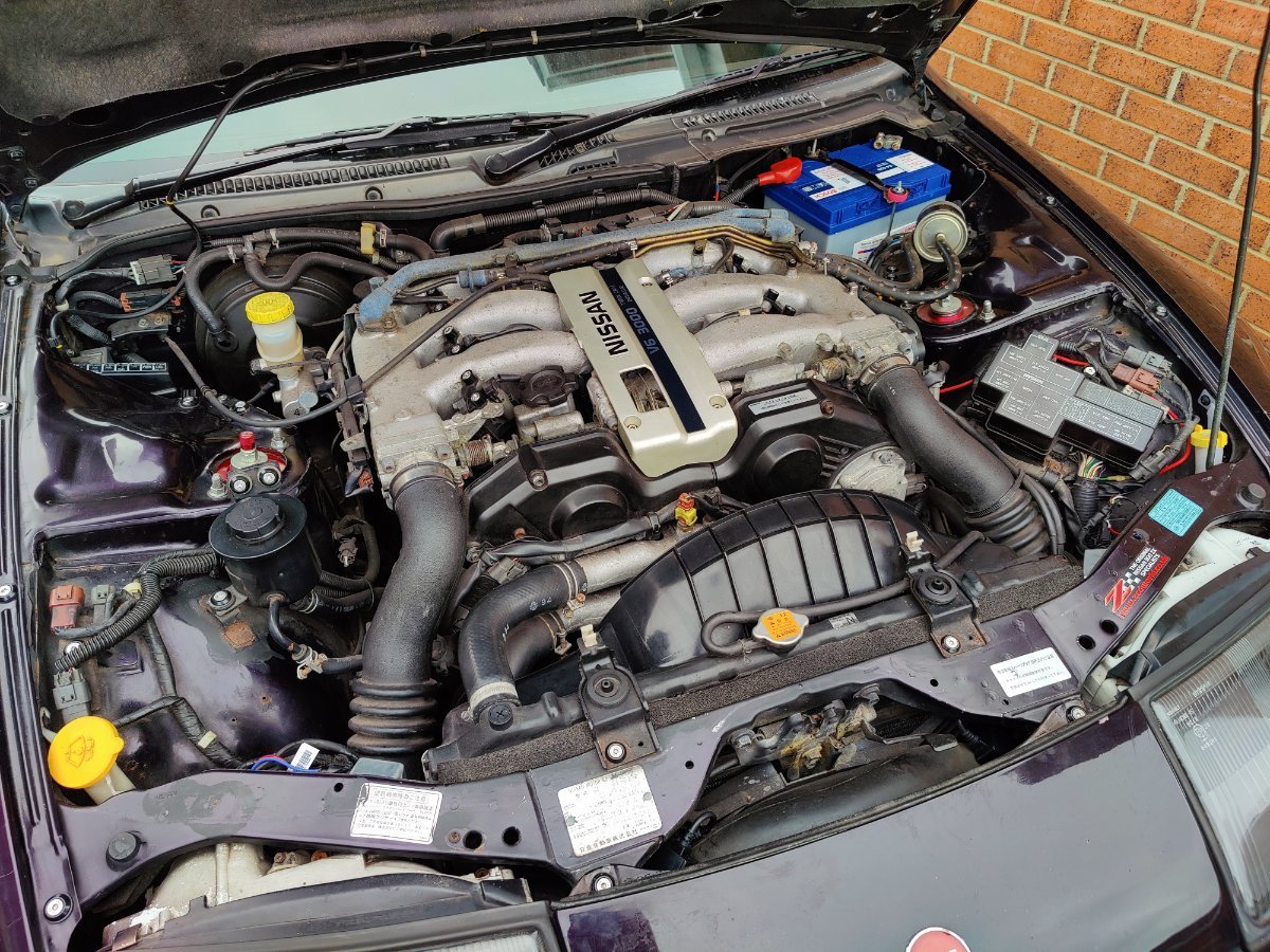

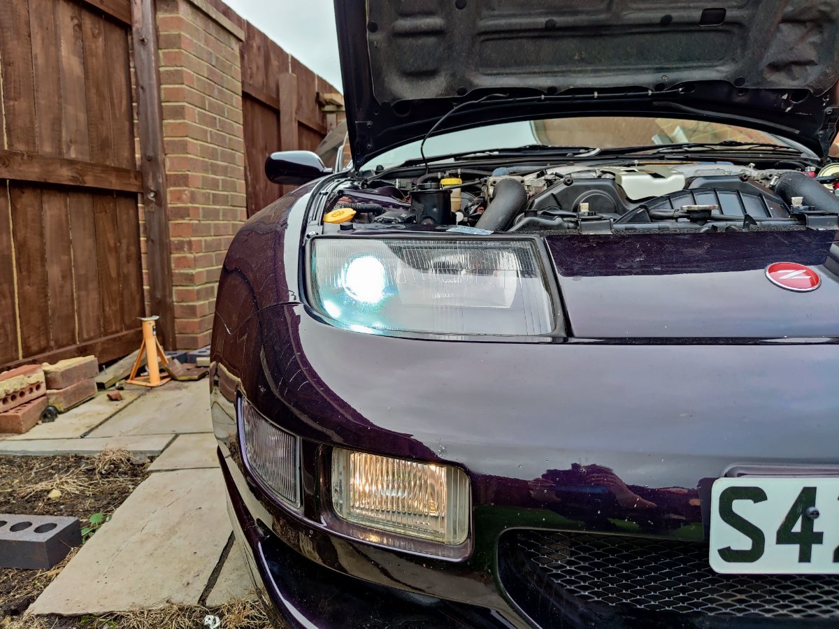

The HIDs that had been fitted to the car were quite a high Kelvin rating. Probs around 6200K. I was never happy with that so got a new set a few months back and was finally able to fit them today.
Camera doesn't do it justice as it always picks out blue hues, but they are a very clear white (4800K). Also managed to get the ballasts tucked away under the nose panel. In the pics below the passenger side is new set and drivers still has old.

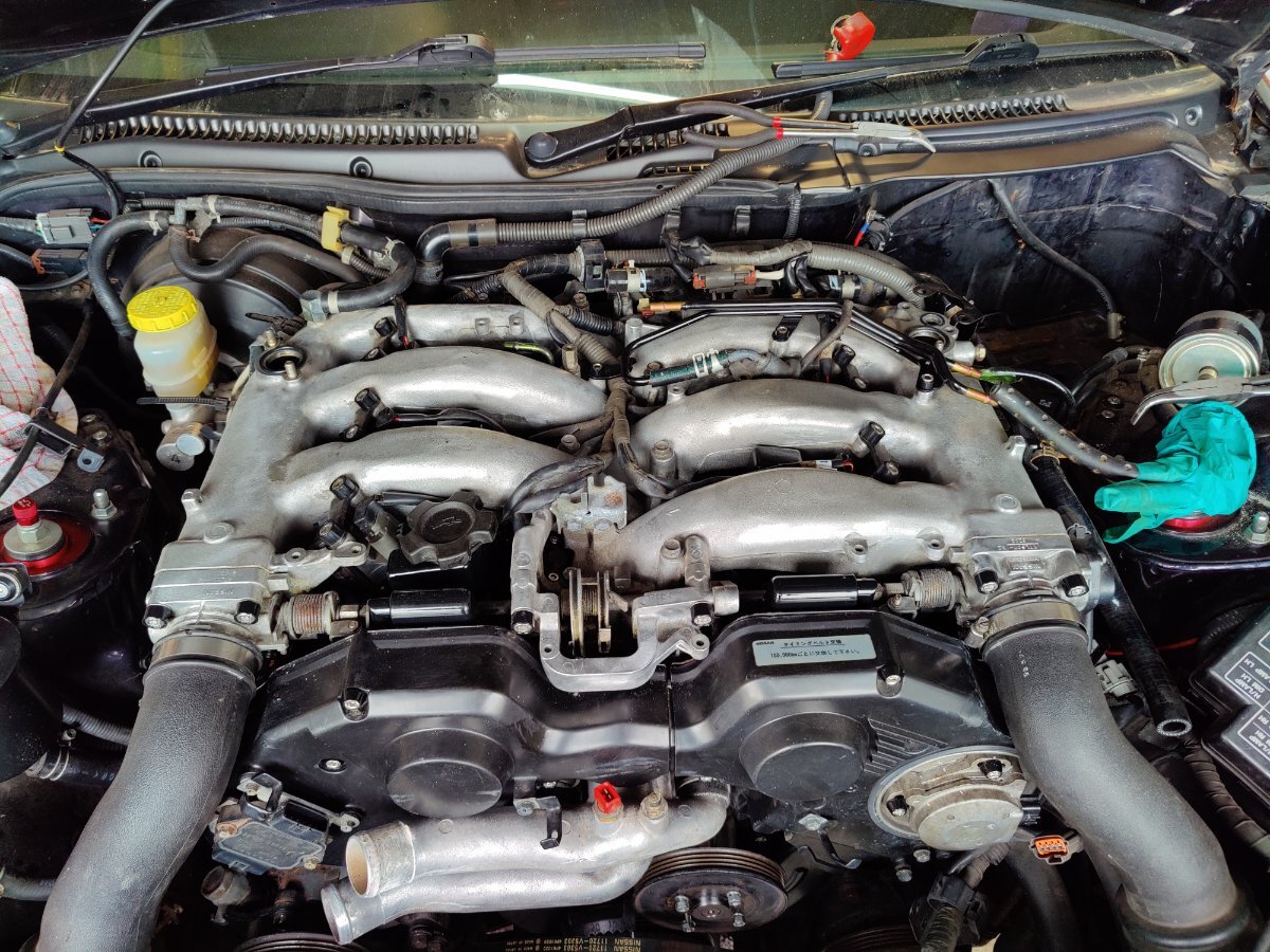

Cleaned up some of the bay with degrease and fitted a few more stainless nuts and bolts. Discovered what I think is the start of lifter tick from the drivers side. Something to add to the "Jimmer list".

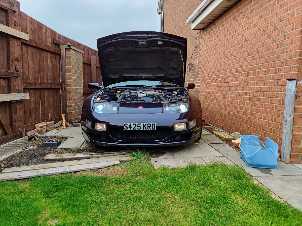

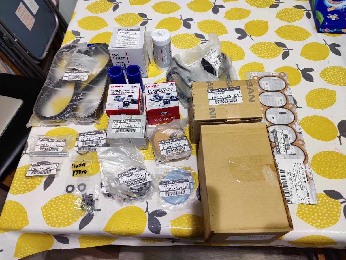

Well the hibernation didn't last long.

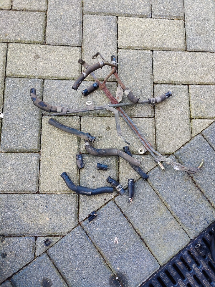

I'm now a fair few $$$$ lighter courtesy of Z1 and CZP. Non of it will arrive in time for this leave, but next leave I'll be moving the car into my own garage to work on it in the warm and dry for once.
A whole lot of $$$ that will never be seen ?
New PCV hose and valves, fuel lines, and vac lines not shown as they're already stowed in the garage.

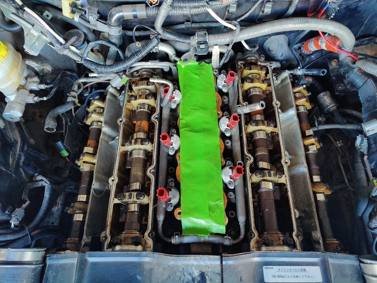

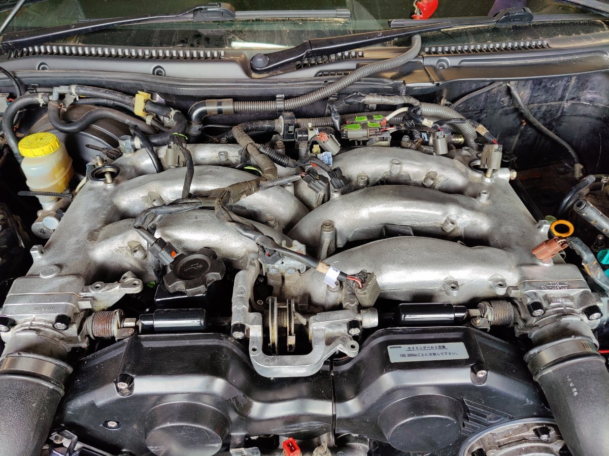

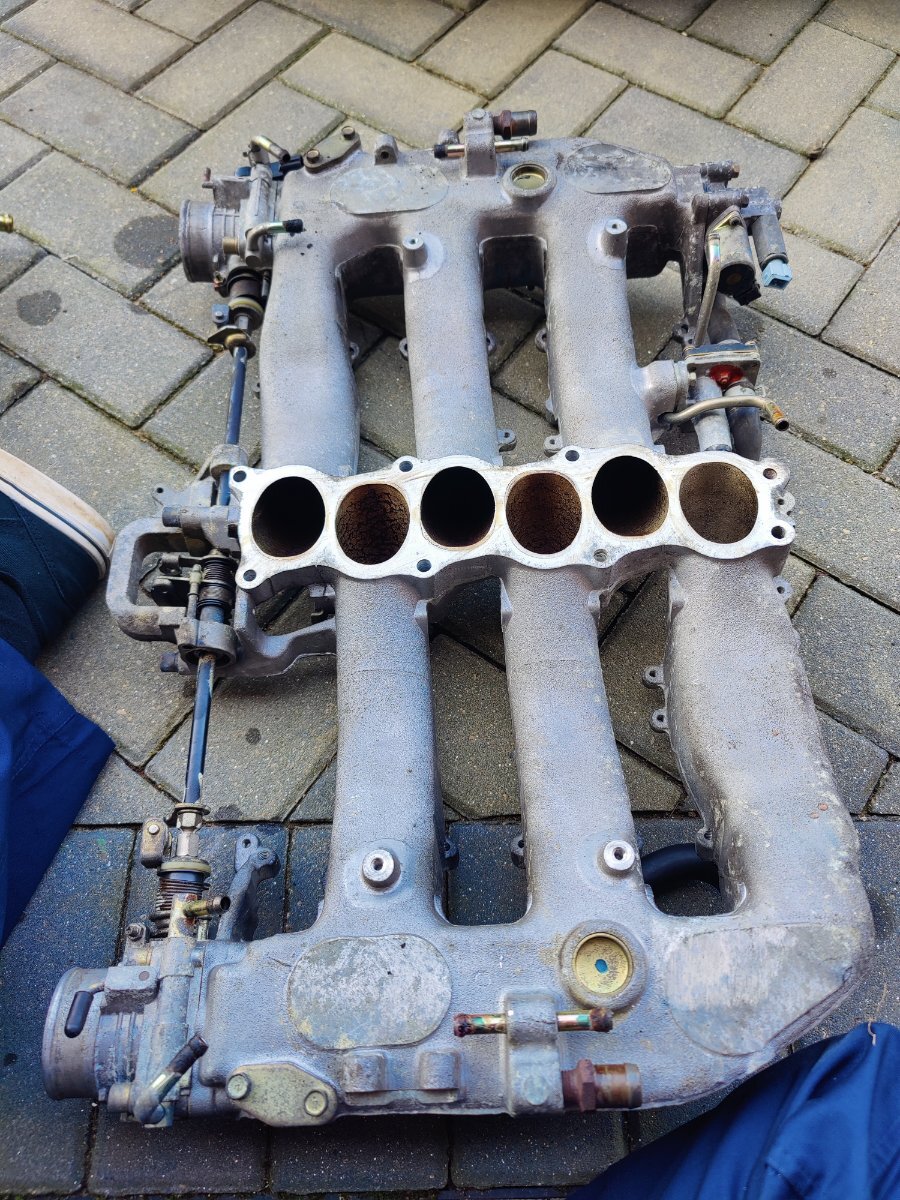

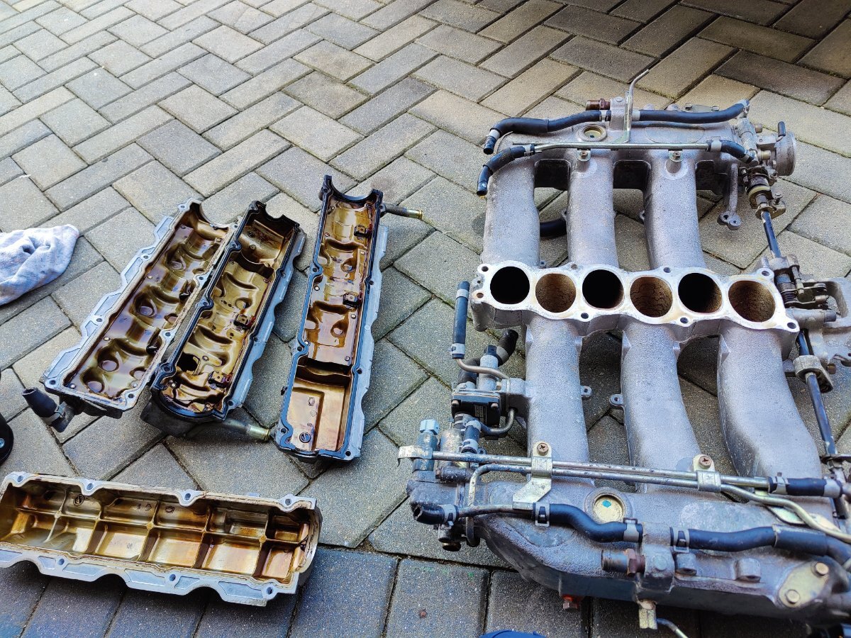

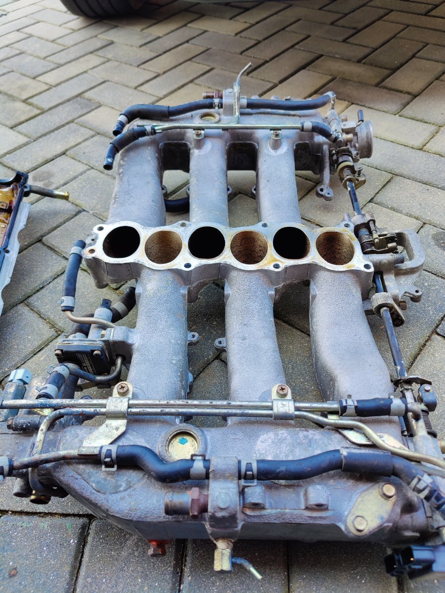

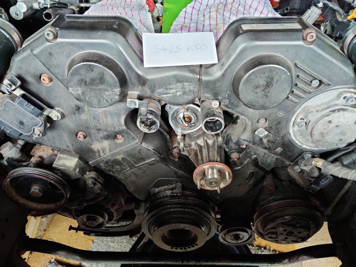

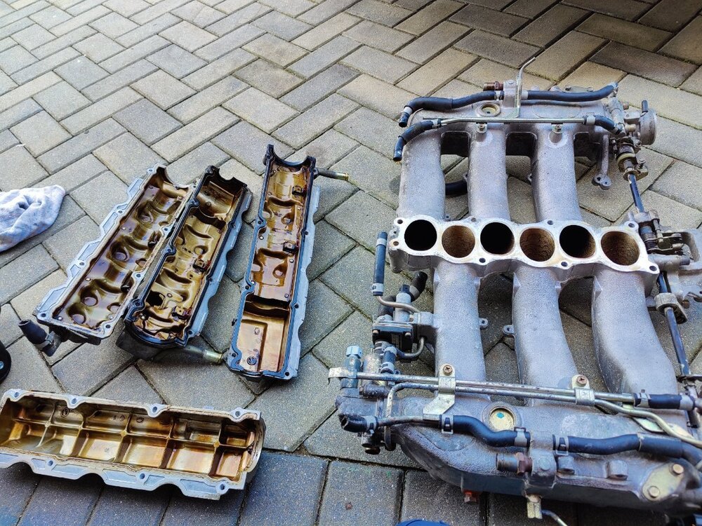

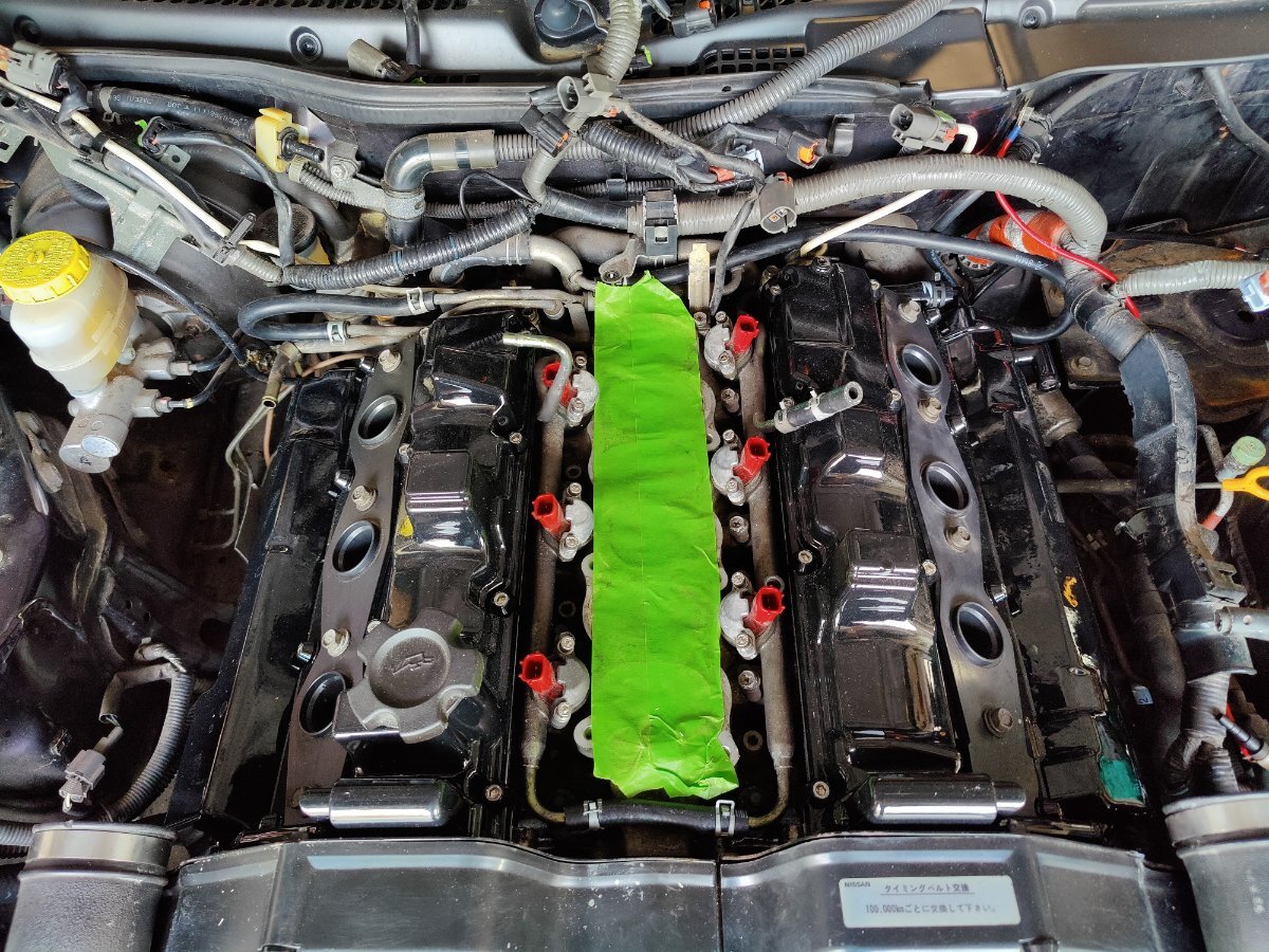

Plenum pulled and valve covers off.
Back of the engine is quite wet, but seems to have been coming from the valve covers. I'll have a closer look tomorrow.

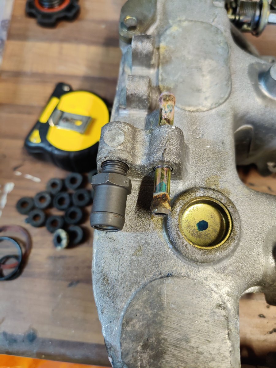

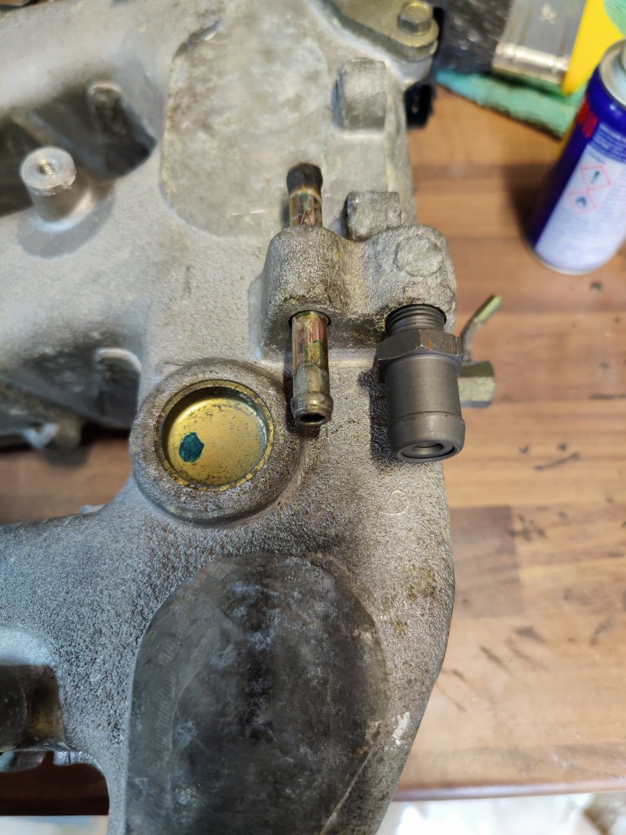

Water bypass complete on the plenum. Just started cleaning it and the valve covers up. Hoping to paint the plenum tomorrow and drop the valve covers and balance bar off at the powdercoaters.

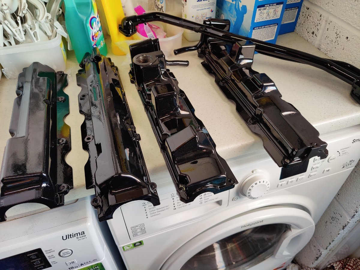

Balance bar and valve covers are at the powder coaters. He's stowed out so I won't get those back till Thursday next week. I started to clean up the plenum and applied a test patch of aluminium coloured gloss engine enamel. But tbh I don't think I like it. Will probably just clean up the stock look and leave it like that.

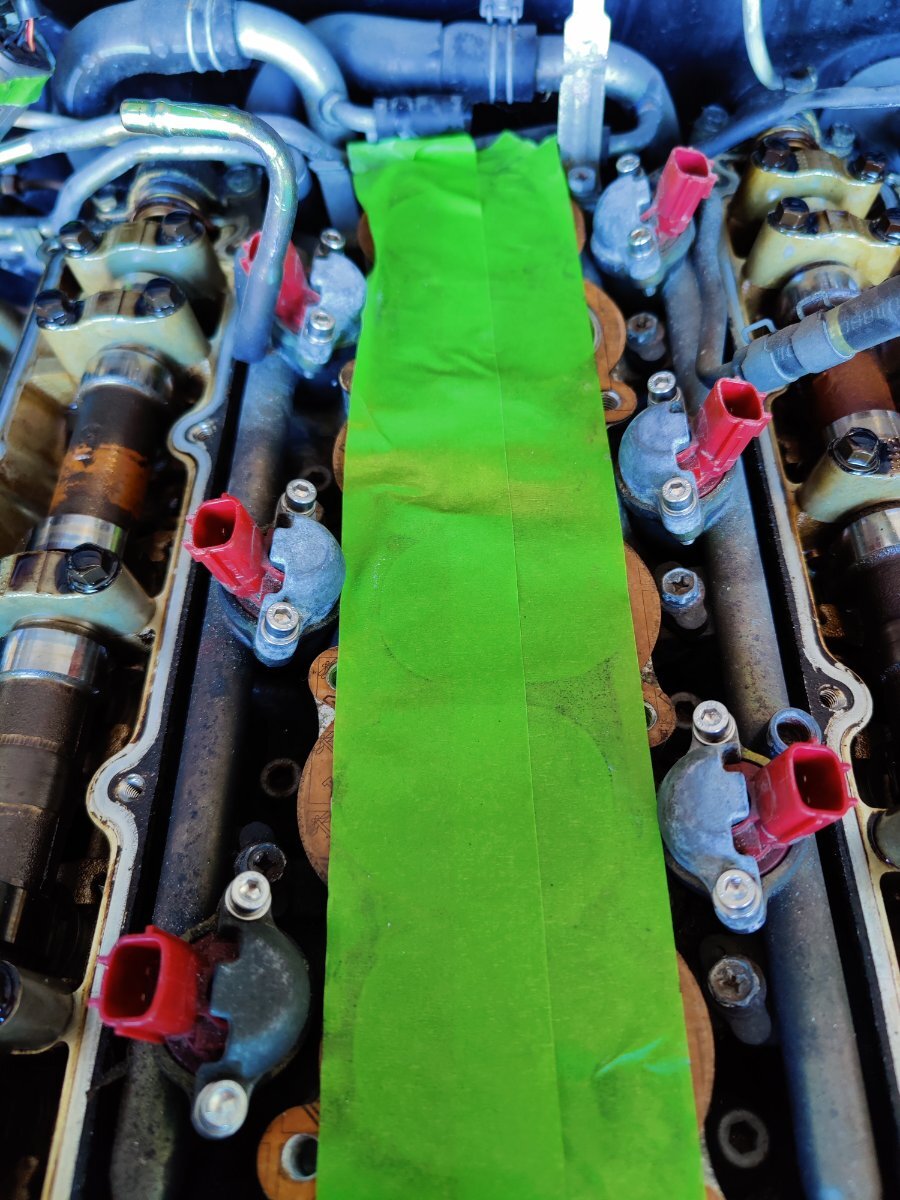

Injector hardware cleaned up and new stainless foxing applied and torqued up. A couple of the ones fitted as found were a tad loose. Car has had an EGR delete so I know the plenum has been off at some point in the past but no idea if anyone has messed with the injectors. Oh well, all done, loctite, and torqued.

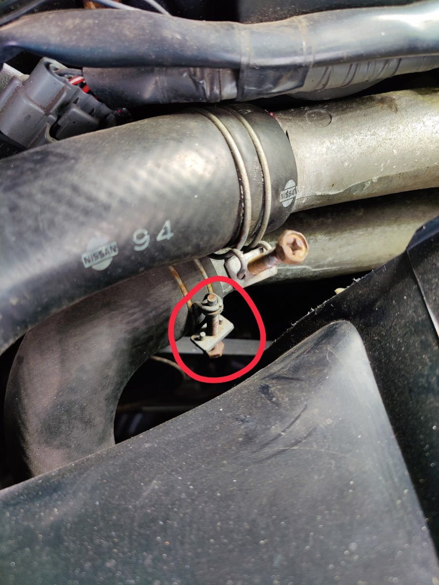

I should add that there is a place in hell reserved for the person who fitted this clamp this way round.

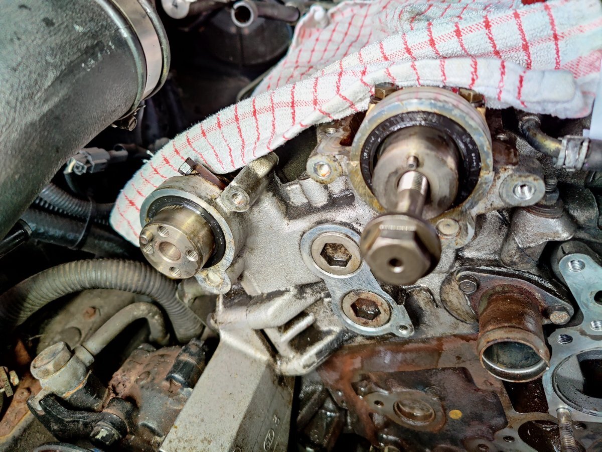

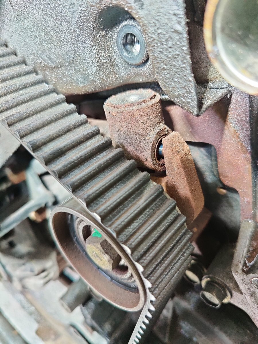

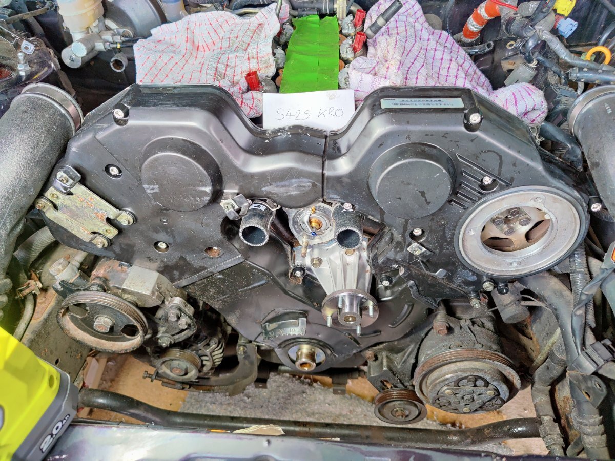

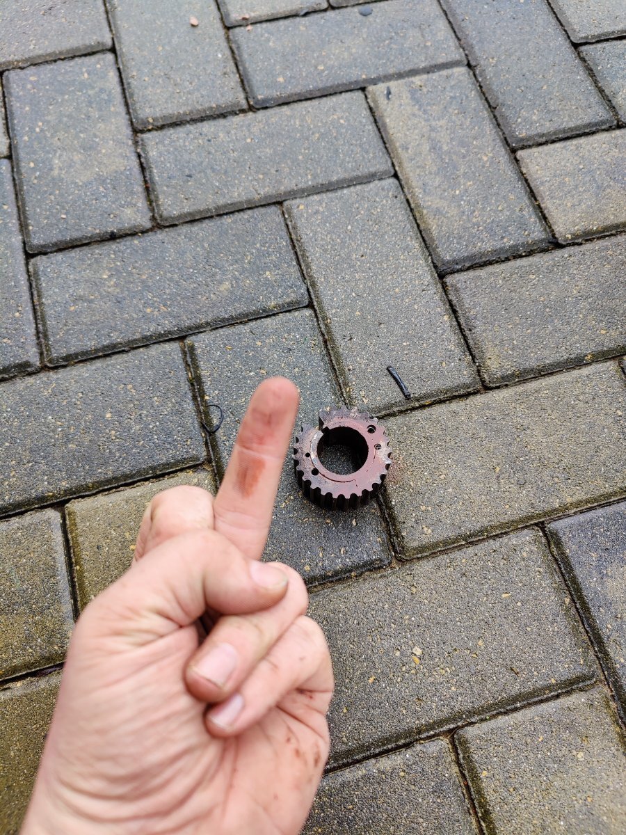

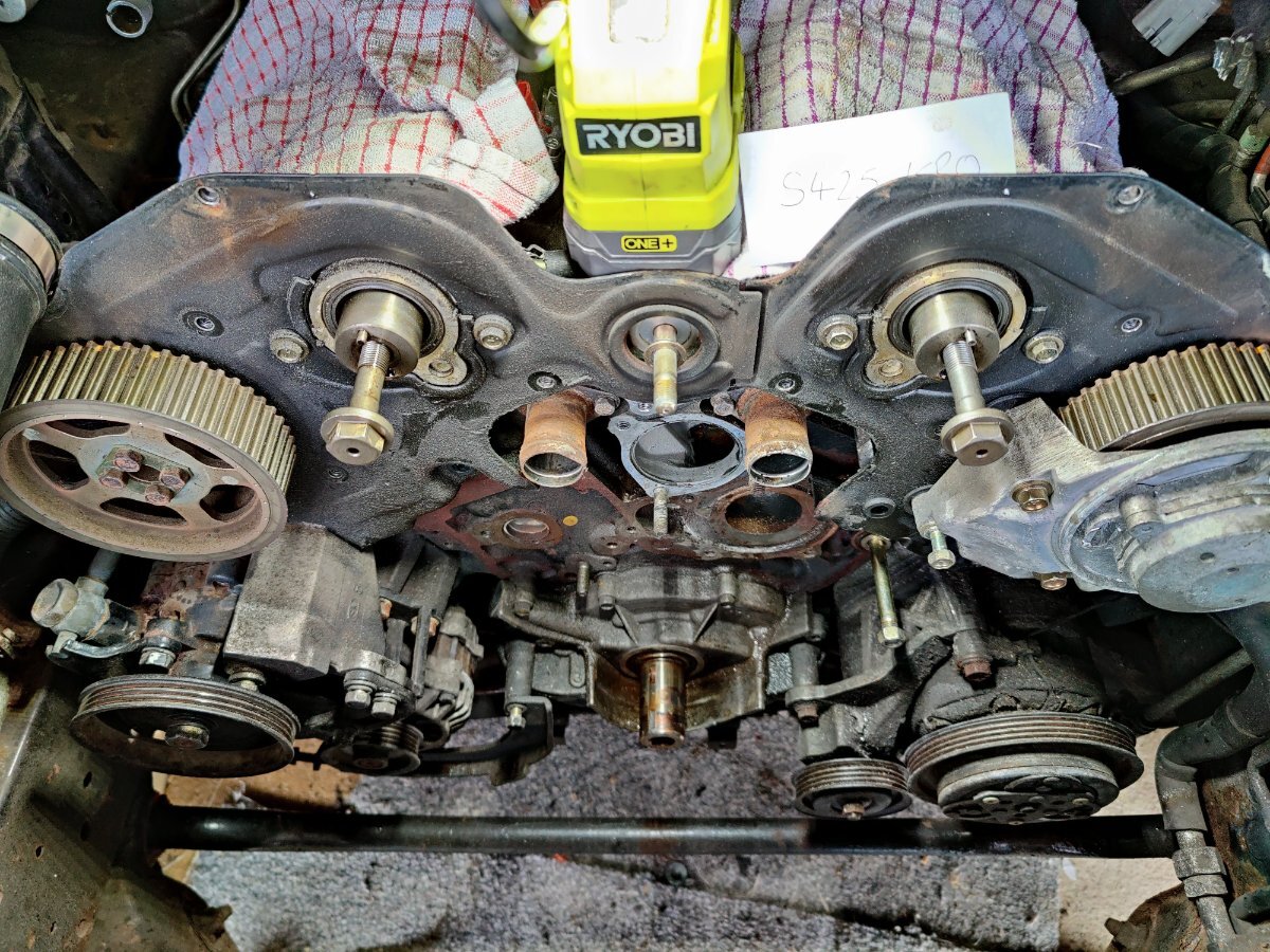

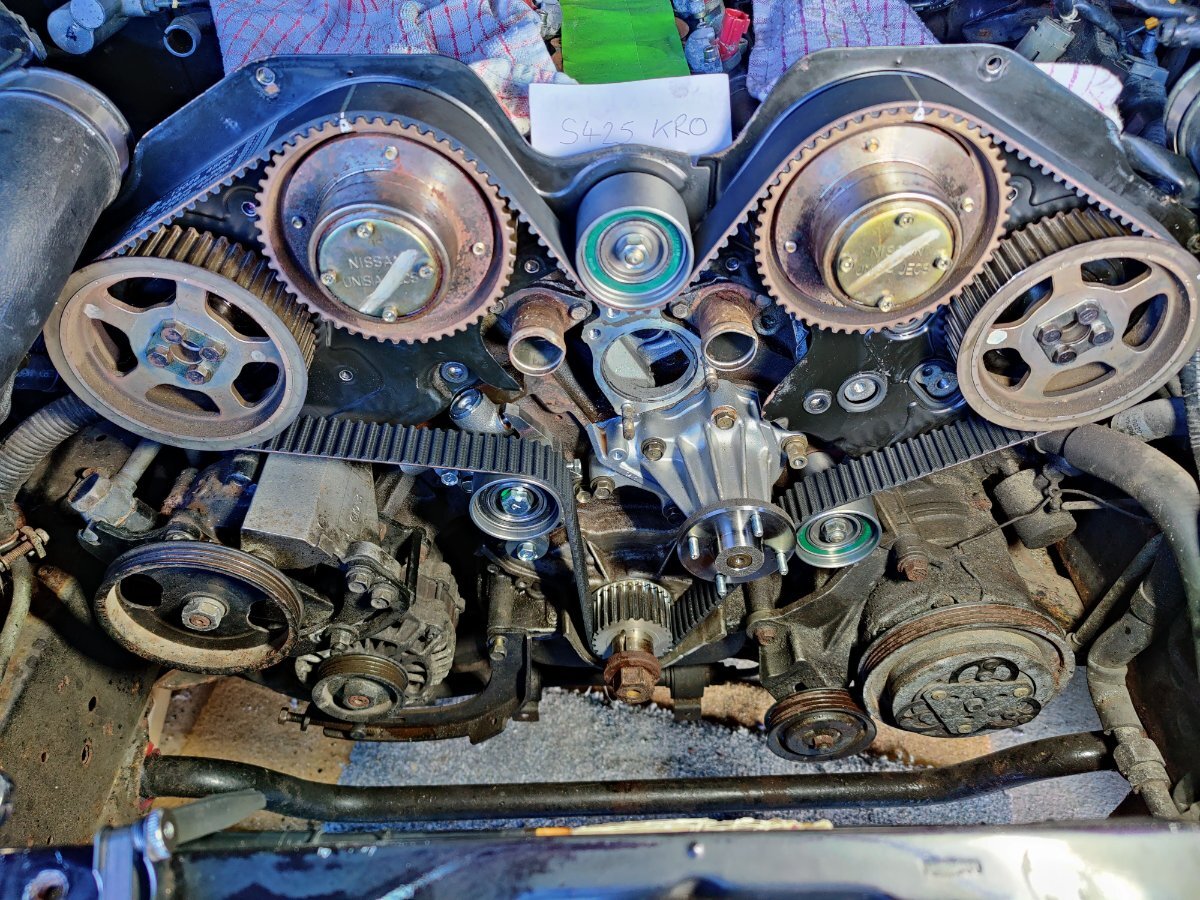

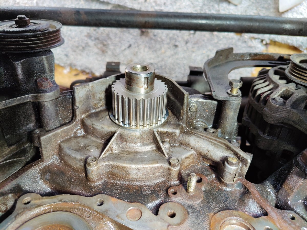

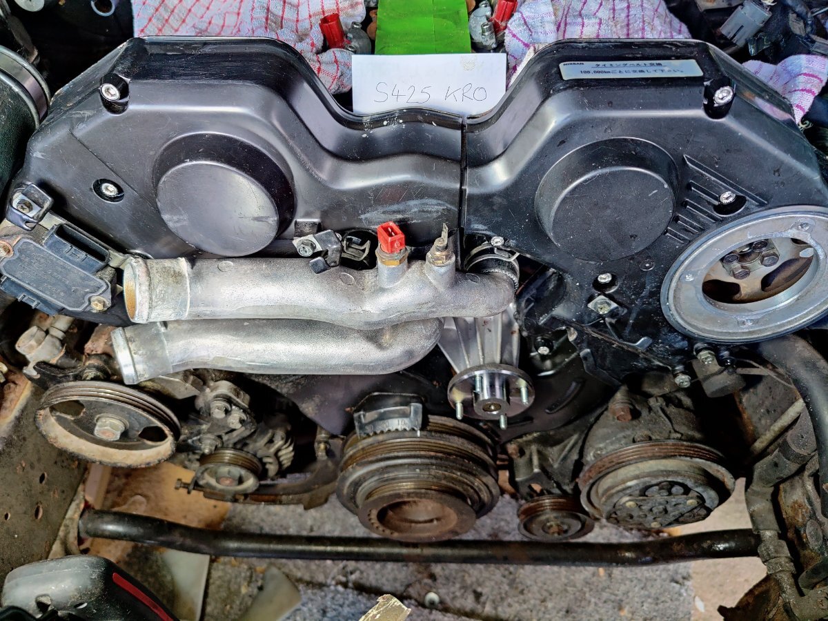

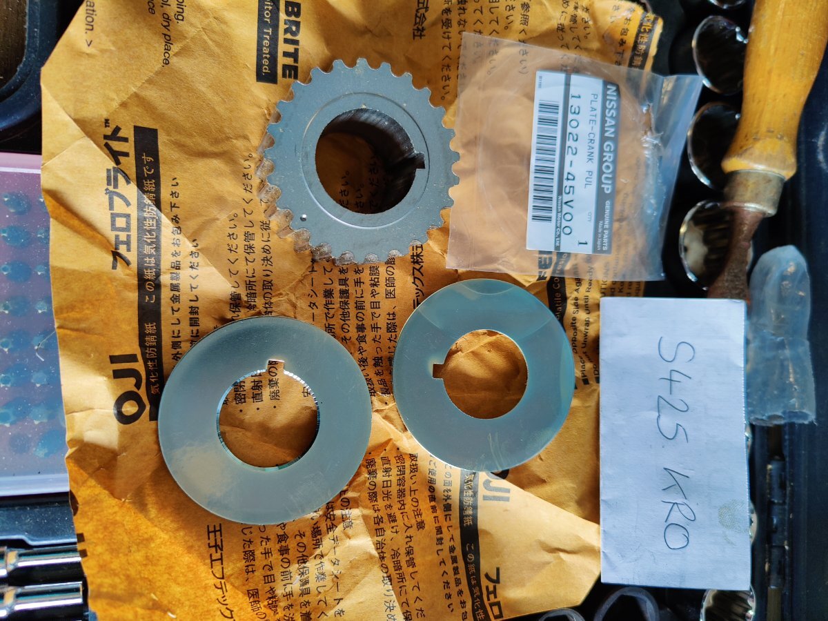

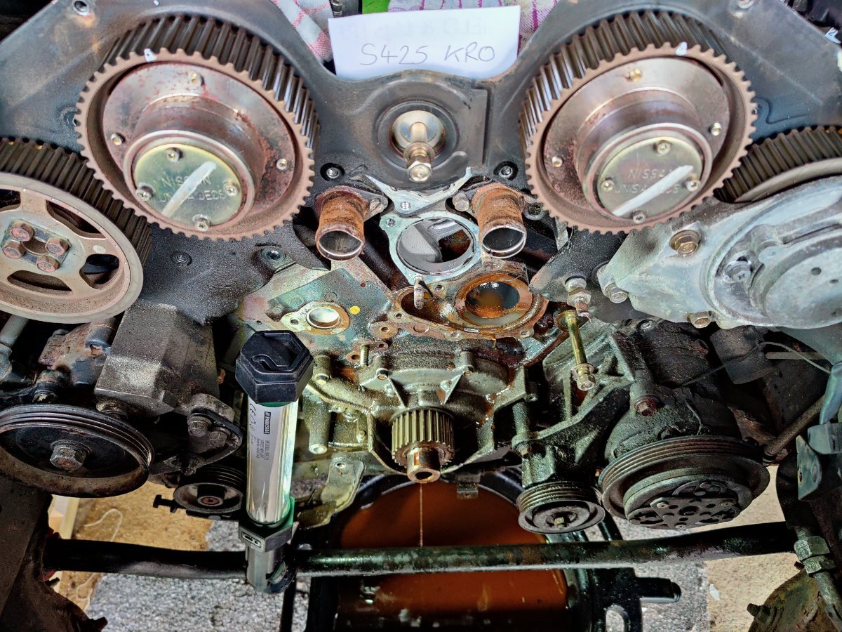

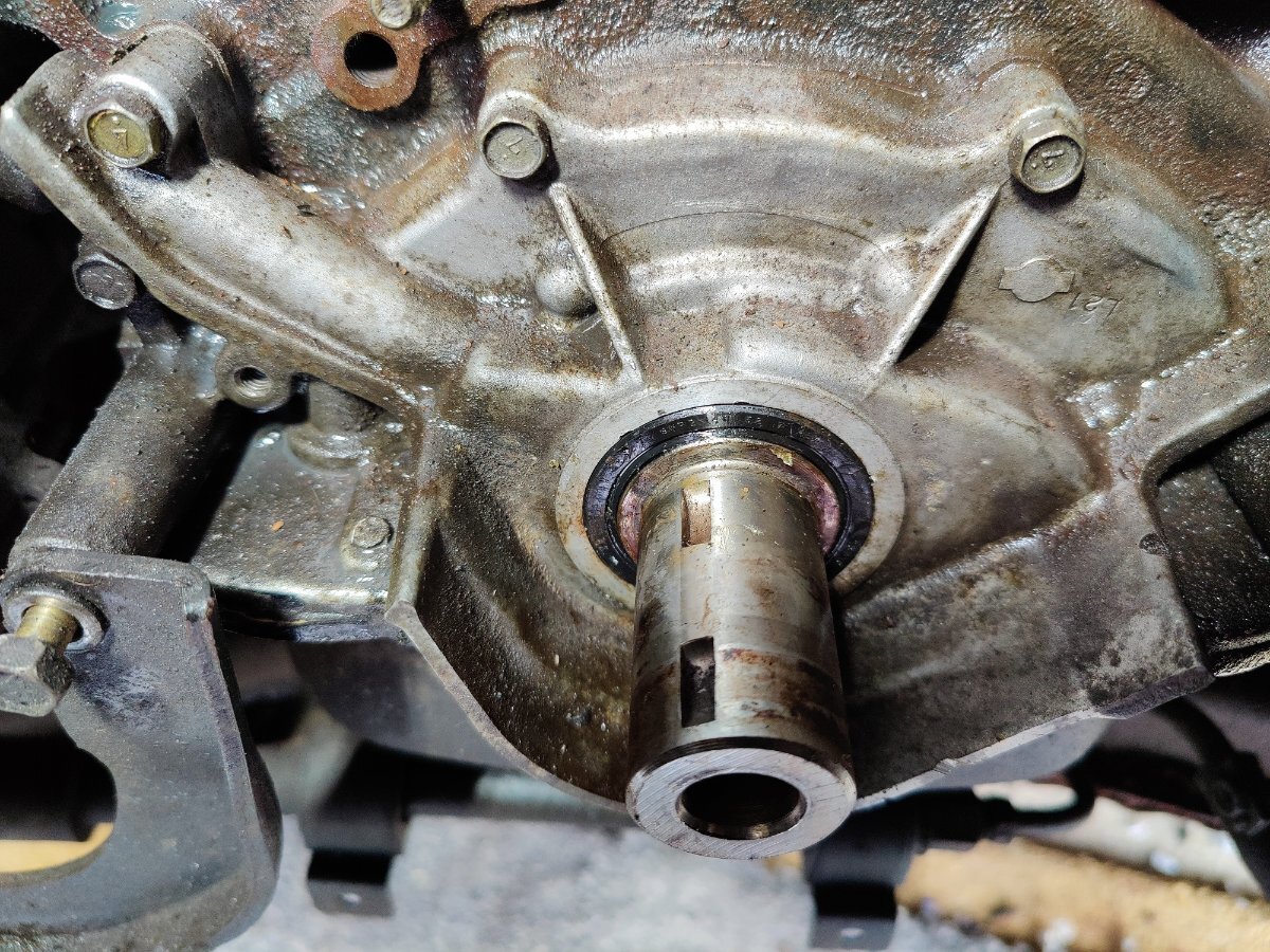

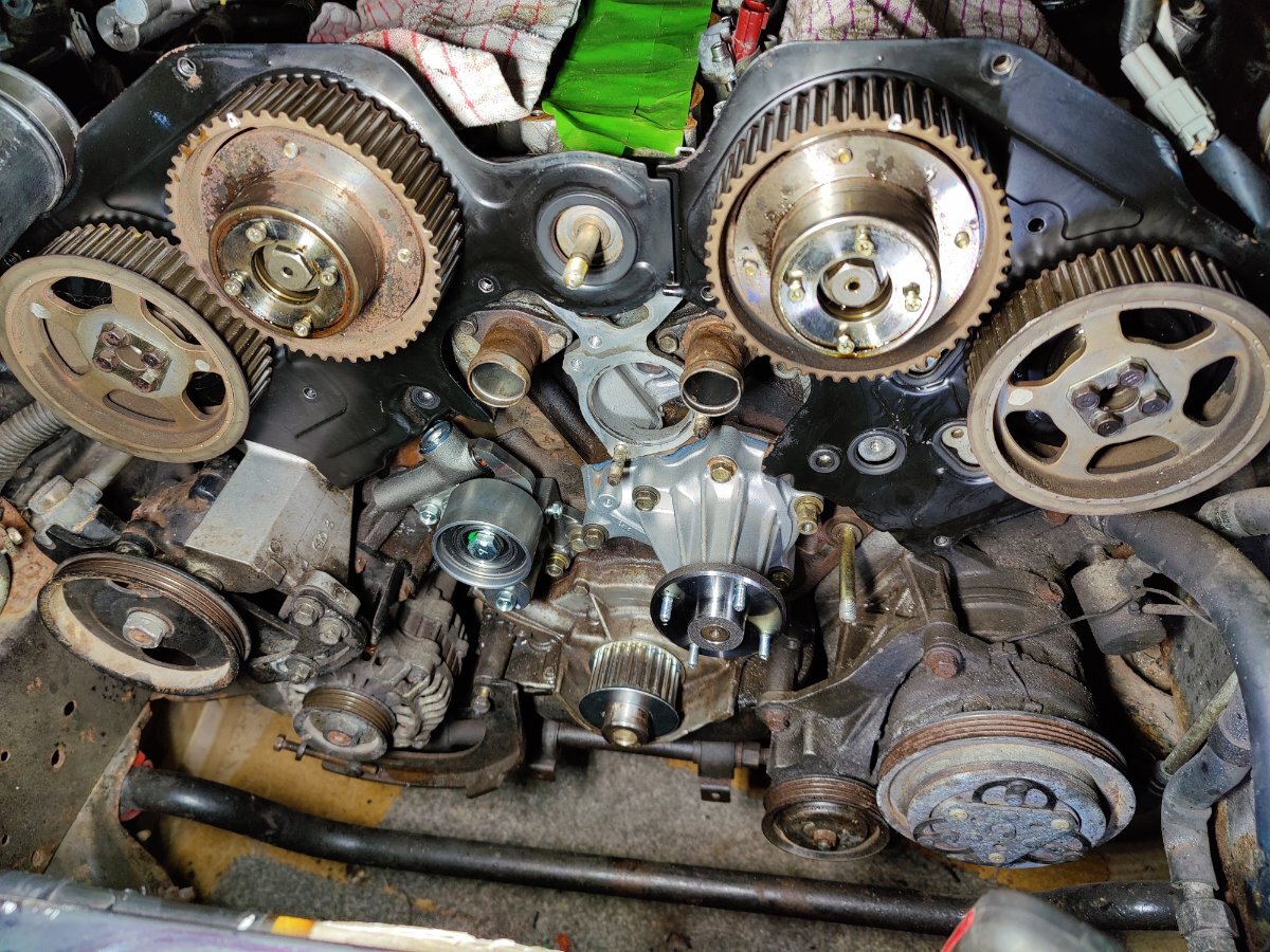

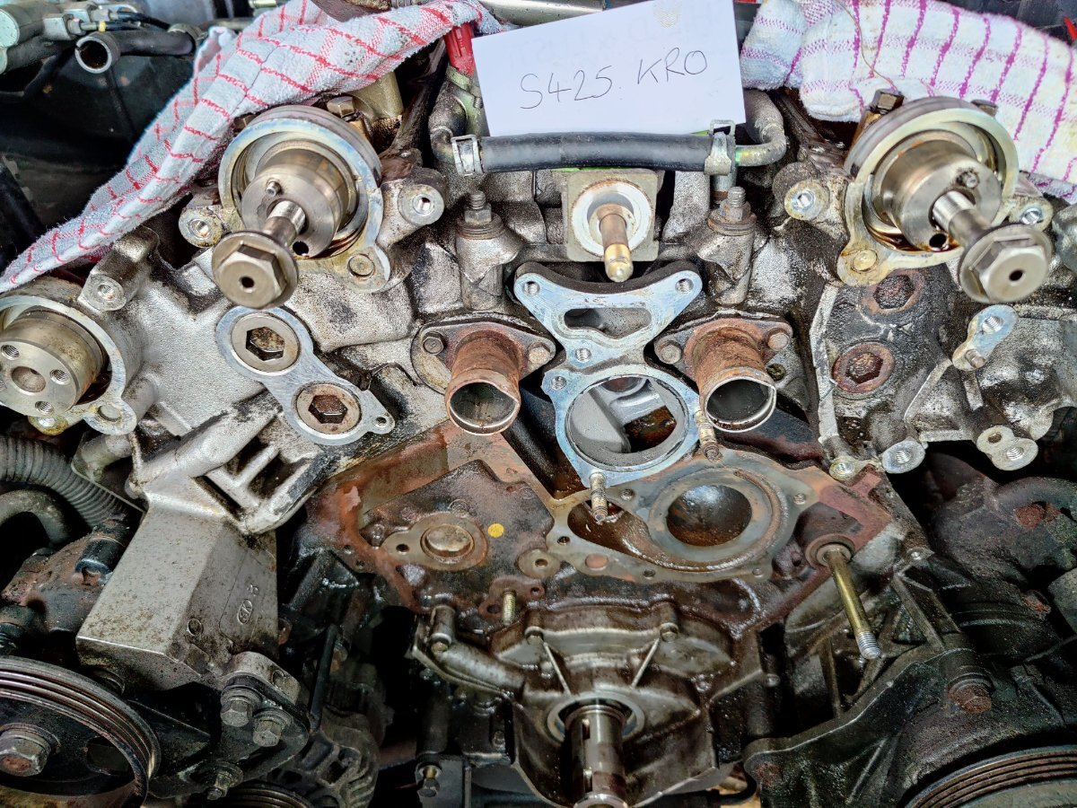

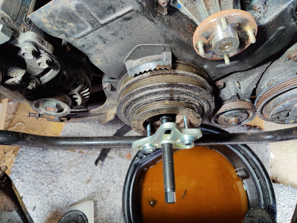

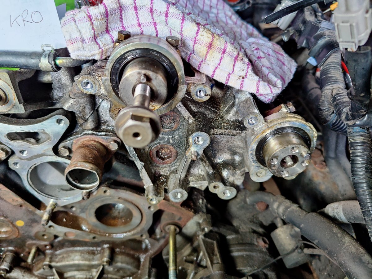

Had a bugger of a time getting the crank sprocket off. Initially started to drill it so that I could tap it and use a pulley. However I snapped a drill bit off (twice) so gave up and pulled out the dremel. A significant amount of patience later (and a cold chisel) and the sprocket came off.

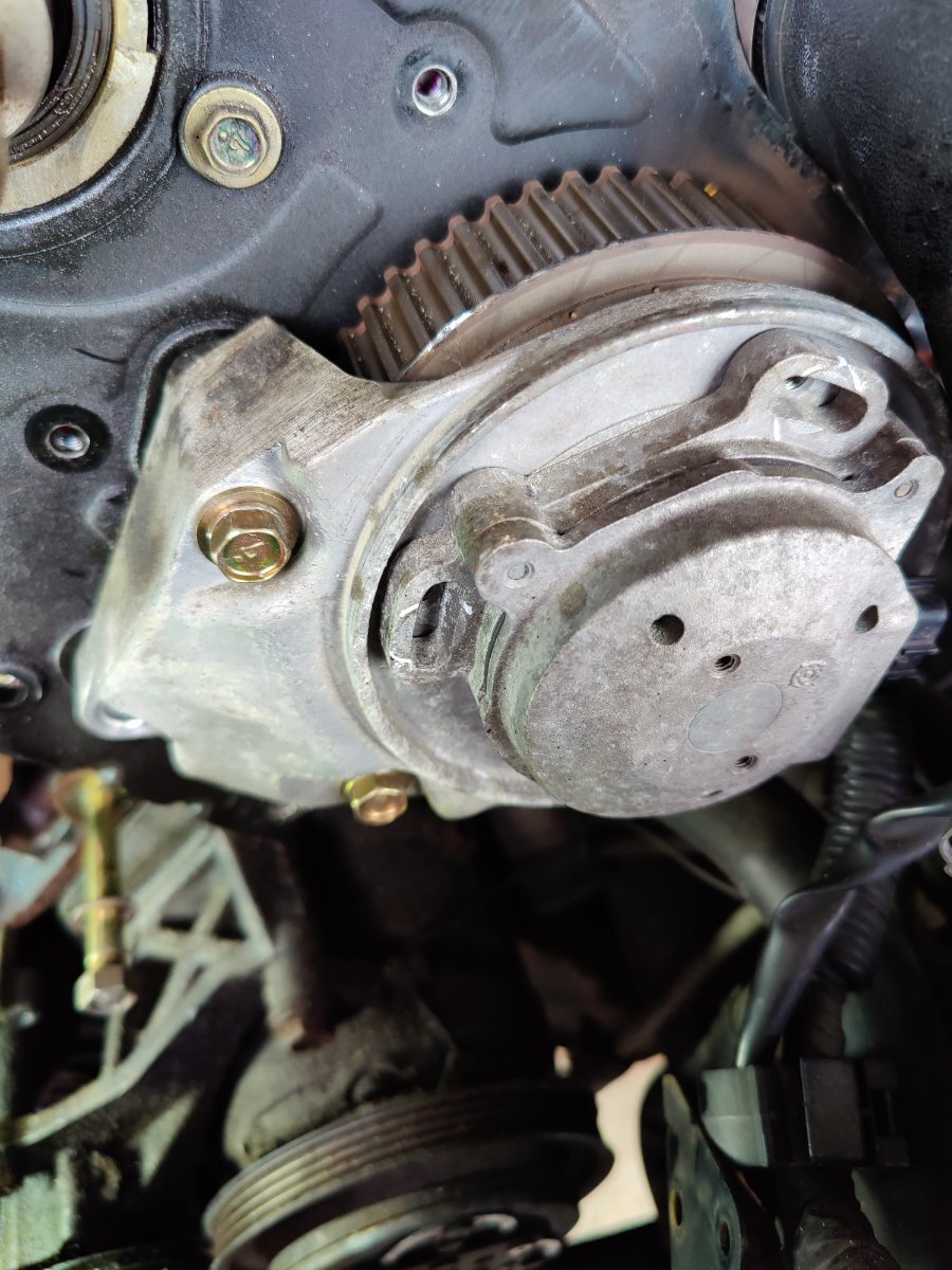

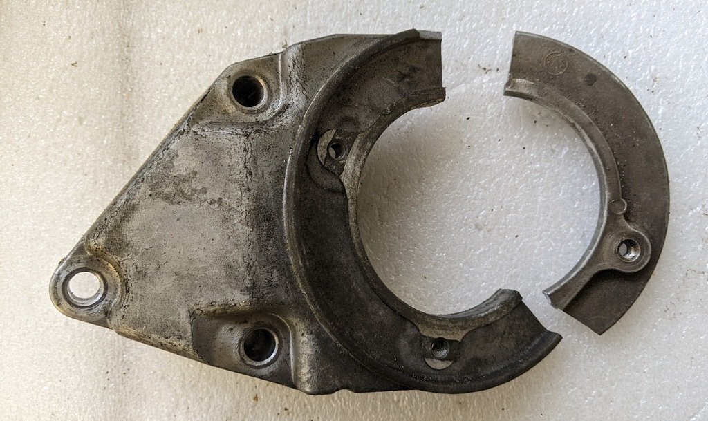

Next up was the CAS which is fully melded into its bracket. Managed with some fecking around to get the bracket off and not snap the CAS pin. It's still stuck in the bracket though so need to think of a way to fix that in the near future.

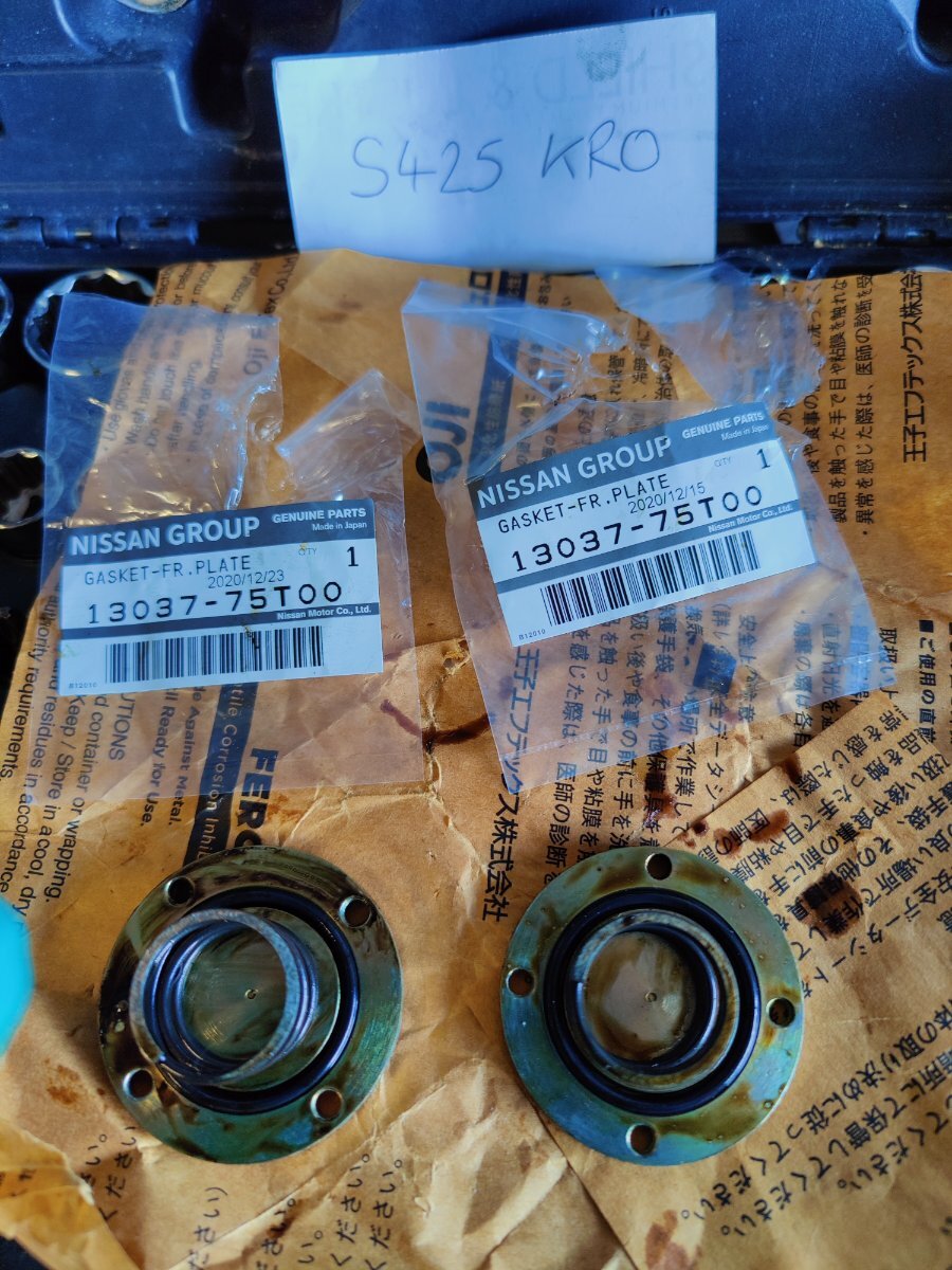

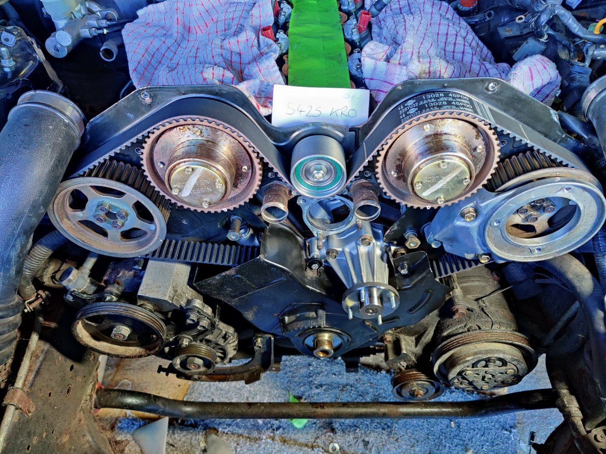

4 X cam and 1 x crank seals removed and replaced with new. New crank sprocket on. Cam gears fitted and torqued. New idler studs on. New water pump fitted. Tensioner correctly gapped at 4mm and loosely fitted.
Will see how things are tomorrow time wise but hopefully I can get the bulk of it boxed off. Still waiting for new ancillary belts from Luke so won't get to the point of getting the rad in. The valve covers will be back from the powder coaters tomorrow so I might get those on time allowing and can then concentrate on getting the plenum back on.
Pics will no doubt end up on a weird order so apologies for that. Seems to be an artifact of the software.
On 30/03/2022 at 15:48, Lexx said:
Re your stuck CAS to bracket. I had the same with a late CAS I bought s/h. To avoid damaging it I cut the bracket itself at two points
to just before the CAS and then split with a small cold chisel and light taps. The bracket is a soft alloy casting and splits easily.  Getting
another bracket would be an easier (and cheaper) option.
Edited by AndrewG
Thanks Andrew. I left it with some penetrating fluid around the edge over night and it came out today without too much fuss. I'll know if I damaged it or not when I get round to starting up.

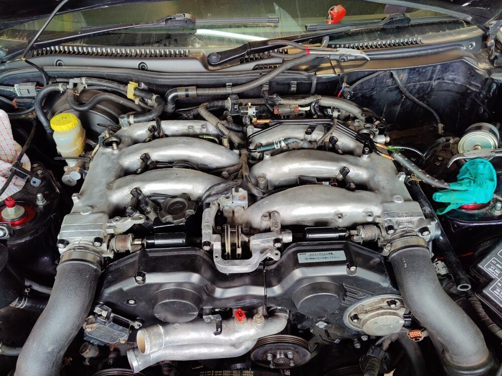

Got back on land yesterday and had a slack few hours to work on the car.
Valve covers fitted including new half moon seals.

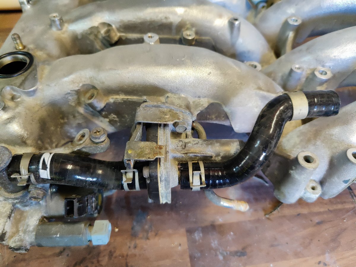

Z1 PCV silicone hoses fitted.
Z1 IACV silicone hoses fitted.
New Iridium plugs
Plenum refitted with new OEM gasket.
Coil packs in. All the wiring hooked back up (hate those God damn wire clips on the IACV!). Fuel hard-line refitted.
All the fittings have been replaced with Zspec stainless throughout.

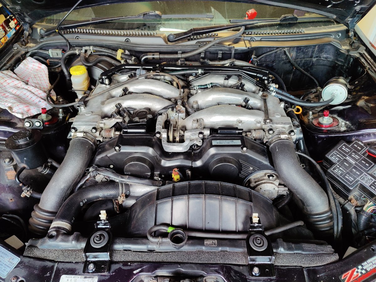

It's all back together. IMG_20220501_183704.thumb.jpg.8e26d9f6f23c24c4fc76b8db440df2f0.jpg
As discussed on another thread having some small issues. First being some white smoke from predominantly the passenger side of the block. It seems to be coming from around the manifold areas so I'm assuming/hoping it's just coolant that dripped all over there during the plenum pull burning off. Going to get my endoscope in there tomorrow and see what I can see.
The cars runs up to temperature fine and hold steady.
Other issue is the idle. On (cold) start up the idle runs up and down from 200-900 for 30 seconds or so and then settles down at 950. When blip the throttle the revs drop and stall after lifting off the pedal. Will start hunting for a vacuum leak tomorrow and hope it's that. Worst case the IACV is borked and I'll be £700 lighter by the end of the week.
Smoking has stopped after 30 mins running today. So putting that down to spilled coolant burning off. Phew.
Erratic idle is being a pain in the ***. I've adjusted the timing as best I can to 15° BTDC. But with the idle wandering a bit it obviously causes the timing to wander as well.
Found one vac leak and sorted that. All the PCV and IACV hoses are brand new silicone items for Z1. Balance bar seals are new and torqued to spec.
I'm looking at the IACV or the CAS now I suppose. I'm a silly sod and didn't clean the IACV when I had the plenum off. So I'll get Luke to send me a gasket and pull the IACV for cleaning.
