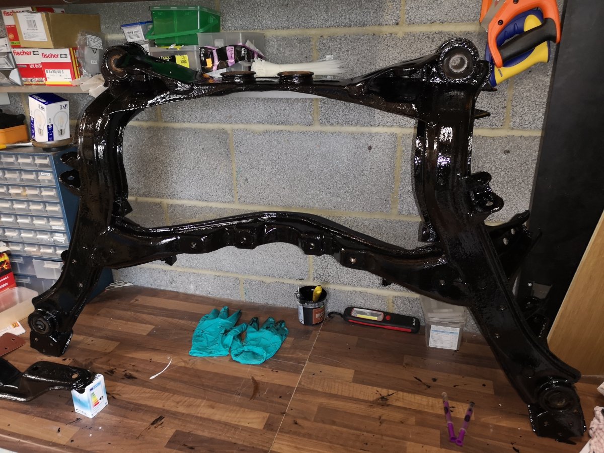

Just a little update.

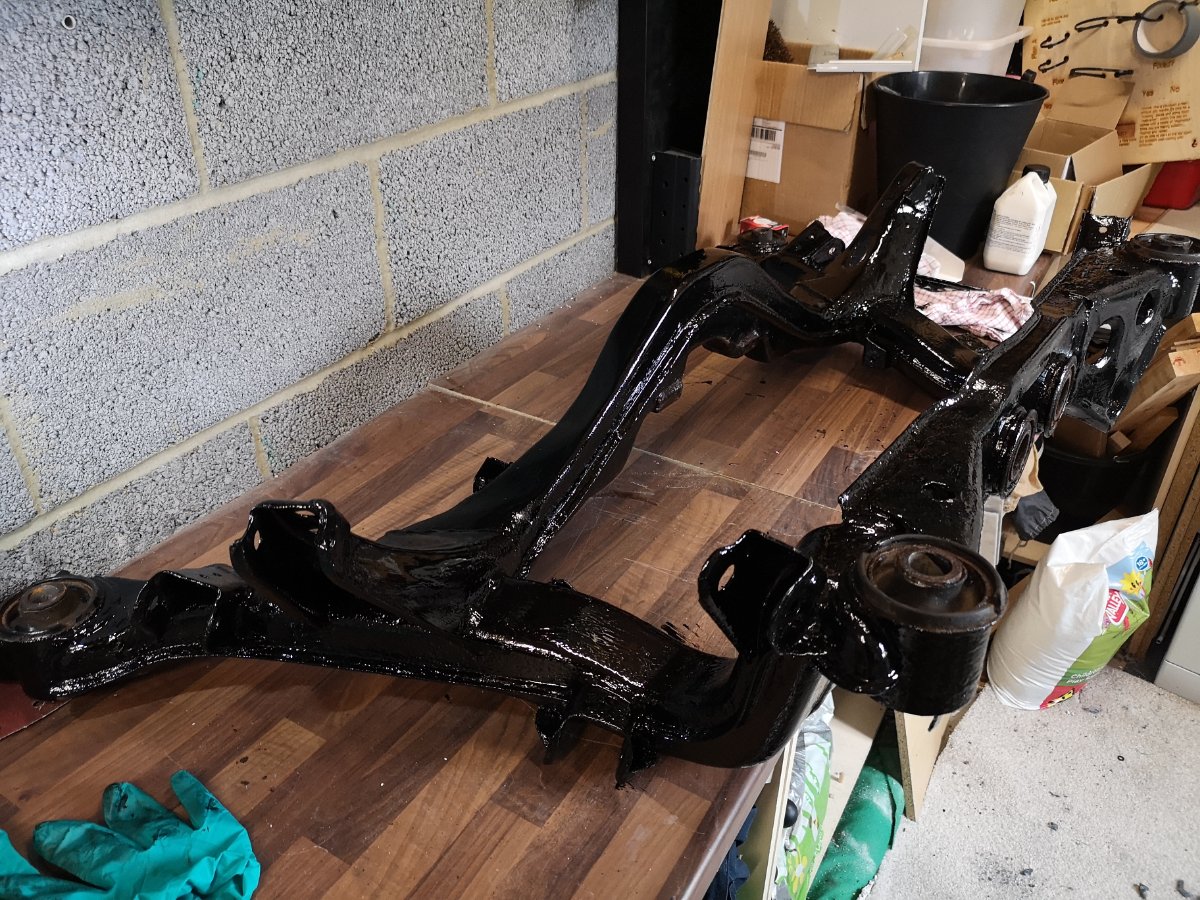

Rear subframe prepped and treated today. Will get first coat of Jotun 87 tomorrow on it. Hopefully get chance to put a second coat on before heading off to work. Decided to stick with the OEM subframe bushes. Have done a thorough inspection of them and they are still in usable condition. Especially considering the limited mileage the car will get going forward.
All my new bushes for everything else should arrive whilst I'm away at work. I'll strip and paint the arms whilst I'm at work so I can throw it all back together when I get back.

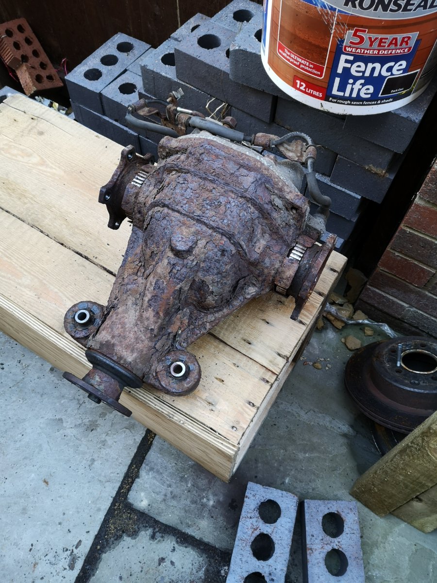

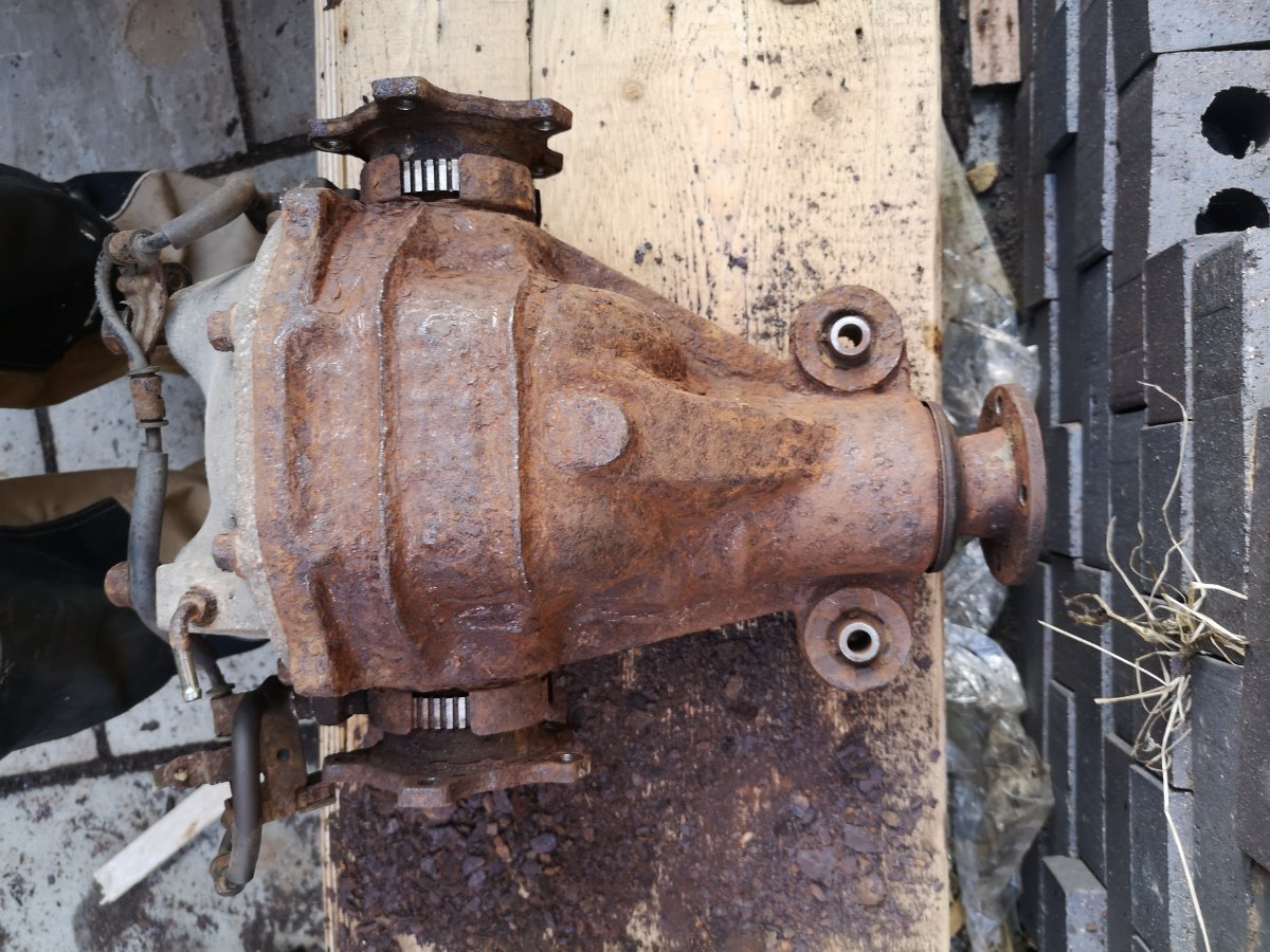

Also started to remove the scale from the differential.
Edited by Lexx

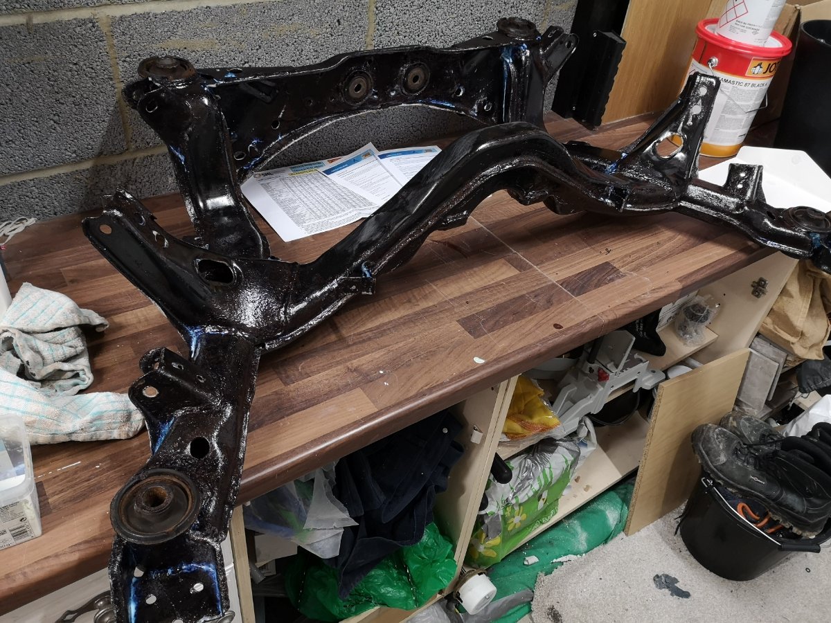

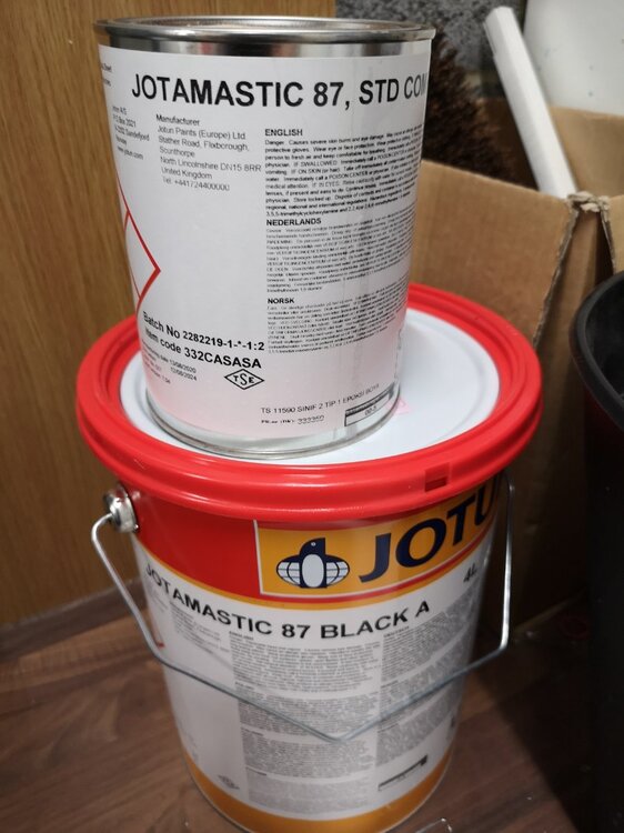

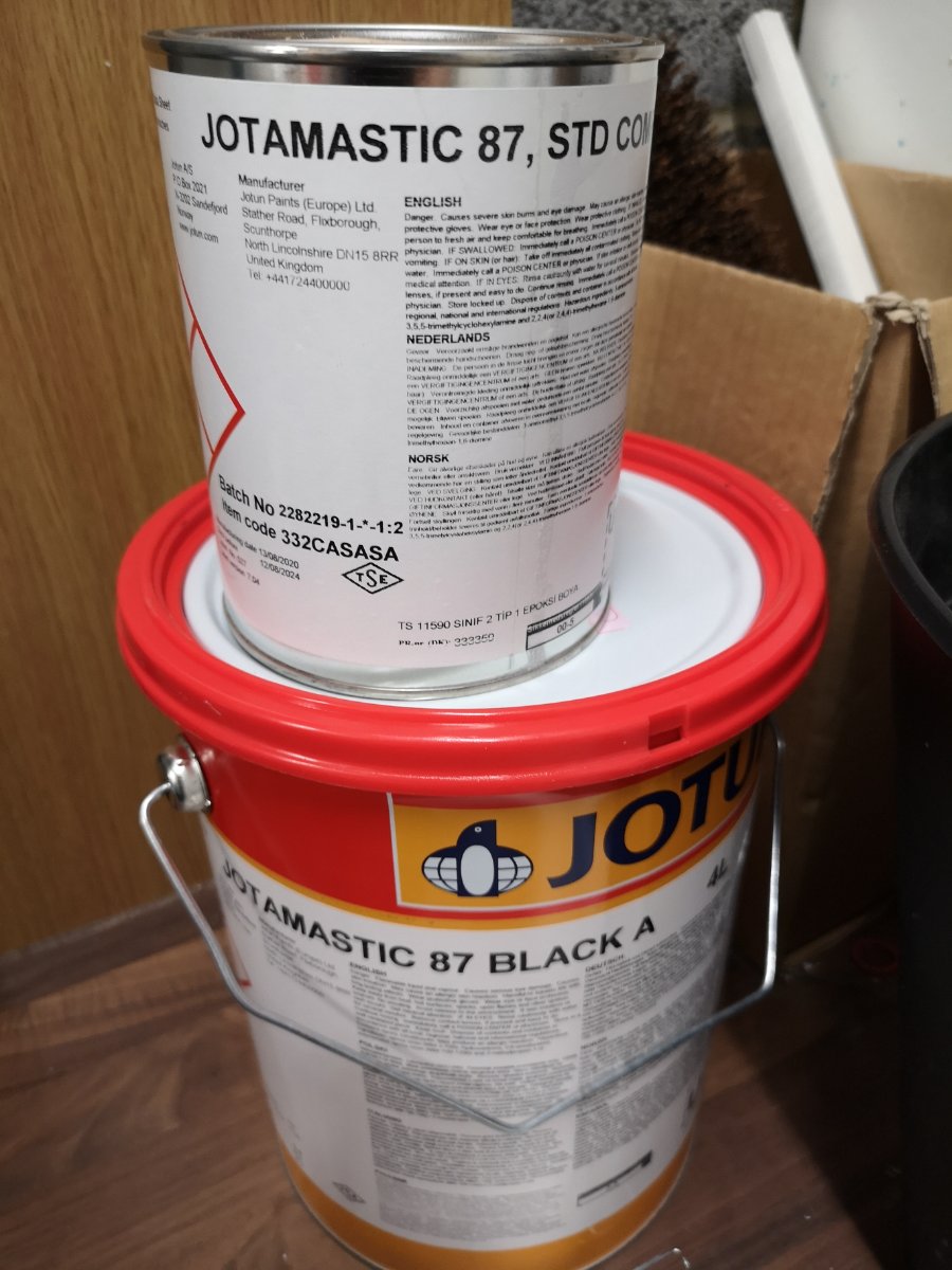

Subframe and differential bracket has had first primer coat (Jotamastic 87). This will go matt when dry.
Hopefully I'll get time tomorrow for a second coat. Then will leave to cure for 3 weeks and then 2 coats of Interthane 990. That'll give a gloss finish.
Original bushes are in good condition so they are remaining.
Feel like I'm making progress now. Just all the suspension arms to strip, paint, rebush. Then the diff. And the half shafts. And the chassis..... Jesus. Not as much progress as I thought!
Edited by Lexx
Adding pics

All these bits have now had the 2 coats of Jotamastic 87. They'll get 2 coats of Jotun Hardtop at the weekend.

They're brush painted bud. One of the reasons I chose Jotamastic 87 for the primer and Jotun Hardtop top coat. Can all be brushed on and as long as being careful shows the minimum of brush strokes anywhere.
I don't have access or space for a spray set up unfortunately. I spend a significant amount of time at work painting large bits of boat with rollers and brushes so whilst it's a damn sight slower than spraying I'm pretty good at getting a decent finish.

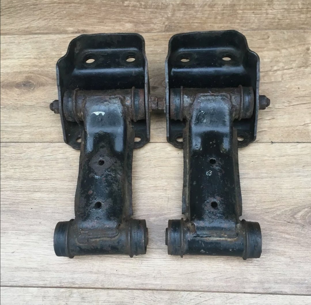

Had a pair of OEM front upper control arms delivered from ebay. Going to clean them up when I'm back on the boat and fit a Whiteline adjustable camber Bush set.

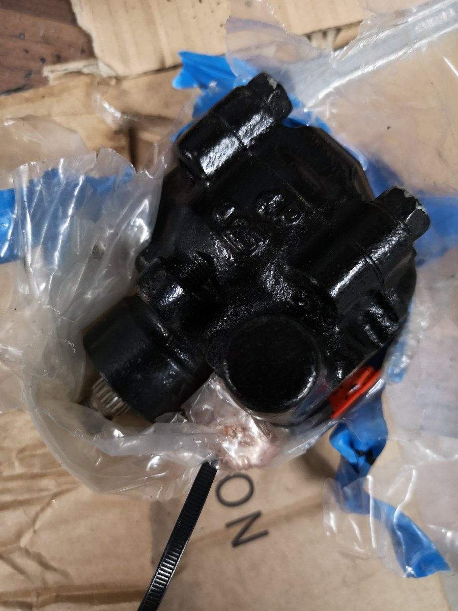

Refurbed OEM steering pump rcvd and ready to go on when I get the 120k service done later in the year.

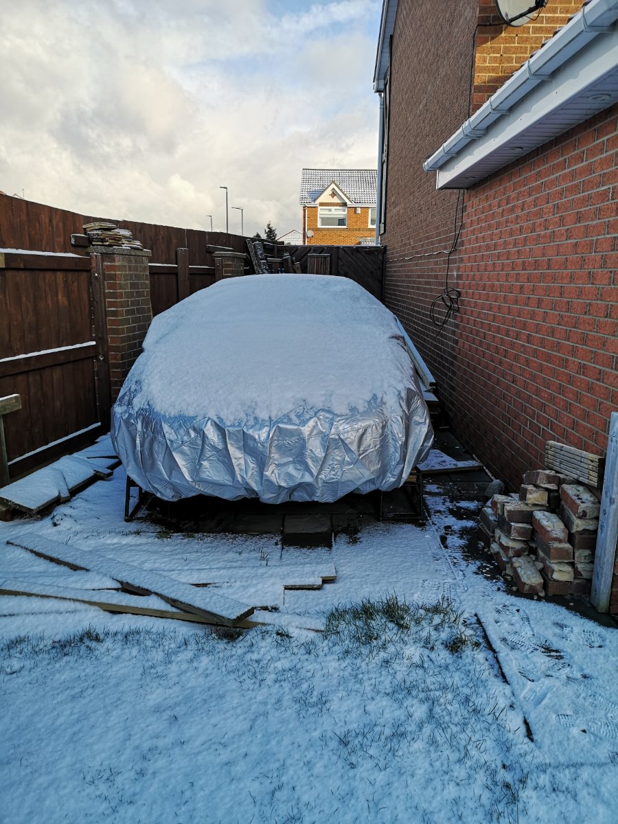

That spot you have for your Zed is just asking for a lean to car port! Would make your life much easier. Im hoping to build an almost fully enclosed one after winter and cannot wait for the sheltered space to work on the Zed or daily.
1 hour ago, naz27 said:
Looking great emoji1417.png. Mine has those same whiteline adjustable fuca bushes too, fitted by last owner and can report all good - was one of the few things I reused.
Funny you should mention a car port.... I've got a full set of plans for it drawn up!
Can't start it until the car has wheels again though. Hopefully when lockdown etc will be done my usual partner in crime from work will be able to come down and give me a hand building it.
Got to be a coincidence! First we both sort our suspension out and now we're building car ports - what's next!
What's your car port design then? is it a lean to one you got planned or something more enclosed? I'm not sure on the route i'm doing for mine yet, got to review all the options soon.

Front adjustable bushes for the OEM fucas that I've overhauled to replace the cheap Midori style ones that came with the car.
