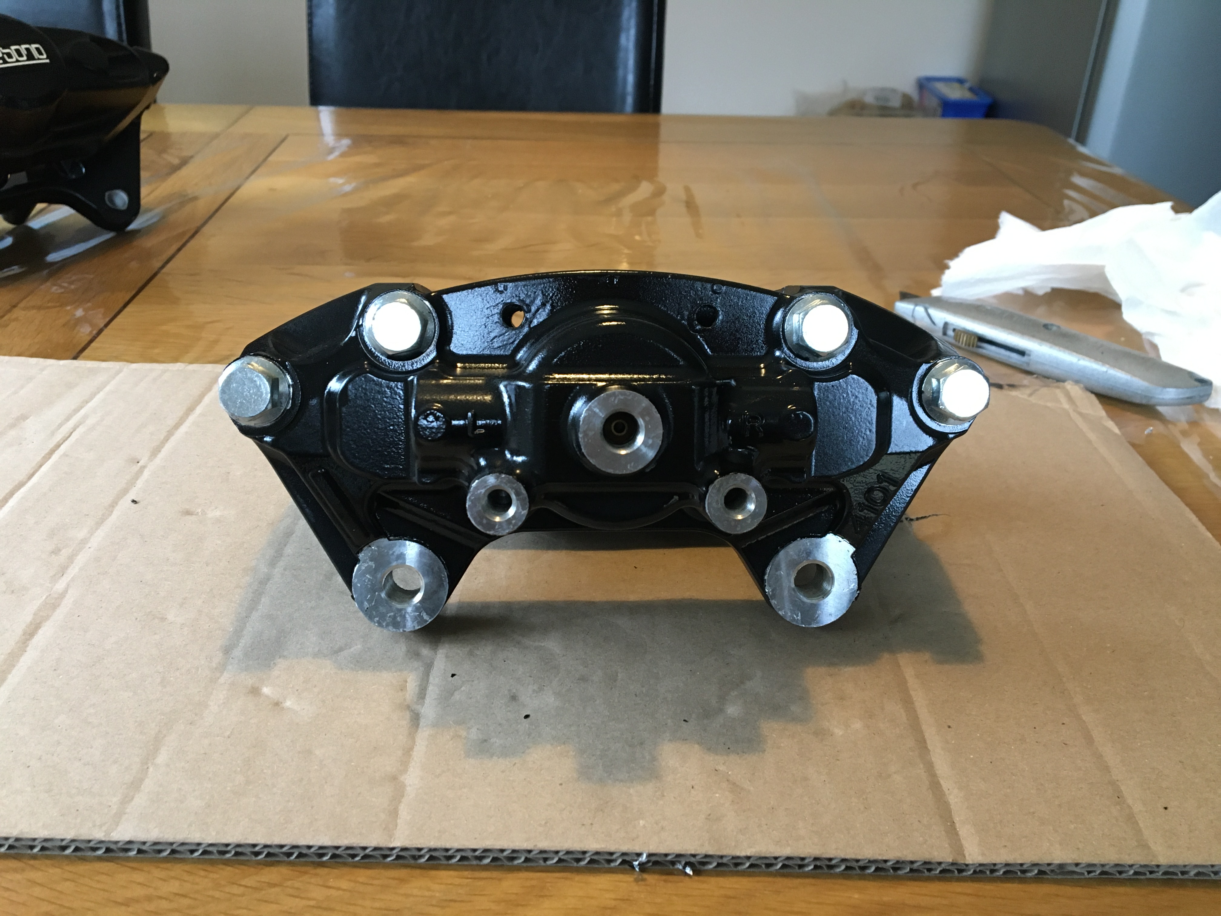

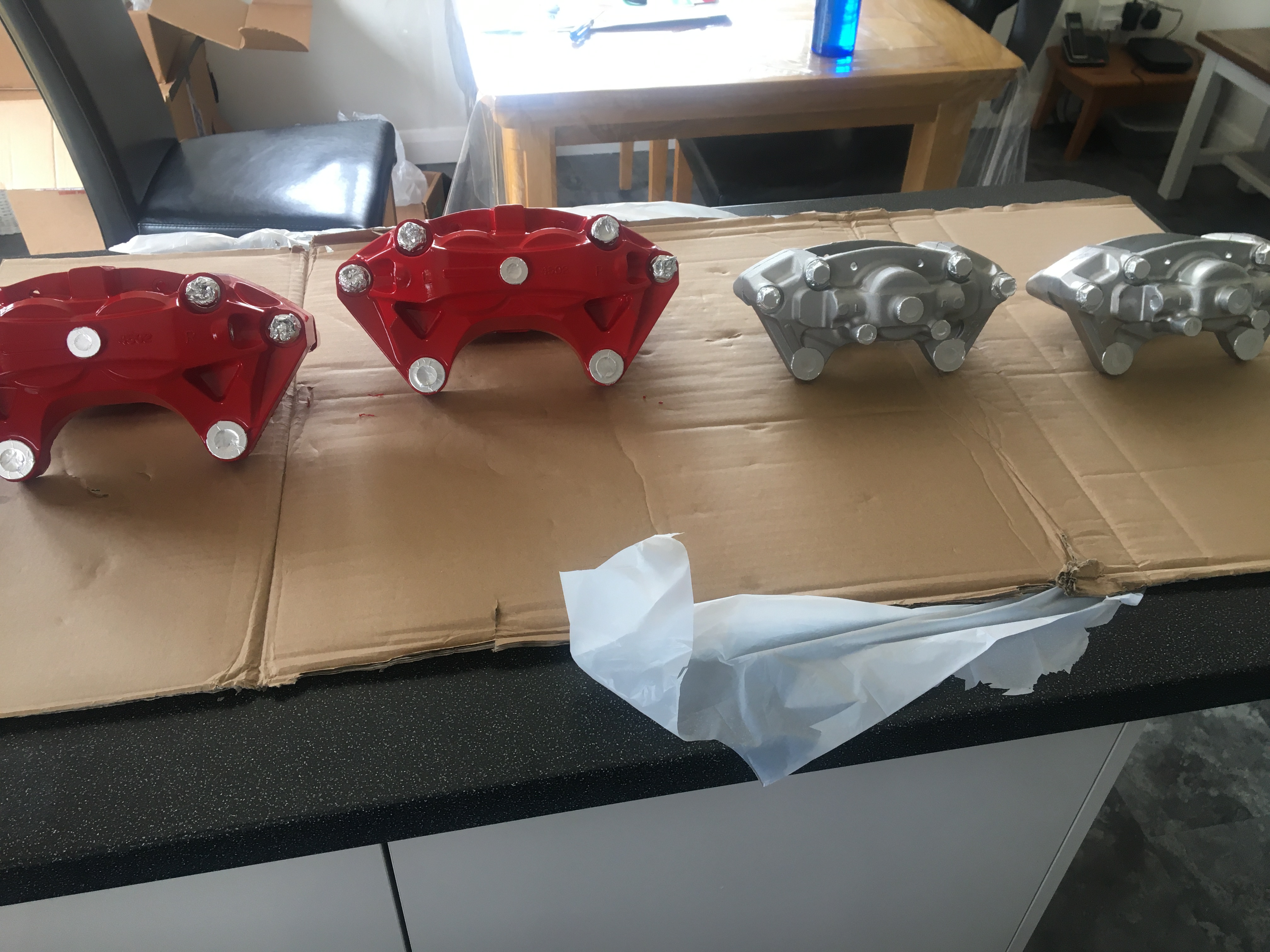

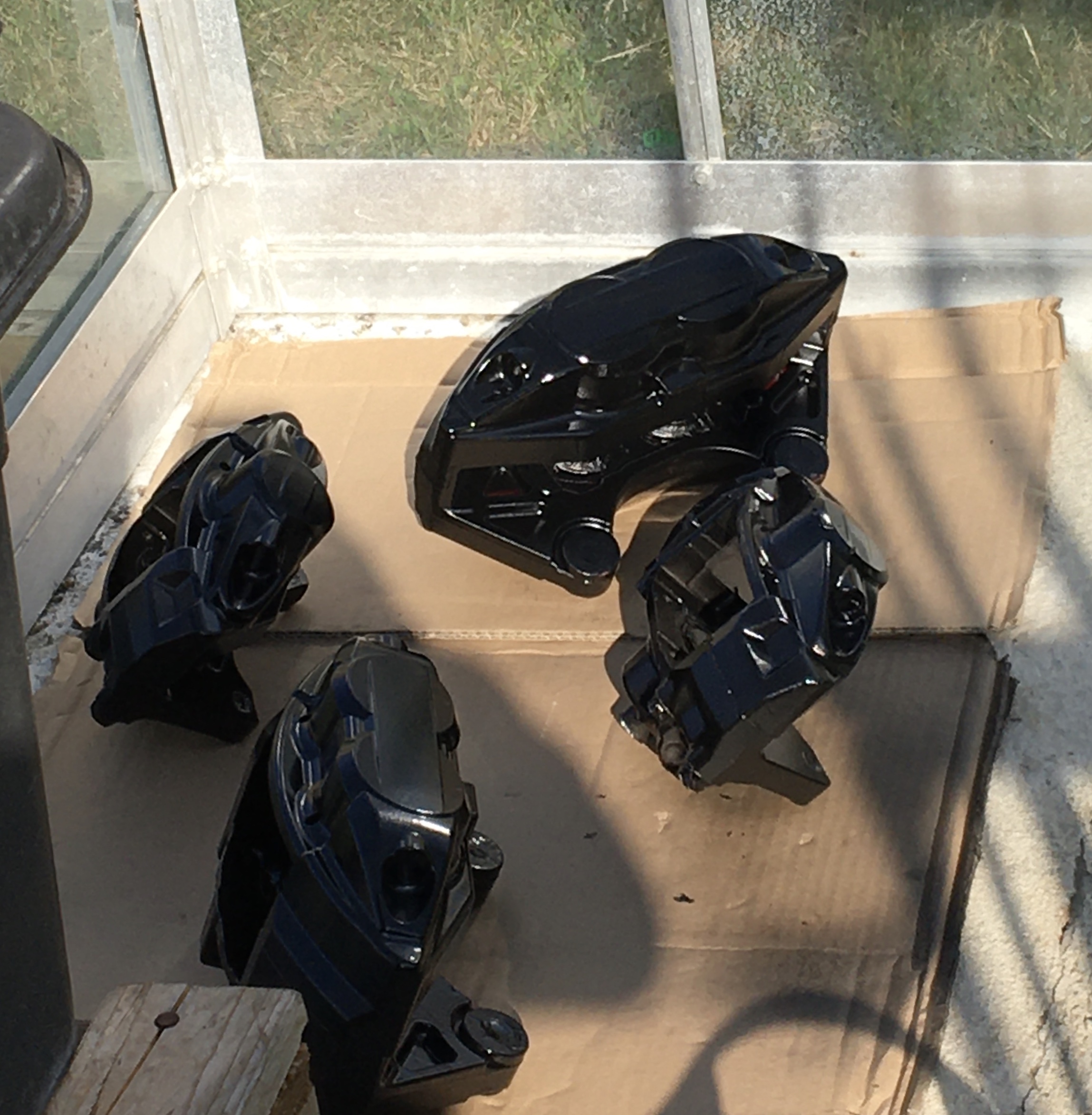

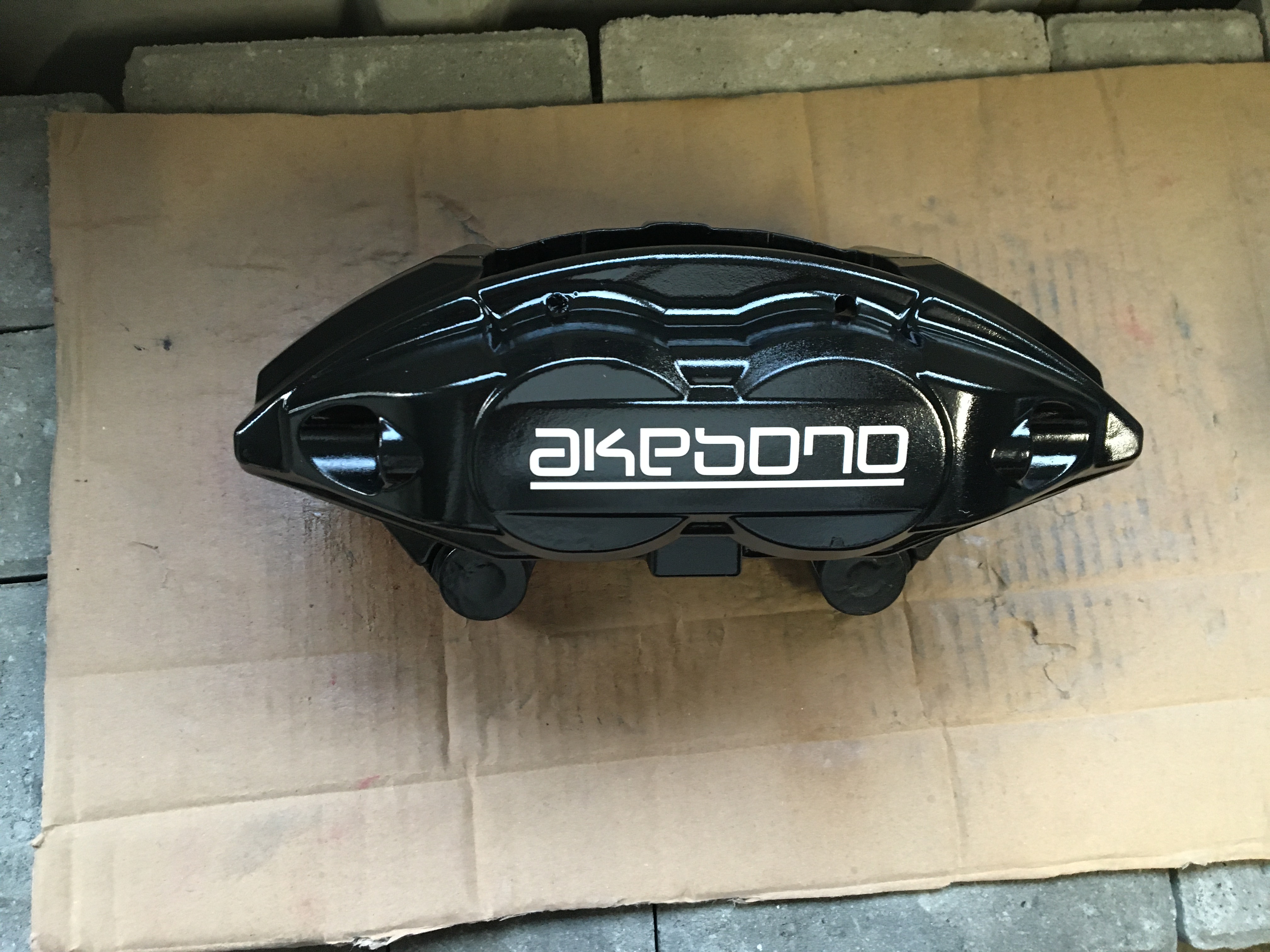

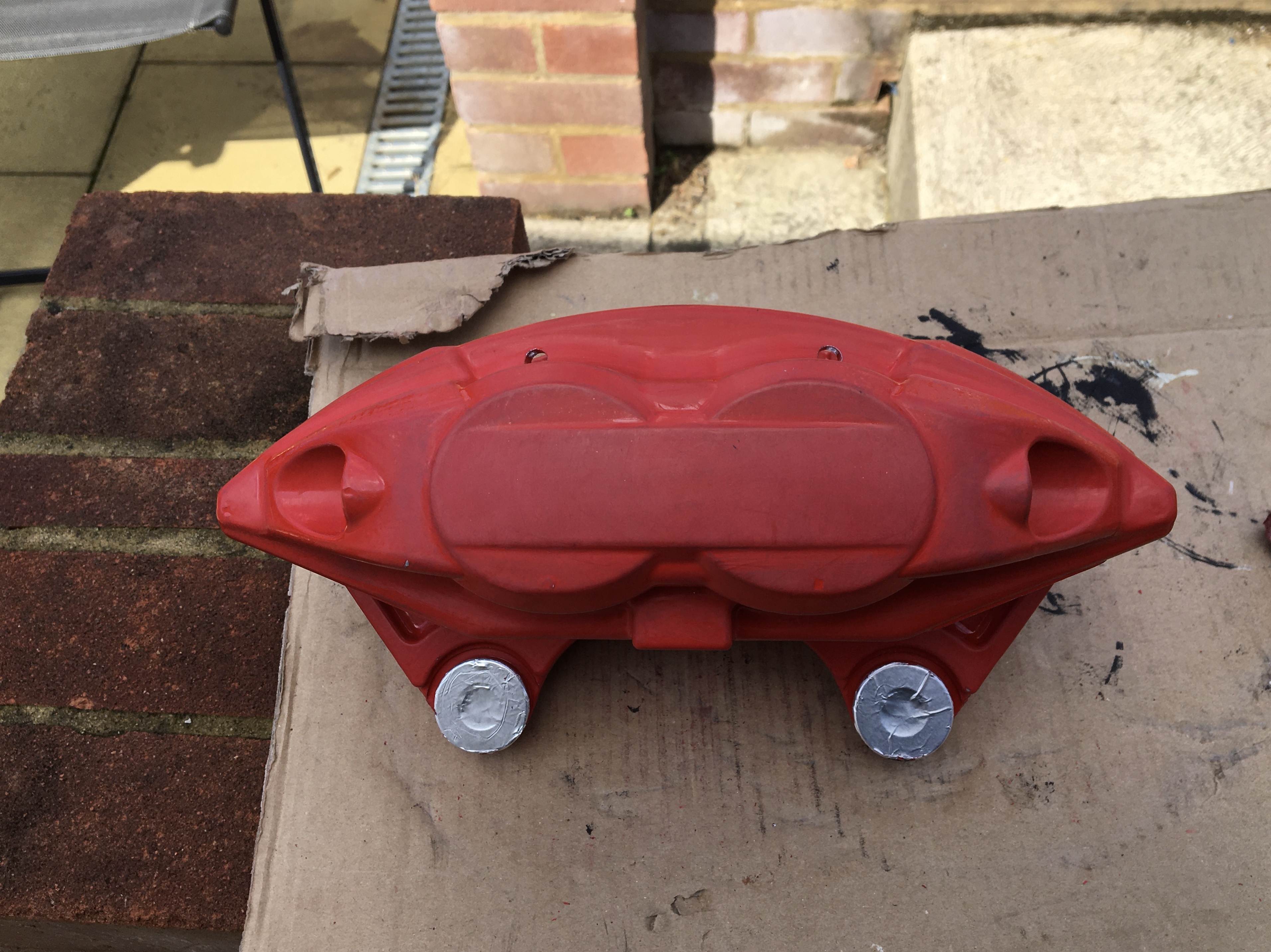

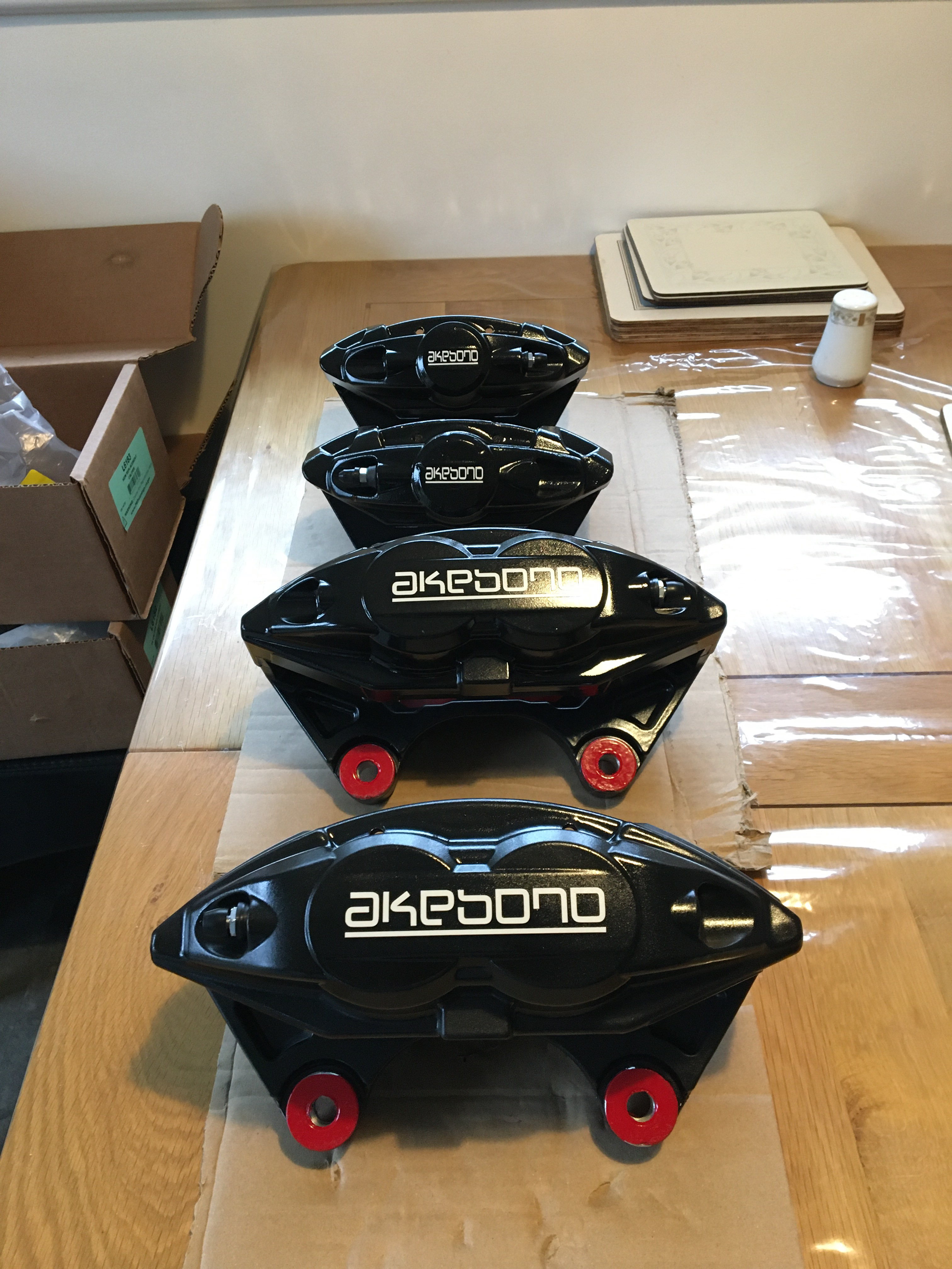

The callipers were fully masked to all the important parts, sanded throughout and given multiple coats of gloss black paint. They were cured with the aid of a hair dryer/heat gun and the green house! Once satisfied the paint was cured sufficiently, some new Akebono stickers, followed by a very high temperature gloss clear coat was applied. These needed heating to 93c to fully cure.
The downfall of this little project was the masking around the pistons - currently there’s an area around the pistons with the old paint visible, as I was so paranoid when cutting the tape during masking with the Stanley knife, that I’d cut the dust seals. This won’t be visible when behind the wheels so not too concerned! The front callipers had the red powder coat on the mating surfaces, so assume this will be removed before install - these were masked to ensure no paint entered the threads.
Overall very happy and cannot wait to have a great set of anchors on all 4 sides!
Hopefully have these on soon with photos to follow [emoji41].
The pads will cover up that when installed.
Yep aware of that thanks - point was more just knowing it wasn’t a perfect job. Oh well, the visible bits look good and should be a durable finish so happy overall.

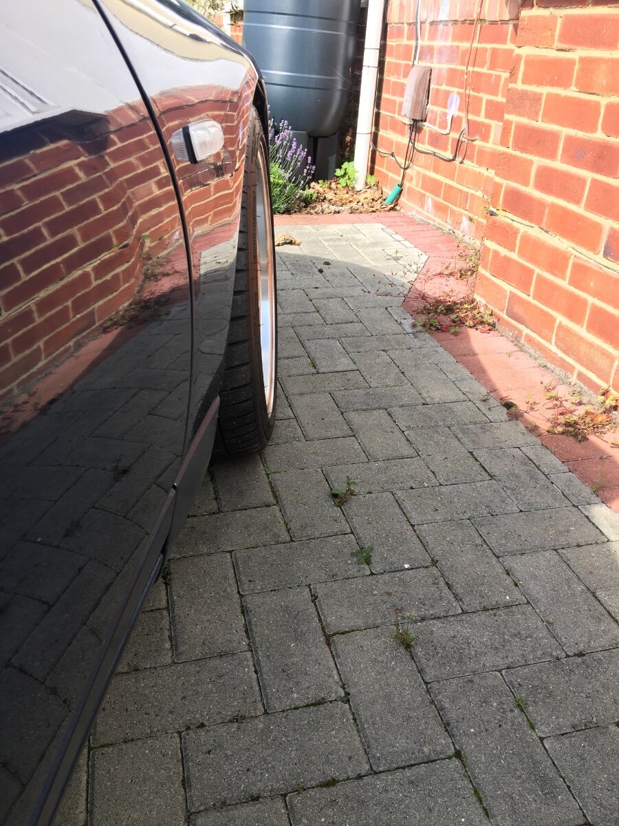

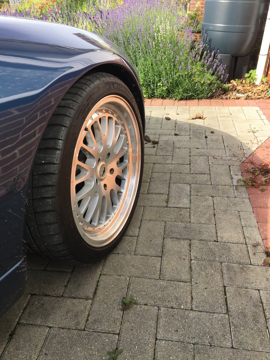

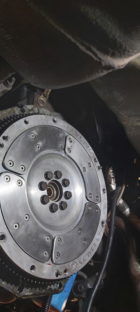

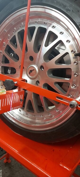

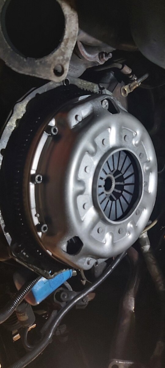

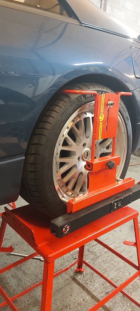

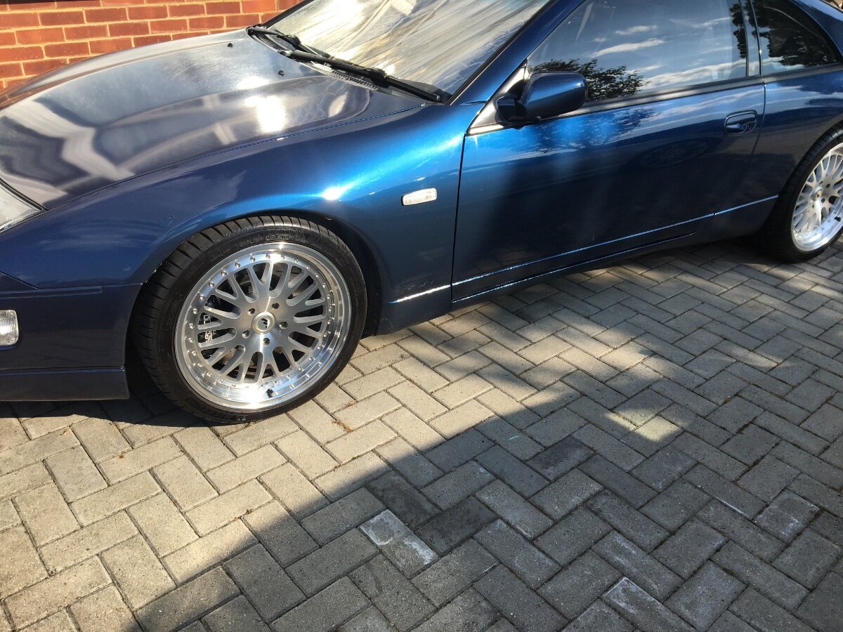

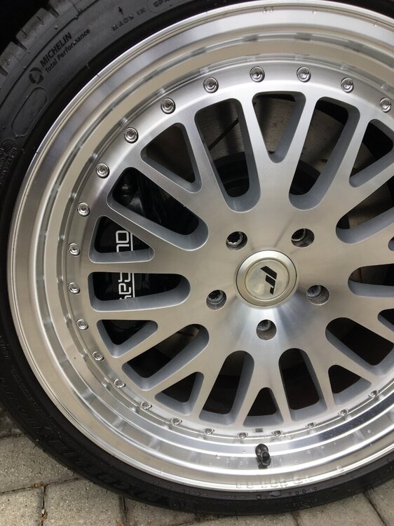

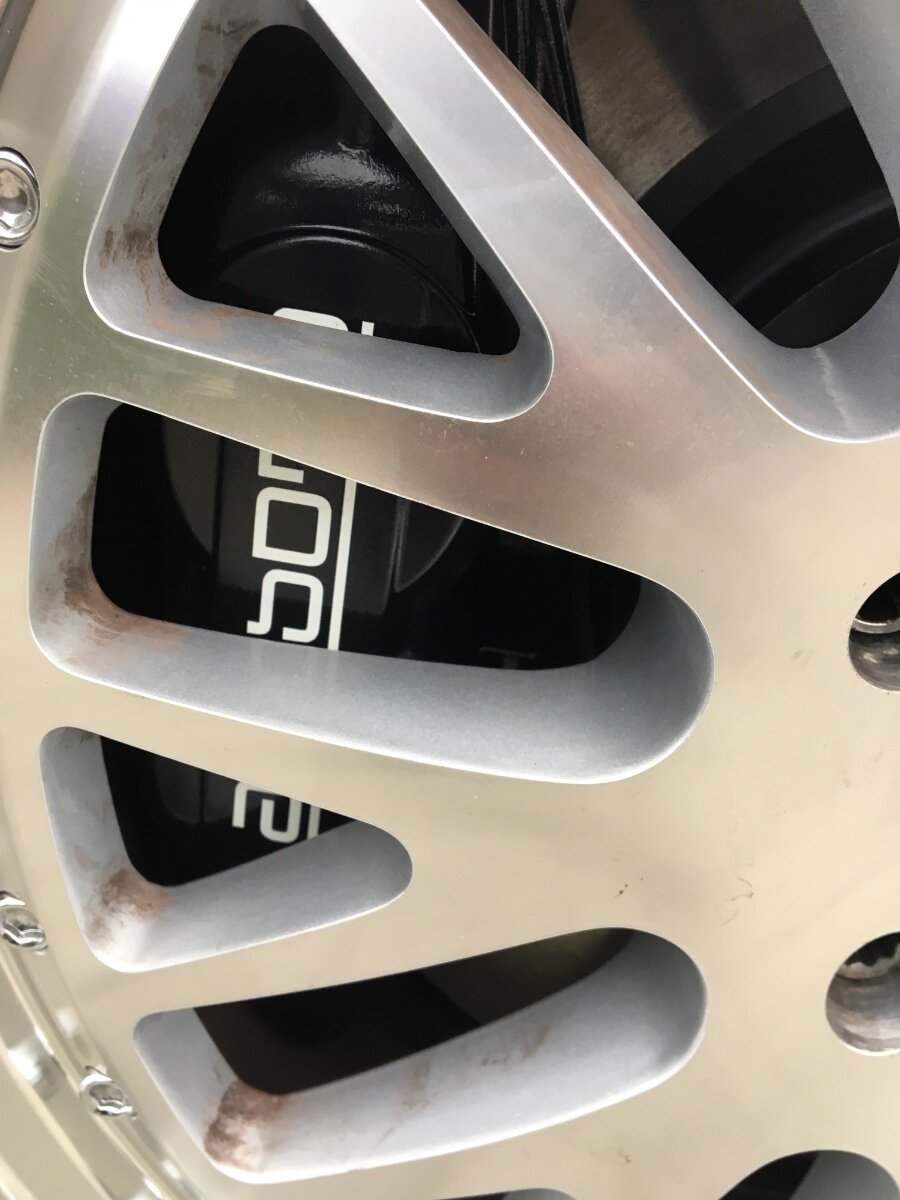

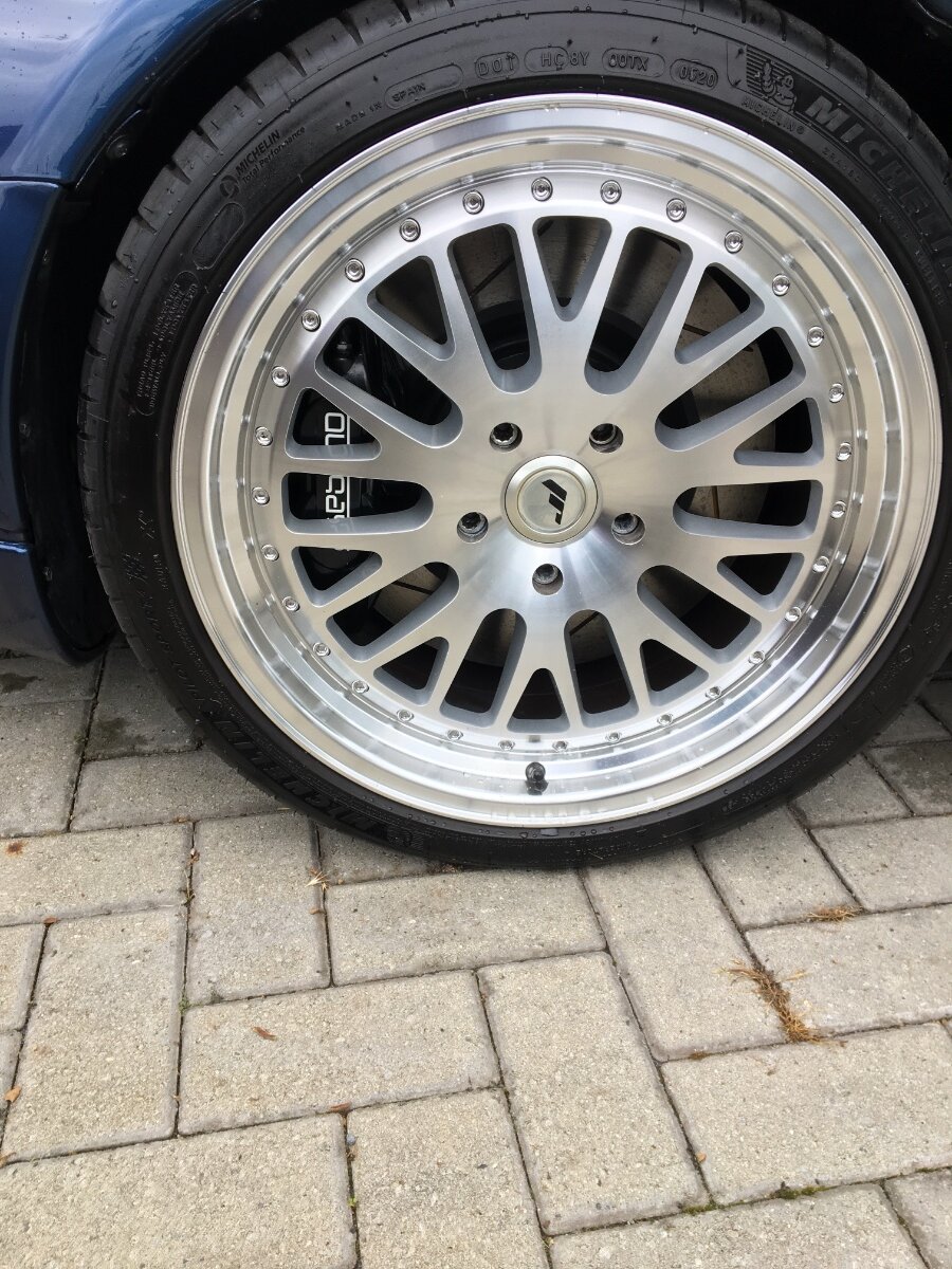

I picked her up July 1st with the new brakes, replacement RPS clutch and rebuilt SZ flywheel. The alignment, although done by the local tyre shop who are supposedly decent, Jim found to be way off and aligned it all properly. Now all sorted and driving like a dream. Everything’s now coming together very well.
With the 10mm spacers on the front now effectively making them ET15’s, the stance is super aggressive. I do now get the occasional arch rubbing when going over bad bumps, but other than that, all good.
500 miles of running in have passed so far, taking it easy, and feel there’s another couple hundred miles left until the clutch/flywheel are properly bedded in. Trying to drive her as much as possible in this nice weather, on evenings after work and on weekends.

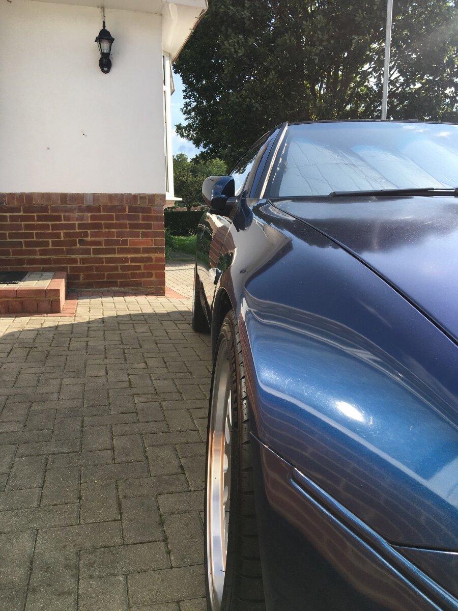

These photos show off the stance a little better ?. The rears are looking a little skinny now in comparison, so may have to get wider ones soon. Good thing JR’s are cheap and relatively easy to get ahold of.
2 hours ago, Gaz 300 said:
Looking great as usual Naz and you will get a slight rubbing of the inner plastic arch on a heavy bump but thats normal. I have 25mm spacers on the front to make the wheel fill the arch better.
Thanks Gaz, first time I’ve had a car this low! Half expected it to happen though so all good. What offset are your wheels then? Yours certainly do fill the arches very nicely indeed.
Lowering the car and correcting the front camber by increasing the length of the upper control arm also changes the caster and has the effect of moving
the wheel forward (the upper control arm is at 45 degrees or so with respect to the lower control arm). This can result in the tyre rubbing against the plastic
liner on full lock.
Offset not known Naz  the spacers were on when I had the oem wheels on and they stayed on for my new alloys. The suspension is Nissan oem.
liner on full lock.
Interesting, thanks for the informative response as always Andrew. I expected it to rub on full lock as well but it doesn't which was surprising - only on bad speed bumps so not overly concerned for the time being. I will have to look up how to set up the rear now as I will probably get wider rear wheels to even it out. Currently 18x8.5 ET25 (+10 spacer so ET15) fronts and 18x9.5 ET25 rears. I've seen people run really wide wheels on the rears, but don't really want to rub the metal rear arches and ruin paint etc. The plastic front arch liners being scraped I can stomach, but not metal!
For reference my cars about the same ride height as yours, touch lower at the back I recon.
My Set up is;
Front 18x8j et 20 with 225/40r18
Rear 18x9j et 20 with 265/35r18
The front is fine, it will occasionally scrub the liner, especially if there’s more than me in the car. The rear I’ve had nightmares with and I’ve had to roll the arches and tuck the tabs to get them to fit. If they were 10mm less aggressive I wouldn’t of had half the problem.
For reference it’s 630mm from the floor to the arch centre (highest point) on all four corners of mine.
As a side note, be aware that the bodies on z32s are not quite as straight as you might expect, most of my fitment issue surrounded one rear arch being tighter than the other by a few mm. This is a common issue with many 90s Nissans it would appear.
Very useful info here, thanks for this. I mistakenly wrote ET25's for the rear - I actually have ET35's and also handily have some of those crap 5mm slip on spacers the last owner had in his spare parts box, so will test fit with that and see how it looks. That'll make it ET30, which may avoid the need for the arch rolling drama you've had to deal with. Fingers crossed it looks decent. Tyres I forgot to mention - I have 245's front and 275's rear.
