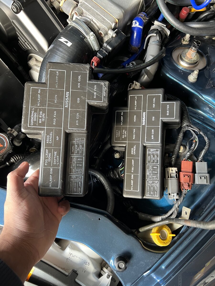

Picked up a replacement fuse box cover for the engine bay - the old one was all scraped to bits. Fitted an AMS brake stopper which has been on the list for years! When I did the engine bay tinware powdercoating last year, I couldn’t do the cruise control end cap, which has bugged me since so sourced a beautifully made Z-Spec cover in black.

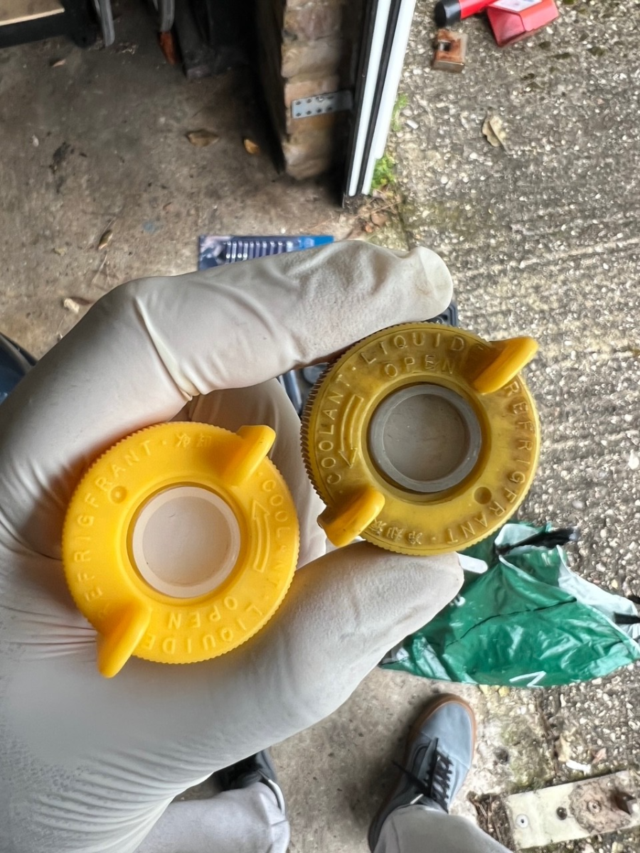

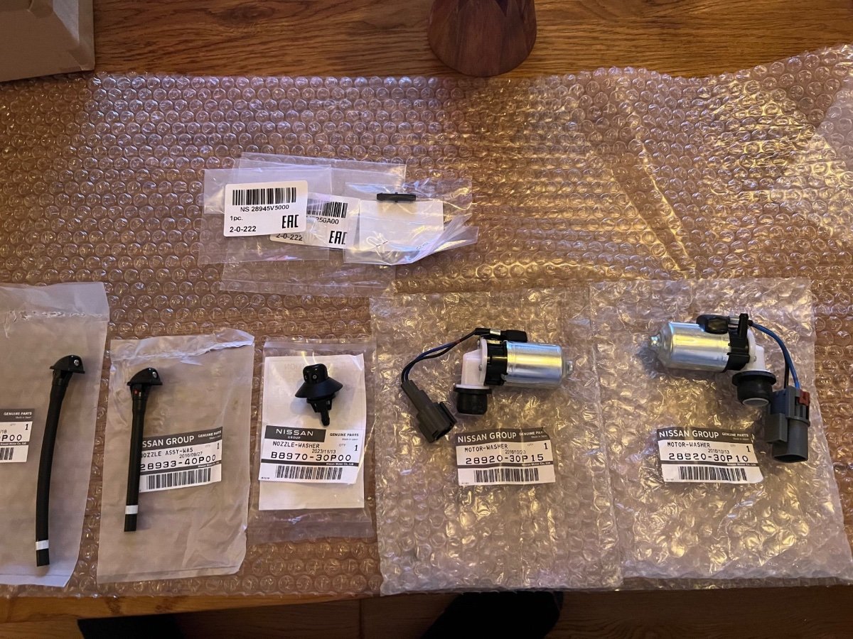

Whilst I was at Amayama's website, I sourced the coolant overflow cap and windscreen wash cap which have been on my wish list for a while, as they're both aged, stained and brittle on my car.

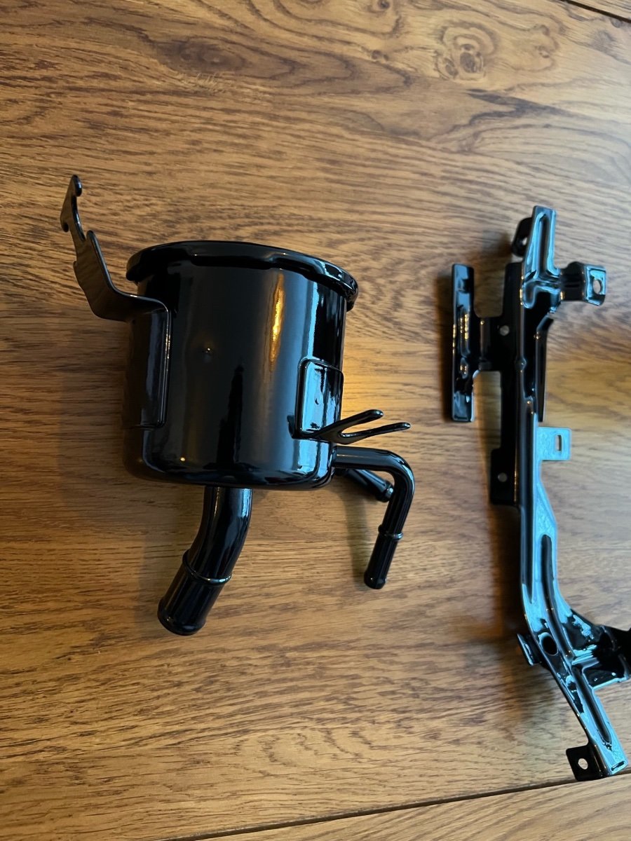

Next up was to source a used power steering reservoir from Banzai Breakers and take to the powder coaters for the gloss black treatment, to suit my engine bays theme. I also took for powder coating the harness bracket for the left of the plenum which Jimmer kindly gifted me. That will sort out the loose hanging harness in that part of the bay. They didn't mask the reservoir very well so I found tonnes of sand blasting media inside, which was an absolute ball ache to clean out. 3 cans of break cleaners and tonnes of water later, I think it's now fully free of sand inside! Looks stunning though so worth it, especially as my current reservoir has gotten rusty all over.

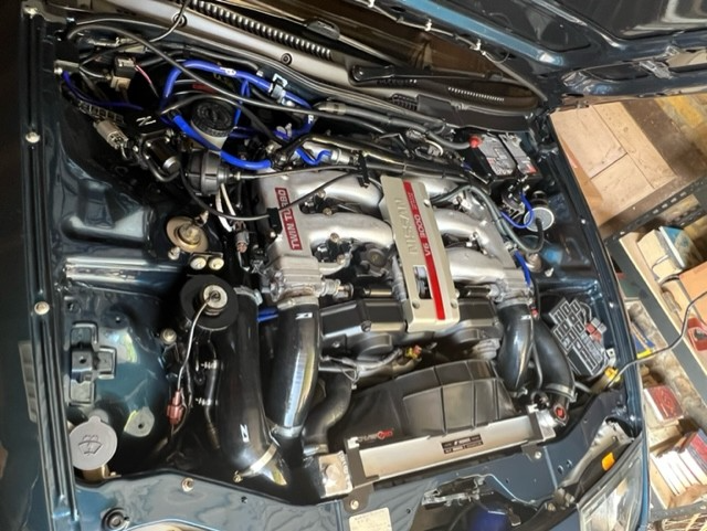

In April I got the battery charged back up and ready to go back out on the road. When I started it, it fired up straight away but quickly started to run like a bag of nails! I was seriously gutted after it had been in hibernation since last October. It was running super rich and stalled. I reversed it back into the garage, whilst stalling about 5 times, and quickly called Duane from DWM to collect it ASAP. Thankfully I already had a booking with Jimmer a week and a half later, so off it went to PowerZed HQ. Before the collection, I'd downloaded the Link ECU software on my laptop, plugged it into the ECU and found Zero errors, all readings for voltage within spec for the common items. I checked all connectors and as my harness is brand new, as are all electrical items, I ruled out corroded connectors but still sprayed electrical contact cleaner throughout, as good measure. Running through my mind was the million and one things it could be, spark plugs, coil packs, injectors, corroded connectors, CAS, TPS, but the conclusion to every one of those thoughts was - hold on a second, everything that could cause these issues I or a previous owner has replaced. Left seriously confused, I was eagerly awaiting Jim's report, of which came back a week later confirming it was just the MAP sensor hose that I had accidentally pulled out the firewall - Doh!!!🤯 Apparently it looked like it was on its last legs anyway or not a very strong hose, so probably didn't take much force to make it slip out. It must have happened when I was playing around with the engine bay a few times over winter. I'd somehow missed it - oh well, learnt my lesson! He plugged it back in and now running silky smooth once again.
Edited by Raja93

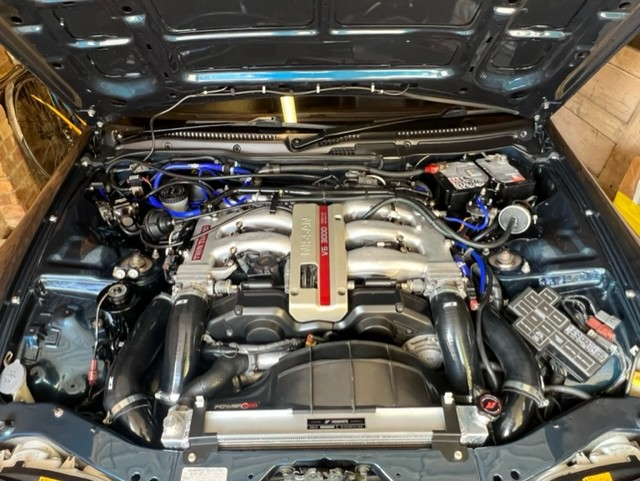

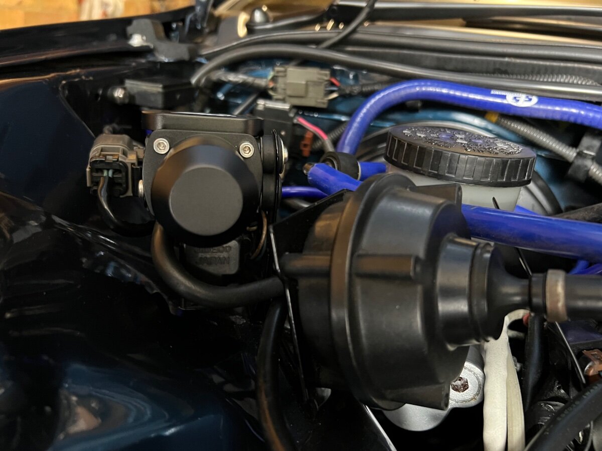

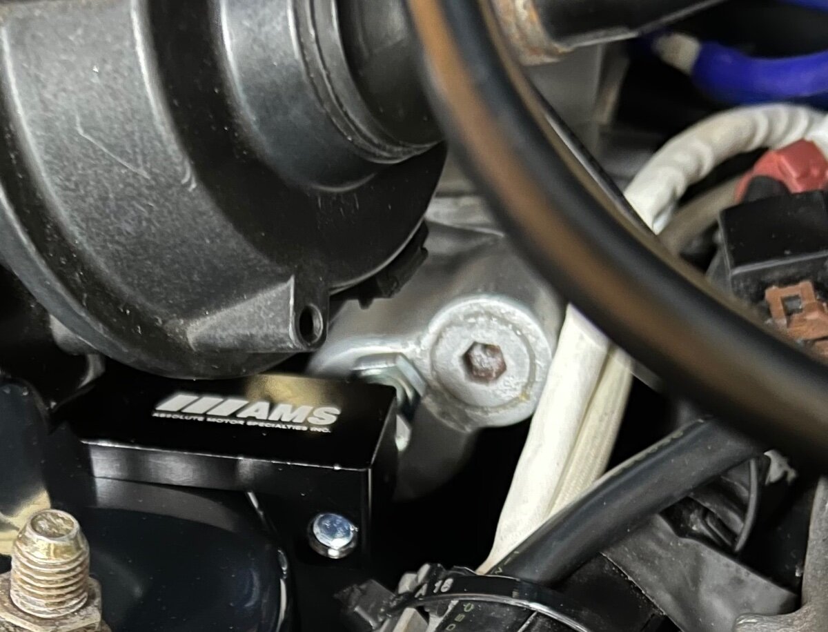

Before I got the Z back out, I fitted the freshly powder coated harness bracket to the left side of the plenum, which stopped the connectors rubbing against the turrets, the nice new windscreen wash reservoir cap and coolant overflow cap. Jim gave it an oil change with Millers Oils finest, brake fluid flush as its been 2 years, with the good old Motul RB660 fluid, replacement windscreen washer pumps (front & rear), new windscreen wash nozzles, fitted the powder coated power steering reservoir, raised the front suspension height as its been rubbing for years and repaired the AC System, as the pump seals failed almost straight after install previously.

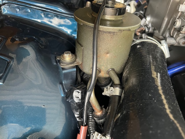

Pic of the old Power steering reservoir - looked awful and rusty, much worse in person:

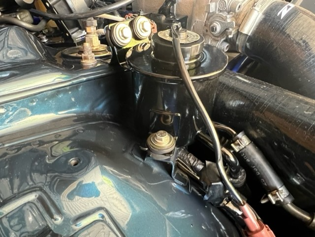

Replacement reservoir in gloss black - much much better now:
General overview of the engine bay now with all these bits fitted. Much cleaner and only thing to do is swap the blue hoses out for some black ones, but that's a job for next years list:
