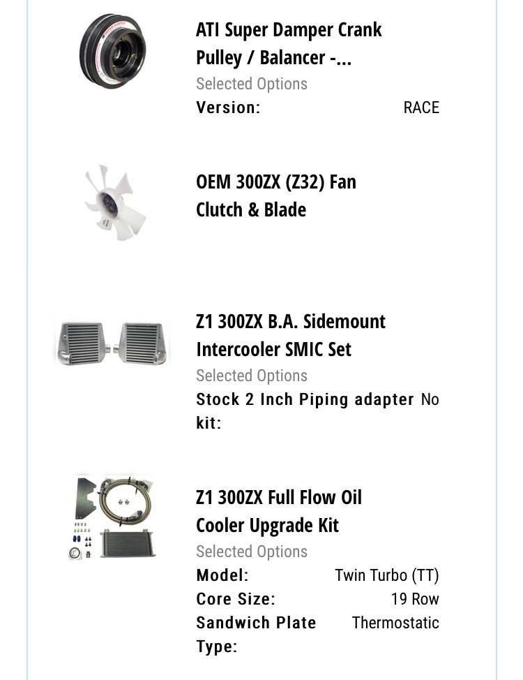

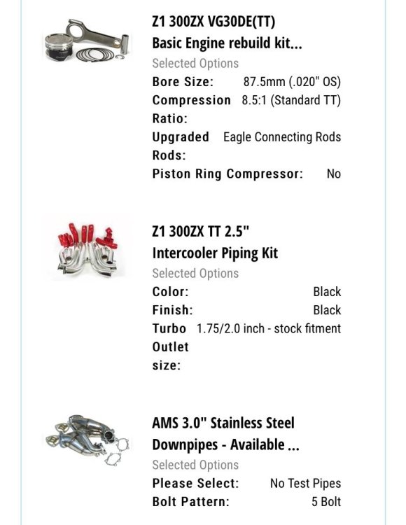

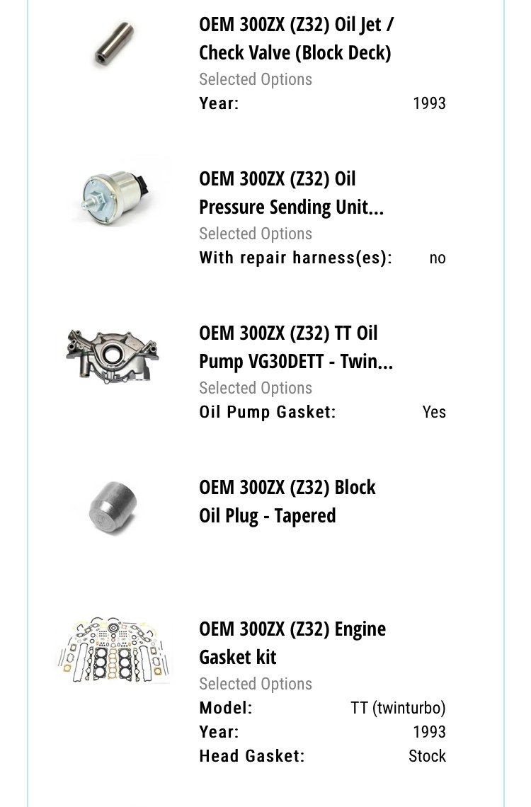

I made a shopping list of engine parts from what I found from our club car builds and a few other sources.
Rather than go back and forth over email with Jim on finalising the parts, I thought it best to discuss with him in person the day I dropped her off. We must have spent a good 2-3 hours but managed to get a final list together. The following week, funding was sorted and the parts were ordered, all as below;
A few other parts I sourced from a friend who’s delaying his engine build, are as follows:-
- BDE engine mounts
- BDE exhaust cam billet half moon plugs
- Injector seals
- freeze plugs
My exhaust front pipes are currently 2.5” and my centre and rear sections are Kakimoto 3”. I’ll be getting Infinity Exhausts to make up a set of 3” front pipes to suit.
We’re hoping Jim can source some rebuilt OEM hydraulic lifters to replace all the existing, but that is to be confirmed.
Now onto the parts selection:-
Aside from the usual array of parts, that most owners going through PowerZed end up ordering, I opted for the following and reasons why explained;
- Full flow oil cooler with thermostat; will drive hard in summer so would like to avoid oil temp issues and wanted to upgrade the stock 28 year old unit and pipe work anyway so made sense to go all out. Thermostat will ensure it doesn’t overcool the oil.
- Cams were decided upon for replacement as I’ve heard the real world benefit they have to the power/torque curve, as well as the head being apart it just made sense as a bang for buck decision. The 400 series cams retain a smooth idle which was key also. The ‘R’ version of these cams which I went for are good for 450-650bhp so ideal really.
- Gates Kevlar belt was selected as the valve springs and cams are being replaced. After reading Nickz32’s build thread, and of him suffering cam belt stretch after replacing springs for more heavy duty items, I thought best to include this!
- Having read of VTC gears failing, I went for the best aftermarket option - the BDE gears. Jim advised this also. I didn’t go for the BDE exhaust cam gears as they’re apparently overkill for my power target range and wanting to save some cash where I could, I didn’t ignore this advice!
- CP pistons are known as some of the best out there, so I did have the pistons and rods in my shopping basket. After speaking with Jim and hearing of the high success rates of Wiseco pistons and Eagle rods for my power targets and well beyond, I saved some cash and went for them instead.
- I was after the Z1 GT525’s as I wanted response and fast road useability etc. Jim highlighted how after the core charge of the 525’s, I could go for slightly bigger ball bearing turbos with fast response that were also cheaper (win-win situation). Looked at the GT535’s and GT600’s. At the last minute we decided to look on the CZP website, where they had the kit as per the screenshot above, which were a happy medium of turbo size. What sold it was they have a billet compressor wheel so more modern than the aforementioned options. To top it all off, they were also cheaper due to a sale, than all other options! Happy days ?

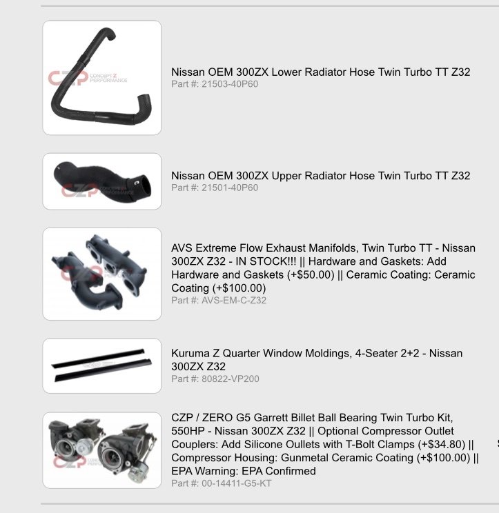

- The exhaust manifold was a funny one. The manufacturer in China for AMS decided to copy AMS’s manifold (karma!!) and sell their own under the name AVS. AMS cancelled their contract with said manufacturer but now have a huge back log of orders, so no chance of parts for ages. My hand was therefore forced to go the AVS route for stock availability.
- Went for the Koyorad originally but after ordering, I found out they’re on a 4-6 month lead in time. No thanks! Went for the Mishimoto which has 1mm less core thickness but I think I’ll survive!
Exciting times ahead ???. Can’t wait for it all to be finished. The engine build + respray will be carried out in parallel. Jim will pull the engine and Anil from Dream Body Works will come and collect her to commence the respray. Hoping for it all to be completed by the end of April, although I’m fully aware these things don’t always go to plan due to this, that and the other.

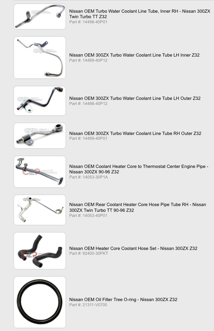

Once the key components and performance parts were ordered, I started thinking what other jobs can and should be done whilst the engine is out?
Out of all the parts my car has had replaced over the years, with me and previous owners, I saw no mention of replacement coolant hard pipes or heater core hoses in the service history folder.
With a freshly built engine, I thought it’s only right to replace all the coolant pipes I can get my hands on, in case any were starting to get rusty. I looked at the usual suspects websites and ordered the items as below screenshots (last few items I forgot to add to the main Z1 order).
Another peace of mind job that will be completed ?. Good old preventative maintenance - where do you stop and draw the line though?

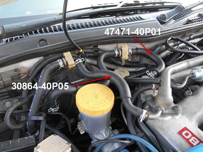

As you are flashing the cash Raja you might want to see if you can still get these OEM pipes from Japan. The originals are usually rock hard. Expensive
but hey...
https://jp-carparts.com/nissan/partlist.php?maker=nissan&type=132&fig=470*&part=3086440P05&page=1
https://jp-carparts.com/nissan/partlist.php?maker=nissan&type=132&fig=470*&part=4747140P01&page=1

I’d say it’s more making the most of the engine being out, hopefully once and never again!
Thanks for the tips as always. I have SFS silicone items fitted at the moment, in great condition, so will leave them in place.
