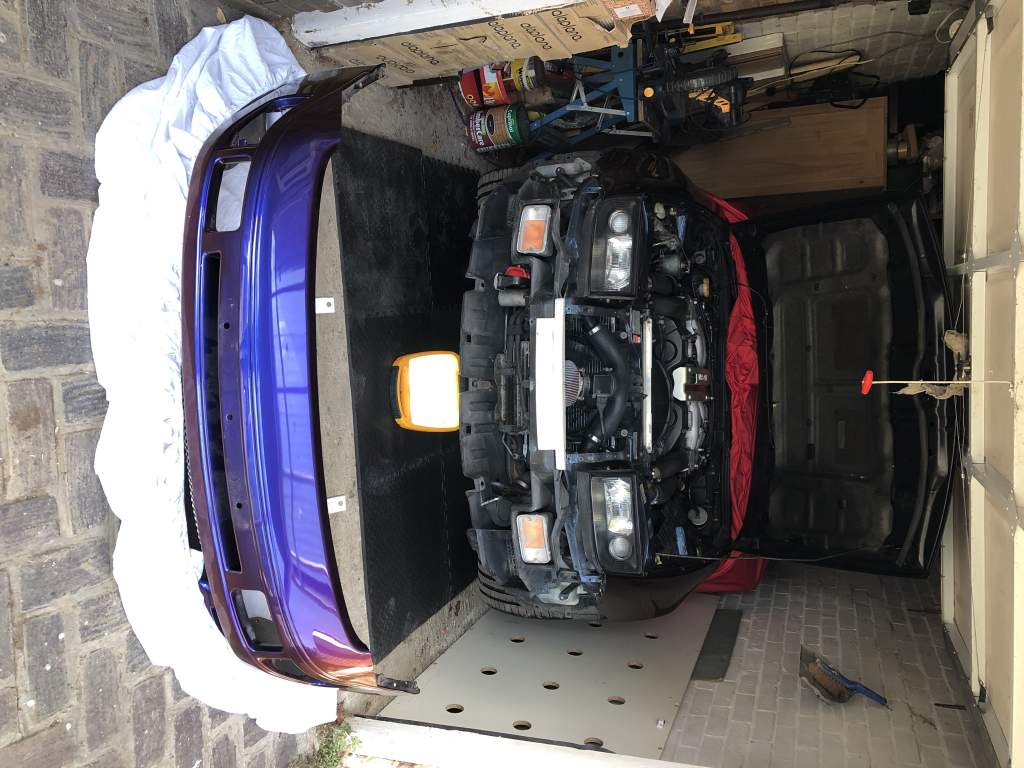

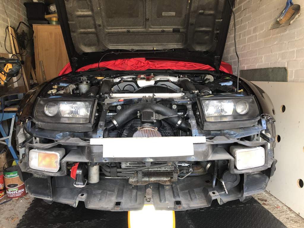

Anyway here’s the car on the stands with the bumper removed awaiting its first job...

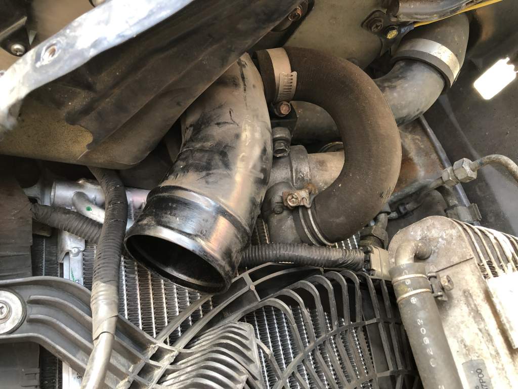

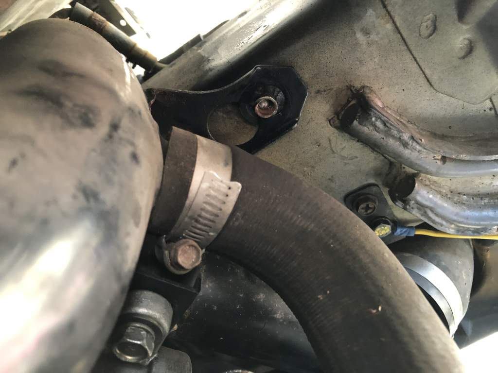

Firstly, what a pig it was to remove the near side headlights rear off side bolt. I couldn’t get to it without removing part of the intake and in doing so snapped my first bolt and split the grommet in half (I’ll be posting a request for the proper name of the offending intake part in my What’s this part called? post soon.
Offending intake pipe
Snapped bold and rubber grommet. IF ANYONE CAN POINT ME IN THE RIGHT DIRECTION TO REPLACING THESE PARTS I WOULD BE VERY GREATFUL. I will try Nissan but I doubt they’ll be able to help.

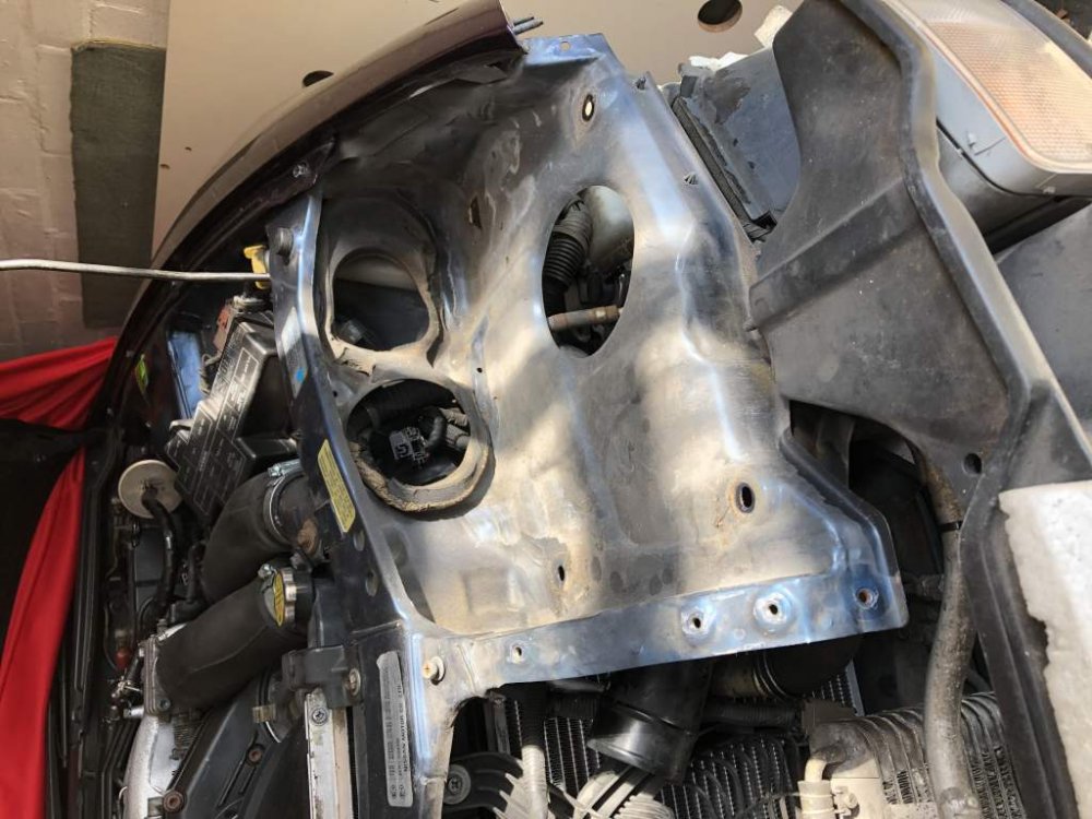

Nice rust free empty space where a headlight once sat.

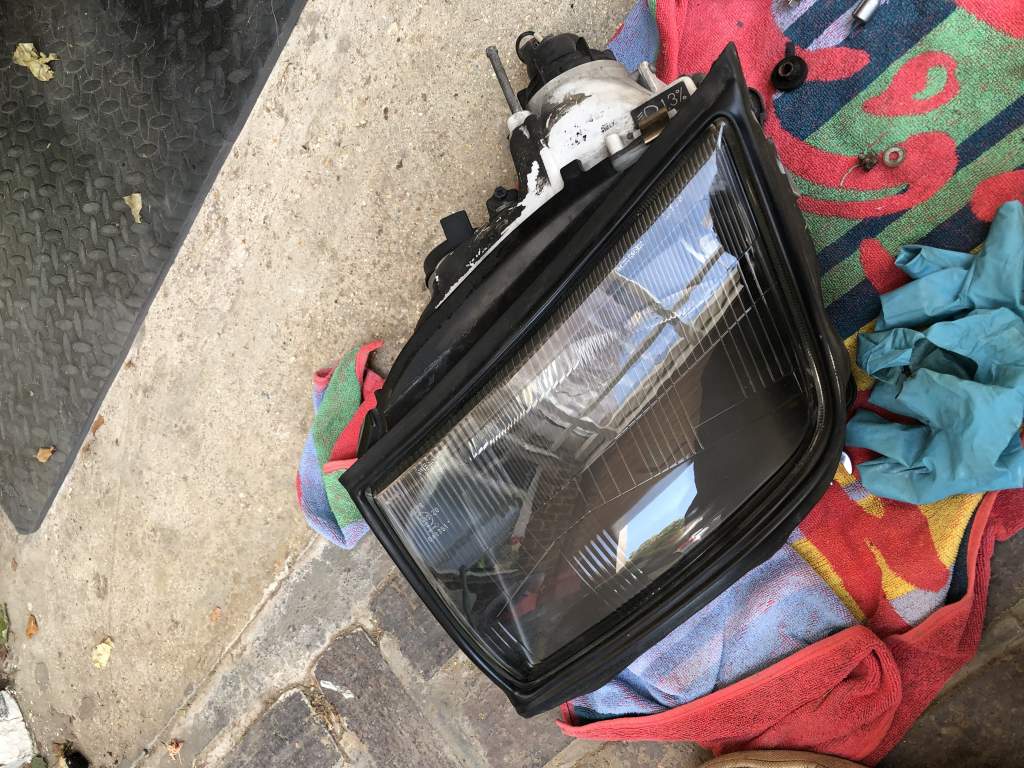

And a dirty light that is the cause of all this effort.

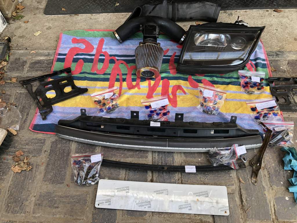

Oh and for your amusement here is a picture of all the parts I’ve had to take off to get this far.4275D380-0A81-44A1-84DA-02B584CCAC84.jpg
Has anyone told you about cutting a slot in the end of the bolts to make life easier?
[sIGPIC][/sIGPIC]
Thanks Ian, they haven’t but to be honest I kind of like the perversion of having to fight to get them out properly. :devil2: Now welding a nut to underside so it’s fix from the top for easy removal and cleaning would be cool.

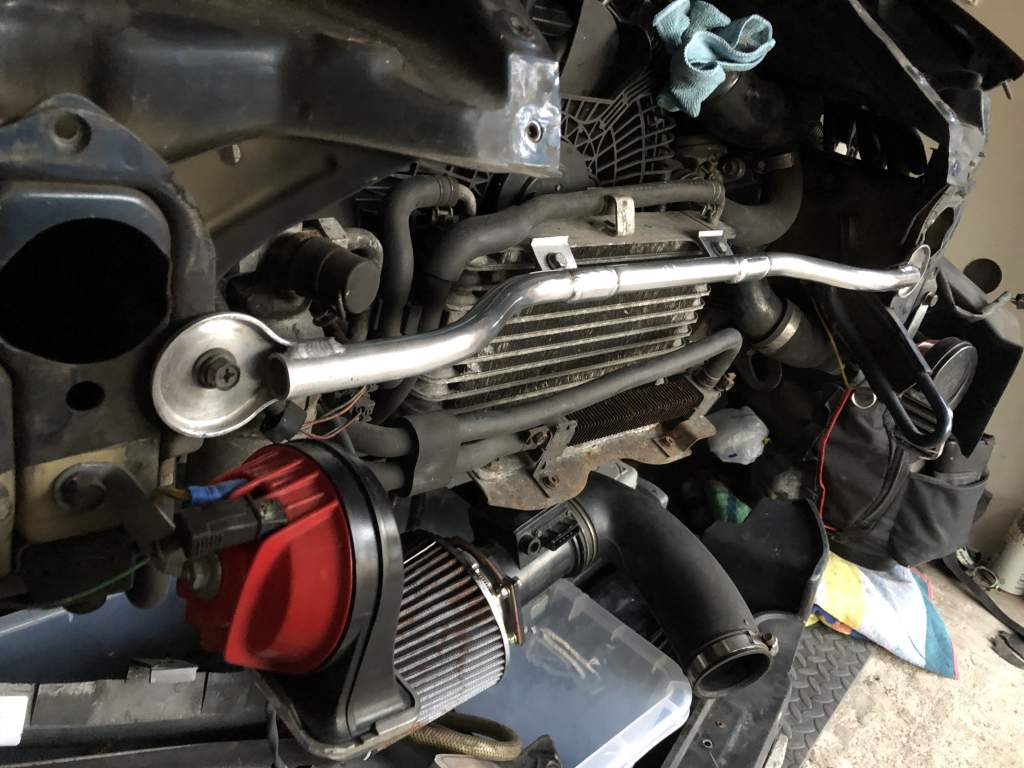

The oil cooler support bar.
That and looking at some pictures of Joel’s engine bay have done me the world of good. :wink:

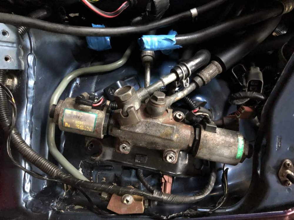

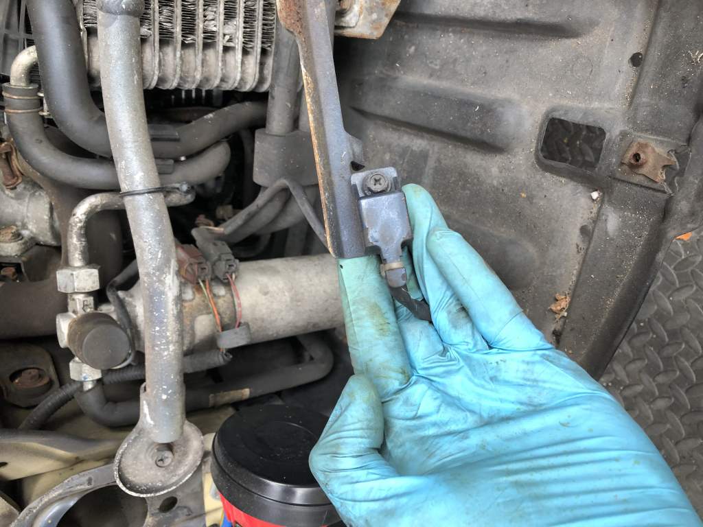

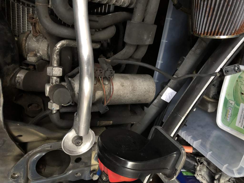

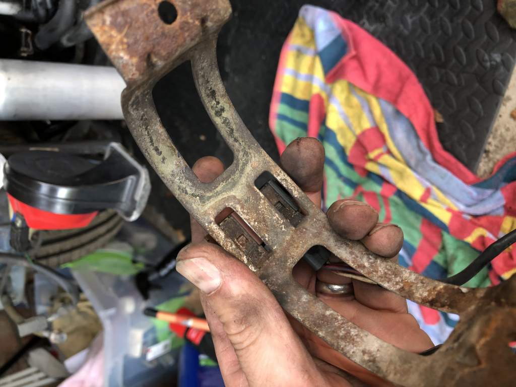

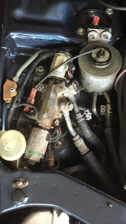

Am I being daft? I’m trying to remove the electrical connectors from the air condenser tank retaining bracket however they’re not playing ball. Do you need a special tool for these or are they not supposed to come off when fitted. There seems to be no give in the obvious push tab to release them.
[ATTACH=CONFIG]118649[/ATTACH]
They have a click in barb that stops them from being removed.
However, I removed mine by prying delicately between the underside of the connector and the bracket whilst pushing the connector off the barb.
A tad of WD40 will help.
Those type of clips are a real pain, had some on the side bracket on the engine, if you hold the plastic connector angle it upwards it will just give the underside enough room to slide off, while holding the bracket. Some have no access to the underside.

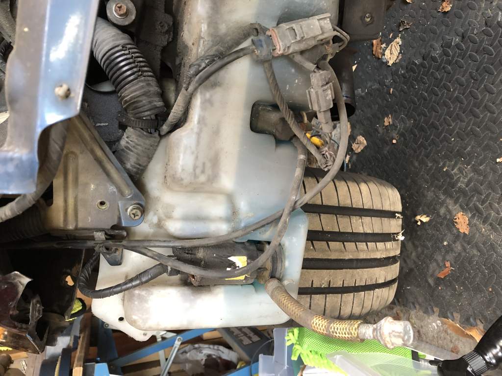

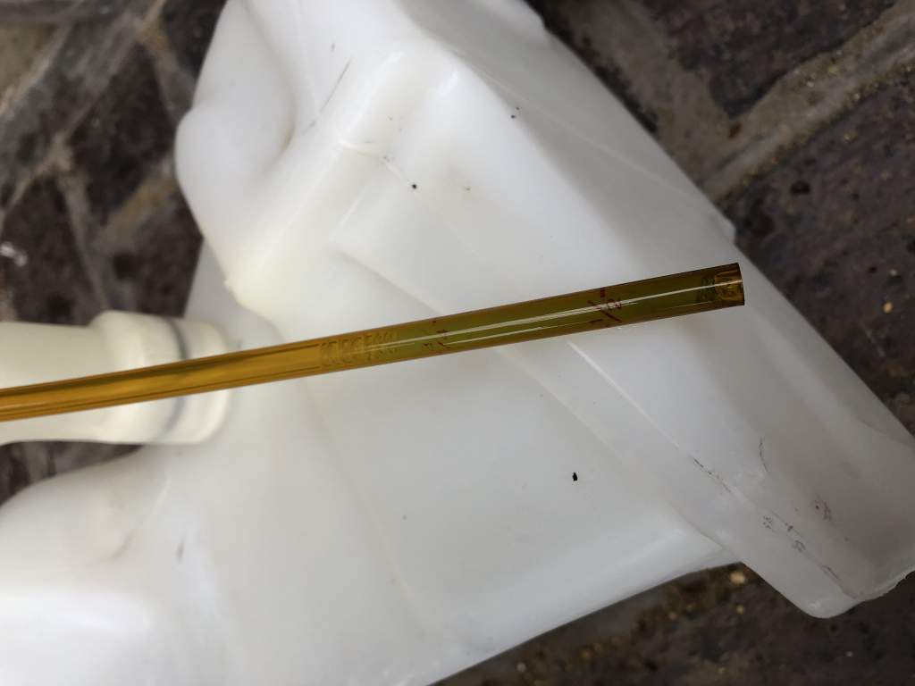

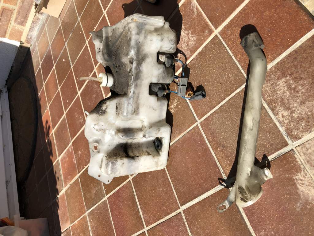

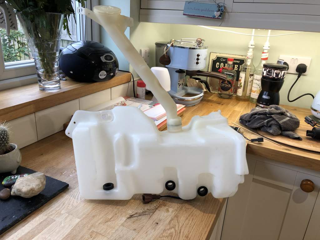

[ATTACH=CONFIG]118657[/ATTACH]
I pretty please how the washer tank cleaned up, however I may have to buy a new neck and lid as mine have stained a bit.
Whilst cleaning the tank an found that the tank measuring tube had come off and that by reattaching it to the lid you can measure how full the tank is. This is my 3rd 300 and each of them had lost the measuring tube so I had always thought it was a case of filling up until you can see the fluid in the neck. For the benefit of those who didn’t know this then you need to cover the little whole in the lid with your thumb, remove the lid and withdraw the tube, then take the reading from the tube. (I’m sure this must all be in the service manual but I confess I’ve not read it)
Washer neck not available anymore, only the expansion bottle neck is still available.

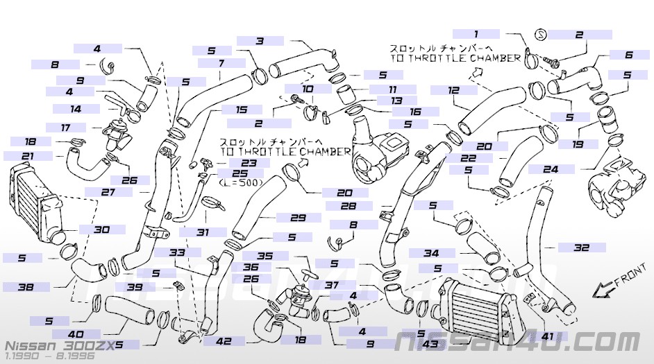

Does anyone know if the intercoolers metal pipe work come out or was the 300zx actually welded around them? :confused1:
Cheers Andrew. I’ve got the bolts off, the valves off and the boost hose off but I still can’t seem to find the angle to get the out.
And I give up, I just can’t seem to get these pipes out without taking the condenser rad out so have cleaned around them.
They do come out but they’re a pain in the ass, refitting them is even worse.
