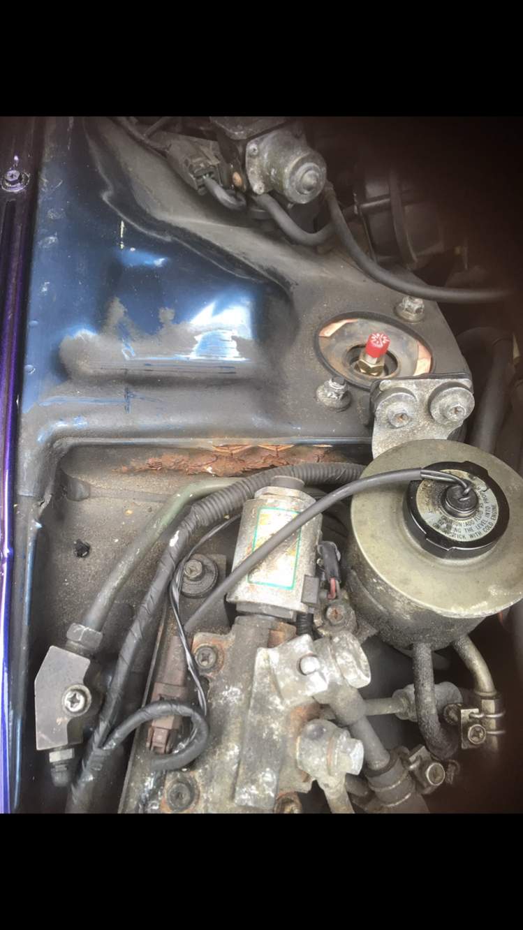

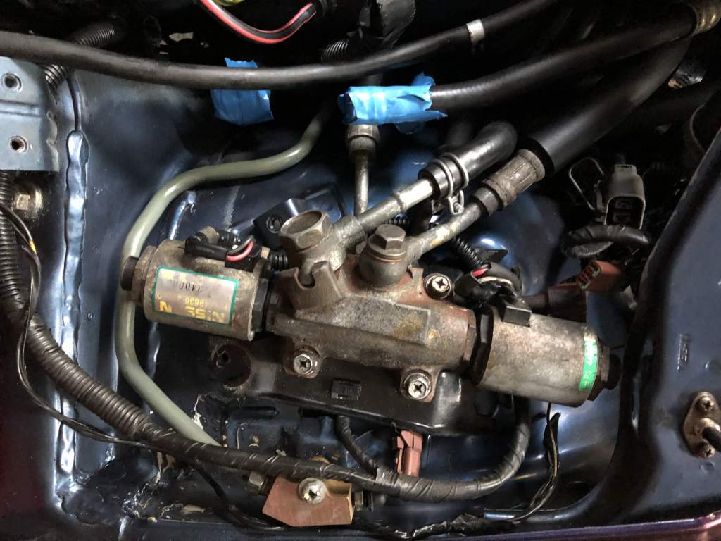

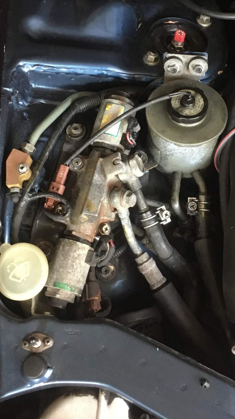

I slept on this last night and, after a good chat with a friend of mine, I’ve decided not to pull the engine out for now. My friend reminded me that I can be a little impatient and over stretch myself at times. He suggested I do what I can with the engine in, then once that job is done move onto removing the intake manifold. If I still haven’t achieved what I want then I can look at pulling the engine and will have built a better understanding of what’s under the hood with my previous projects.
So here’s a few pictures of the progress in one small area.
This is what it was like when I collected the car in autumn 2017
I then asked Jim to get the rust fixed
The after a bit more stripping back I’ve got this far.
Still a long way to go, but this was by far the dirtiest area in the engine bay.
Out of interest does anyone know what is used as the “seam sealer”? As you can see in the last picture mine isn’t very nice and would like to get the redone before I touch up the paint around that area.

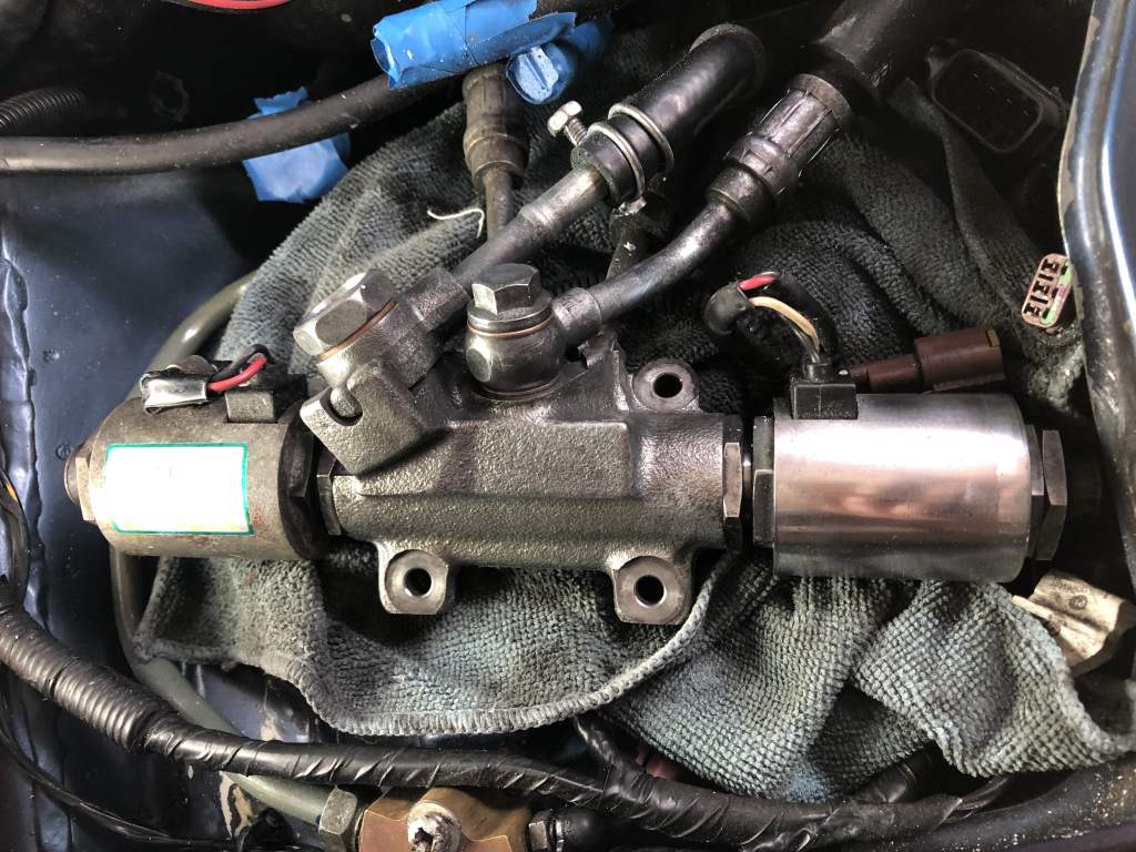

Nothing too exciting going on at the moment. I’ve priced up a load of plating and powder coating and will send that off next week. What I’ve mainly been working on is continuing to clean the HICAS unit. It’s taking a long time but I’m starting to see the results.
Thanks Andrew. The compound I’m using is Autosol.
The polished area was rubbed down with various grade wet and dry paper then hand polished. I’ve removed the sticker but will get these reproduced when I’m finally happy with the finish.
The man housing was wire brushed with the Dremel and Autosol, then buffed with a microfibre cloth. I’m going to invest in a different type of buffing wheel for the Dremel as I think that can be better.
The metal pipe work was done the same way as the main housing but I’m far from happy with that finish and will try something else.
They’re the ones however I used the stronger stainless steel version.
