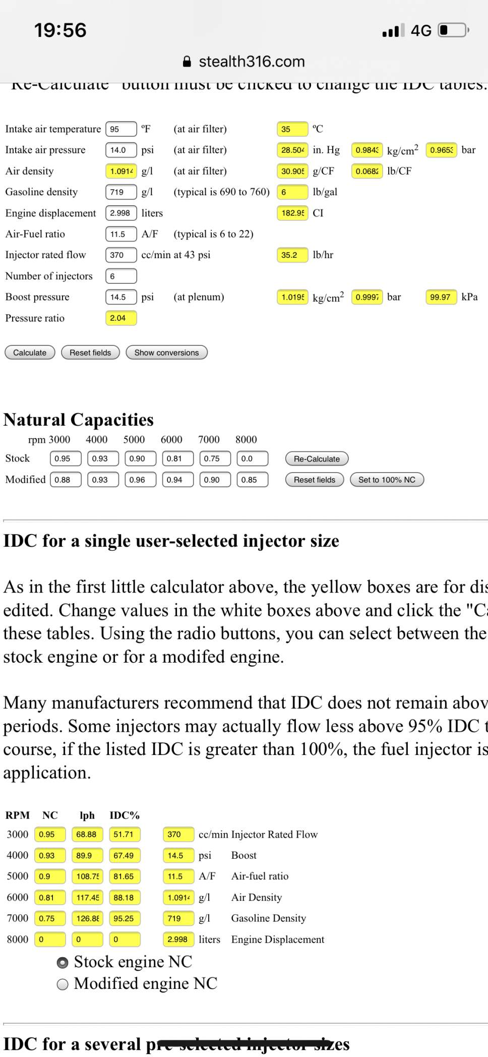

With regard to injector sizing for boost, the maths don’t lie.
370cc @ 43.5psi injectors x6
2998cc 6 cylinder engine
Boost pressure of 14.5psi
Maintaining AFR of 11.5/1
At 7000 rpm duty cycle is at 95.25%
The general consensus for ROAD based cars is duty cycle shouldn’t exceed 85%. Whilst the flow-pressure characteristics of the OEM pump mean that At 60psi absolute pressure it still flows a sufficient volume of fuel that reduce the risk of running a higher duty cycle for a VERY short period of time, running above 85% does mean that you’re eating into a margin of safety that is there to account for variances in atmospheric conditions including both air and fuel temperatures. To be able to flow enough fuel for more than 14.5 psi, you would have to raise your base rate fuel pressure to effectively force more fuel out of the injector at any given duty cycle. The risk of this is that as fuel pressure goes up the amount of fuel the pump can flow goes down.... you then run the risk of running lean by way of insufficient fuel supply from the pump.
[ATTACH=CONFIG]117833[/ATTACH]
When you then factor in that the early style pintle capped injectors are at least 26 years old by now, and simply don’t spray as cleanly or consistently as the newer style pintleless injectors, I would STRONGLY advise changing to the new style Nismo 740cc injectors to ensure safe running at anything above the boost levels Jimmer as set for you.
Has your calculation taken into account that fuel pressure at 14psi isn’t 43.5psi?
Yes mate, 1:1 rising rate so @14.5 psi boost fuel pressure is at 58psi

Where did you get that duty cycle reading from whilst on the rollers?
I’ll add a quick footnote. As a general rule of thumb the cc Number if the injectors is roughly the maximum HP the injectors will support safely, so 370cc roughly supports max of 370hp, 550cc=550hp max etc etc etc. Obviously there are lots of other variables to take into account, but as I say, it’s a good rule of thumb
Sorry, yeah you did say that.

I’m in a slightly more patient mood today so il explain what I was on about in respect to the injectors abilty as such. The numbers below are theoretical and you can’t expect that x = y exactly every time it’s merely a guideline.
The fuel map, on the ECU, has a margin for error. That’s about 20%. Thus doesn’t allow you to add more than the margin within that map. Most chips etc are an extrapolation of the stock map. As per the stock map and iterations of it;
3 bar fuel pressure @ 100 duty is 370cc, sufficienct for 370hp @ the fly.
This is a smart thing for a manufacturer to do to a car for a world market.
If we lift the restriction of the ECU so that 100% duty is 100 of total fuel delivery, with no redundancy or margin for error, the injectors can flow;
3 bar fuel pressure @ 100 duty is 370cc sufficient for 425hp @ the fly.
Of corse this is a silly move, no error compensation and everything flat out.
The total flow ability for 425hp is limited by the safety margin, which conviently lands us at 370hp at the fly with the stock margin for error. Injector size is equal to peak fly HP. As far as the ECU is concerned we are alt 100% duty but we’re not we're at 85%. So, for example we lift the stock ECU restriction so 100% flow is 100% duty and do not run past 90% duty that gives us 10% margin for error, not enough for a manufacturer but for a custom map, that would be “ok”.
3 bar fuel pressure @ 90% true duty on 370cc injectors is sufficient for 381hp @ the fly.
So 17 psi on stock Turbos is about 365hp @ the fly.
For a 90% true duty cycle you’d need 355cc of fuel per cylinder per minute.
So as you can see @ 365hp your under your safety margin by a fair way.
At this point you’d be pulling about 65psi on the fuel supply to supply the correct fuel pressure.
At this point the factory knock sensor became useless a fair while ago, the factory boost gauge has been off the clock since lunch time and o2 sensors have quit. The only thing looking after things is the ECU with all the processing power of a SNES your passenger is stood on. This is true wether your at 12psi on 370s or 21 on 740s and a crap chip or poor mechanical health you will kill it.
If you’ve got money burning a whole in your pocket, for what 740s cost to instal you’d be better off buying nistune and an AFR or better yet a stand alone with failsafes.
In short, in my grumpy opinion, 16psi on the RIGHT chip will net you about 365hp and less than 90% true duty.
That doesnt ring true Thats 2.13 litres per minute for the Zed Engine.You wouldn't get very far at that rate, about 32 minutes driving if the tank was full !

I would always upgrade injectors, even if they are not running at near maximum duty it makes sense seeing as they are 20-25+ years old to replace them along with the fuel pump for safety and longevity reasons.
to move from the theory to practice, just connect Conzult or NDS and read the Duty Cycle in real time, I can not try with my Z
But, I have an example with my 200sx S14, engine SR20DET,
it was equipped with a complete exhaust system without catalyst, fuel pump walbro, flywheel 6kg, intake filter Apexi, intercooler Silvia S15, delete EGR, spark plug irridium IK24, Boost controler Greddy profect b2 with 15PSI of boost, injectors OEM 370cc, a Eprom Horsham.dev to configure the set
With 15PSI, my injectors OEM 370cc had a duty cycle between 90 and 95%
It was just verbal advice from Charlie at SRR, I didn’t think to ask how he knew at the time.
This point reminds me that I used to have Datascan on live readout when I had a car pc and it would usually peak at 96% duty cycle at 9psi.
