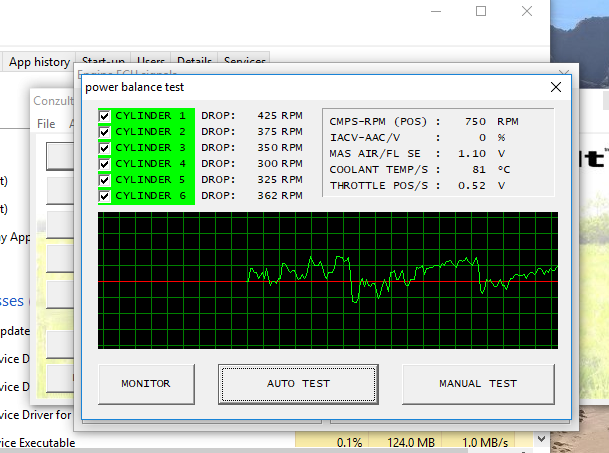

Here's the pic of the auto balance check:

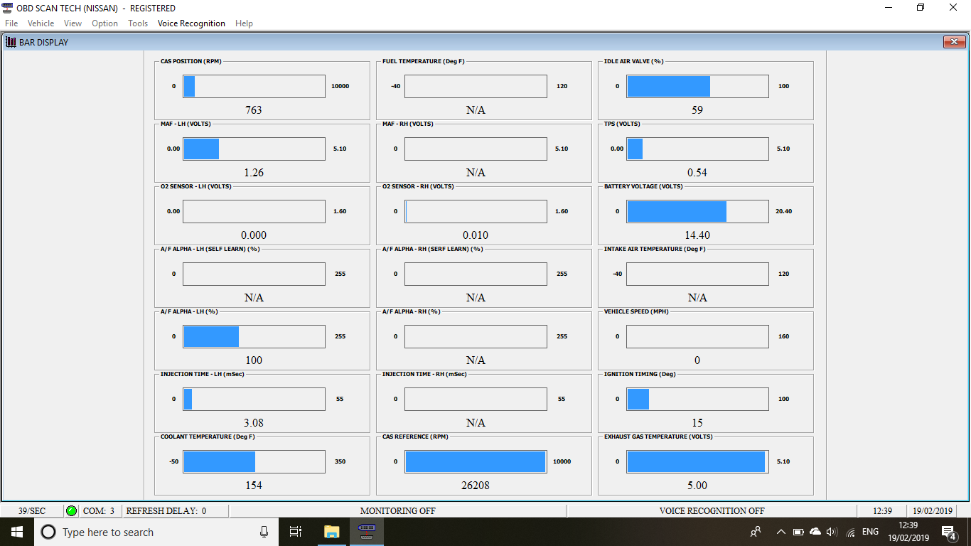

And here's the bar display from OBD Scantech:

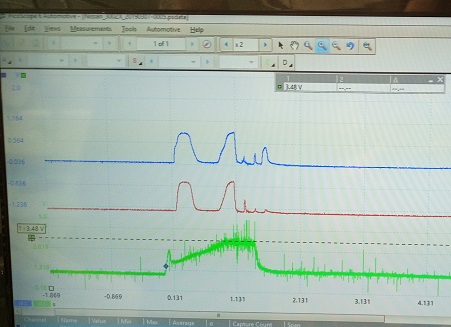

Going from idle to WOT, MAF peaks around 3.4V (green), blue is LH O2, red is RH O2

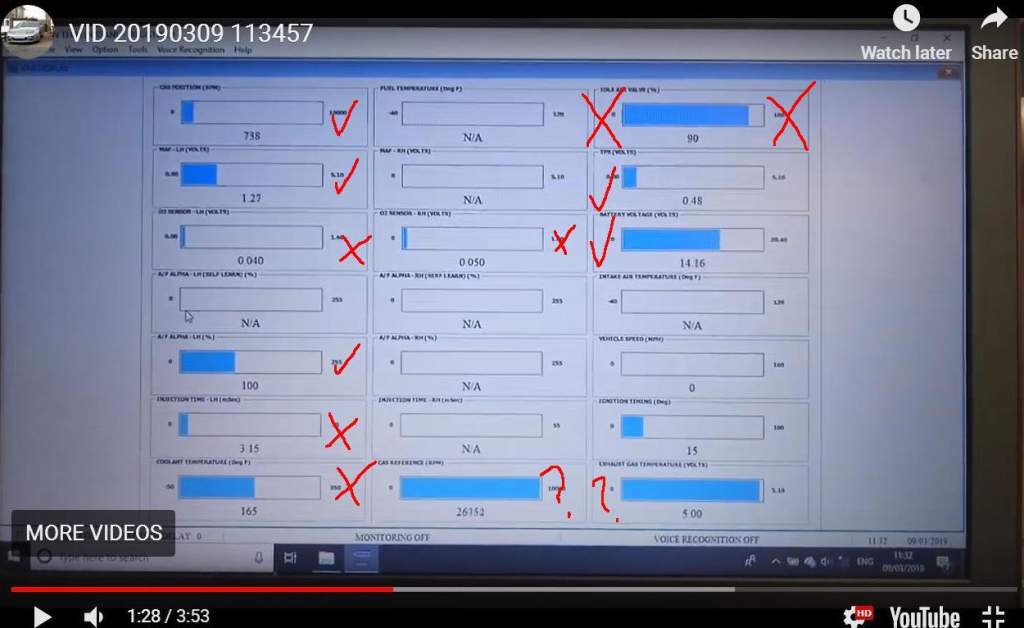

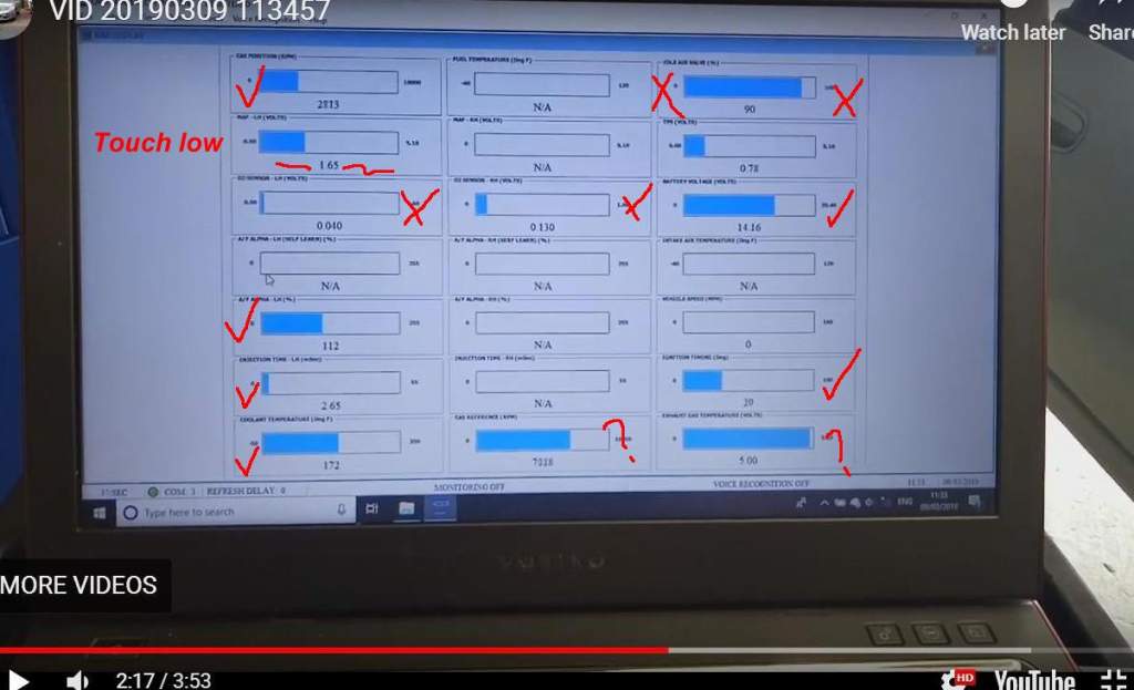

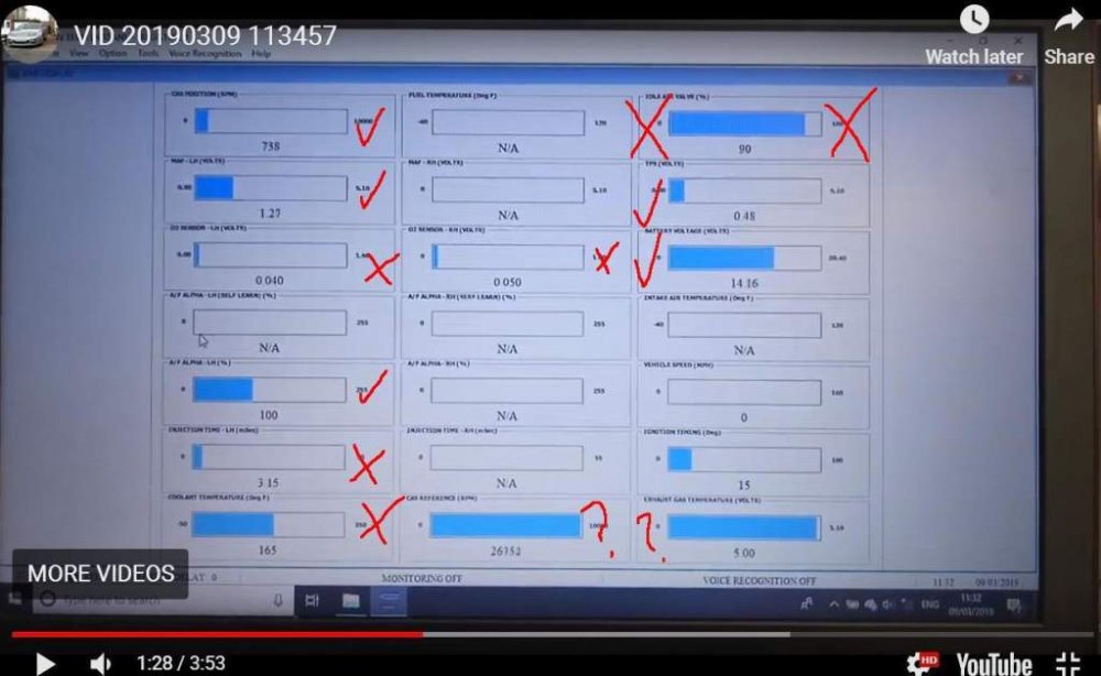

Plenty going on there to comment about, will just do some frozen screen...hang on
Jeff
Ok here we go first with the screen shots>>
So first lets deal with the wandering / twitching ignition timing, the earlier cas units did suffer from early location pin wear and could cause drifting, as could a faulty cas itself, however the later one have an issue with interference from bad shielding on the cas pick up cable, watching via the Conzult ports always often shows a twitch, the later cable looms solved this, so in essence disregard that as a red herring.
The video does start with a low water temperature, I have no idea how long it had been running prior to the start of the video so could of still been in its warm up phase, if not however the temp was low and could point to an issue with the stat not closing fully ( common failure, many of my tech threads show this)
The injector dwell is too high at the start even with the lower temperature and would normally point to an issue with the afm, however we will see later this is not the case.
The 02 sensors are both toast, one worse than the other, the external structure is likely intact but the internal pre-heat circuits which are used as a reference calibration have failed / failing completely in one and the other is on its way, this can be seen as it comes to life when the throttle is stabbed hard and it warms up, disconnecting them is usually better than leaving them connected, the results may not be seen though whilst other faults exist as we will see.
The screen shot unfortunately does not show the tps hard close switch, this is essentially is the main way the ecu knows the throttle is closed fully, any issue with this can cause timing issues and stumbling, but as I cannot see it I cannot comments on it.
So the throttle position sensor you mention is at its lowest, any lower and the engine cuts too easily, so, you need to check the throttle balance, sounds like one throttle is slightly ahead of the other and that been the one the tps is connected too, I did a tech thread on how to check and adjust the throttle balance, this I cannot stress is of vital importance through the whole rev range to be correct, and they do change over time as the landing pad for the throttle stops wears, and of course after any adjustments to the the throttles the tps will need resetting.
See my throttle balance tech for this here >>
https://www.300zx.co.uk/forums/showthread.php?151304-Throttle-balance-tech&highlight=throttle+balance
So to the very obvious fault of the auxillary air valve is wide open 90% of the time, this is as the name suggests a valve that meters changing amounts of air passed in addition to the throttle butterfly`s, its primary role is to stabilise the engine when the the throttle is snapped shut, when braking, when coming to a stop and when the car is put into D on auto`s and engine drag occurs, this works in conjunction with the tps and the ignition timing.
So to explain, the engine tick over speed is also regulated by the aiv, when the engine is fully warmed up, with no air leaks and timing correct you should have something like this>>>>
Tick over speed around 800 rpm ( not the 750+minus 50 as in the manual, that was for a brand new engine )
Coolant temp 80c
Timing 15 deg
Engine speed 800 rpm
Aux valve 15 %
TPS 0.46V
Inj time 2.2 / 2.8
Maf 1.5 to 1.8
NGK spark plugs fitted
So your clearly not achieving these figures and the problem seems to be centred around incorrect air balance, and the afm issue is the first that needs addressing.
The aav been wide open is the ecu attempt to balance the engine, however the unit is failing to operate as it would be racing away if it was really open 90 %
The know issues with the unit is bad connector connection and also to get jammed, in lesser cases it fails and needs replacing.
To start with, check the top yellow connector, it often goes green and will need cleaning, next and to prove the point to see if it is jammed, whilst ticking over and observing the afm value, strike the unit firmly with the wooden handle of a hammer or similar, ( yeh really ) make a good few blows and see if the value changes as do the rpm.
If nether of those work, disconnect the connector and apply a 12volts supply to the unit, it should of course open wide and the revs rise to a fast race.
Finally if nothing, then it would be fair to assume the unit has failed.
Note: on some very odd occasions it has been observed the output from the ecu to the aav has failed at board level in the ecu and this will need replacing.
So moving on, lets assume you now have a working aav, good throttle balance setting and good tps setting,new 02 sensors ( or old ones disconnected ..same thing for testing) now the whole procedure needs doing again to see what figures your getting.

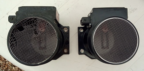

Old and new MAFs. Someone’s clearly been a bit heavy with levering the hose off – and I wonder if debris from that might have damaged the MAF.

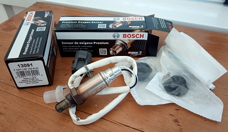

New Bosch 13091 O2 sensors to be fitted next week. Also proper NGK PFR6B-11

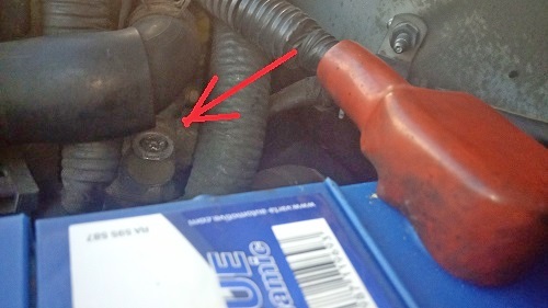

The idle adjust on Z32 wikispace given in other threads isn’t there any more. I found this pic of where the screw is
but can’t see that on mine – is it this one?

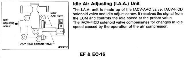

Yes, FSM drawing and part below.
Thanks AndrewG, I'll have a go after the O2 sensors and plugs have been done. Cheers
