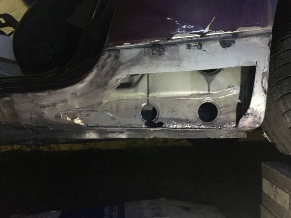

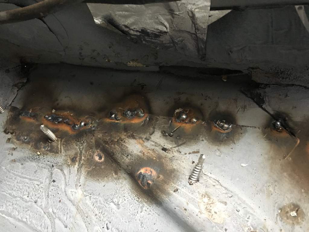

Well after a while making sure the patch section was fitting properly I fixed them in place with self drilling screws and added a few tack welds inside the car.
I had to beat the panels together in a few places to make sure there was no gap between them, so the panel hammers and dies came out and I began with a bit of fettling....
I was intending getting some more done, but had to stop due to weather getting a bit damp and running out of shielding gas.... lol
Tomorrow is my day to finish this off, grind off the welds, seam sealant and treat it with some rust preventative.....
Inside car..... top of patch area....

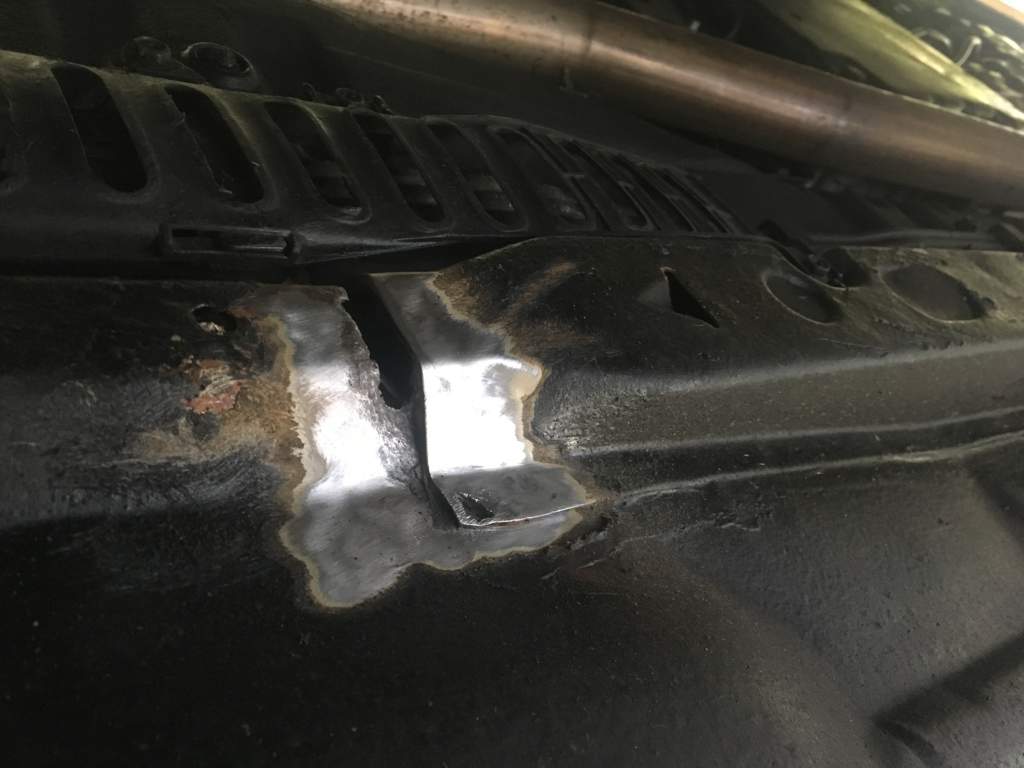

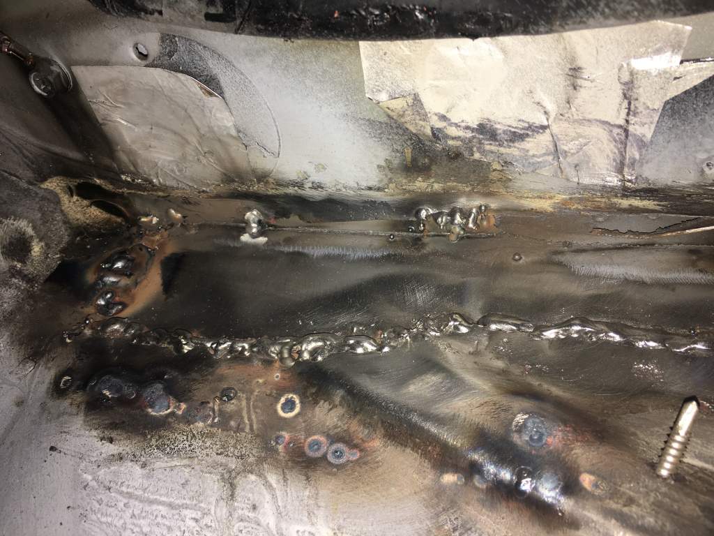

Well she is all welded up and seam sealed.....

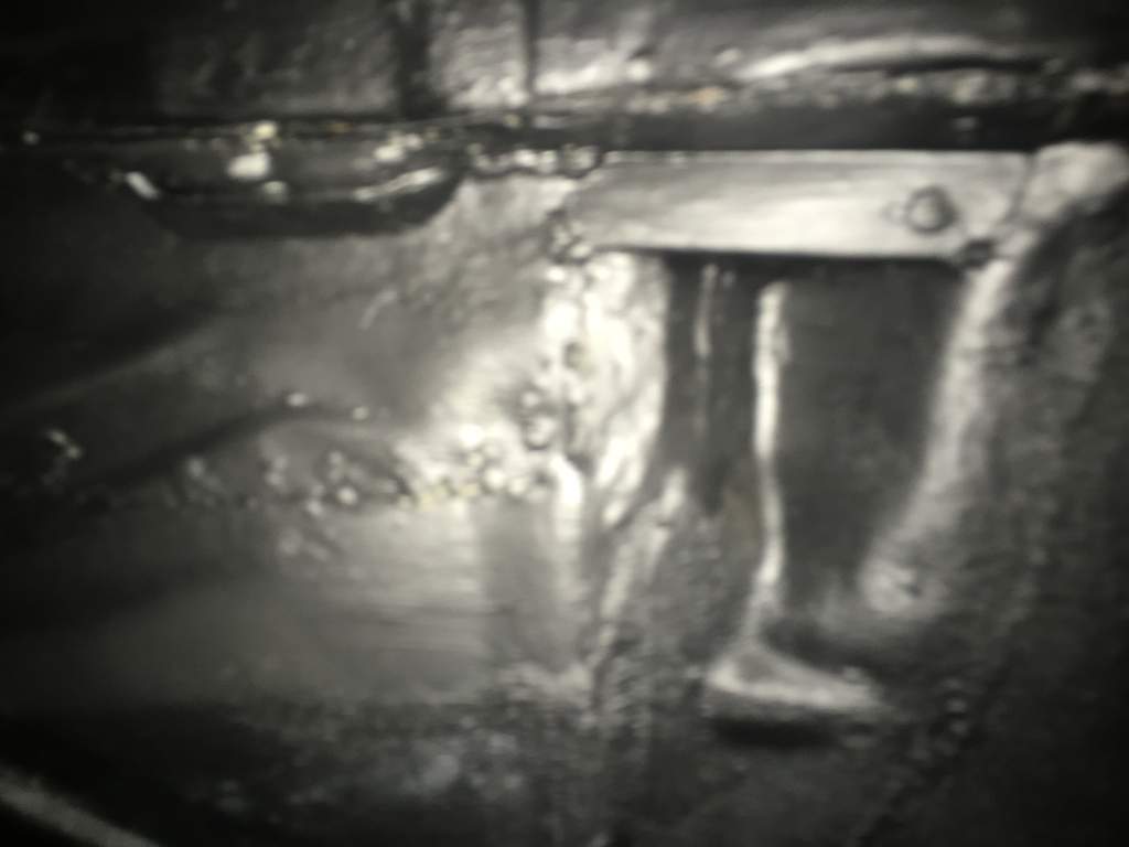

This was the inside after most of it was welded up on the inside joint.... I also welded the underneath as it was an overlapped joint.... both edges are now sealed and very strong....
This is the inside after cleaning up with wire wheel on the drill...

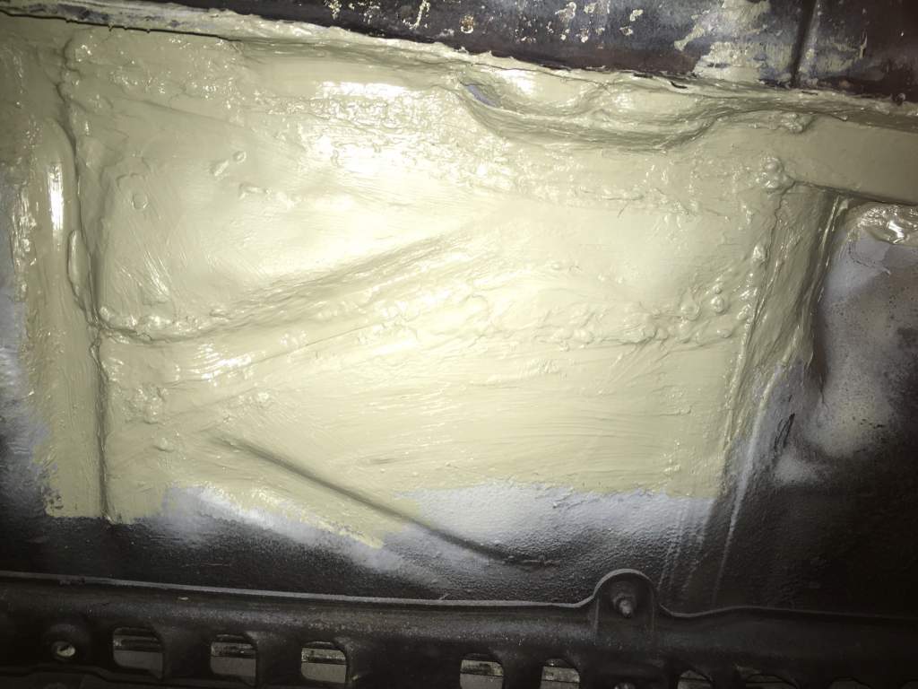

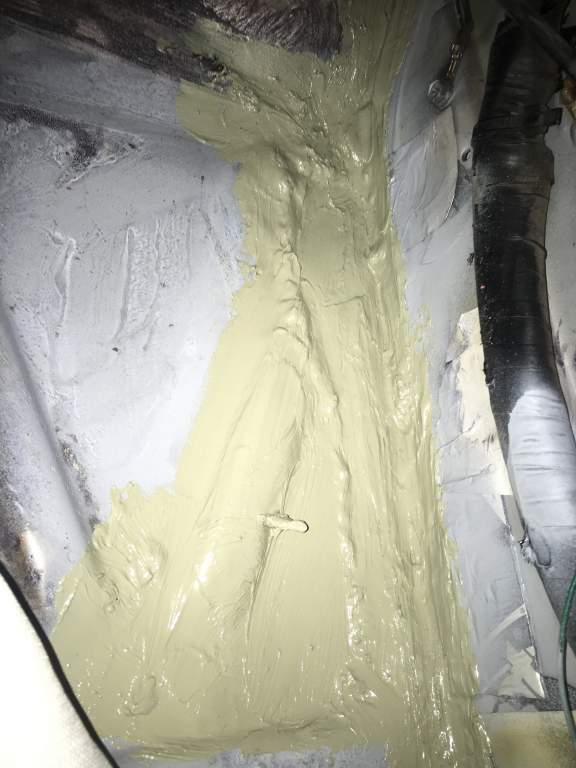

Next is the inside area with a coat of seam sealer applied....
And finally is the underneath with a coat of seam sealer to protect the welds and give it a bit of protection from stone chips while i was there.....
Not as pretty as I would have liked...... But I can clean up the welds when the weather gets better next year and i do the entire underside of the car and sills properly......

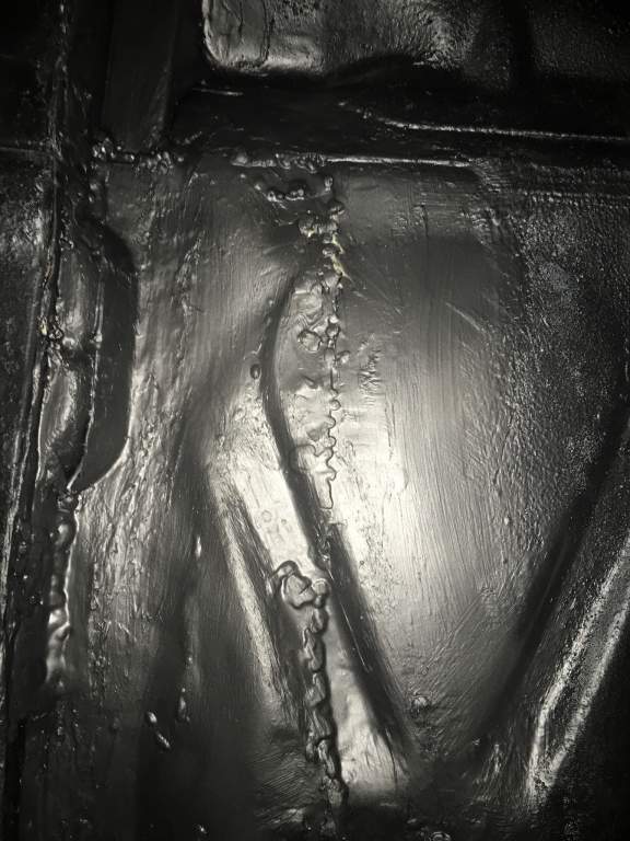

Well it is now seam sealed, painted inside with gloss black paint and underneath with a Matt black.
I also rubbed down the entire drivers side floor pan and bottom of sill, rust treated 2 small patches of minor surface rust.
Now fully painted floor pan. Next is to use some good quality underbody coating then the Bilthamber Dynax - UC clear underbody wax.

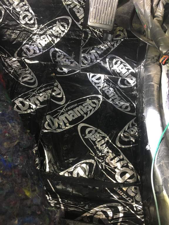

I also fitted the new dynamatt sound deadening to the floor pan and tomorrow I shall be fitting the Dodo sound stopper LT under the carpet before I fit it back in place....
I wasn’t happy with the seam sealer underneath the car, so I stripped back to metal and reapplied some more.
Later today I shall be giving her another coat of paint and Schutz, followed by the Dynax-UC...
I finished the inside with some DODO sound stopper LT under the carpet for some added sound deadening where I removed the OE stuff to weld her up.

Well I looked at last nights work and have decided it is acceptable to me for the minute....
So this afternoon I gave her a coat of tetra schutz and am now waiting till tomorrow to check how it looks and see if it needs a second coat...

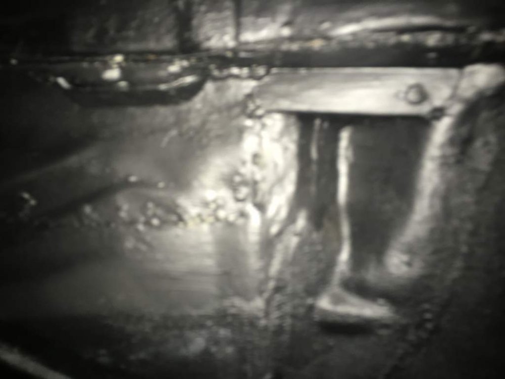

First of all after turning her around and starting on the other side for resealing the floorpan, I found this rotted through chassis rail......

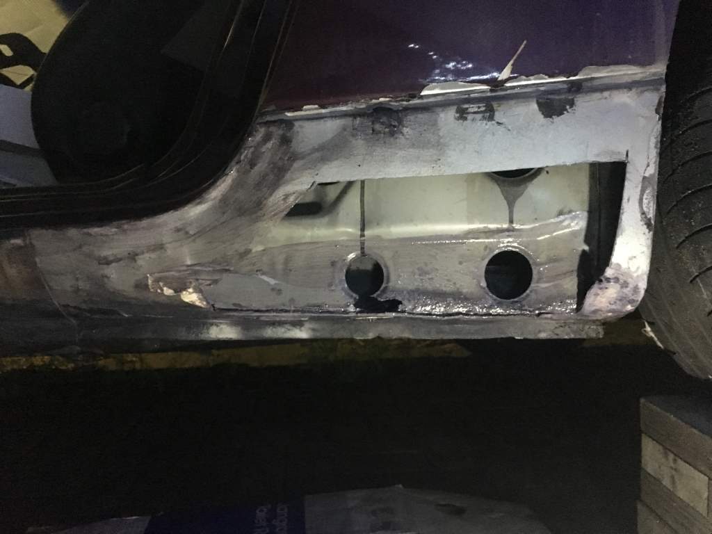

I was a bit peed off so got cutting..... lol

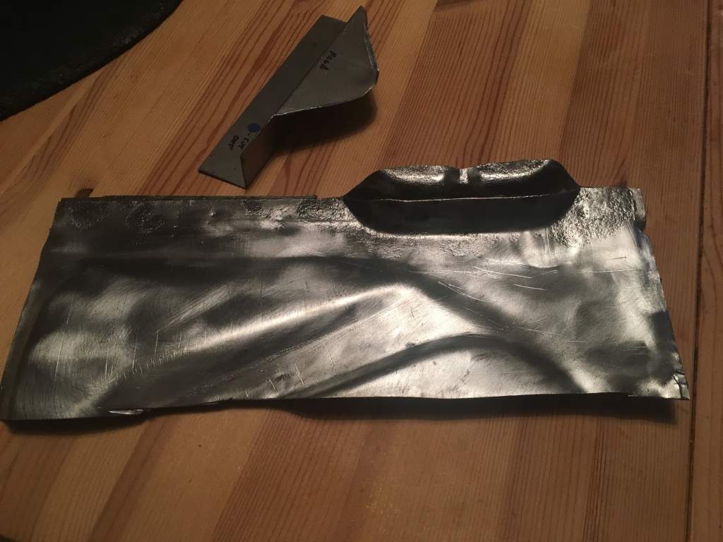

I’ve ordered the Panel from Luke and I’m making the repair panel for the chassis rail by hand....
Just made a template tonight and will cut out the sheet and shape tomorrow......
Just need to find my joggler tool now....
