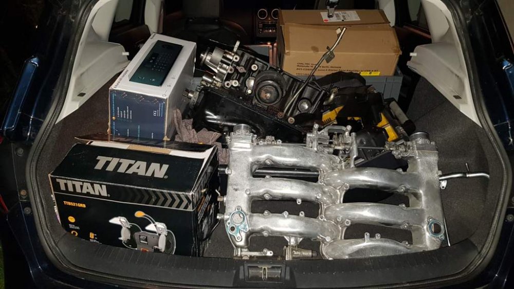

On a road trip for a forged engine.
  • Replies 46
  • Views 3.4k
New forged pistons, and upgraded injectors, already had new turbos
