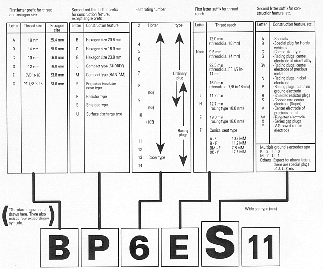

I’m suprised your not keeping stock plugs and they are gapped at 1.1mm, that’s what the 11 bit in the name is for.
Simon you’re getting your metric and imperial mixed up. The 0.36 figure you have in mind is probably the stock TT gap of 0.036”.
I omitted a zero.
Si, why you going for Grade 8’s.... you only need grade 6’s at your spec. I didn’t have any problems with grade 6’s until 17/18psi
E0B0A7CE-C67C-4BE4-A7D2-5A7B0E699F4A.jpegThe stock spark plugs are NGK PRF yadda yadda-11 the 11 refers to the gap which is 1.1mm.

I purchased the PRF6B-11 I think they are about 5 years ago. They weren’t cheap however from what I understand NGK worked with Nissan to design the plug. This was about the spark placement in the head bowl particularly. I believe the US cars received grade 7, these are no longer available so they’ve subsequently changed to our spec the 6. Feel free to correct my memory here.
Because of the cost Noel was running a copper plug, those BK whatever’s. These didn’t correctly place the spark, I believe it left them slightly shrouded. But they were a cheap off the shelf compromise. He felt the compromise was acceptable in reflection of cost and they could be gapped where as the stock plugs don’t like this treatment.
In summary the stock plugs whilst expensive and uncommon last 10s of 1000s of miles and for the vast majority will be the right part. If you starting to experience spark blow I’d really hope this is encountered with a professional edge and that can be addressed in due corse.
