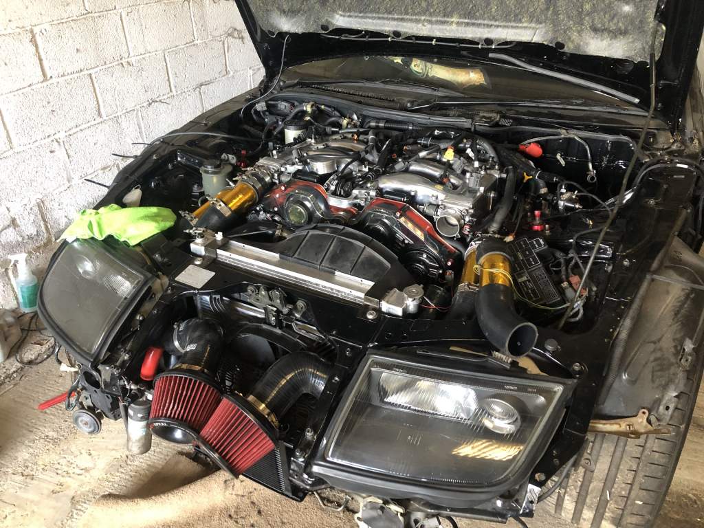

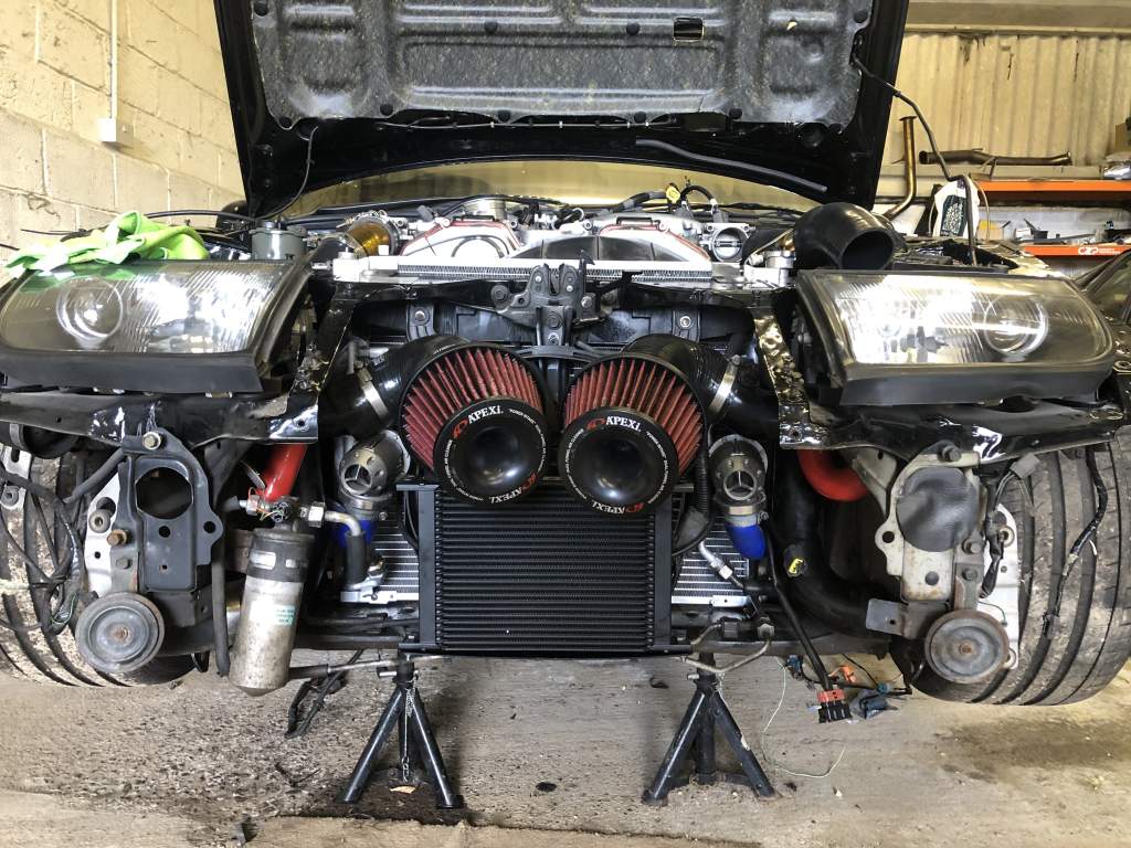

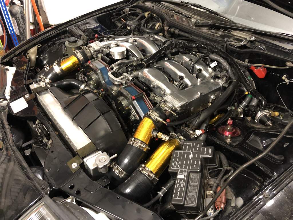

Been ticking over the last couple of days working my way through the engine bay and interior

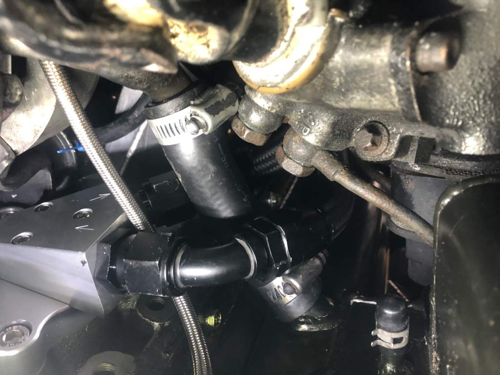

Trying to get the new loom to sit nicely is proving to be a bit awkward, but will keep working at it. Not sure what to do with the unused connectors that are just lingering around (O2, EGR, PRVR etc etc etc). Don’t really want to cut them off,m as it’s a brand new loom, but also don’t want them cluttering up the engine bay. The 2.5” piping makes it that little more awkward at tucking them away.

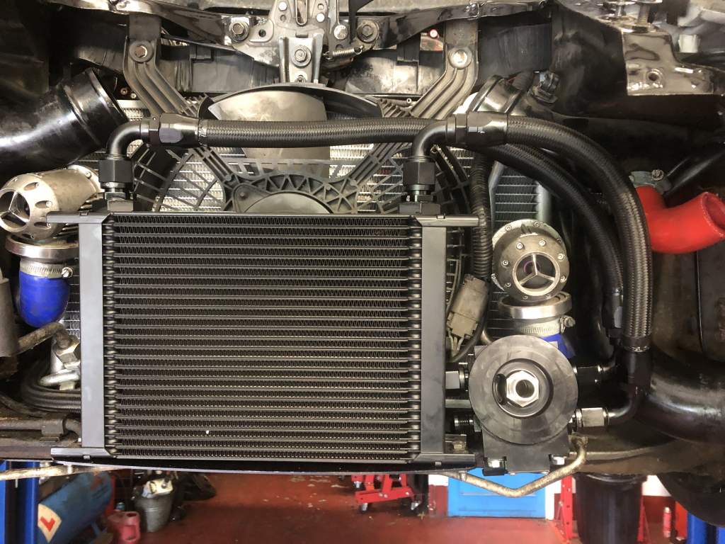

New Setrab 23 row oil cooler turned up today, which was duly fitted
The dash 10 lines and AN fittings are due to be delivered tomorrow, as is the vast quantities of oil for running in.

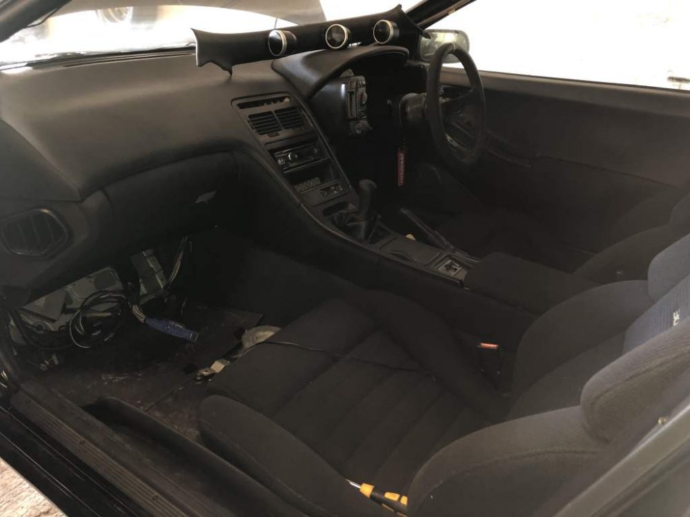

Managed to get most of the interior back together. Annoyingly, the very top clips on the A pillar trim broke, so will have to figure out how to beat fix those
Flywheel, clutch, Gearbox, starter, prop and exhaust will all go back on on Thursday when I get access to a ramp, and the remaining wiring modifications (trigger system and injector connectors for ID injectors) will happen at the weekend.... hopefully I’ll get time to give it a wash before it goes for running in and mapping on Monday
I think if all else fails, a simple self tapper for the a pillar, covered with a black plastic number plate cap.
I had to do something similar on mine, I have my rocker switch for the rear fogs mounted up in that area as well.

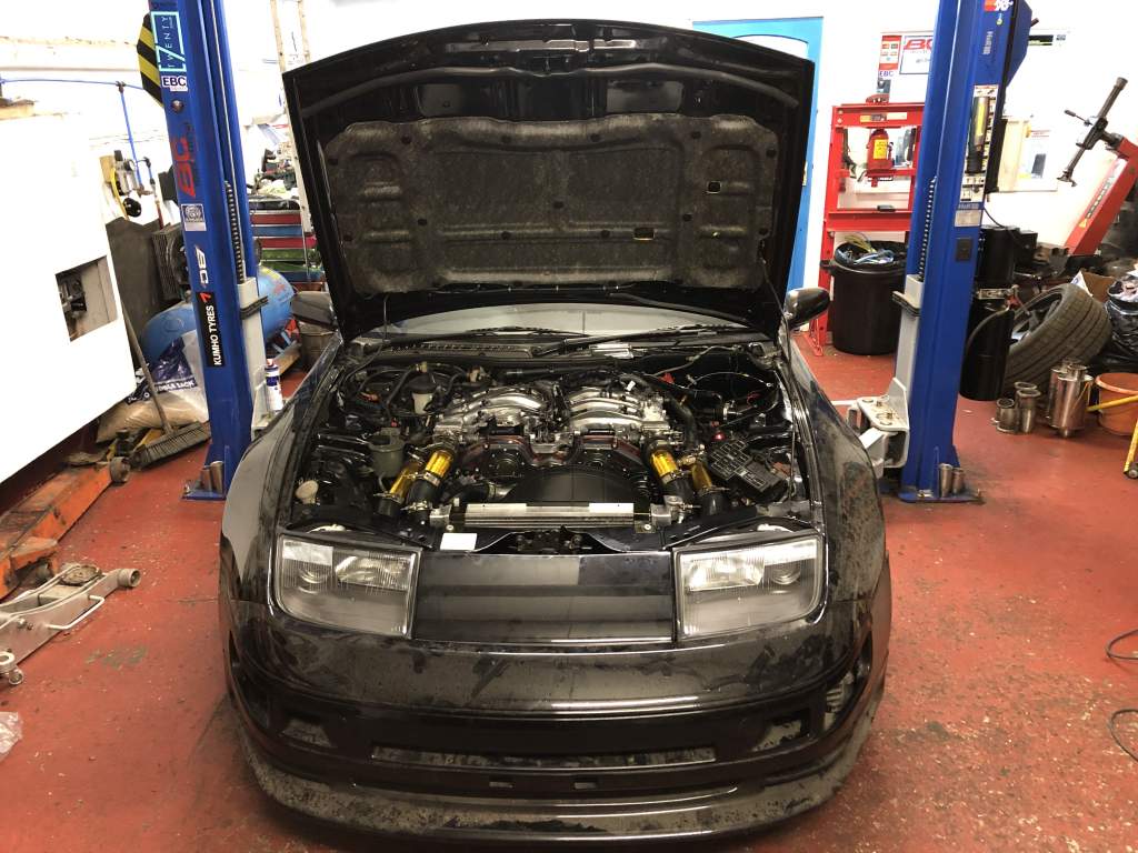

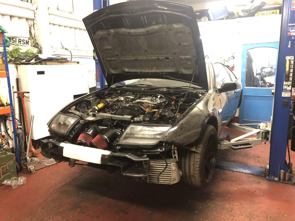

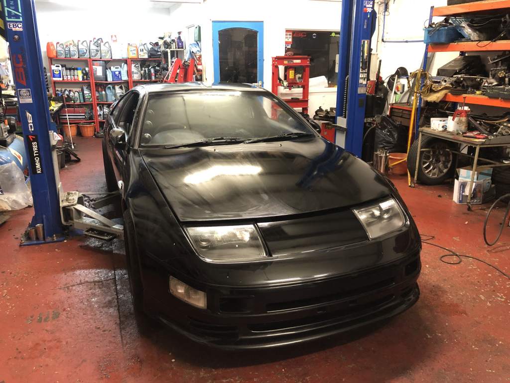

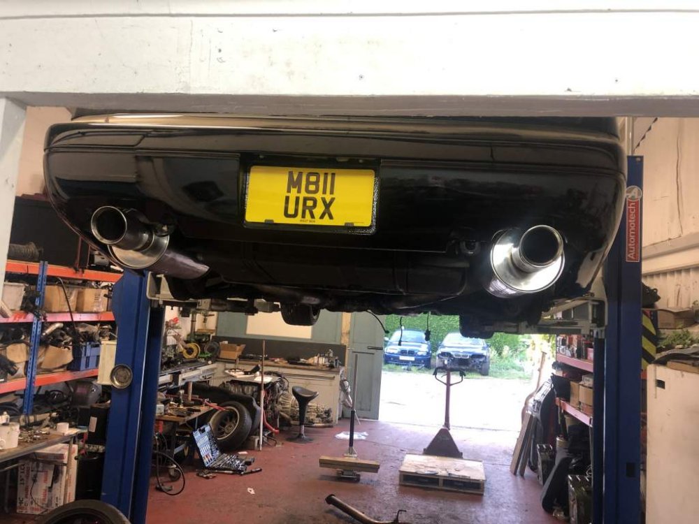

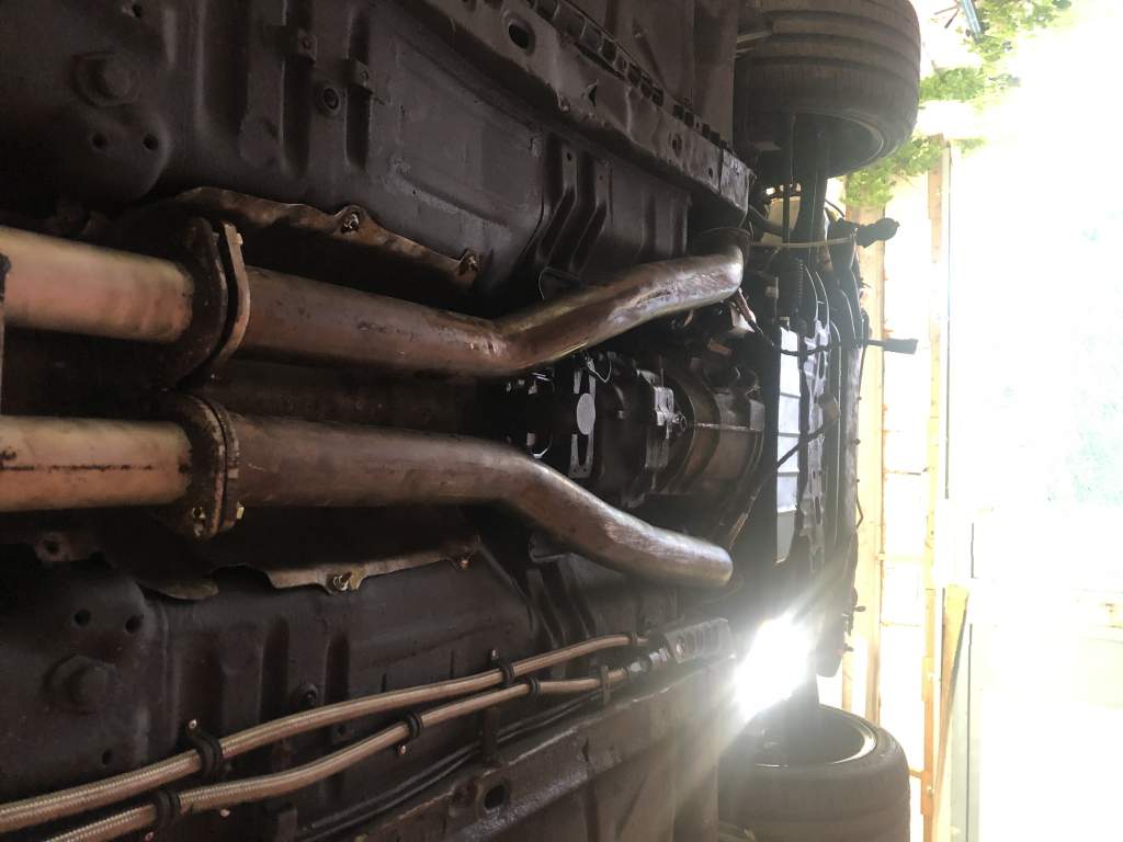

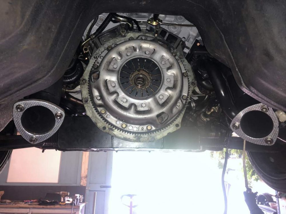

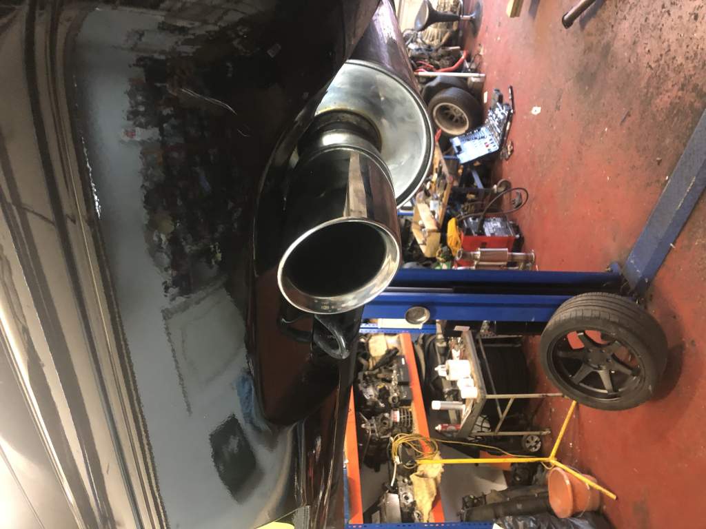

Unfortunately the H pipe I had made doesn’t fit as the ultra quiets hit the floor, so I’ll gave to have that remade in the future. In the mean time I’ve borrowed a Blitz cat back system from a friend. It’s only a 2.5” system rather than a 3”, but needs must with mapping due on Monday
And that’s where I left it after a 13 hour day yesterday working on the car. All the wiring has been finished, I just need to prime the oil system, button up the last few bits, give it a wash a load her up for tomorrow

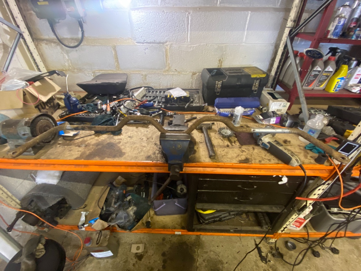

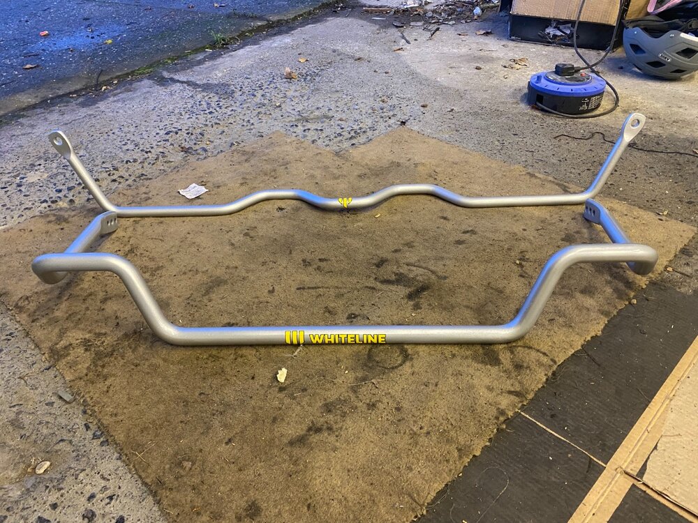

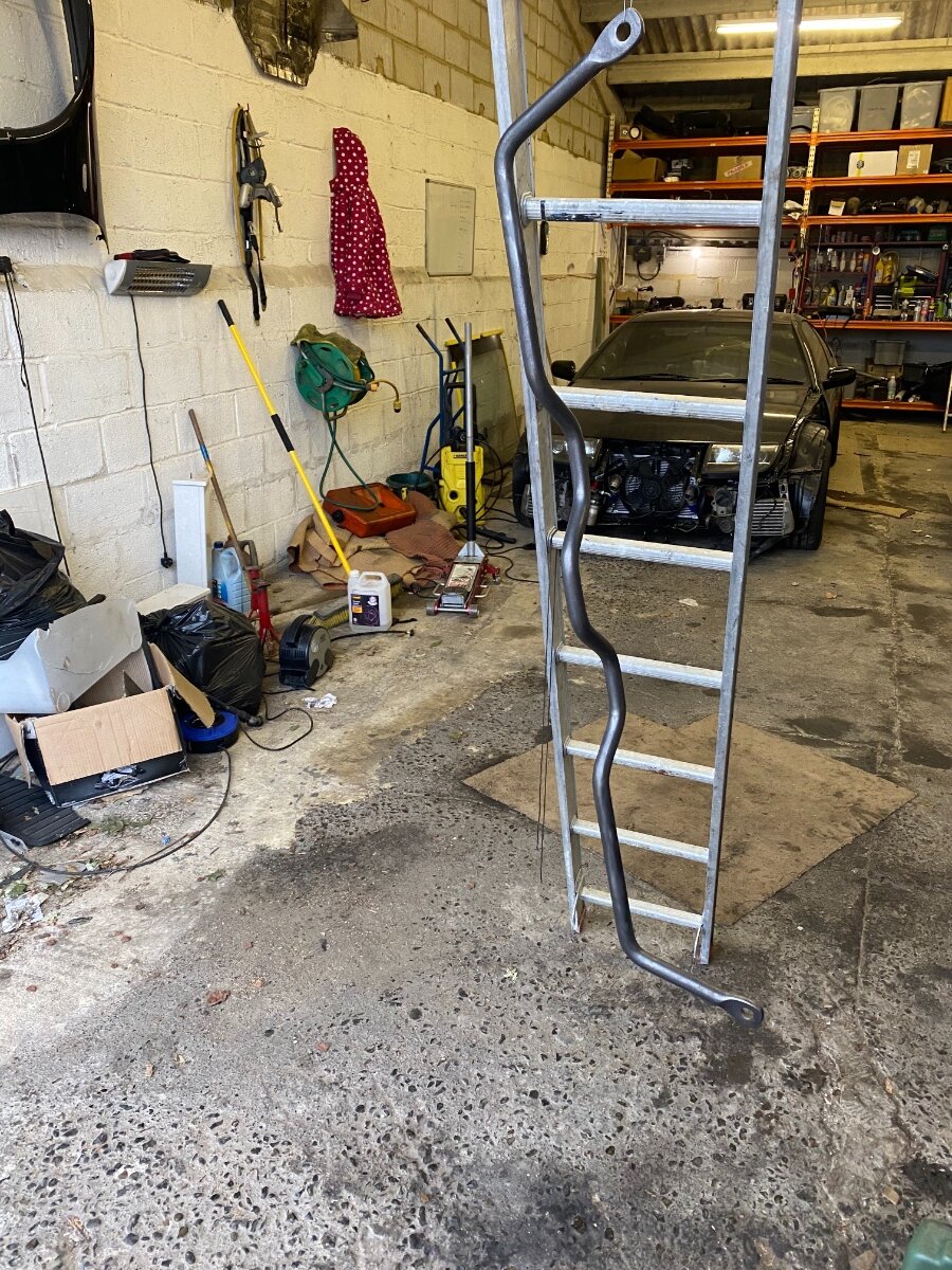

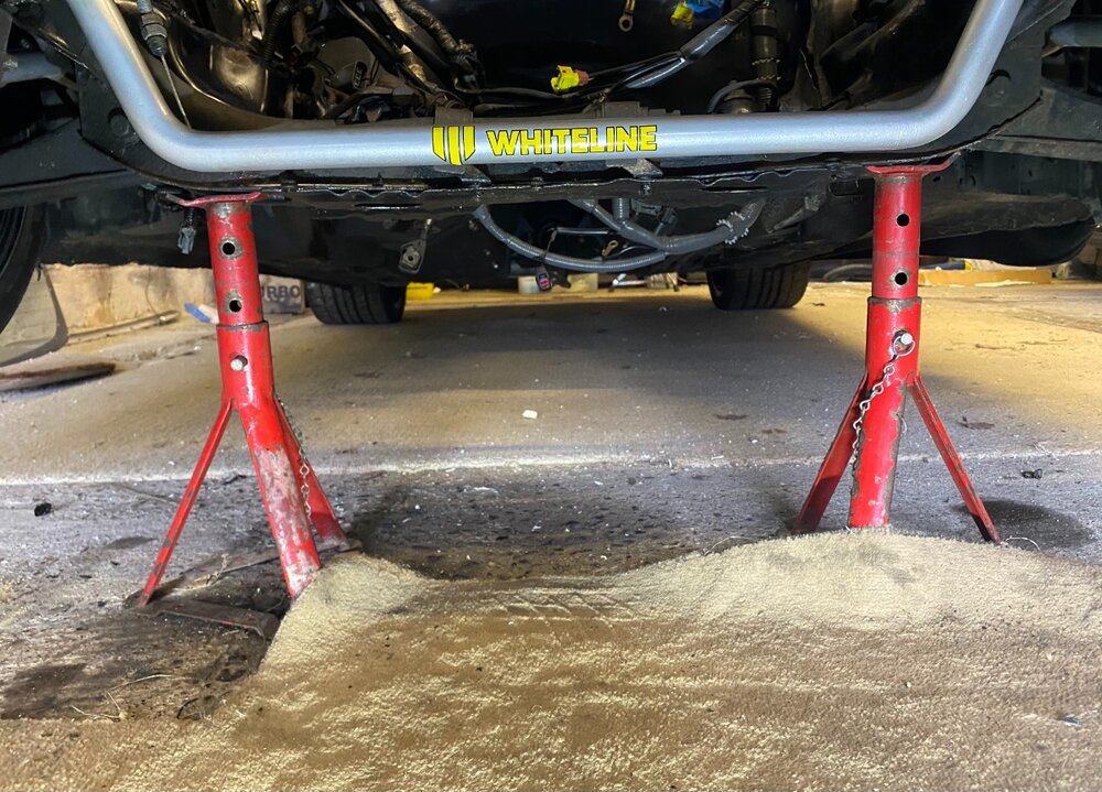

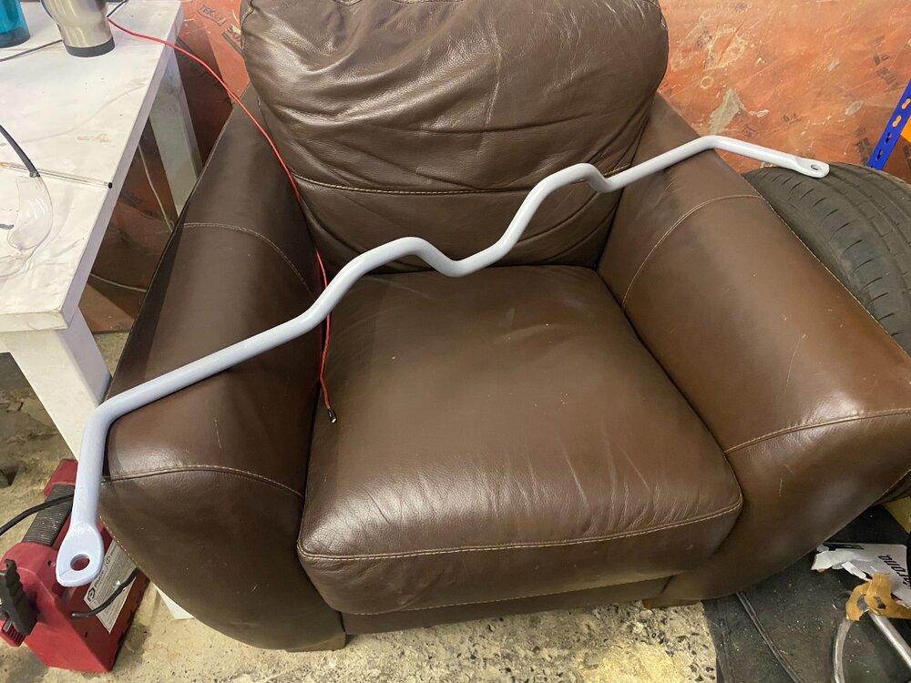

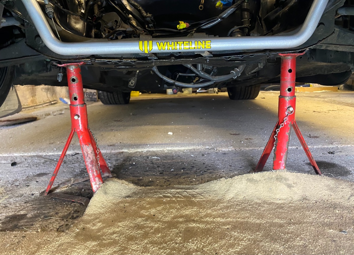

I bought a set of Whiteline anti roll bars from Banzai Breakers a fair while back, and they’ve been sat on the shelf gathering dust for a while, so month or so ago I decided to give them a clean up. As you can see, they were a little on the grotty side!
Edited by nickz32
So I attacked them with a stiff wire wheel, a couple of coats of etching primer and Ford Stratos silver (closest match I could get to the whiteline silver). They were finished with some new decals and 2k laquer... let’s hope they last!
My Stillen ones had the same level of corrosion. I wire wheeled them and chassis black. Keep meaning to pop them off and get them powder coated.
I’ll see how they last, I was pretty liberal with the clear... but worst case I’ll do the same and have them powder coated or cerakoted

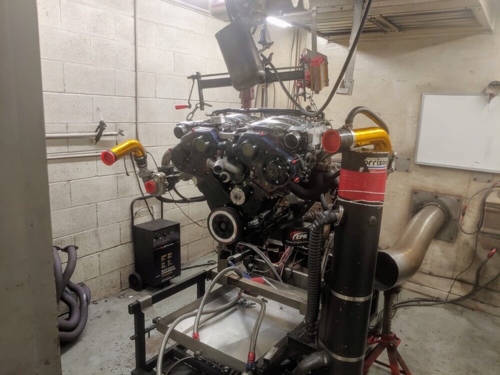

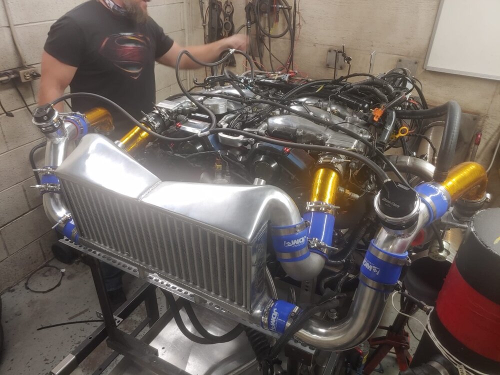

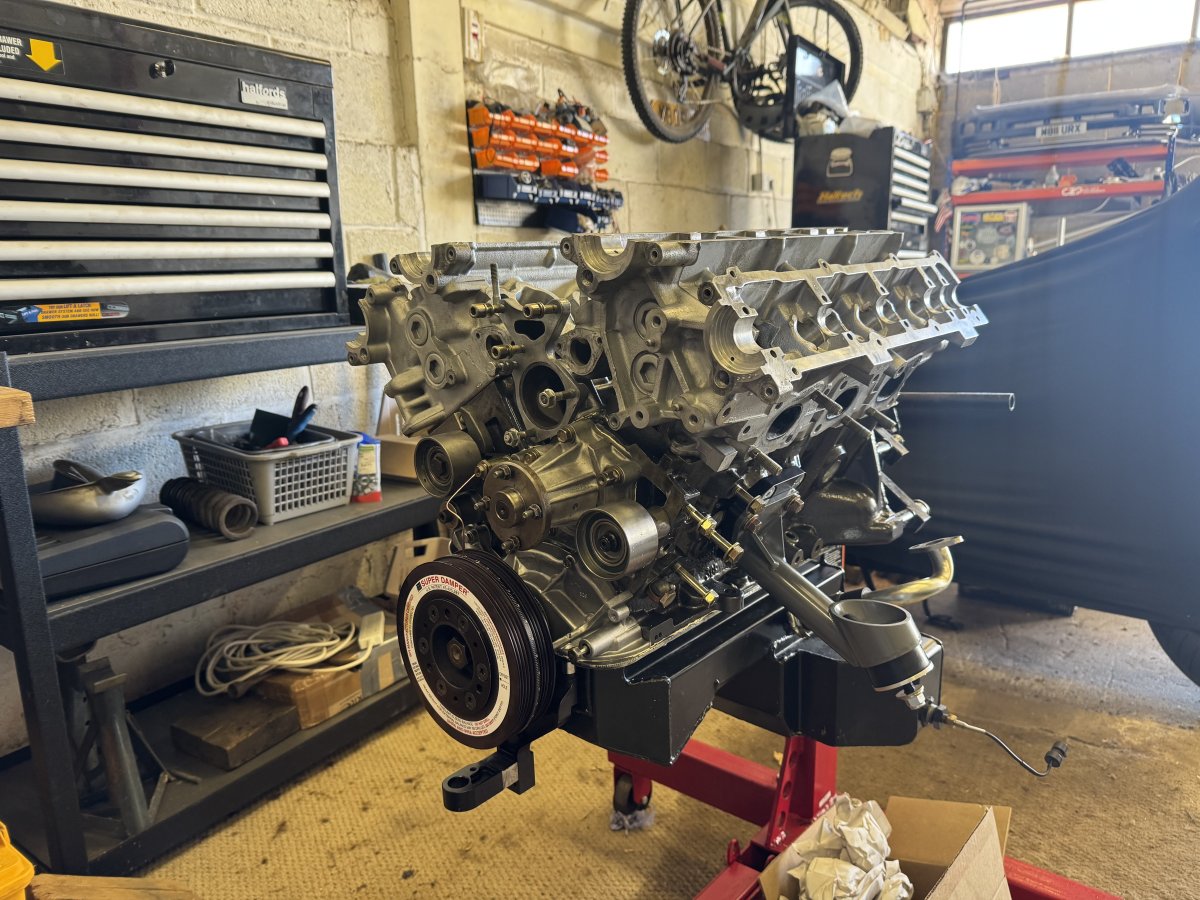

So, I can finally show you what’s been going on with my engine!

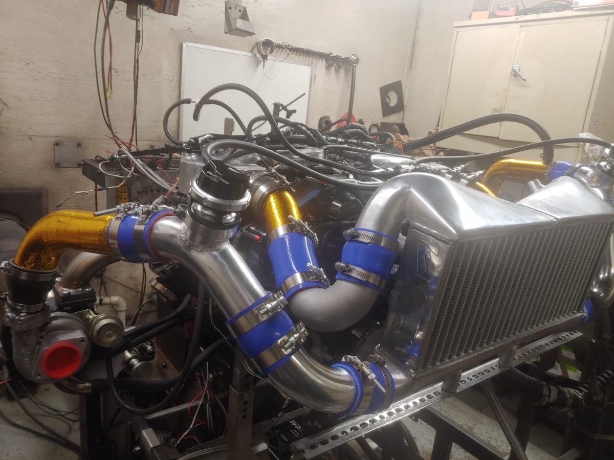

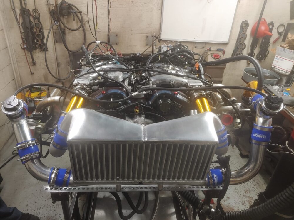

In order to finally rid my set up of its gremlins, and in order to get the BEST possible tune, my engine has gone back to the states where, as a first for a VG engine in the USA, it has been mounted to a Superflow SF902 engine dyno. EPR have undertaken all the work to make the required adapters, mounts etc etc to ensure a perfect fitment to an a fine dyno that is primarily used for small block V8’s and alike. ALOT of work has gone into making this a possibility, and I’m chuffed that my engine was the first!
As you may have seen in my for sale ad, I’ve also upgraded to a Haltech Elite 2000 ecu. This will enable me to run multiple fuel and ignition maps (low boost, high boost, high boost with race fuel..... up to 12 maps in total) as well as numerous other feature upgrades that make the ecu a much better choice for future proofing my project.
For those who don’t know the advantages of an engine dyno VG’s a chassis dyno, the main ones are
1) an EXACT crank HP reading rather than a calculated reading by a chassis dyno
2) much finer control of ramp rate, enable much finer tuning of fuel and ignition cells
3) lab controlled conditions, enabling finer control of airflow through intercooler aswell as oil and coolant control.... no worries about over heating the engine.
I’m waiting on an can adapter for the Wideband controller so it can be wired into the Elite ecu...
