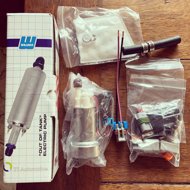

New Ti automotive 525lph fuel pump arrived today. This thing will give me a good 15% headroom with flow for what I need but is pretty amp heavy in comparison to my AEM320lph pump (525 draws just under 22amps at 70psi). So I’ve bought a 46amp capable Delphi fuse holder and 30amp capable Deutsch connector also arrived today. Just need to order some 12AWG Raychem wire, and the new pump setup will be complete.
How far will the pump be from the battery?
The same as any other 2+2 lol!
From memory my current wiring (which is 16awg) is about 4m when all the twists and turns of getting it to the pump connector
Edited by nickz32
Well it does say "out of tank" on the box, so not such an odd question!
22A using automotive 12awg (nominal 3mm²) over 4m will give you a voltage drop of 1V. Nominal rated max load for 3.0mm² is ~27.5A.
It’s a generic Walbro box, the pump is still an in tank pump
Where do you get that calculation from Andrew, it differs somewhat from the one I’ve used...
Thinking about it, I think 4 meters was how much I ordered, but I didn’t use all of it..... I’ll have to measure again when I remove my 16AWG wiring
Edited by nickz32
Ah, that’ll be why there’s a difference, my calcs are at 13.5V

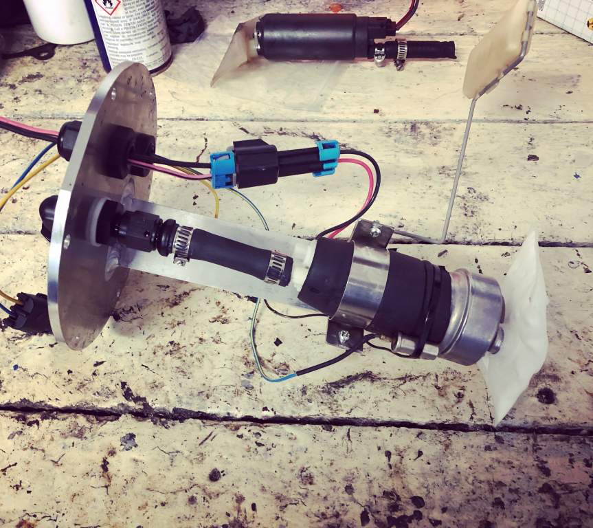

Swapped out the fuel pumps today. Need to get my backside in gear and sort out the new loom

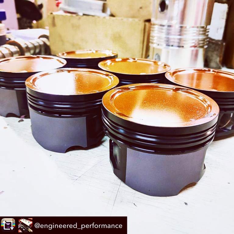

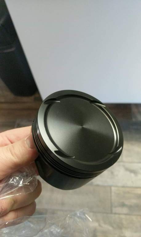

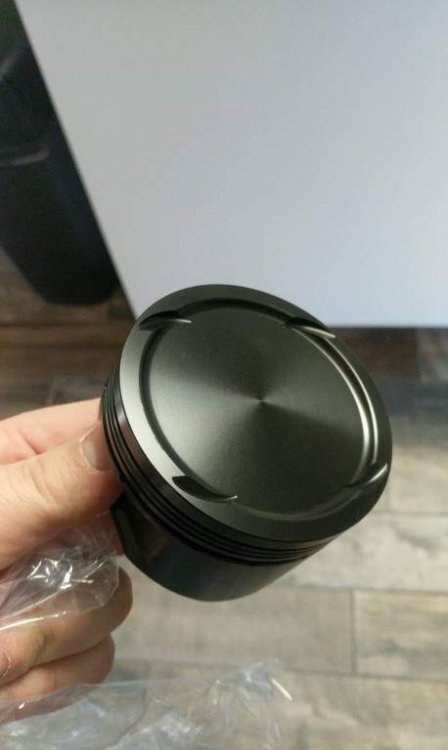

My CP Pistons came back from being treated with Diamondyze anodising. This drastically increases the surface hardness of the pistons aswell as improving thermal dispersion and anti friction properties
Then they’ve been treated with TechLine ceramic coatings on the crowns and skirt.
They’re almost too pretty to put in an engine!

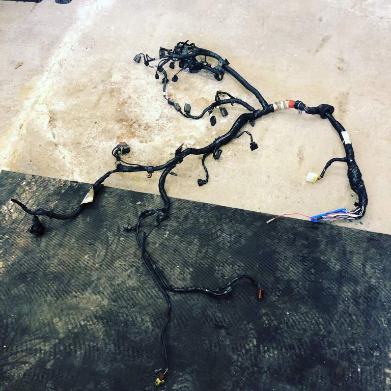

What an utter arse of a job that was to remove!
So the Milspec harness has been put on hold for now. For two reasons really, 1) I want use of the car this summer and I want to attend the AGM in it. 2) I want to future proof the MilSpec loom by having the required harnesses for a Haltech I/O expander box and CAN hub.
So I’ve just ordered a new ‘95 OEM harness that I will use for the next year, and then I’ll sell both looms in the future to recoup some of the costs for the Milspec.
I’m also due to have some custom intercooler ducts made this coming weekend. While the OEM ducts do bolt to my Z1 SMIC’s, they obstruct the top 3 and bottom 3 rows the the core.... far from efficient. The new ones will be made of aluminium and will expose the full face of the SMICS. Furthermore, I’ve sourced some arch liners from a mk1 Audi TT, so I can harvest the intercooler ducts from them and graft them onto my arch liners..... of the Germans fit them from factory, they must do something!
The first one i did took me hours and cut me too ribbons removing it,Such a satisfying job though knowing you are future proofing the car for many years.Anybody viewing this who has a sketchy loom should roll their sleeves up and get it swapped before they go obsolete.Top job Nick :cool2:

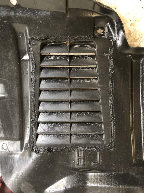

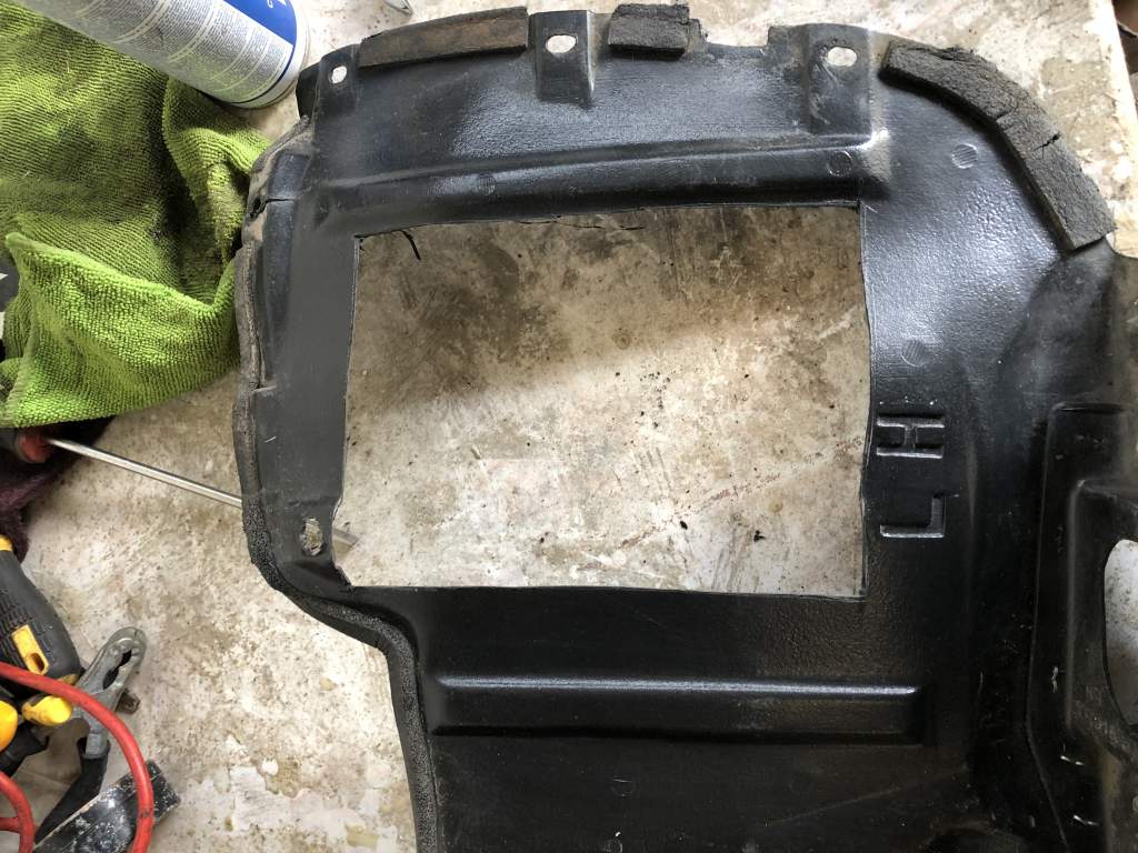

Started another of the “to do list” jobs today.

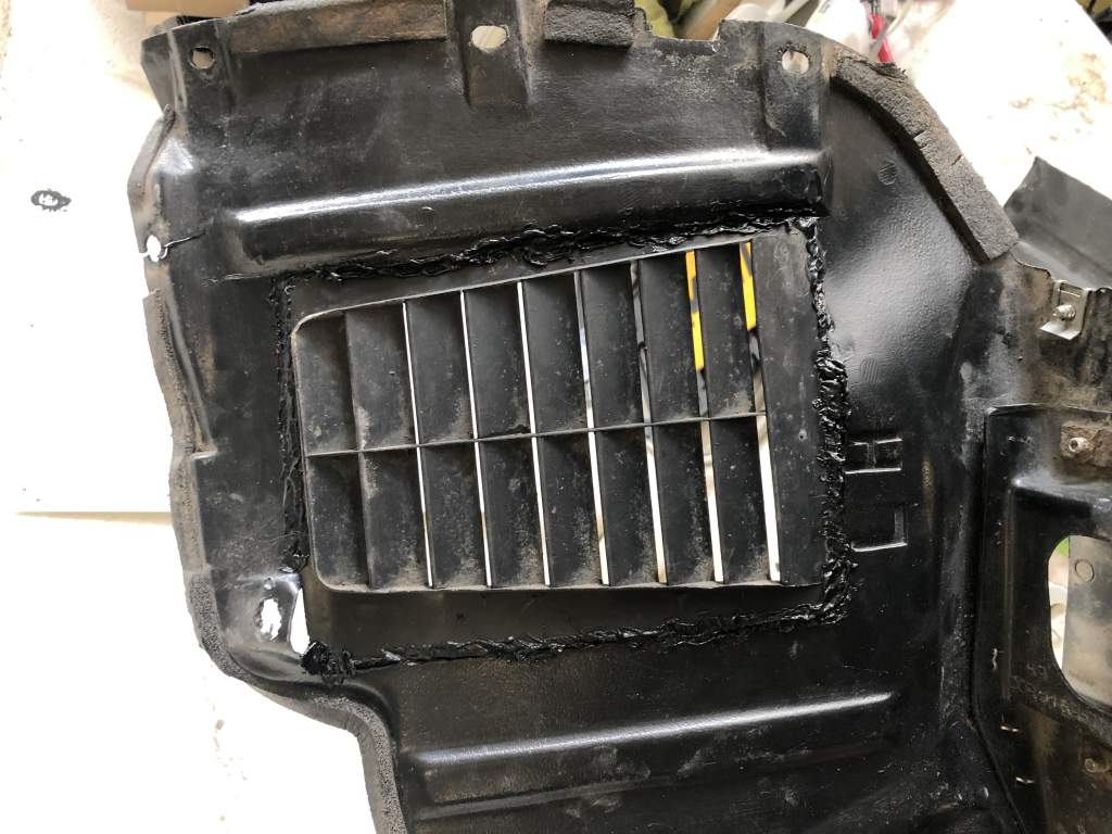

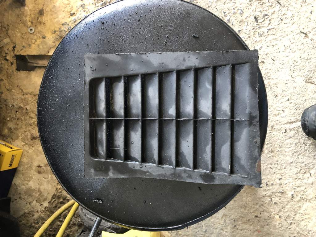

As I mentions a few posts back, I’d sourced a set of mk1 Audi TT arch liners. They utilise a vent in each front arch for air passing through the intercooler on one side and oil cooler on the other. So today I set about grafting the vents into my arch liners

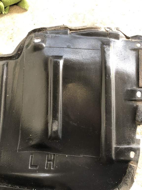

I scored an outline on my arch liner
And made the cuts
I then used the hot knife fitting on my soldering iron, plastic zip ties as a “filler” and set about plastic welding them in place. It’s been a while since I’ve done any plastic welding, but I think it came out ok. No doubt the second one I do will be a bit neater.
Given that VAG decided the TT needed such a vent for escaping air, i believe these vents will improve the efficiency of the SMICs by preventing positive air pressure building up behind the coolers and slowing air being fed through the coolers down.
I’m going to dig out the smoke machine and leaf blower for a crude test to see how they compare to an unmodified arch liner I have knocking around
I’ve done the same to mine Nick, although I didn’t fit a fancy pants grill :lol: big old Stanley knife hole.
