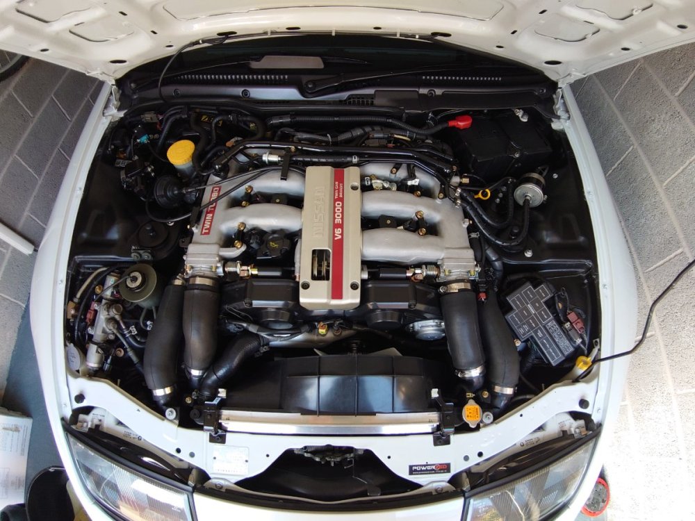

Looking good. Reminded me of when I did my engine bay a renewed and refinished everything and topped it off with a brand new later spec main engine harness and 740cc Nismo injectors. Plus some other new old stock parts that are nigh on impossible to get hold of such as brand new OEM Intake/boost hoses, OEM earth harness and clutch booster U-shaped hose. The only thing missing that I did after that was fit the spring style fuel line clips for the fuel filter and return lines - all other crap jubilee clamps had been removed.
It ran so beautifully with the new injectors and engine harness(es). Unbelievably smooth and responsive.

Out of interest Si did you ever regret getting the bay painted black? I’m torn between white and black. Black looks smart and lends itself to any colour car but white looks cleaner and stock.
Thanks! Lots of blood sweat and tears went into it but it was very satisfying, looked great and ran better. I had quite a lot of help too from people in Japan and the US. One particular screw was proving a nightmare to get hold of and that's the little screw on the early cars that secures part of the harness via a little metal clip to one of the offside cam covers. Chris Karl is one of my friends (ZCCA President) with quite a large car and part collection - he has buckets of Nissan fasteners - quite the nerd's paradise). I believe that both those OEM harnesses are now NLA. I wanted to keep the original hoses (took me a long time to get them), 2 Jim actually had and the other two I got on Japan and brought them back in my suitcase! I found that the silicone hoses are just too flexible and have little structural rigidly and actually collapse reducing the aperture considerably. Consider getting Flexi couplings and hard lines (powder coated satin black) if you're able to.

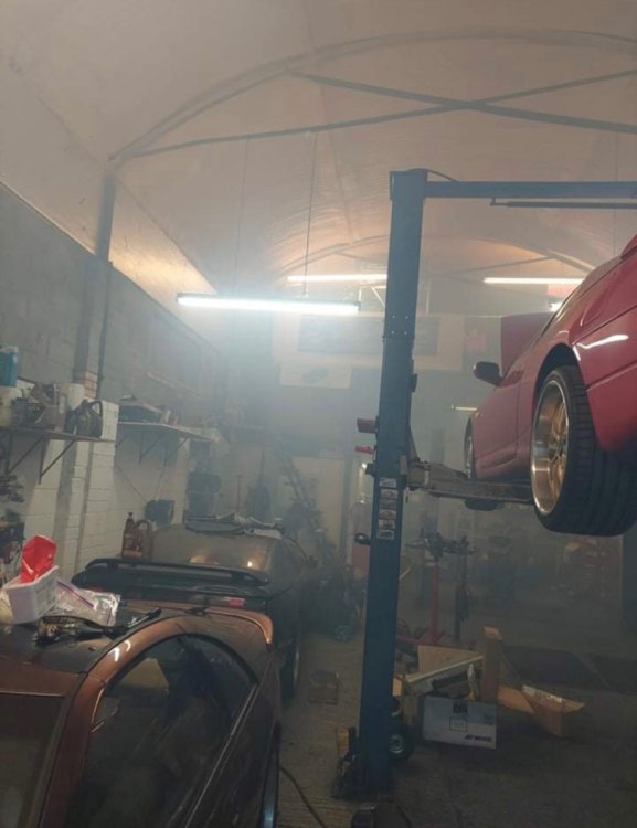

Well this project is about to take a massive leap forward.

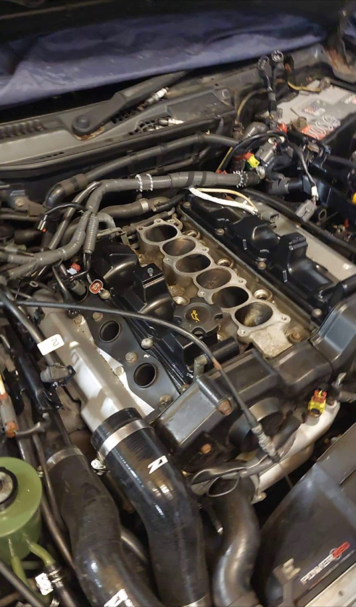

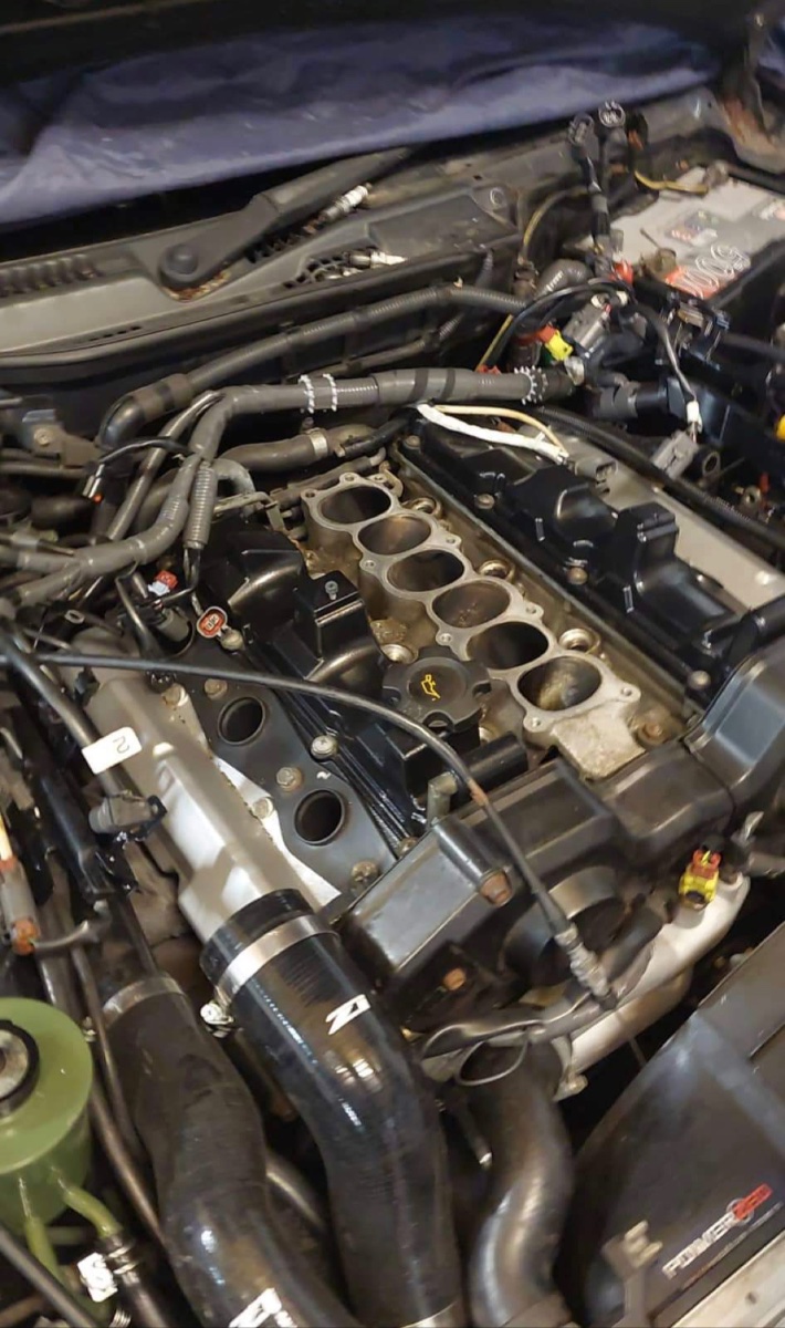

Unfortunatly, after Jim had fitted all these lovely new bits for me, the car is running really badly filling the workshop up with smoke before running like a three legged horse. It’s got no compression on a cylinder and a fuelling issue. ????
Jim sent the injectors away for testing, after trying some of the other potential issues, as there was a small possibility that they weren’t originals but thankfully they are. ?
So the next step sadly is to pull the engine. ?
As it’s always been my intention to get the engine out at some point I’m trying to look at this from a positive perspective and will be tasking Jim with a lot more work than intended. ??
So the first thing on my list will be to get the engine bay properly prepared and painted. I had some remedial body work done in there after I first acquired the car but I was unhappy with the seaming around the work. This will be a good opportunity to get that properly sorted before painting.

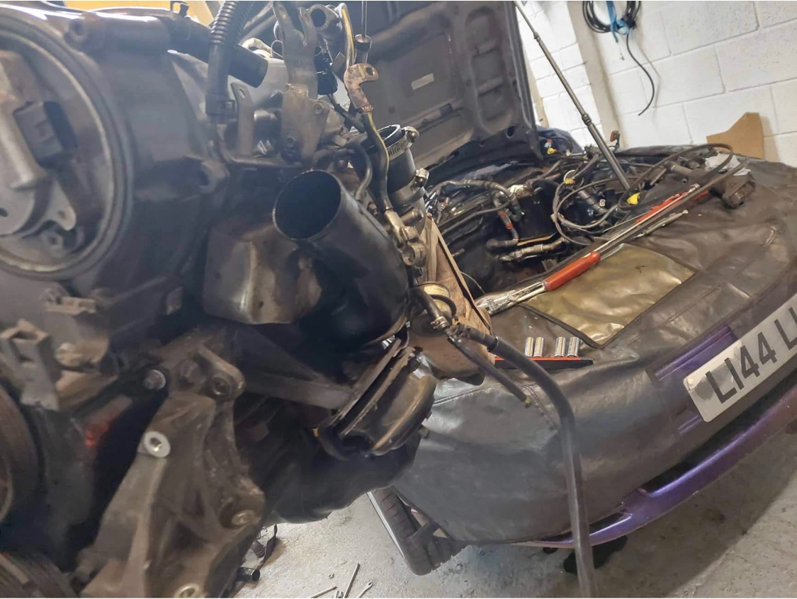

Jim is currently getting the engine out now. Hopefully this will expose what the issue is and then we can look at how to move forward.
So things are starting to move forward. Jim has the engine and gearbox out ready for her to be taken away to Alfie’s Autobahn who will be painting the engine bay and sorting out all the powder coating that’s going on up front. ?

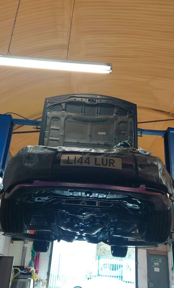

So now that Jim has the engine and gearbox out the next stage was to get the chassis to the body shop.
I’ve taken the car to Alfies Autobahn in Westbury, Wiltshire, which is not a million miles away from Jim. Matt, the owner, is not unfamiliar with the 300zx having completed a manual conversion on another 300 last year.
Matts brief is to drop the front subframe and suspension for powder coating, prep and spray the engine bay in Aston Martin Morning Frost.
The bay has now been documented and thankfully there’s no structural issues found.

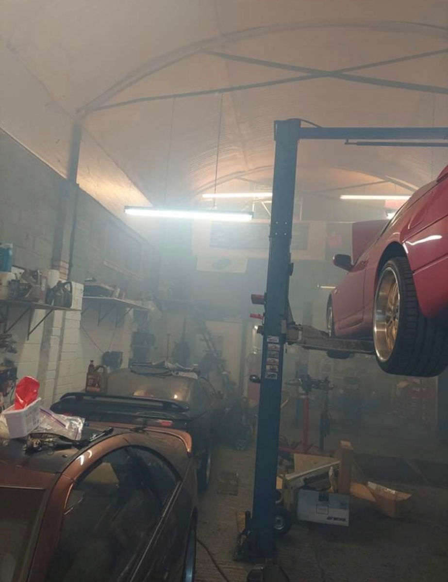

Well this project continues to try and break me. ?
Last week I received a message from the Matt, the owner of Alfies Autobahn, the company who I sent my car to to have the front subframe, suspension and engine bay stripped ready for paint and powder coating before reinstalling, telling me that the owner of the workshop had kicked him out and changed the locks and that he had until the 19th of January to get everything out before the bailiffs seized everything. ??
Thankfully I did get a bit of luck here after contacting the company who Matt had sent parts to for powder coating, Craig at Platinum Wheel Repairs. Craig told me that Matt had sent over a load of parts but there were a number of bushes that hadn’t been removed so hadn’t processed the work.
Craig put me in touch with another business who would be able to remove the bushes and repress new ones once powder coated, James of Garage24 motorsport.
After talking to James it turned out that his business specialise in Jap cars and has a thing for restoration. James was also local to Matt and offered to rescue everything. With time pressing and me desperate to get my car out of the clutches of the evil Matt, he rushed down to Alfie’s Autobahn picked up my car and parts. James was horrified at the state of Matts workshop and how my parts were stored. ? However he gathered everything up, loaded the trailer and saved the day.
Not wanting to have my pants pulled down again I decided to visit James so we could talk face to face and check out his garage. I’m so pleased I did, his workshop and work was immaculate. I have absolutely zero concerns about his work and his integrity.
So at the moment I stand around £1k  out of pocket by sending the car to Matt, a car with the front end in pieces and very few clues of how to put it back together.
On the plus side I now feel that my car is surrounded by professionals.
The next stage is to find a company to do the paint work. Again James has given me a few contacts and I’m awaiting details and prices.
A few pictures of how she currently stands. Structurally the bay is in fantastic condition, I want to get the caulking redone before paint but other than that there’s only minor surface rust. ??
James also wants to put a few more hours in to get the last parts out before sending to paint. ?
