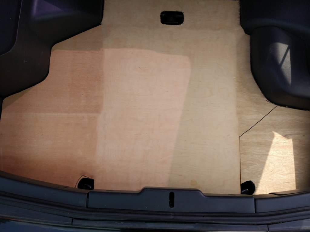

After completing this today, it only took about an hour.
I would have to side with Si, only for the reason of splintering. The jigsaw will splinter ply, but leave smoother cuts out of MDF. As long as it's strong enough and your rear wiper doesn't leak then you should be good032bf92c448f992ce5fa33bbc3aae2b2.jpg

Sure I could have made it neater, smaller teeth or done by hand, but I really couldn't be bothered [emoji38]
