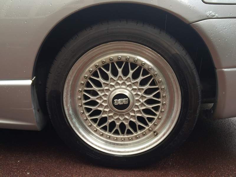

Got some BBS alloys I've had refurbished and need to order my new tyres, what do you guys recommend sizes and brand? What are the widest tyre I can fit to them,there not staggered,cheers guys

Always thought these were 17s
They look to me like 17 inch sized inners with a step up barrel to 18 inch. Though the they're that was on it can confirm what size if gray still has?

Right so 17" you were correct. I would keep the 45 sidewall and it looks like 275 width? You could fit a 285 on it by the looks of things.

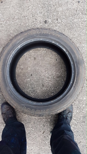

Ok...after a lot of searching we found my old tyres,the wheels were fitted with two different tyres, Avon zzr1 x2 and sunny sn3900 x2? None of which are going back on,sizes were all the same...(235/45/17)..so thinking after reading reviews on some new tyres I'm going for earthier Michelin pilots sports or Pirelli p zero's....so do I stay with 235 widths on all four,or can I put 235 front and put wider on the rear? Could I push the rear up to 245's or 255's for better grip?

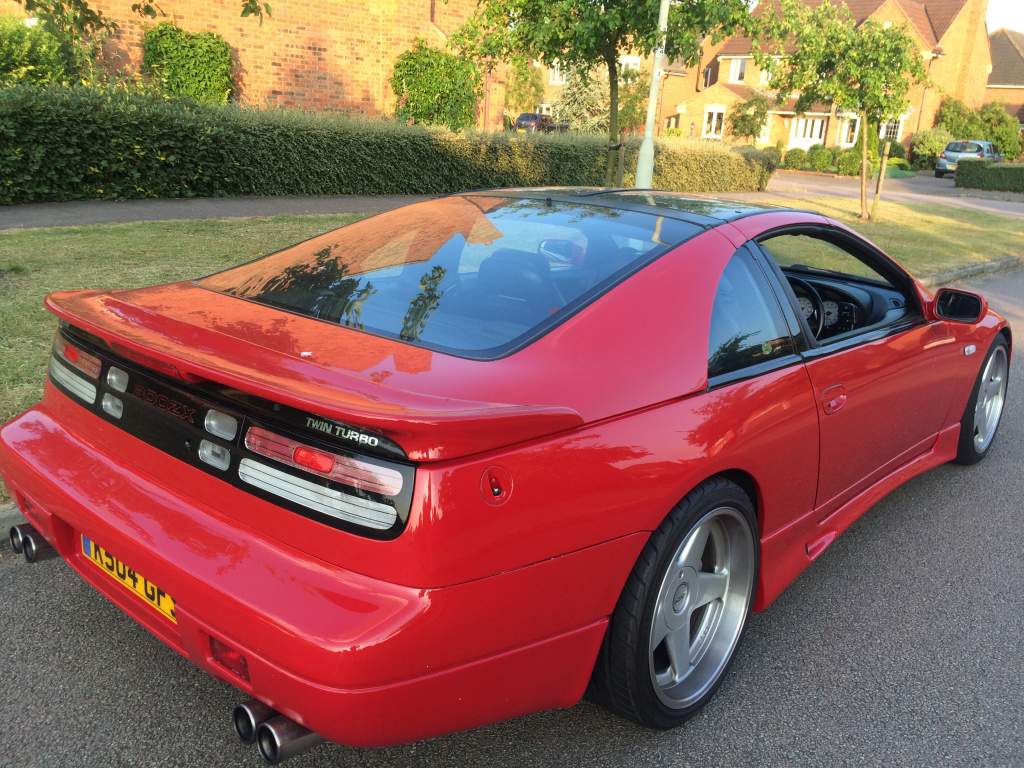

Mines been lowered with a nice set of Azevs fronts are 8.0 225/40/18 and the rears are 10.0 255/35/18 I wouldn't go pass 255 width at the back if it's sitting low other wise it will catch, here's a picture of mine not the best angle

With your rim sizes mate, you'd still get a 265 on the rear - my Zed is slightly lowered on Meister-R coilovers and I run 235/40/18 fronts plus 265/35/18 rears; without issues!
Thanks, will try and get some proper pics up when I get it washed, I did have 265 as a tester and it used to catch sometimes only because it low at the back
