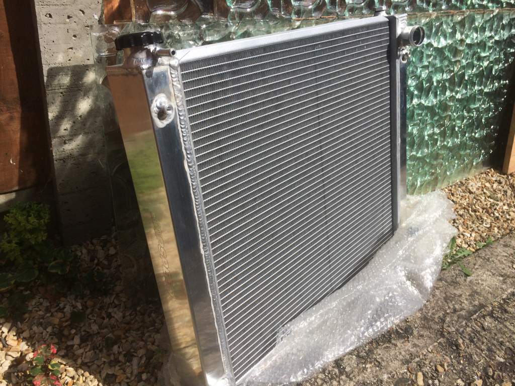

Not many updates at the moment. As you can imagine the house is taking a lot of my time and most of my tools are still in storage. I can’t remember wether I’ve mentioned this but I’ve discovered the radiator has a pin hole. It’s a Japspeed item for probably 7-8 years ago. It’s up the top and is a tiny drip only when pressurised so it’s not actually a massive issue. I wouldn’t take the car on a long journey like this but it only leaks if I top it up.
The quandary I’ve got is wether to just pull the rad and have it welded. It’s on the core itself centerally. Or to simply replace. Obviously a blob of weld will cost me virtually nothing but I’m concerned it’s a larger corrosion or defect issue. If it’s a seam on the core, I’m not sure how those tubes are produced it could split.
What do you think guys, repair or replace?
Replace! It’s unlikely you’ve done the damage so there’s a good chance more holes will start appearing.
You’ll need to have it out for inspection so have a look once it’s out. If it was me I’d probably just replace it anyway to remove all doubt of further failures. I have read an article from Greg Dupree which suggests aftermarket larger core roads are simply unnecessary (even in that hot climate), so I’d probably just get a good quality pattern part from Mishimoto @ around £100.

Belts and radiator replaced.
The belts I went for Continental units in 1000mm and 870mm. My old power steering belt was past its best once I removed it. New belts were a snug fit... just for Jeff.
Radiator I ordered a generic aluminium unit from EBay. It turned up emblazoned in Japspeed logos and cost significantly less than the ones on thier website:lol:
Not bad for an hours work and no more coolant loss or squealing!
