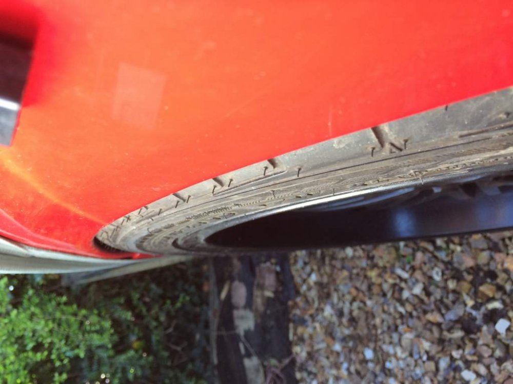

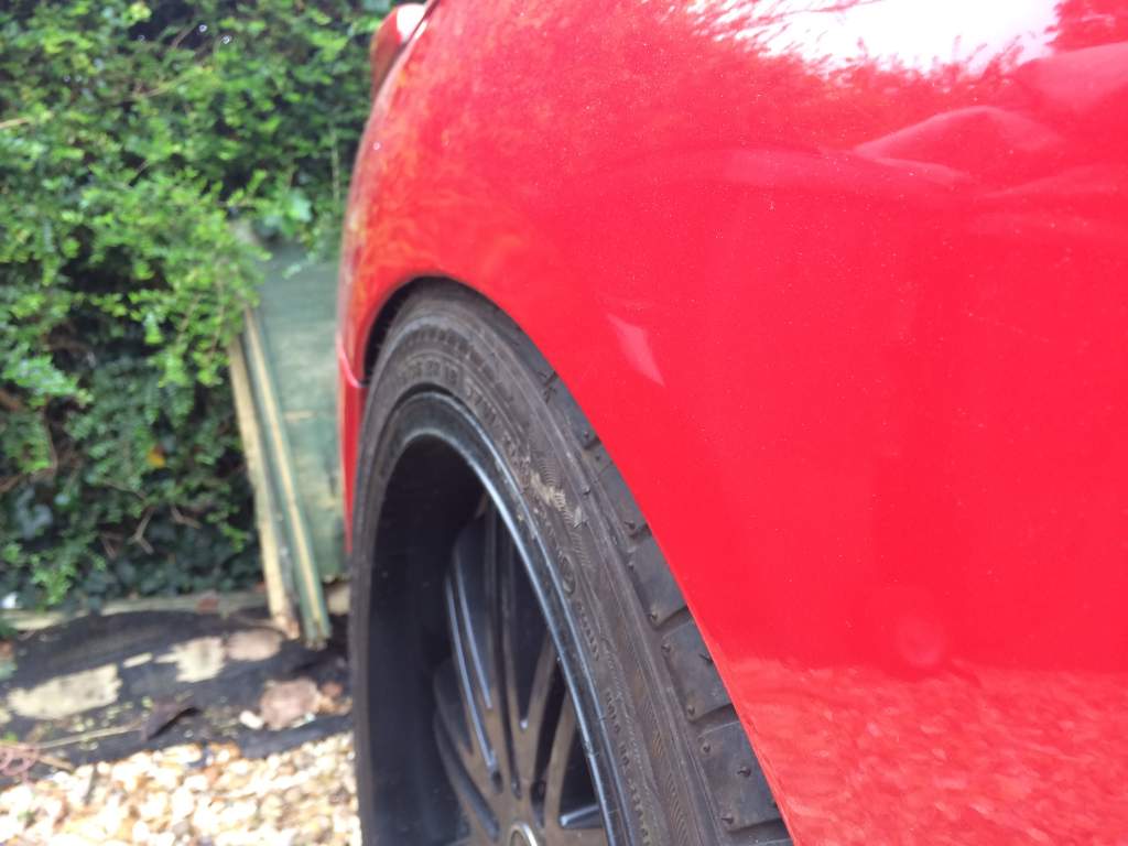

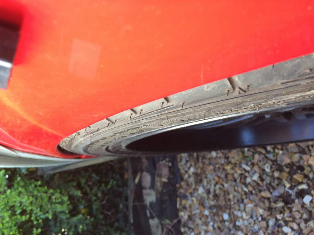

Yeah it’s incredibly aggressive. When I first put the wheels on I was really worried about hitting the arch, on full droop I had about 25-30mm of protrusion. That pulled in and initially the rear was so low that half the tyre wall was in the arch and the mid section of the exhaust was mm from the gravel, at that stage it rubbed. I brought it up an inch where I wanted it and my maths was bang on with fag paper clearance. I know my camber is effectively zero so once I dial in just over a degree it should all come together nicely. Real world vs hard parking is the test though and I’d be quite happy to add another 10mm all around for driving quality.
I’ve rolled it around and other than noisey it seems ok. Gotta book it in for an MOT now.
Time will tell Joel. Once you start adding roll etc into things it changes. I’ve hacked the front arch liners and rolled the rears pretty heavily. I’ve seen lower though...
Did a bit of faffing about today. I didn’t want to paint myself into a corner so to speak, where I’d pull off the drive for the MOT and find it was scrub city. So I added 15mm per side to front ride height and 10mm to rear. I also added a touch of negative camber to the rear. I now have about 5mm between the flattened arch lip and the tyre wall, much better. The front can come down but that can wait. Right now it’s a ghetto alignment by eye but it will get the car to the MOT station.

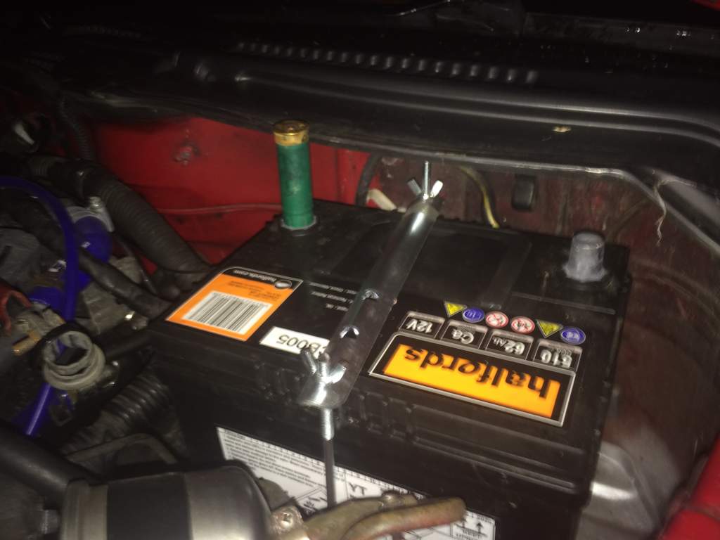

Battery insecure. I have no idea where the clamps gone so I picked up a universal one yesterday to modify. With the light fading, I couldn’t find those handy caps that cover the battery terminals and me keen not be electrocuted (not a good way to start a weekend off work) I needed a solution. #countrylife
Yes that’s a spent cartridge:lol:

Battery tie down is done.

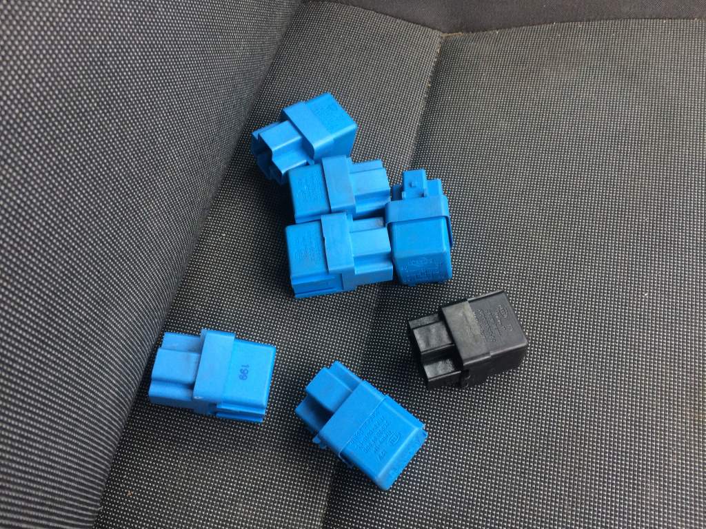

Horn (forgot this off the initial list) this gave me the biggest issue. The relay and harness was full of crud so I had to rebuild a new subharnes as wiring it straight through just didn’t have the balls.
And then... the left pod stopped working, this was an intermittent fault but obviously it meant I couldn’t activate my wipers to prove new wipers sufficiently cleared the screen. Grrr. Fuse box back out and with me now out of reliable relays I swapped the blower and accessory ones. I don’t need the blower right this immediate second. This seems to have worked and when activating the blower it just sat there clicking and clacking, supporting the idea that it’s the relay at fault. So I need at least two of those bloody blue Nissan relays. Time to go to the car graveyard and rifle the fallen. :devil:
Edited by Stephen
When you need electrical parts a dead Micra is the way forward. Thank you little red V plate Micra, may you rust in pieces and your parts perform in ways they could never dream, contributing to keeping a monster alive. 6 Blue relays from one micra, result!
