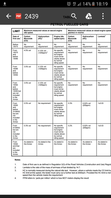

Lex posted this on another thread a while ago.....

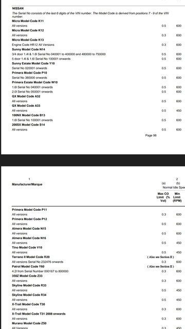

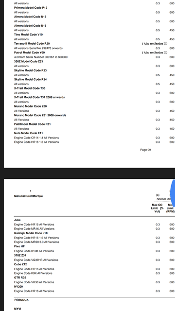

And here's the Nissans listed in the Annex.
Apologies for poor pic quality. Photobucket seems to have reduced quality.
I'll re upload from my laptop later tonight.

I'm struggling to read them pics.

I'm pretty sure they cannot fail your car for emissions......... As a 300zx isn't on the Annex they cannot test for emissions if they have No reference, so it would go under this section... and that states it is only an idle test if I am reading it right...

Since you quoted me, I just wanted to clarify what I was referring to in the post you quoted.
the 300zx must still HAVE an emissions test. But it only has to have the BET (basic emissions test) which is conducted at idle.
The OP's car has failed as his CO emissions are too high. The BET max level for CO is 3.5%.
Most zeds would pass this easily (mine passed it comfortably when it had de-cats fitted).
I'm going to sound a little harsh here - but please ensure you know what you are talking about before passing on information. It could have been very embarrassing for the OP if he had shown up at the MOT testers shouting what you had told him whilst all the time he was incorrect.
Again, sorry if that sounds harsh.
