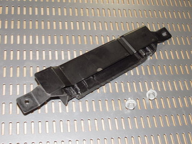

What is this block of metal in my boot?
1990 Z32 TT.
So I was stripping the interior of my boot lid to refurb the rubber seals etc, and noticed this block attached to the bootlid.
I thought maybe it was part of the mechanism for the (removed) rear windscreen wiper, but there are no connections. It's just a metal block connected by rubber to the brackets that bolt it to the bootlid via the holes to the left and right of the block in the picture (2x10mm bolts).
Just wondering if anyone knows what its purpose is? Weight distribution? Bolt on block to replace a windscreen wiper mechanism?
Cheers
  • Replies 29
  • Views 2.7k
Its a counter weight, i got rid of mine years ago :thumbup1: serves no purpose other than supposedly give some even weight distribution between front and rear of the car
When the car was new and the gas struts were new, and there was no water was in the original spoiler the metal block weight was so calculated to give the tailgate enough counter weight so that a small assist to raise it was required without it shooting up too rapidly.
Over time however the gas struts get tired and the original spoiler takes on water both of which upsets the calculation making the tailgate heavy to lift up, taking the weight out will assist to a degree, but in general changing the spoiler will cure a heavy tailgate.

I thought it might be vibration in panels lots of cars have blocks like that underneath.
A bit of it was rubber and could move, if it was just for weight would they have not just used solid metal...

Appreciate this thread is a year old, but only Terry got it partially correct.
It is certainly not a counterweight as it would serve very little purpose at that. What it actually is is an anti-vibration device fitted to reduce 'flutter' on the tailgate created by resonance at certain speeds. I wouldn't remove it personally, the weight is insignificant and hardly worth ditching.

You have to ask yourself the question that if the function of this weight was simply a static counter balance why did
Nissan go to the trouble and cost of suspending the weight on elasticated rubber supports?
[ATTACH=CONFIG]106662[/ATTACH]
Exactly. It's self explanatory once you look at it (I hadn't previously), it's also diagonally placed for that reason to help with resonance in wider angle.
I'll happily get it confirmed from the horse's mouth with Toshio San at ZCon in a few weeks. It was brought up a number of times before.
