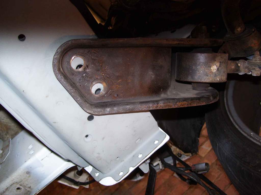

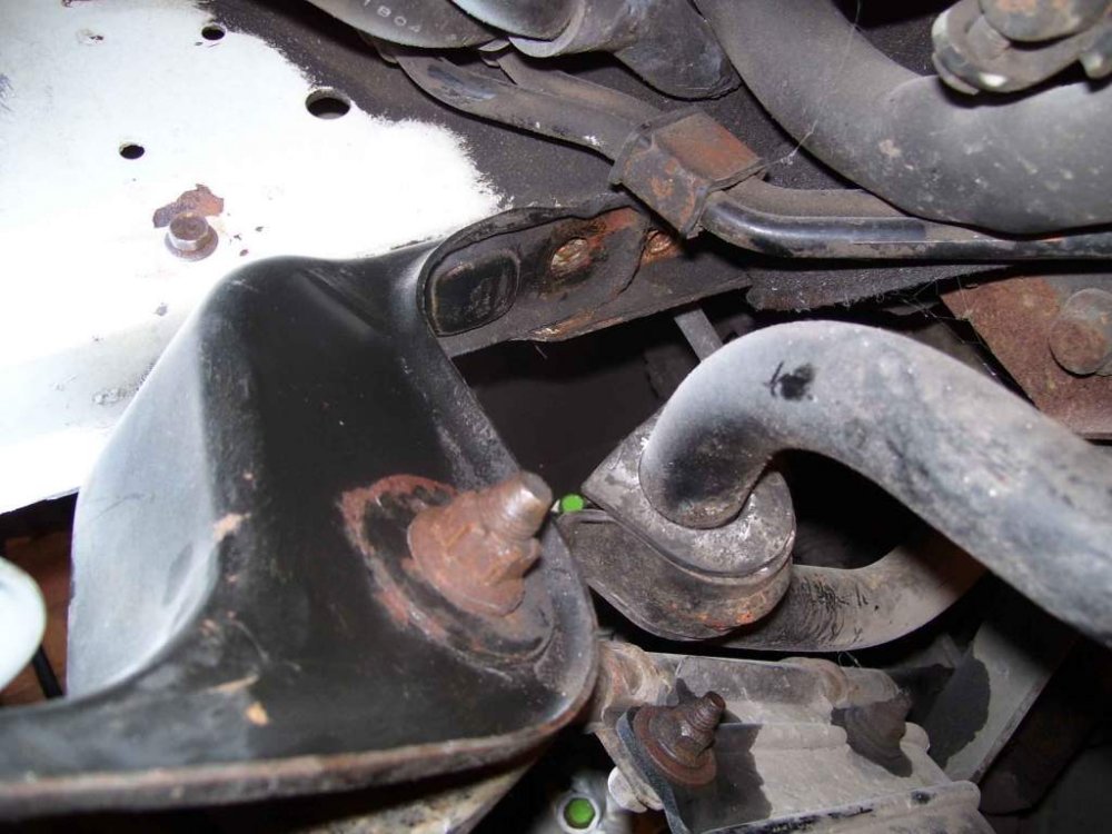

Not sure how to explain, but it is the two brackets that carry the tie rods, they bolt up to the underside of the cross member.
Front to back they seem okay, it's Left to right that is the problem. I would undo them completely from the tie bar but just can not undo the bl&&dy bolts. Hey ho, there is always tomorrow.

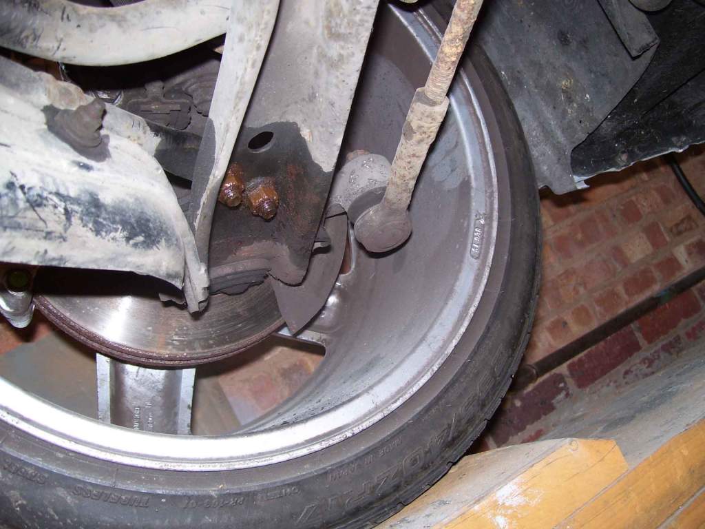

Sorry for the delay Russ, I've been tied up with the spot weld fault on the crossmember.
As promised, here is a picture of my dilema.
I have to say a big thank you to Slick Pete for his invaluable advice as to how to overcome the alignment, thanks mate.
I will post my results shortly along with a step by step guide.

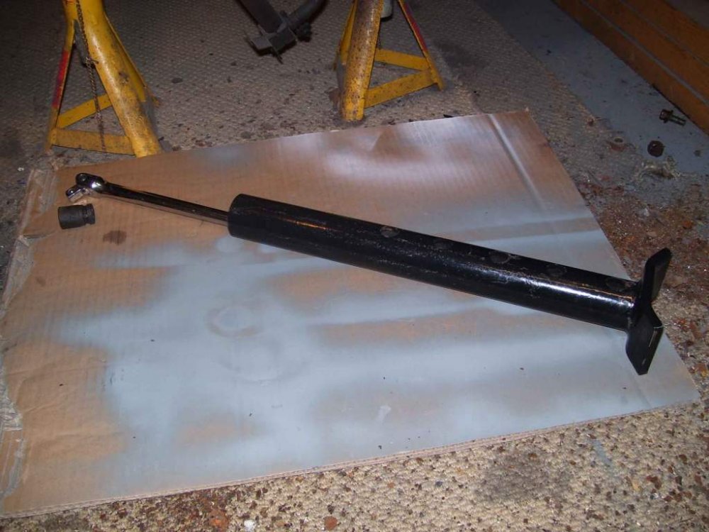

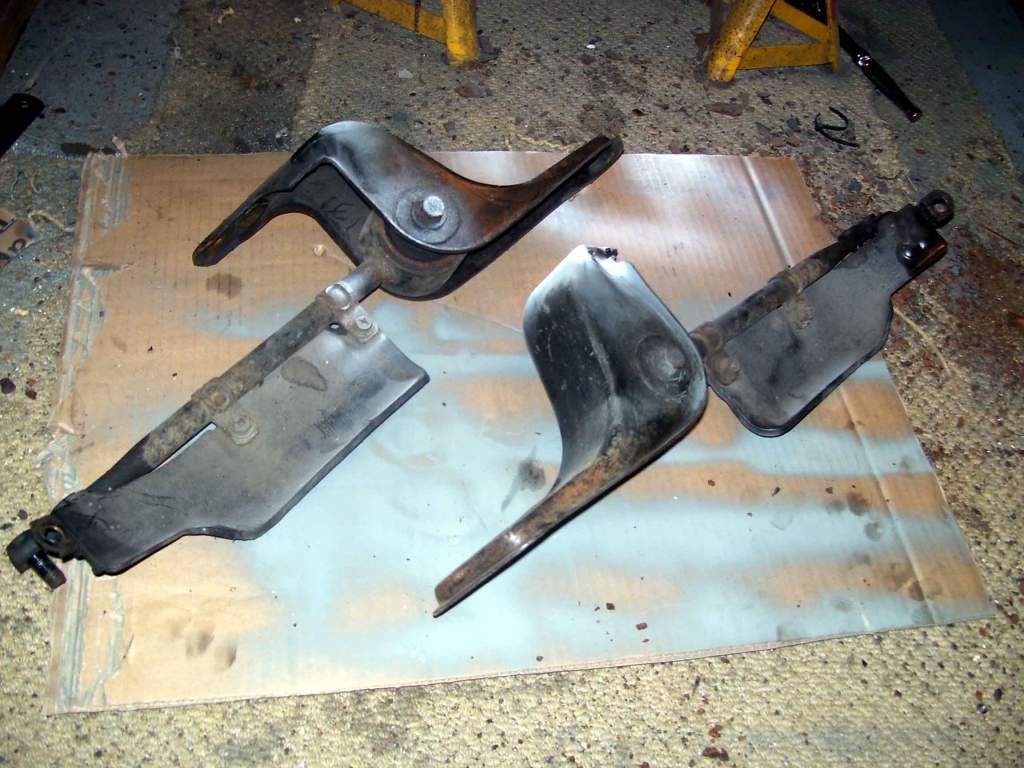

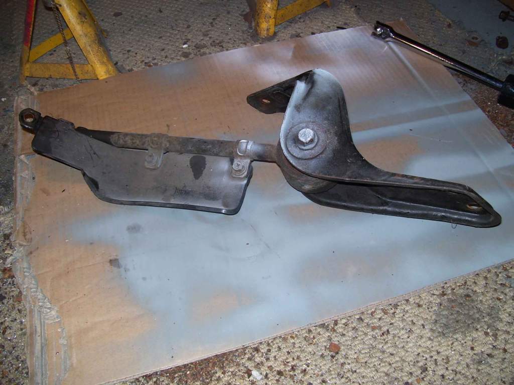

Thanks to some improvisation and a copious amount of Plus Gas, the first tensioner rod was off. Phew.
Just a matter of repeating on the other side.
I don't see the problem ...
As long as each tension rod bracket (with the tens. rod disconnected from the lower arm) line up to all 4 holes (2 in the lower support and 2 in the frame rails) there is no problem.
The reason why it doesn't line up correctly now is because of the tension rods (and tension rods are called just that for a reason)
Thanks Lymon.
Hopefully I will get time to bolt up the bracket to the crossmember and chassis rail without it being attached to the suspension arm today.
As you say, if I understand correctly, the issue will be move the suspension into the correct position so as to engage the 2 connecting bolts.
I guess it is my lack of my understanding that is the main issue.
