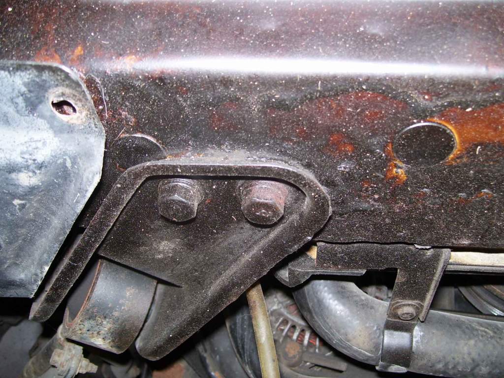

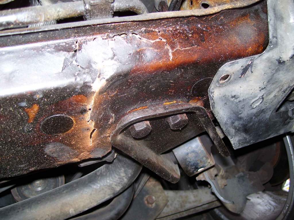

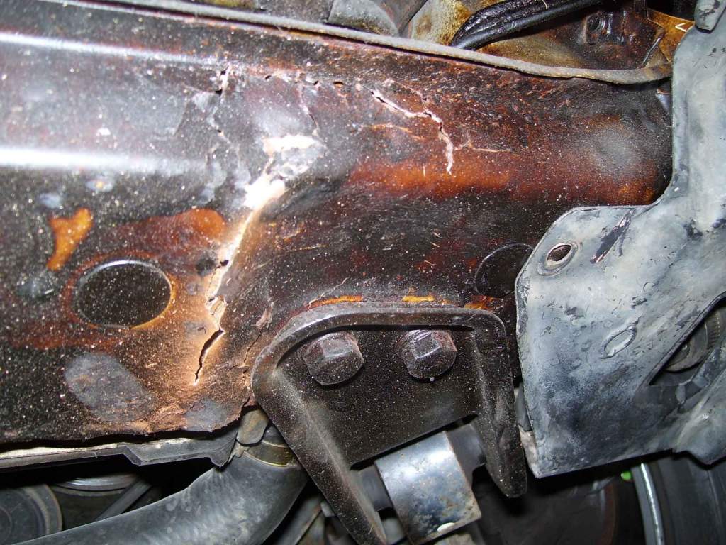

Disastrous discovery! how bad is it?
Just before going for a quick spin, I thought I would just check a couple of things like exhaust mountings, break lines etc'
Lucky I did, I discovered that my front cross member has collapsed on the front near side due to corrosion!
I cant believe how bad it looks, so gutted to say the least!
Looks like a very difficult job to me, so distraught at the moment.
Especially with the Coventry meet just around the corner and my MOT in a months time!
I could really do with some experienced advise as to how to approach this one, I am worried that it could be the end of the car.
Please see pictures below, 3 of the near side and 1 of the far side.

Hrm. That's a doozey. It is a piece in its own right but iirc it's spot welded in. Looking at what you've got there the corrosion looks quite significant. I think it would be faster and probably mandatory to acquire that section from another shell and fit it. Getting to it very may well take longer than replacing it.

Mate, get a new one!-lot less hassle to fit and will outlast the car!-Allan would fit it for you if you didn't feel up to it mate.

Defo give Guy a call, he has done many of the very repair you need and does it in place, replacement is a cut out and weld in new which labour cost is huge let alone £400 for the member and two wing ends.

Red, I'm breaking a tt auto and the cross member is in good condition.. I'll be cutting the car in half at some point so,if you want to bring a grinder and cut the section out that you need, you're welcome to it mate.. Gimme a drink and it's yours..

The only difference I think is between na and tt due to the rad mount locations. But easily moved.

Red, the cross member on the breaker I have is in very good condition mate, it's probably cos it's been coated in oil half its life by the looks of it!
Seriously mate, come and take this one and see if it helps you out. I'd like to see it go to helping keep another Z alive red. You can have it free of charge.. It's at least worth taking it to see if it can help and all it'll cost you is a little work to take this one off. Theres no engine in this car so you won't have any trouble getting access to it. The wings and front bumper are also off so basically you're looking straight at the bit you need..

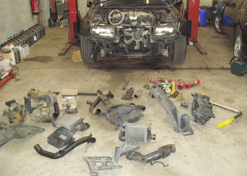

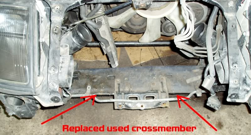

If you hell bent on changing it then be prepared to remove a lot of kit, one I did about 10 years ago:
Jeff
Old damaged one cut out surfaces cleaned and new one refitted welded in place.
