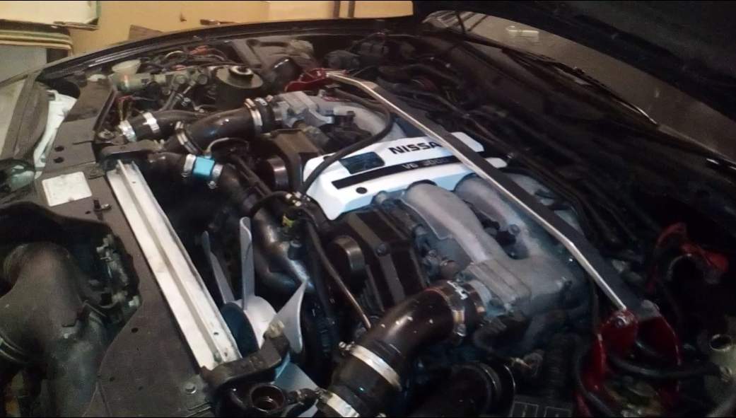

Hey guys, I've got some hard pipes to replace the soft plenum pipes, there are four boost hoses? I think that's the correct name.. Anyways, can anyone show me which pipe goes in which position as I'm about to do some dipping on them and need to know the positions so I dip the designs the right way up.. because they aren't all the same, it's giving me a headache!

Assuming yours are the same as mine, on the bigger inner ones the joint is at the top, and the thinner outside ones the joint is furthest to the front of the car.

Could you reupload the picture? Mine weren't very hard to fit whatsoever, in fact the stock rubbers were twice as hard to remove.

They look roughly the same, not sure why with the thinner ones one has a bend both sides and the other just one?
But it should be:
Bigger ones, bend at the top by the throttle bodies
Smaller ones, bend at the front of car, near the radiator.
