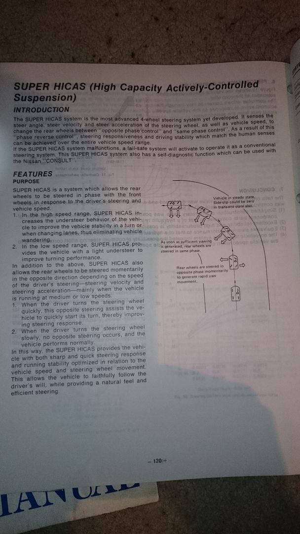

I suspect the phrase has been coined. Ie it's always been super HICAS but the super prefix has been dropped and applied to define the early vs late design.
Does sound like a reasonable explanation. No more arguing :thumbup1:
Andrew stop being silly, you're wrong. There's no way that Marketing brochure by Nissan is correct, Wiki is independently verified so I'm with Ali on this one (sarcasm meter full scale deflection).
I understand yours and Andrews doubts, but was merely trying to resolve this kerfuffle, not saying he was wrong.
It wasn't just me under the impression that there was hicas and super hicas otherwise we would not have this discussion.
Wikipedia and some skyline article. (i know, i know) but it seems widely accepted on the internets
To be clear I'm not starting a fight, I am having a discussion
The Skyline system is rather different as it uses all the information you suggested to control its active AWD system and suspension. R34 onward. It uses a separate computer to that of the HICAS.
The early and old style HICAS found in the Z32 are pretty much identical, it's only by way of actuation where they differ. The main brains are similar, if not the same and do not measure yaw, g-rate, speed at which the steering wheel is being turned or any of that. They take a speed input from the dash and one from the steering angle which is taken from the HICAS sensor found behind the steering wheel.
All the other stuff you mentioned is all stuff collected in a separate systems on the R34+ models of the Skyline.
Oops I've started something again,
I get bored at work and go through our archives of old brochures, probably read a skyline one then, just ment I prefer the electric system, sure there nothing wrong with it but never liked the idea of running my power steering fluid under to the back of the cars,
Just got my 1989 product guide out, it's referred to as super hicas so guess I'm wrong lol...
