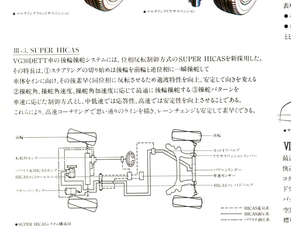

We talking about hicas, or super hicas? Ditched the hicas on my old zeds, eventually I'm buying JaiKai super hicas, not sure it's justified but have something against the hydraulic system the later electric system I want ( someone removed it from my zed very disappointed when I went looking for it)
Both the hydraulic and the later all electric systems were called Super HICAS in the Z32. I think it just got shortened
in this discussion to just plain HICAS.
I thought it became super hicas in '94 when it became electric, I there actually a "hicas" then?
I was under the same impression.
That's what I thought.
Super hicas used a computer to measure stuff like how far and fast steering wheel is turned, lateral Gs, yawrate, and road speed. Then calculates angle to turn it. Hicas is just hydraulic valve controlled by ECU (only uses speed wheel is turned, speed and steering angle)
Si come get me[emoji14]
Give me strength!
Conflicting information is doing my head in.
HICAS or SUPER HICAS is widely excepted too stand for High Capacity Active Controlled Steering (Super HICAS was a updated version on later models)
Earlier HICAS versions used hydraulics to steer the rear wheels. The hydraulic system was powered by the power steering pump and used speed sensors to determine how much and in which direction to steer the rear wheels. Later versions, called Super HICAS, moved to an electric actuator for the rear steering rack, making the system much lighter. The Super HICAS system also used its own computer to control the system instead of speed sensors. HICAS and Super HICAS rear wheel steering is limited to about 10 degrees in either direction.
While I cannot doubt your source, it would make more sense to have a base hicas, and then upgrade it and call it 'super hicas'
And the source of that is?
Wikipedia and some skyline article. (i know, i know) but it seems widely accepted on the internets
