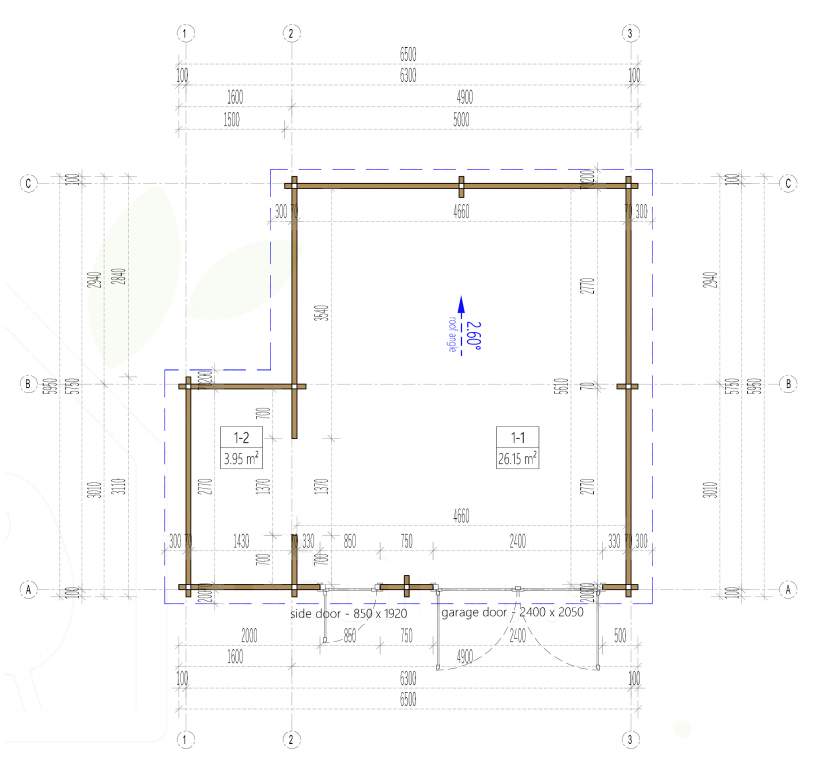

Working out costs and building regulations but plan is to take out approx. 130ft of hedge, replace that
with a nice new ranch board style fence then build a 22ft by 20ft zed garage at the back of the garden.
Trying to get it as wide as possible up to the fence but really would like to skip on the fence at the back
and just build the garage from breeze block unto the edge of the garden.
The back end of the garden only measures about 18ft but the hedges are nearly 5ft wide at the back so
we will be gaining another 5ft after they are gone.

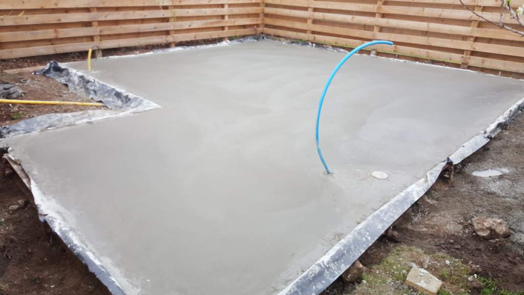

And its all done,
Came home just after 5 to a nice smooth surface.
The side cast is coming off next week and we shall be putting in the order for the new garage in the next few days.
Its now a race between my zed getting done and the garage getting done.
Two projects side by side to compliment each other.

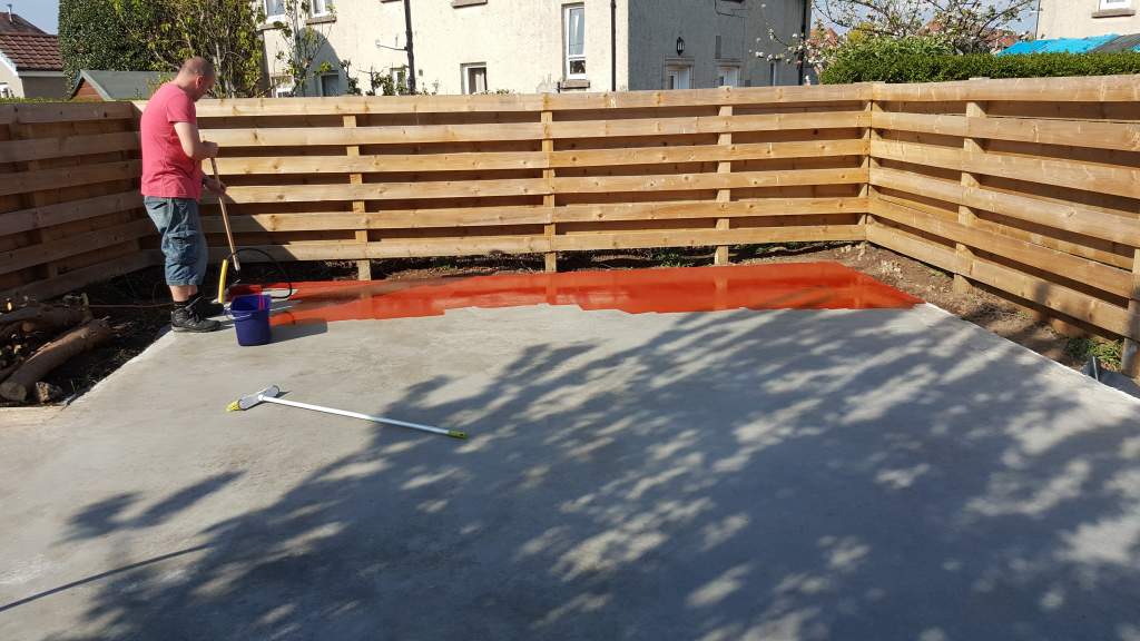

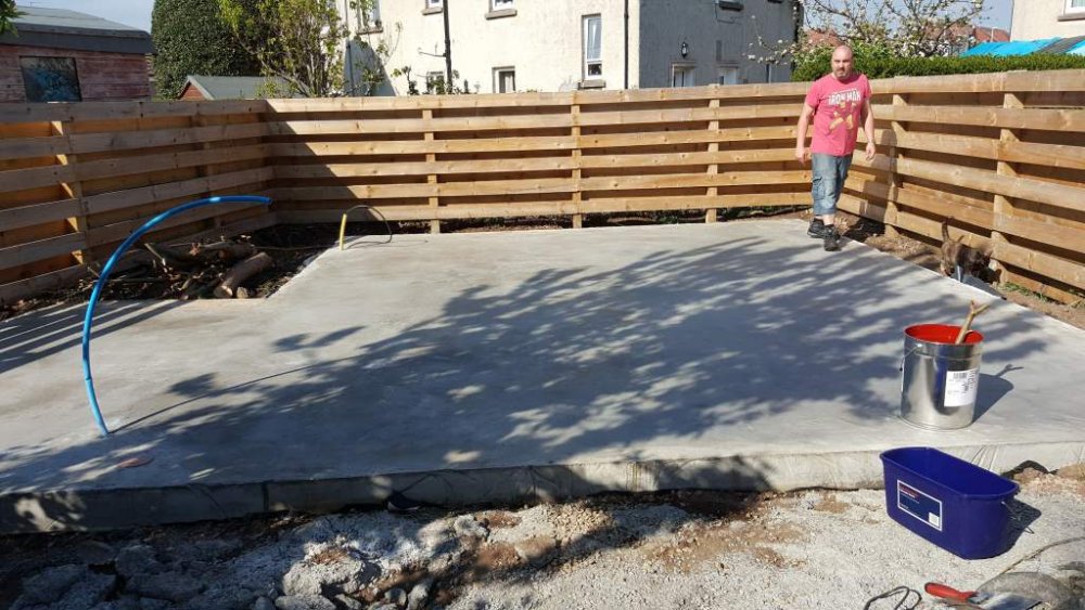

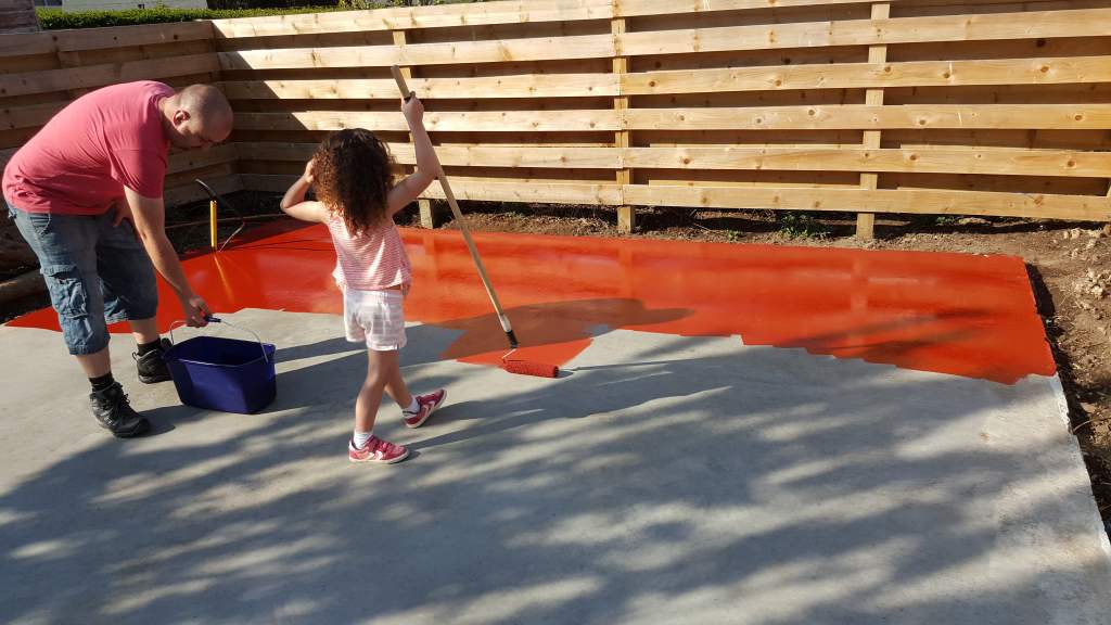

Yea I've always fancied rubber/plastic tiles, I'm doing a garage soon so looked into them, I think it'd be about £400ish for a garage that size
Was gonna say alana works in costco and they do a garage floor system thing for the floor but just seen its sealer and paint your looking for lol
Cheers anyways,

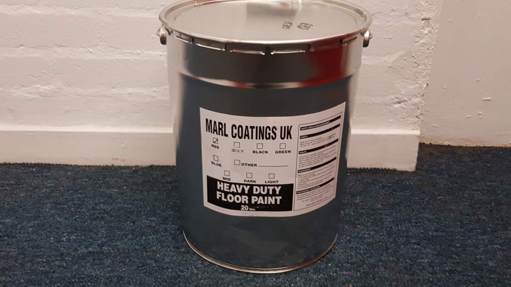

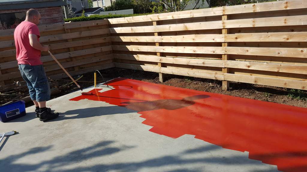

Its cost me a small fortune to get this built so far so dont have any extra funds to do anything but paint it.
Its perfectly smooth so a good red garage paint will make it look great.
  • 3 weeks later...

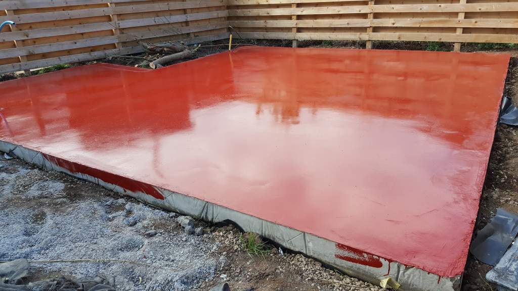

Definitely don't PVA the floor before you paint. When I did my friends workshop I swept really thoroughly then thinned the paint about 60/40 with white spirit as a base coat. This penetrated really well and was finished with two proper coats and the floor has lasted remarkably well. We previously did the car port using the manufacturers instructions of around 20% white spirit and it's trashed now, just peels up where the tyres have driven
Now that you are stood in it, you get a better sense of its size, going to be a great mancave :thumbup:
Hate to bear bad news but the 1st coat should of been thinned 50/50...also mate the more coats (thicker paint) you give it the less resistance it has to stop chipping and flaking off. with this type of floor paint less is more.....:wink:

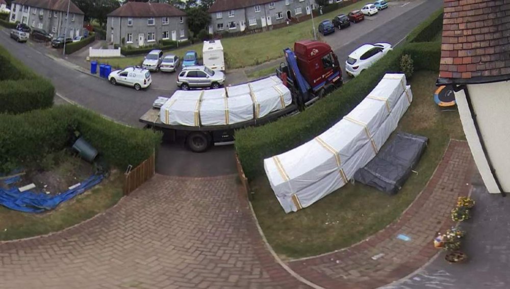

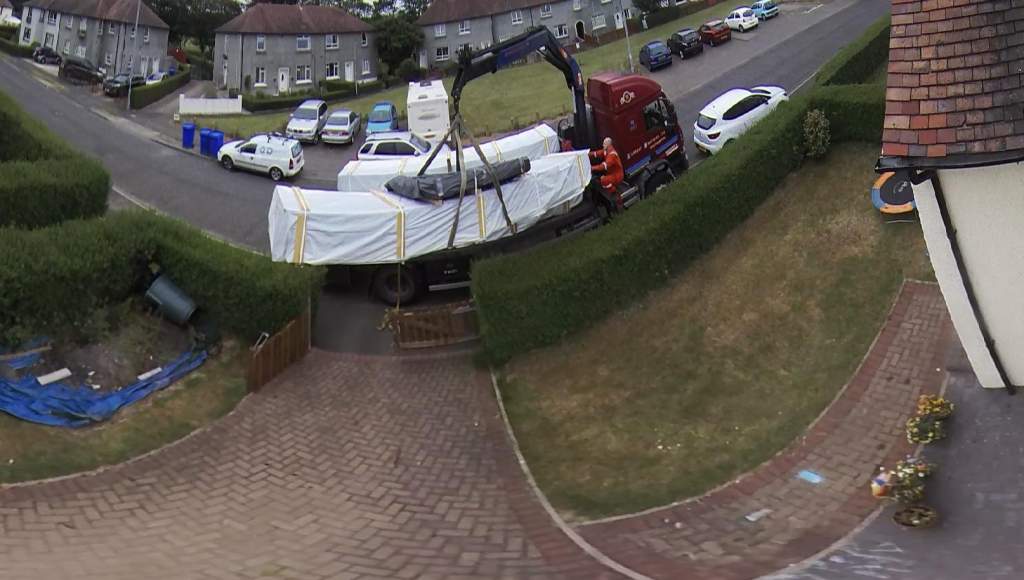

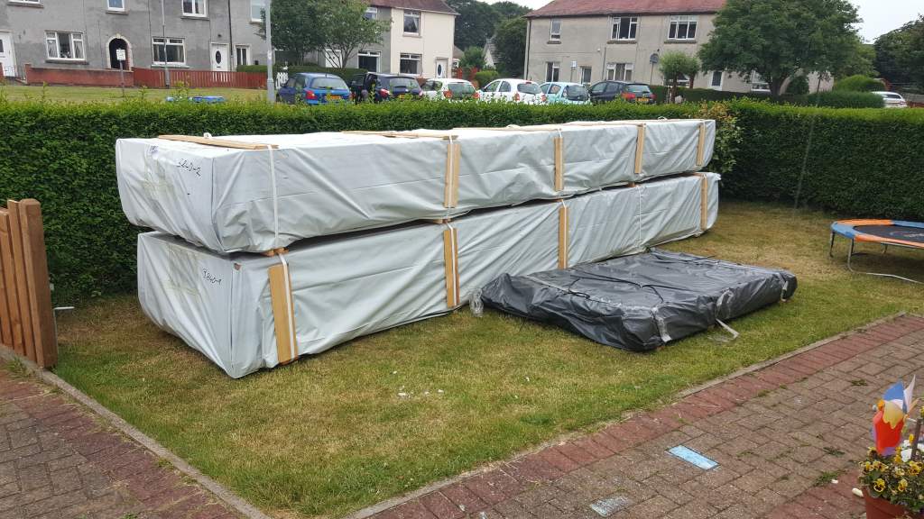

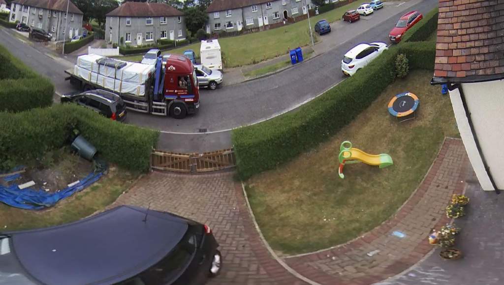

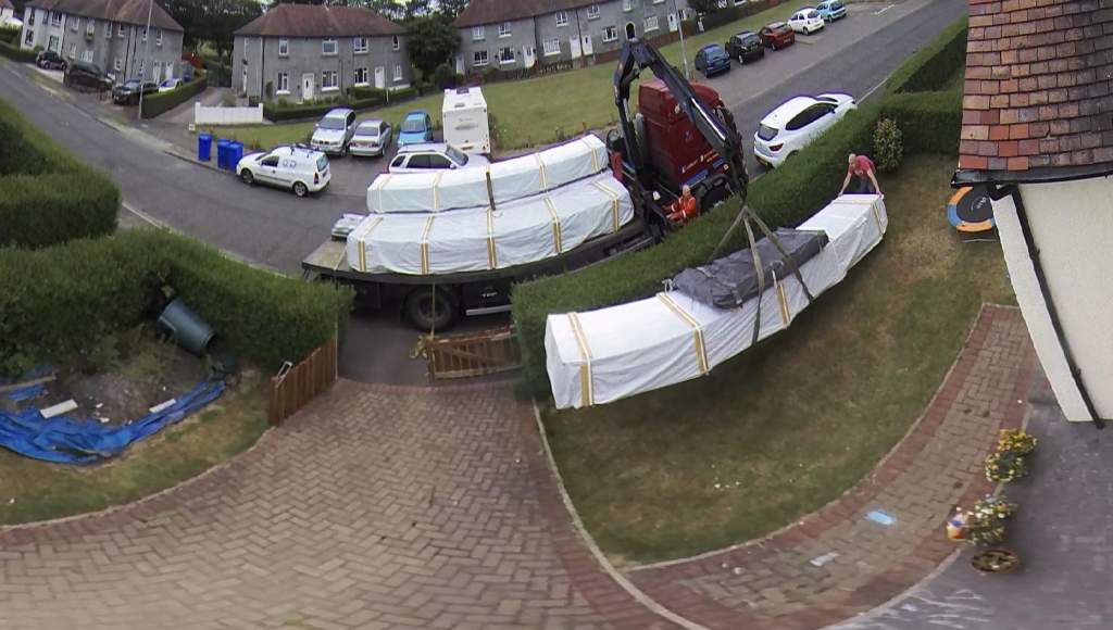

New garage should be arriving on Wednesday on a huge 13' pallet.
Wont be built for another week but exciting stuff when it arrives.
Goodluck on the build Lee...bet its nice knowing the old girl will be tucked up dry and warm this coming winter:)
