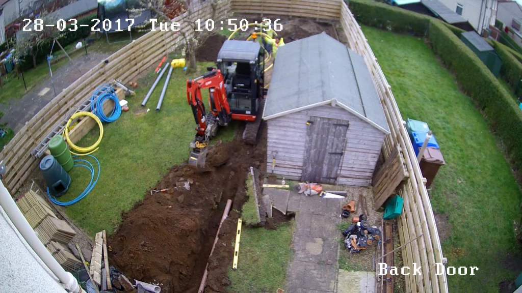

Putting my rebuild on hold for a month and a bit as the work for my garage gets under way.
Working out costs and building regulations but plan is to take out approx. 130ft of hedge, replace that
with a nice new ranch board style fence then build a 22ft by 20ft zed garage at the back of the garden.
Trying to get it as wide as possible up to the fence but really would like to skip on the fence at the back
and just build the garage from breeze block unto the edge of the garden.
The back end of the garden only measures about 18ft but the hedges are nearly 5ft wide at the back so
we will be gaining another 5ft after they are gone.

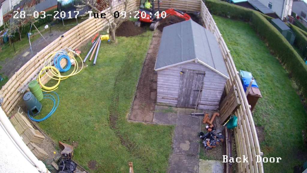

Here's a nice pic from my camera so should be able to capture the build progress nicely.

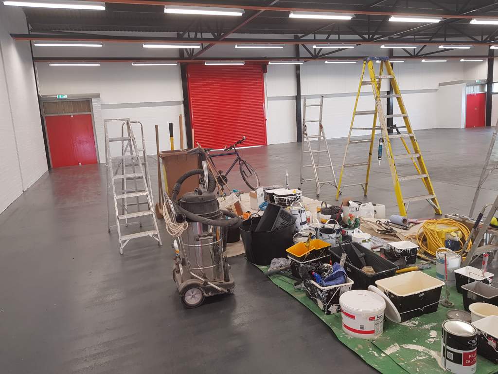

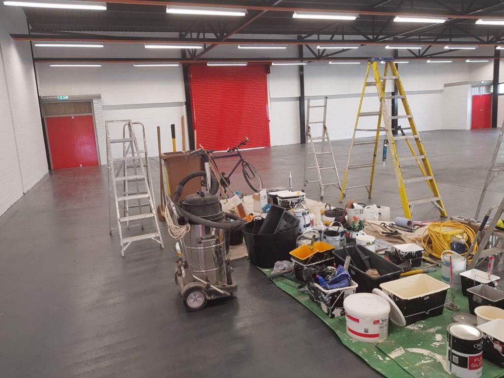

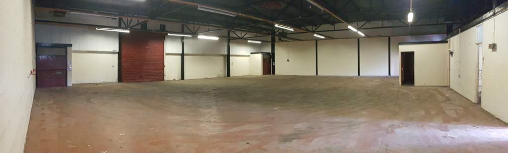

Decision's decision's Lee but the refurbed one looks so much more brighter.
Just needs a few bulbs changing, for a £6k difference I'd take the cheaper one and get the mop bucket and paint brush out:thumbup:
Look pretty much exactly the same to me :tt2:
Not even moved into the new garage yet and the work have decided to go larger.
Either this, which we take as is :
[ATTACH=CONFIG]101215[/ATTACH]
or this which is another 6k per year more, buts its just been refurbed and is spotless :
[ATTACH=CONFIG]101216[/ATTACH]
Do you want help with the rental costs? Or is your boss happy enough..

Not bad , i'm at work and being sneaky watching the progress.
Yes, you can watch them arrive on site, scratch their heads for a bit, get the measure out, have a brew then if it's a good day do a bit of work with perhaps nipping off site for 30mins, break for lunch then a bit more digging if you're lucky, then another brew, clean up for a good hour using your water and then go home, claiming that was a full day when they're home for 3pm :angry:.

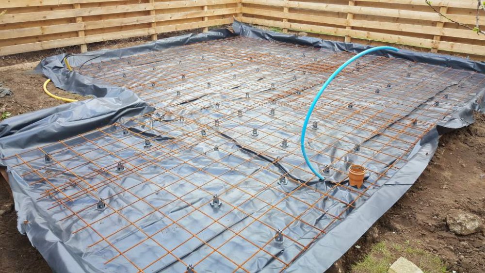

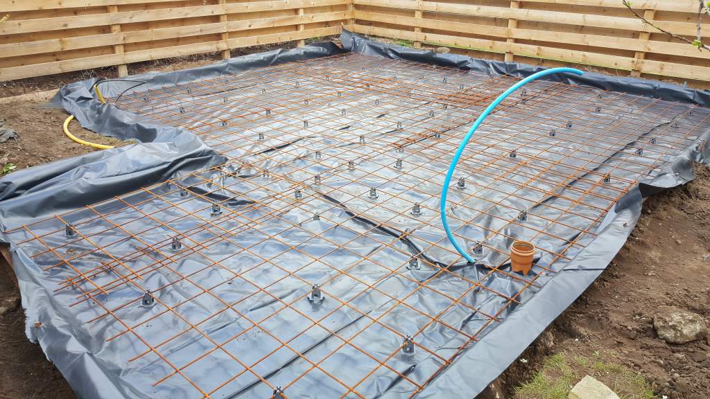

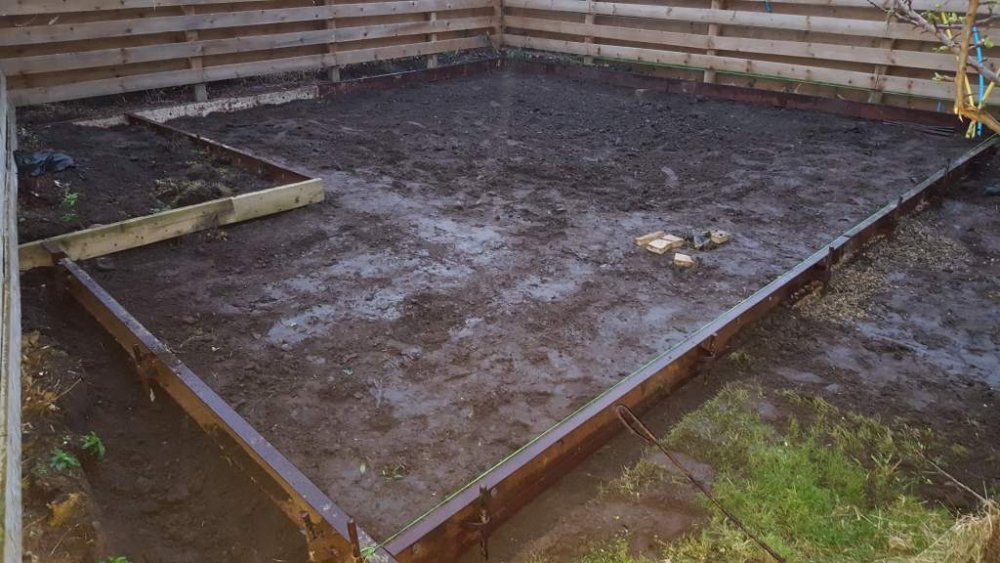

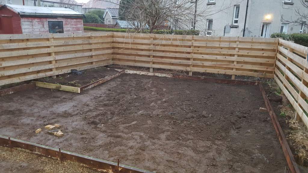

i hope they arent going to lay concrete on top of mud and no expansion joints :scared:
Not to knock another builders work but do you not need a 6-8inch of type 1 stone for a base on teram which is all led on virgin ground (i.e. Top soil stripped) as slab will likely subside other wise. Sure there is a good reason for it but just looks like they have already set the concreting shuttering. Also recommend putting reinforcements mesh where ramp is going at minimum. Sure it's all under control as seems a fairly tidy site but just thought I would mention it.

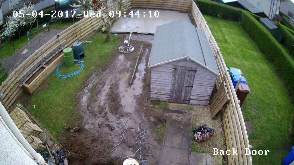

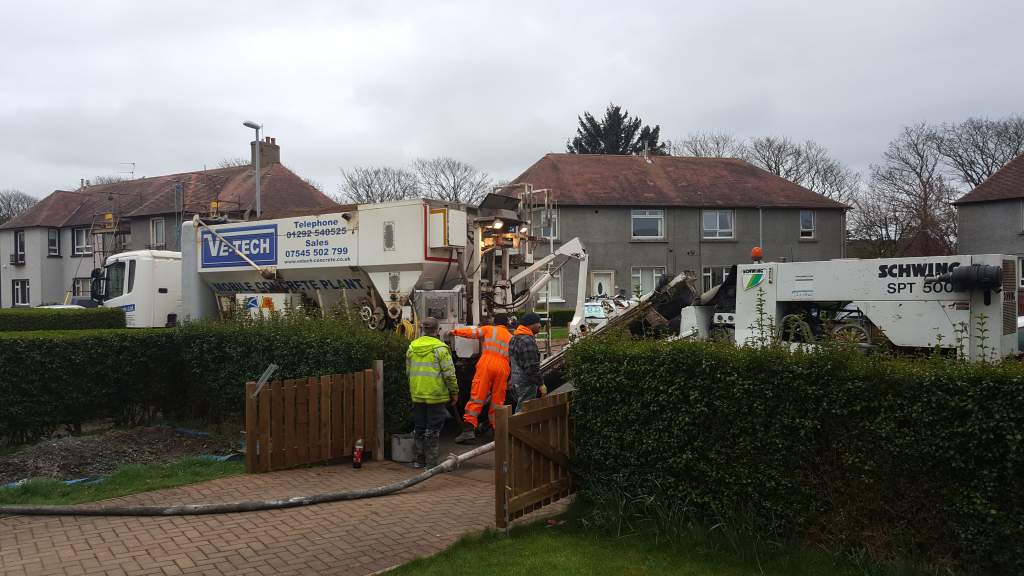

Those concrete pumps are pretty cool (in a sad way!), especially when the arm is over the top of the house and the guy controlling it is round the back with a remote control panel moving it about
Sent from my SM-N910F using Tapatalk

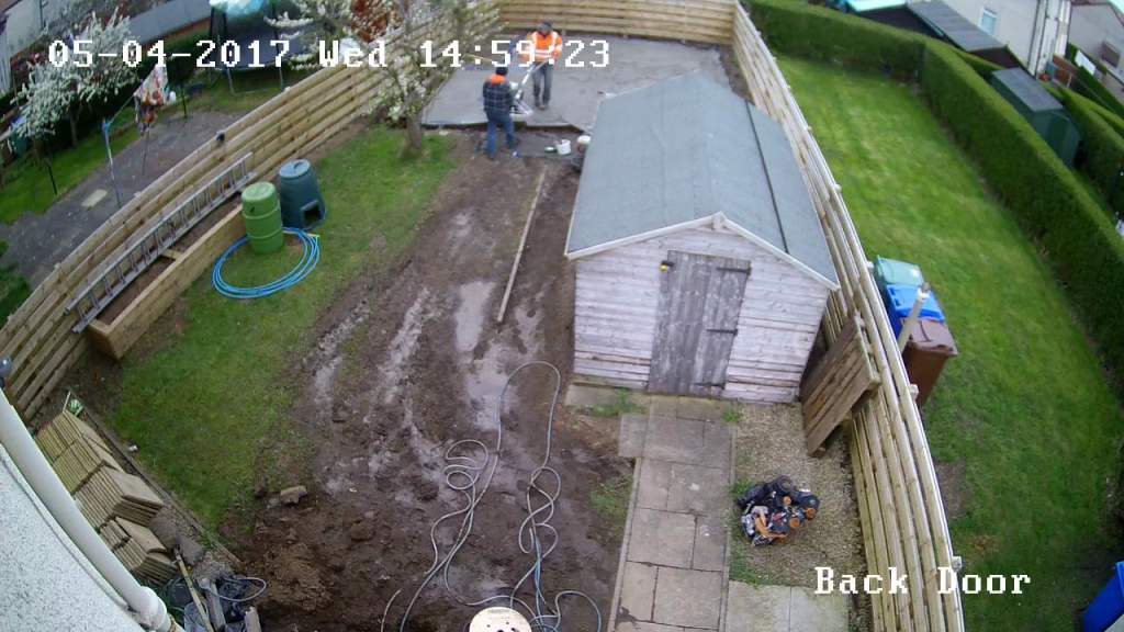

looking good there.
noce little slalom round the shed should fix your reversing skills... :lol: are you moving it to the other side?
did you not have a reinforced approach ramp put in as well, up to where the door will be?
