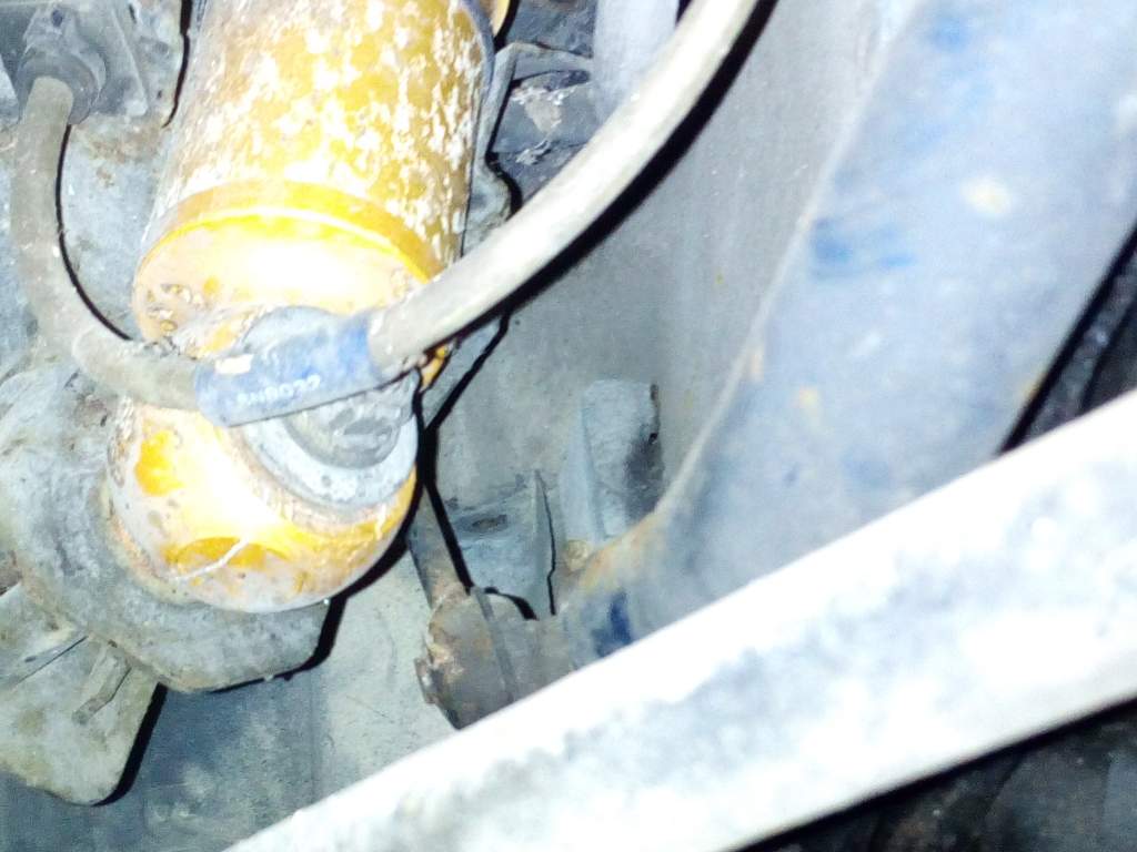

I can tell you that :(
(There is a crack in it)
Who is made by? How old is it? What's happened to it? There's a thousand reasons that might be cracked, poor quality materials is simply one option. You never know what's occurred, the car, maybe not even yours , donnor part, may had had a crash.
It has been through 2 mots on the advisory. No brand though I suspect it is from one of those Japanese part supermarkets of cheap stuff, doubt there has been a crash (of the car, maybe to the suspension) because I have had the whole front frame unearthed and is all straight.
[ATTACH=CONFIG]94829[/ATTACH]
It's possible that if there is no sleeve inside that bottom mounting then the close contact of aluminium on a steel pin could have caused enough corrosion to occur to swell that aluminium mounting and crack it. Is it white and chalky around that mount?
As I say they may have come from a donnor car, they could be 10th hand. That being said they appear to have very little corrosion and adjustable preload. The only way to know is to remove one and see what's on it. You may well be right that they are cheap crap. Whatever the case I can tell you I wouldn't drive that car on them with that crack.

Wouldn't worry bout it that shock looks more serious than what I was wafflin on bout if I was you ide be exercising my credit card and ordering some new shocks at least or coil overs there not as expensive as used to be, I wouldn't be drivin that either I had a shock break on a Toyota last year as I was going round a roundabout and the wheel bent under the car as I glided in front of an arctic scary stuff.
I may have spotted a few penguins as well it was winter after all
I wish I still had the pics the car ended up looking like car off back to the future
