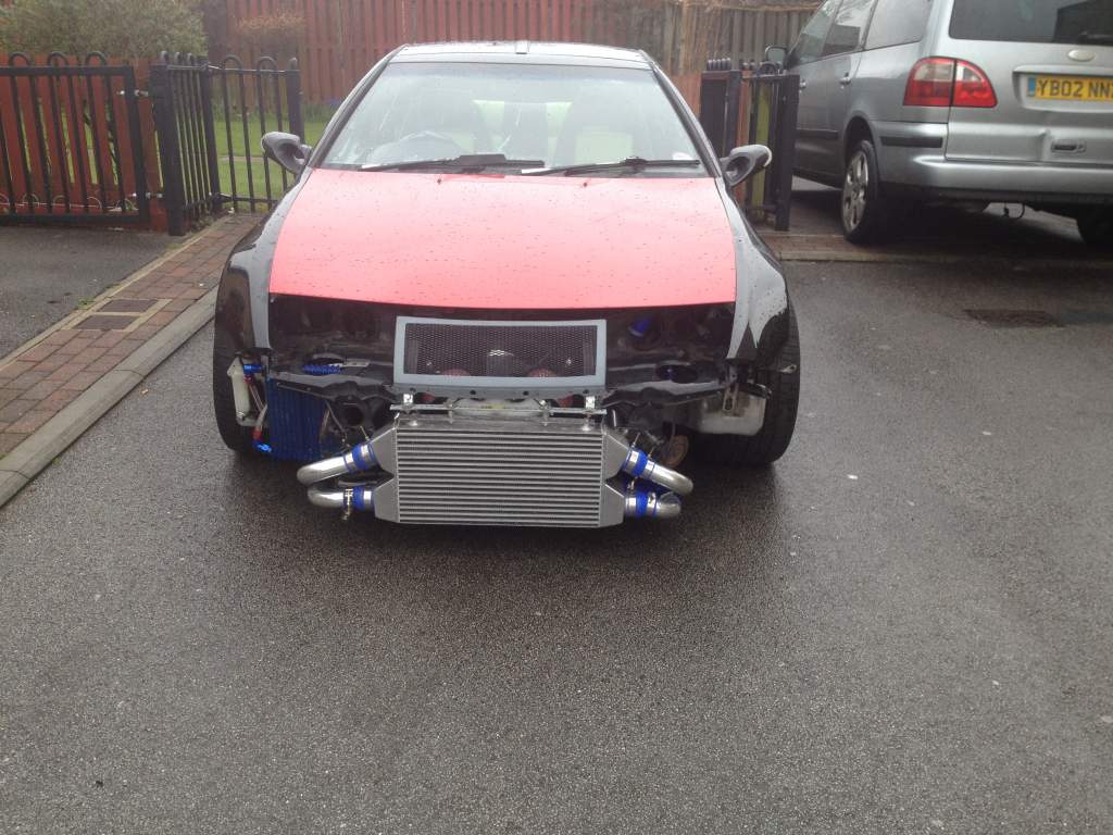

I've got a larger FMIC on and the 99 spec went on fine. Also Greddy Gracer type front bumper fitted with some mods around the pipe work. Car looks good, may I suggest though that you put your fan shroud back on. The fan does very little in the way of drawing air through the radiator unshrouded. Mine fitted fine with an uprated thicker core rad too.
S
It was only that Ash had to cut his 99spec bumper to get it over the FM, but I suppose it is half to do with how it is mounted and where the pipes go.
Yeah you're right. I mounted mine quite high and chopped a lot of the bumper bar away. So like you say you can either chop the bumper or re-position the cooler!

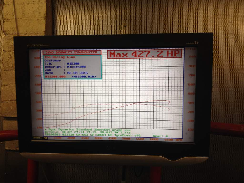

[ATTACH=CONFIG]93768[/ATTACH]
Your car has major issues according to that dyno plot!

hi guys just a quick update I have got the car live mapped but still not running fully right z32 dyno 2.jpg
hi guys just a quick update I have got the car live mapped but still not running fully right [ATTACH=CONFIG]94234[/ATTACH]
Huge improvement. What do you mean on "not running fully right"?
am not fully sure yet but its got boost leak or sum thing not running right sum where its reading too much air flow and cutting out going in to safe mode its running at 12psi I think that's what the garage said .
